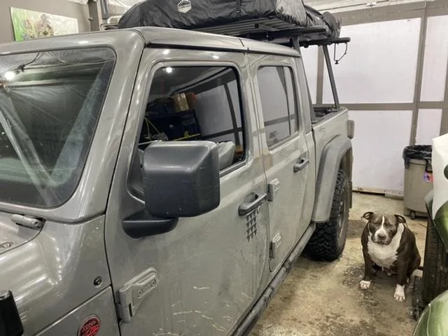

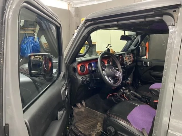

A few drops Johnsons baby shampoo into a spray bottle of distilled water and spray everything woth it. The glass, the door, your hands. Anything that tint can touch. Helps if you have someone to help.
As for tools, a good 8” rubber squeegee and a small plastic tool.
Clean the glass and surrounding area well. Roll the window down about an inch. Then spray it all down with the tint film solution. Then squeegie it clean (this removes the lint and dust).
Then spray the glass and the tint as you pull off the backing. Keep it all wet. Aligh the top edge, then woth the plastic tool work it under the rubber glass trim.
Squeegie out the water, from under the film, then roll ip the glass and finish working out bubles.
Helps if you have a heat gun at this step to get it set.
Ive done a few, the JT is pretty easy as it’s quite flat and square. It isn’t hard, but you’ll make a few mistakes to start. So get a second set, and start with the passenger side :)
Plenty of YouTube vids as well.
But got good results with the Lexan kit at 25%. Just did it, so nothing more to say. But that tint did apply very nicely and was pretty easy to work with as far as films go.
