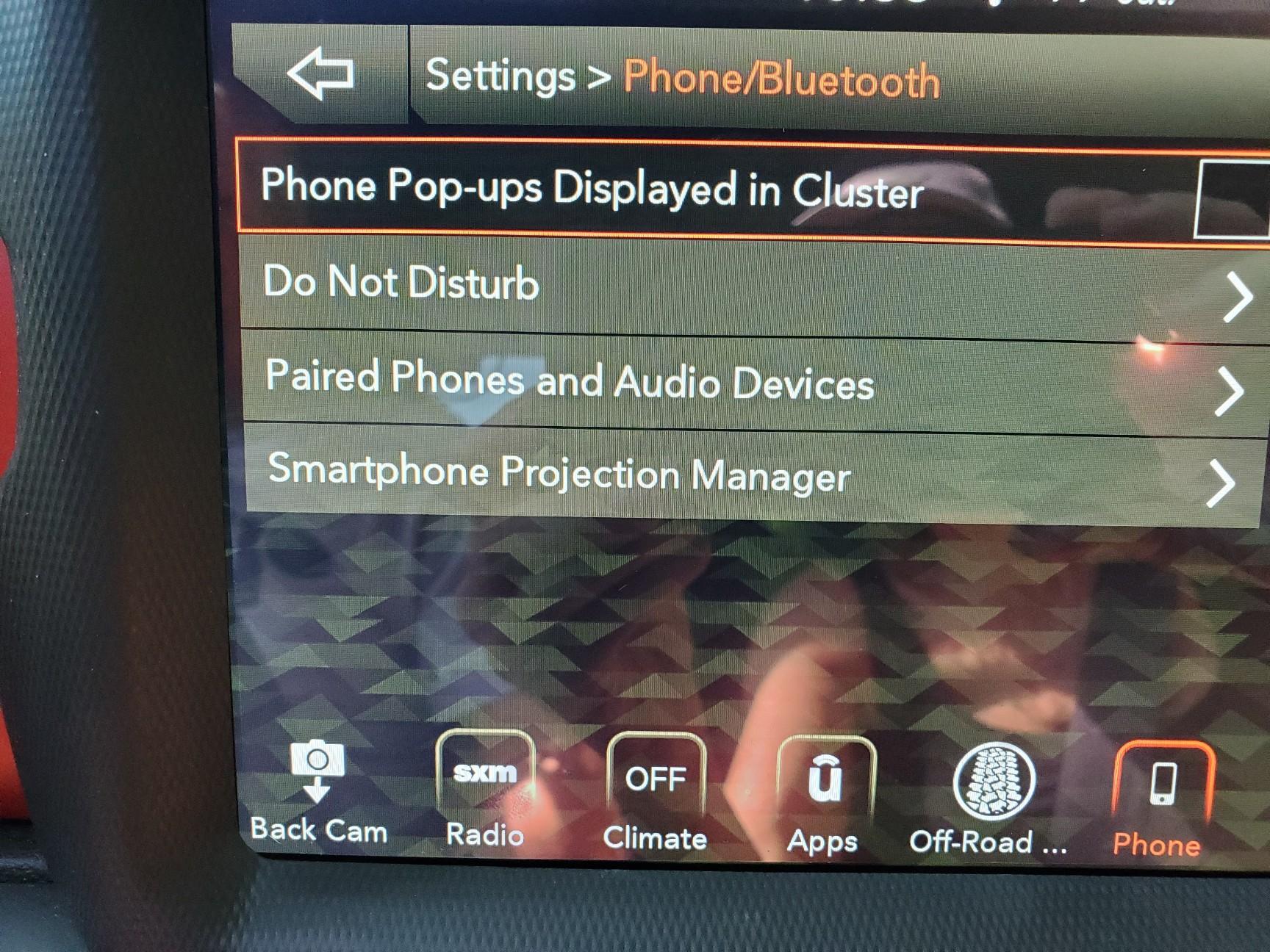

@allenjh
Won't hurt, but slight chance that you may find this helps.. I've seen the process below, help for a few random issues.. The process only takes a few minutes to do.
1) Unpair your Android smartphone.
2) In UConnect, Smartphone Projection Manager, (see pic below) delete any and all Android devices listed there. (You may see more then one, even if you have only paired your Android cellphone)
3) Now, pair your Android Smartphone with your JT.
Thank you! That worked and Android Auto is now working correctly.
