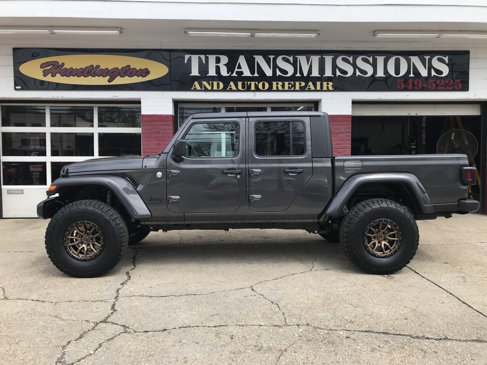

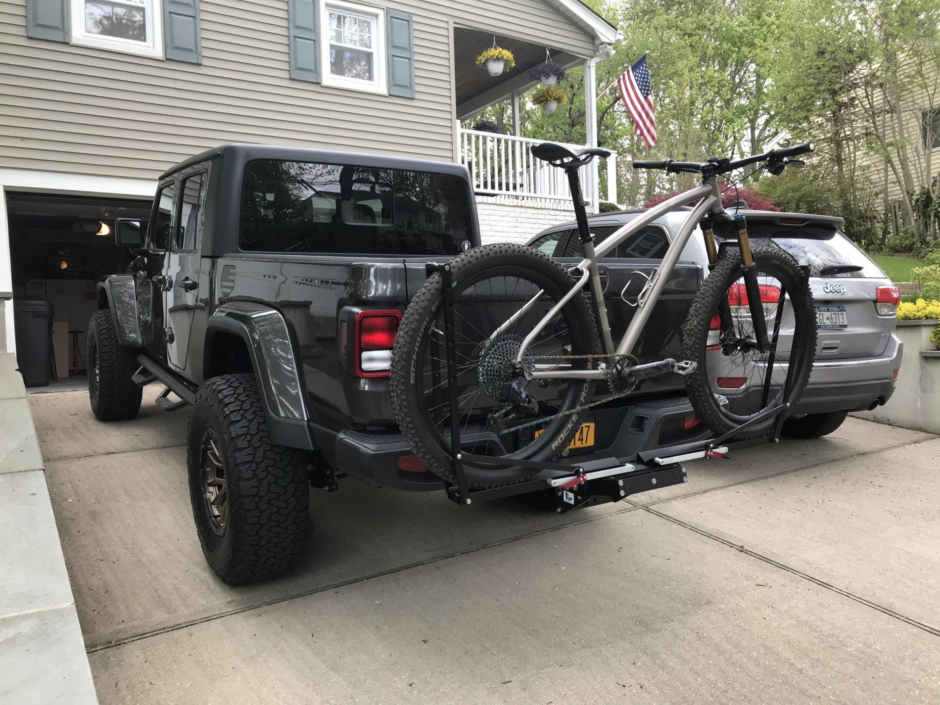

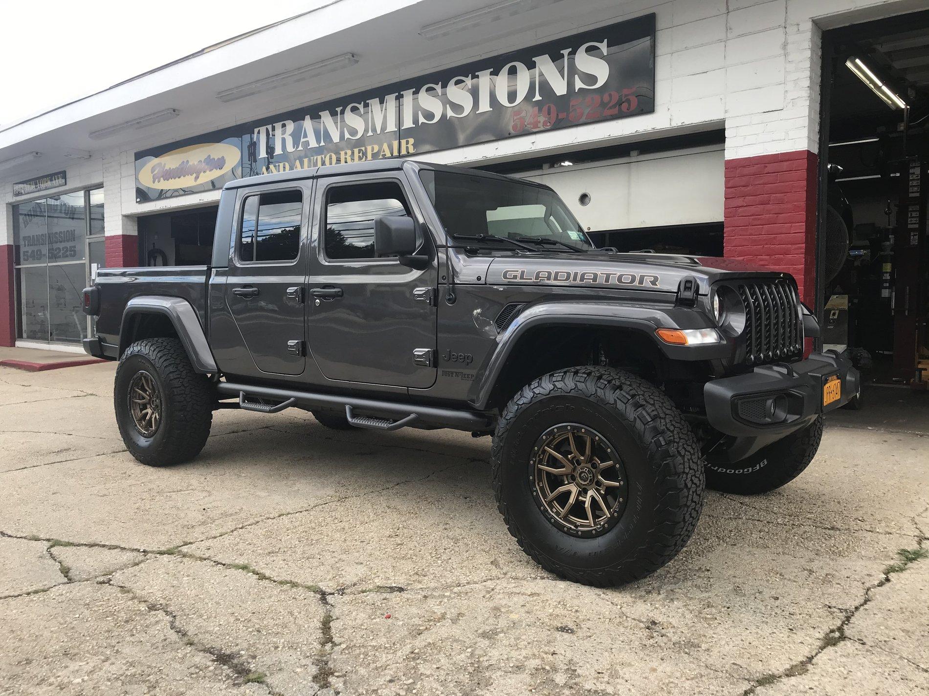

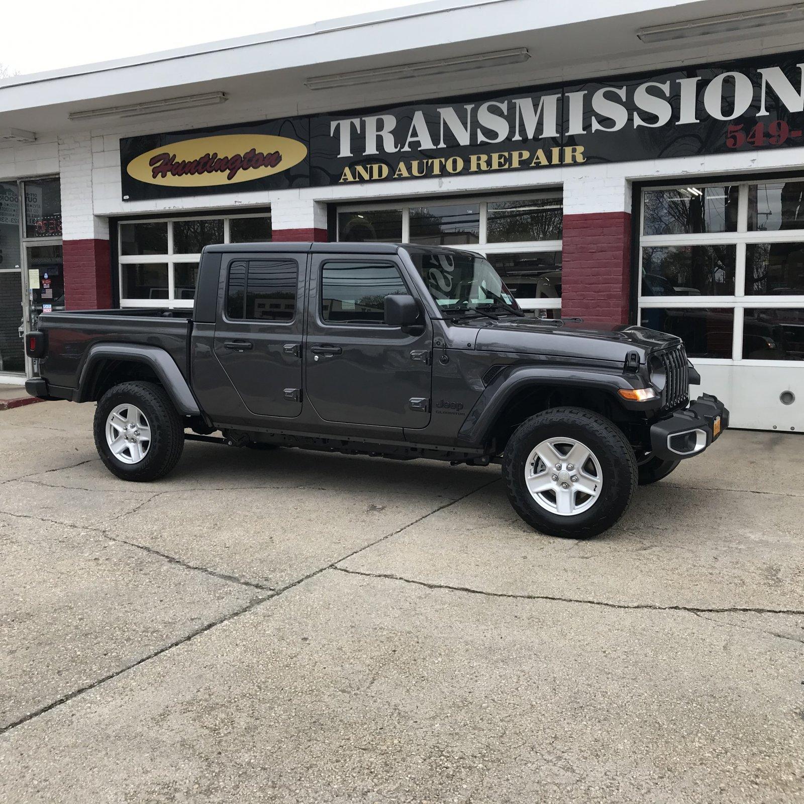

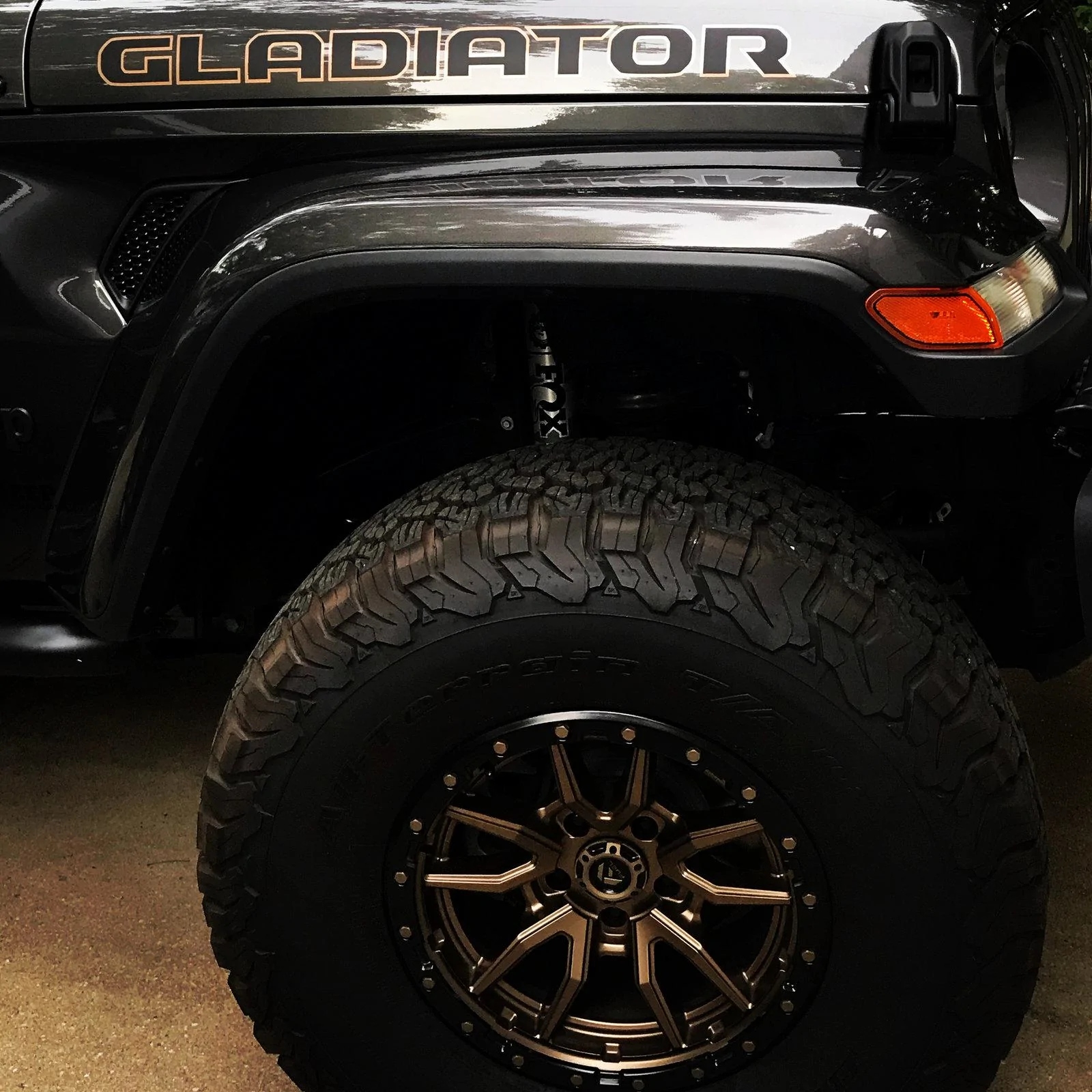

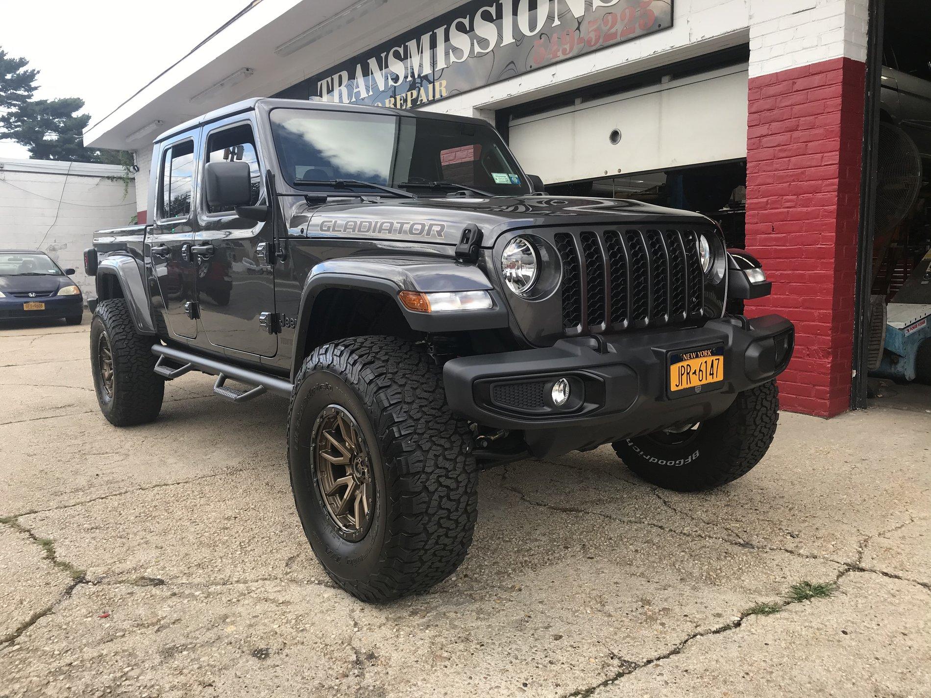

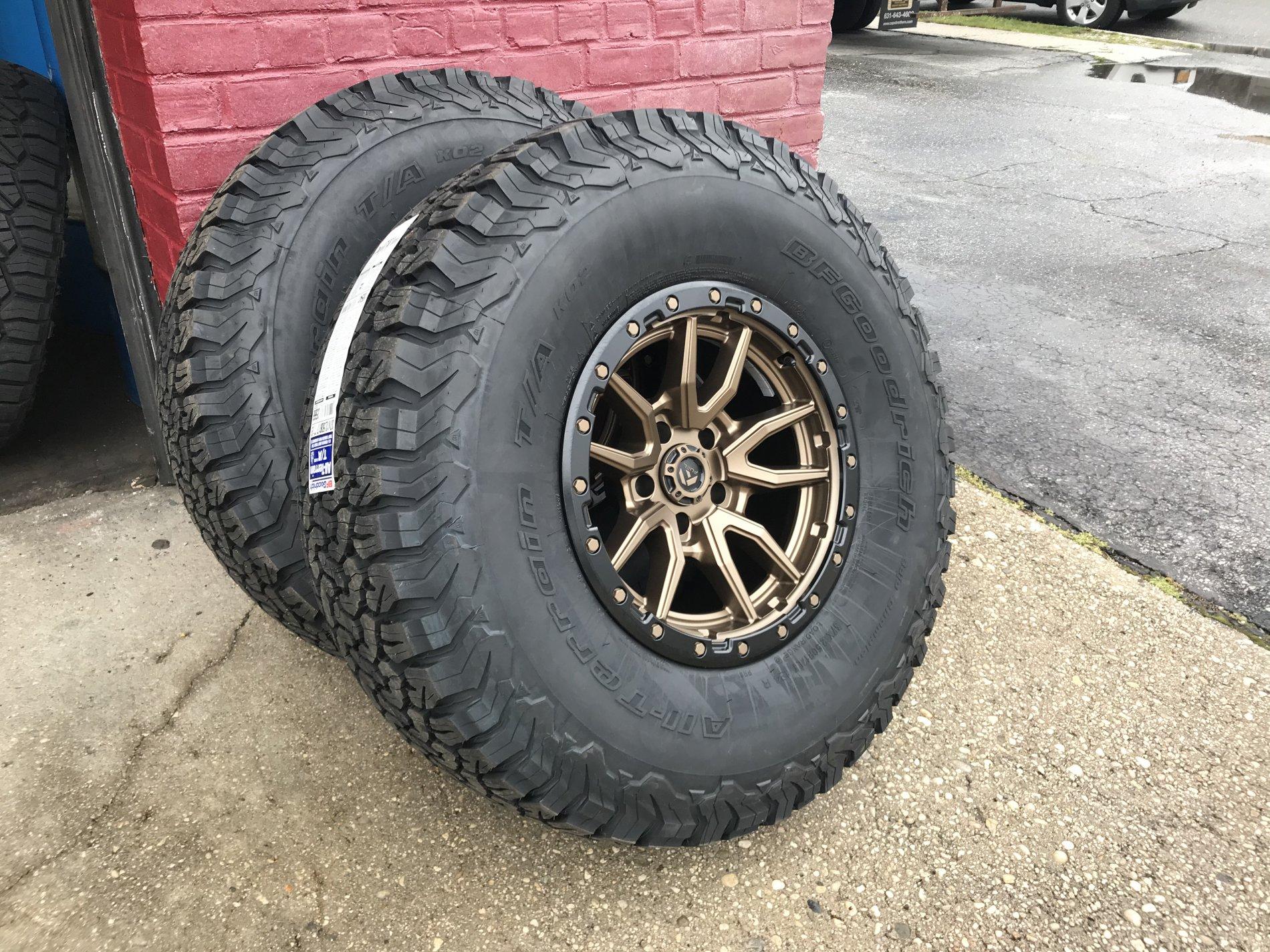

I ordered my Sport S late January and because of the virus I didn’t receive it until Monday, April 27th. My whole area on Long Island, NY has been like a war zone... major hot spot so I decided to name it Elpis, Greek goddess of hope. I had all the parts ordered and sitting in my garage just waiting. First three days and this is where I’m at.
- cold weather package
- tow
- color matching flares
- bedliner
- Granite Crystal Metallic
Jeep Gladiator Project Elpis F24E1F52-9F15-4CF7-B7B4-E149FB999E3B
Jeep Gladiator Project Elpis 485518FA-3093-4295-B247-AC21B159FC52

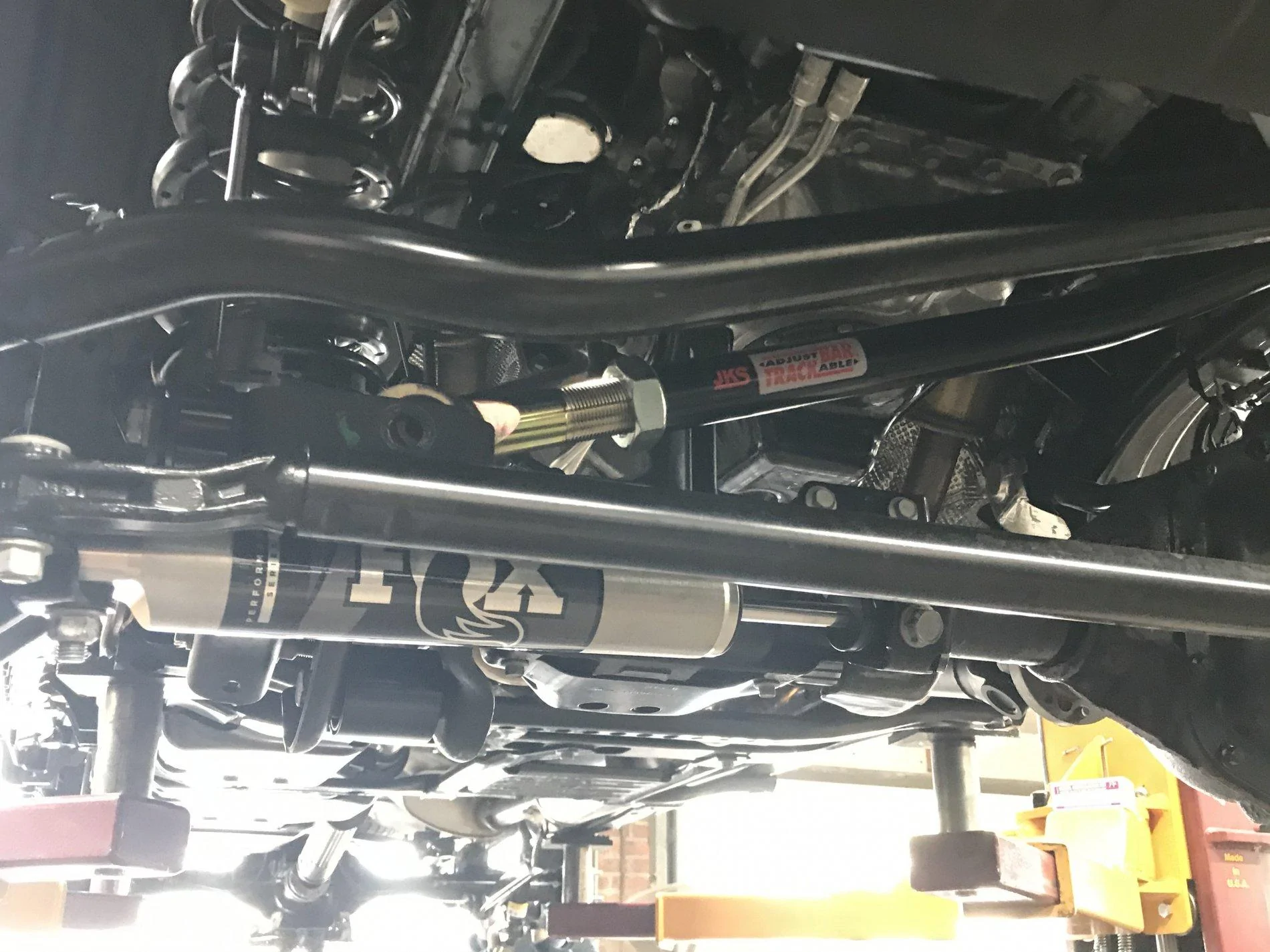

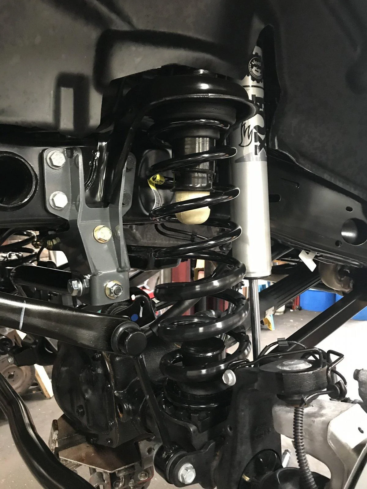

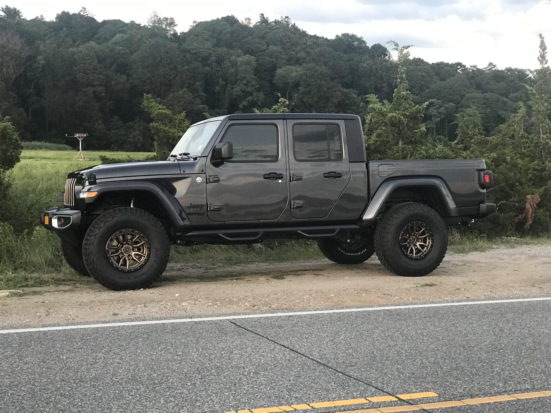

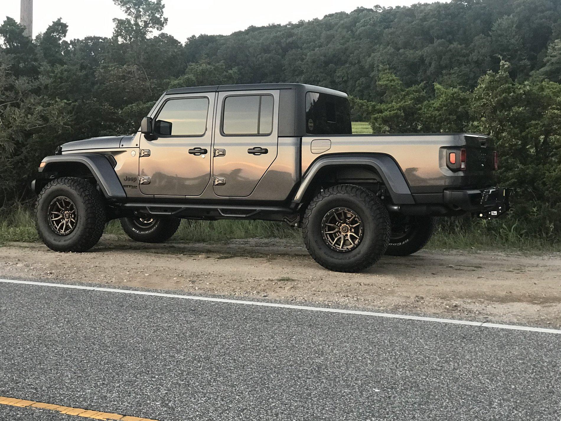

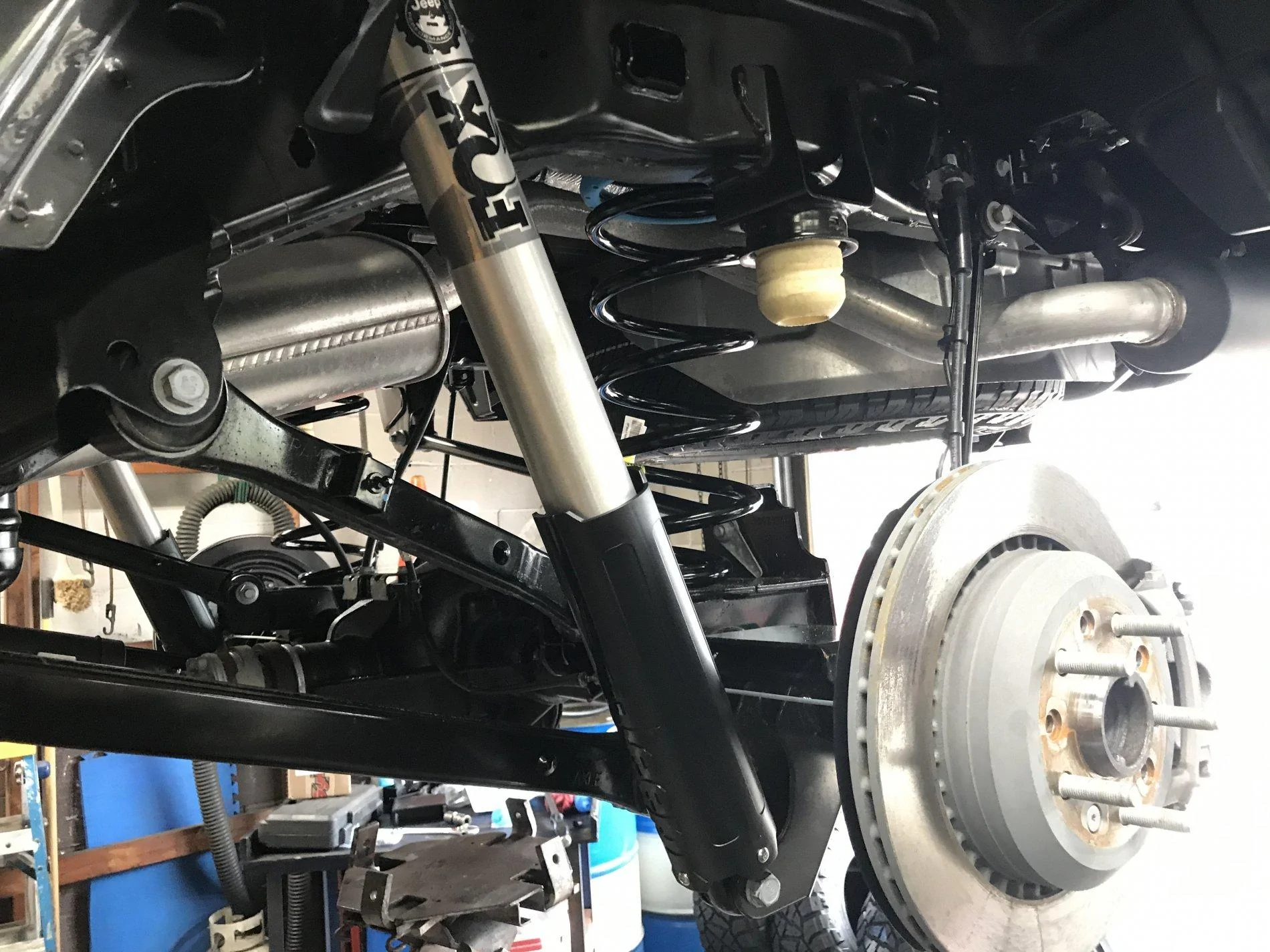

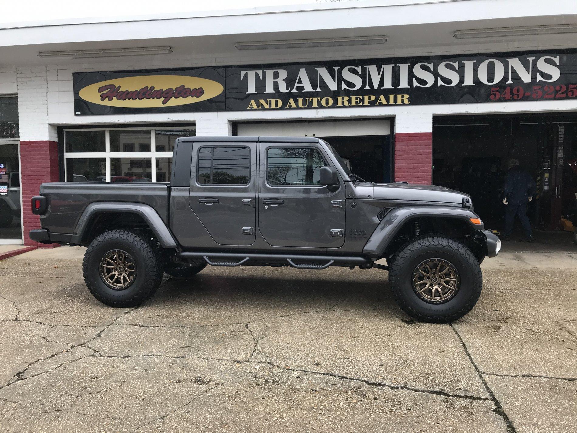

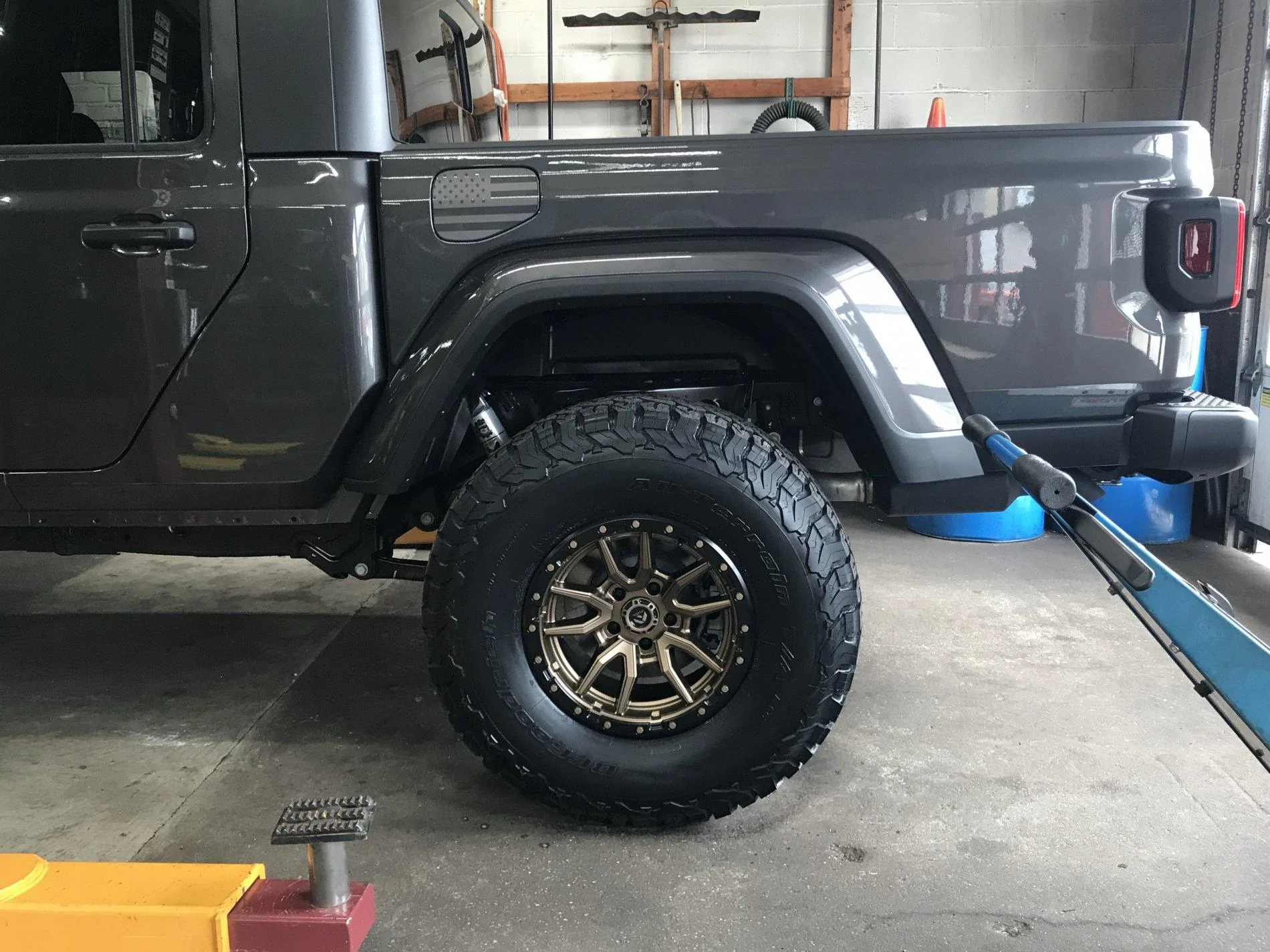

I did the Mopar lift, Synergy brace, JKS track bar & Fox Stabilizer. Got the alignment done on a brand new Hunter machine and it drives like a dream. So happy with it.
Jeep Gladiator Project Elpis 23B1EB69-26DD-41D5-95DC-DAE53DBA7921
Jeep Gladiator Project Elpis 098E8DFC-7574-4755-9BF0-F2C473640928
Jeep Gladiator Project Elpis 4068A284-E0A0-4AAB-B5B4-D63C8EA591CD

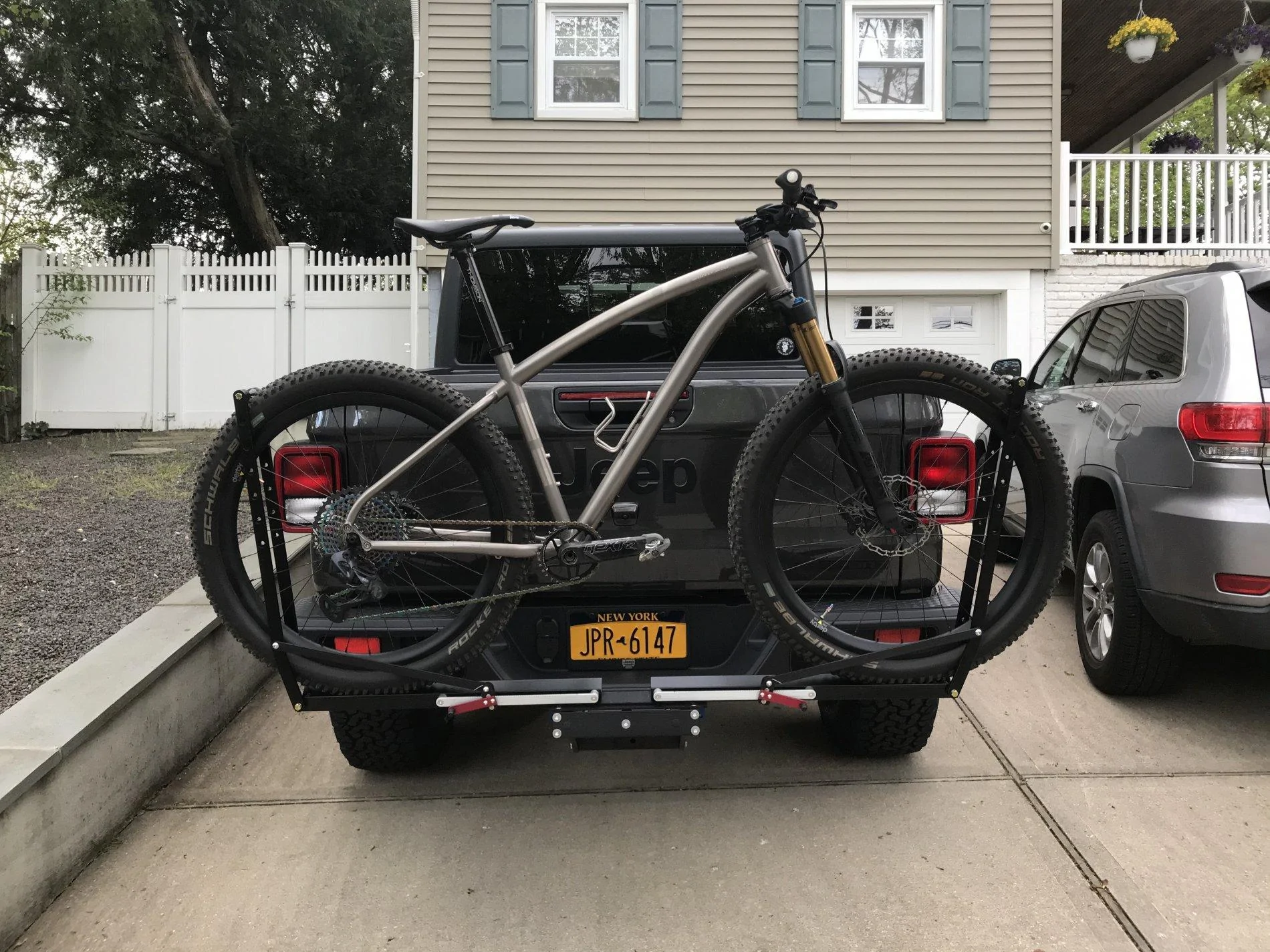

Weekend project in between putting some miles on the JT. Making a coffee table out of the Mopar crate.
Jeep Gladiator Project Elpis 6236A3D3-22C3-4335-99FA-F22EE70D00B7
- tow
- bedliner
Sharp rig. I'm helping my granddaughter's husband look into buying a Sport S just like yours. I'll show him your thread. Great choices so far.

Thanks Pat, any questions just ask away. We did all the work at my shop so it’s hands on

did you add an additional spacer on the front?
reason i ask is that the stance doesn't look like it has too much rake. do you know what the difference in height is between the front and rear pinch seam.
i have a sport with tow package and the difference is 2 inches.
i just ordered the Mopar 2" as well and wondering whether or not to add a .75 inch spacer as i have been reading that most do.
Sorry, just saw this. I used a 1" spacer

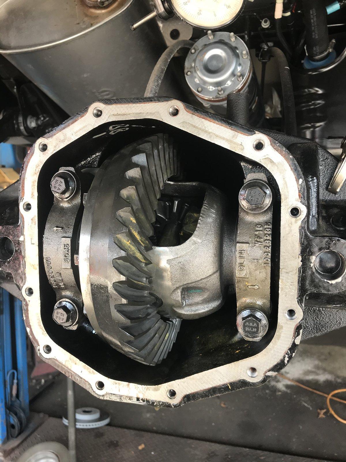

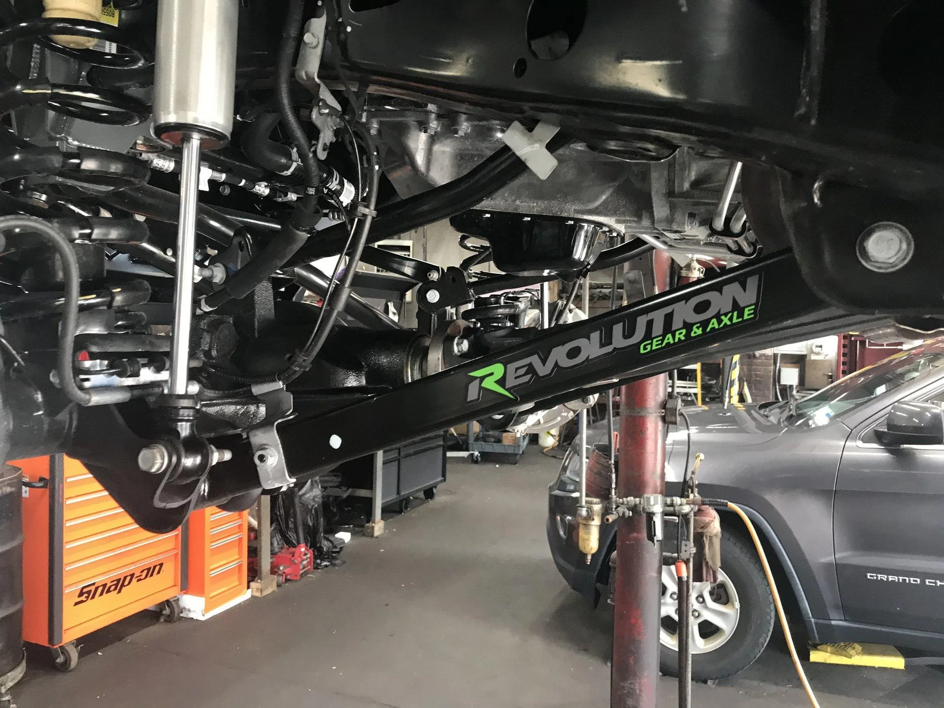

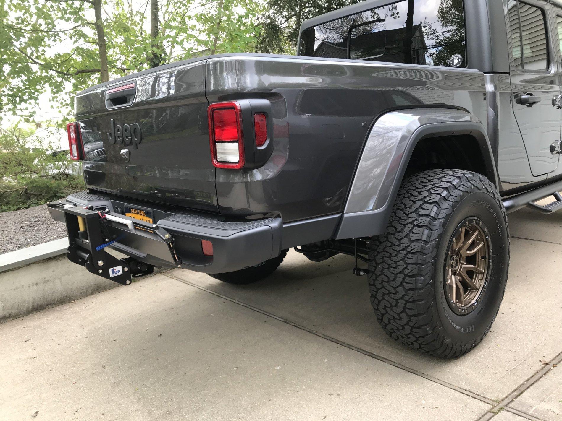

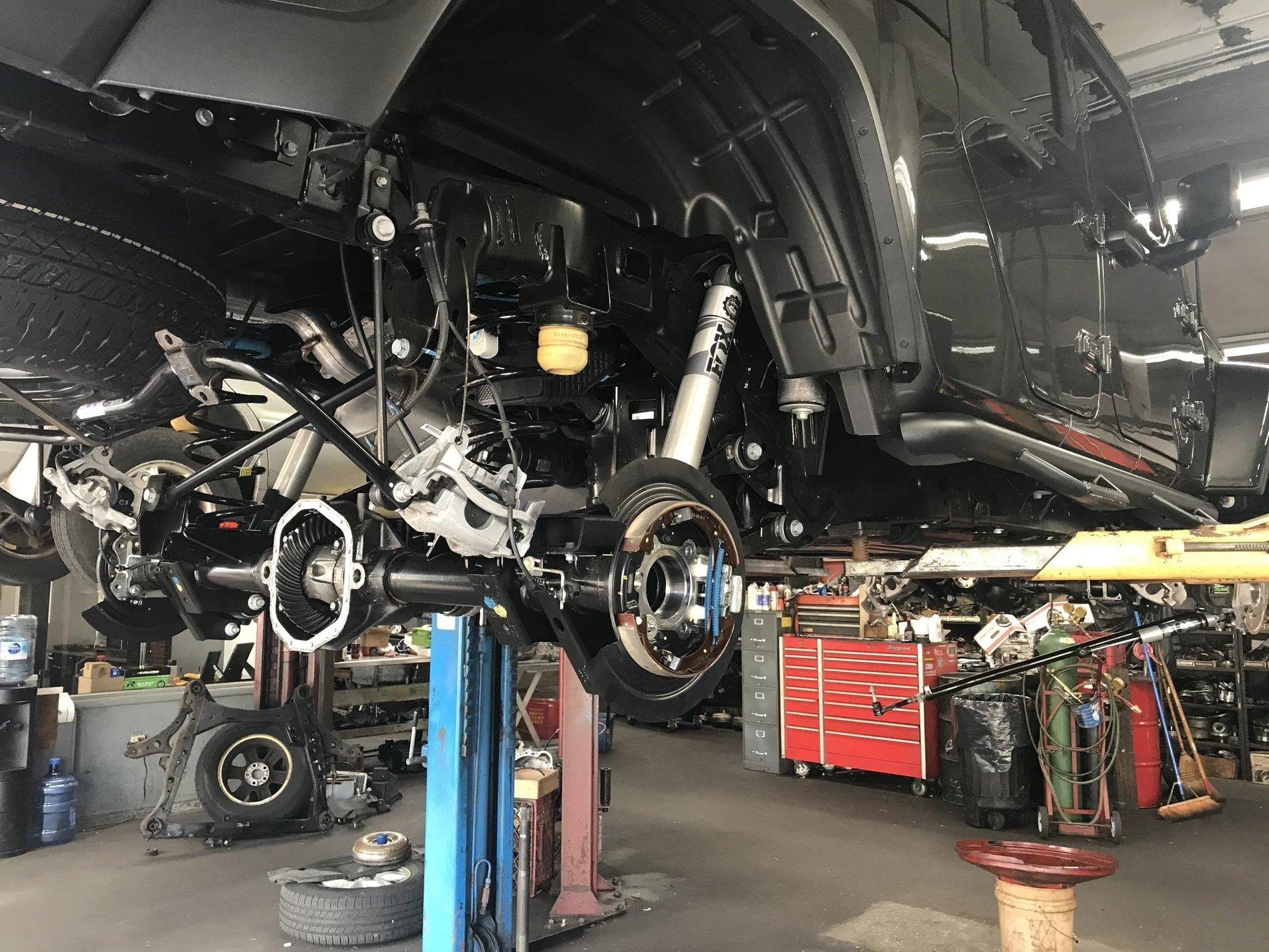

Took out the stock 3.73 gears and installed Revolution 4.88s!!
so much better, has some pop off the line and locks into 8th gear at highway speeds
Jeep Gladiator Project Elpis BF19B15A-4491-4B2F-8014-D81AD66BC469
Jeep Gladiator Project Elpis 32159176-CFA8-427F-82D4-755FE5009450
Jeep Gladiator Project Elpis E572EDF1-ACB8-45CB-A00A-8E605FE97FB2
