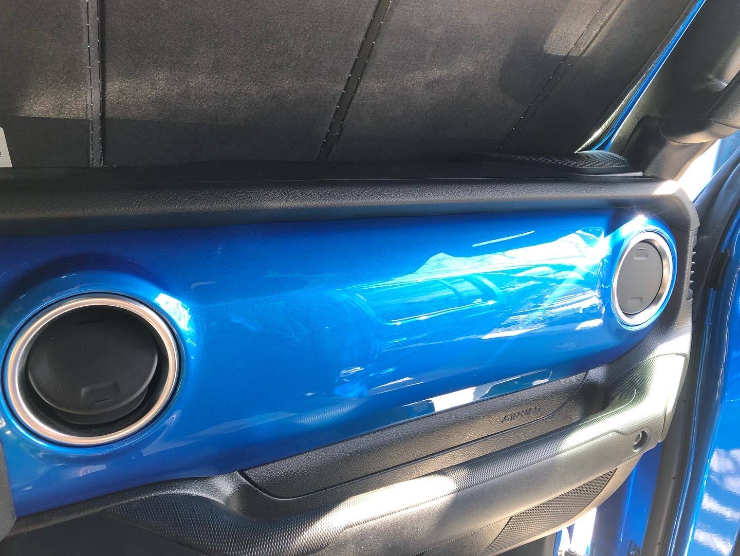

What I ran into was, I wasn't removing the right cable to the main battery, so the Aux battery was still connected and providing power to the dash, which means the airbag had power. Once I disconnected the proper cable, the dash was dead. I don't think you want the airbag going off while you are handling it? Once the power is dead, it's an easy job. I replaced the dash panels on mine and it was really pretty easy.
That's why you take the cable "assembly" off the top of the IBS, and then you take the two cables apart and keep them from touching anything at all.
It's a totally safe, proven, perhaps over-kill, method of making bloody well sure "he's dead, Jim".
Tank, where did you get your color matched panels? They look really good!
It's a company called Distinction Applied, https://www.distinctionapplied.com/
You order the color you want and they send them to you, you replace the factory ones, and when you send the old ones back to them, you get like a $200 credit. They have all the factory colors and other ones, like Carbon Fiber and Camo. Really easy company to do business with. The only tricky part is moving the air bag from old to new, just follow the directions and make sure the power is off and it's pretty easy. I bought a kit that has the tools for removing trim and dash panels, makes it a lot easier.
