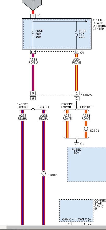

No luck so far. I pulled the radio fuse, speaker connections and double checked every connection I could see and still no go. I unplugged the battery and the head unit to leave it to drain out. Hopefully that doesn't cause further issues lol.
In the diagram below it shows the 20a fuse down to the connector into the head unit. It does say "fused B (+)" I'm not sure whether this is indicating that there is no connector there or that there's a fuseable link and no current rating stated.When i pulled the head unit there as no fuse or fuseable link that I could see.
If this doesn't work IDK what ever to do.
