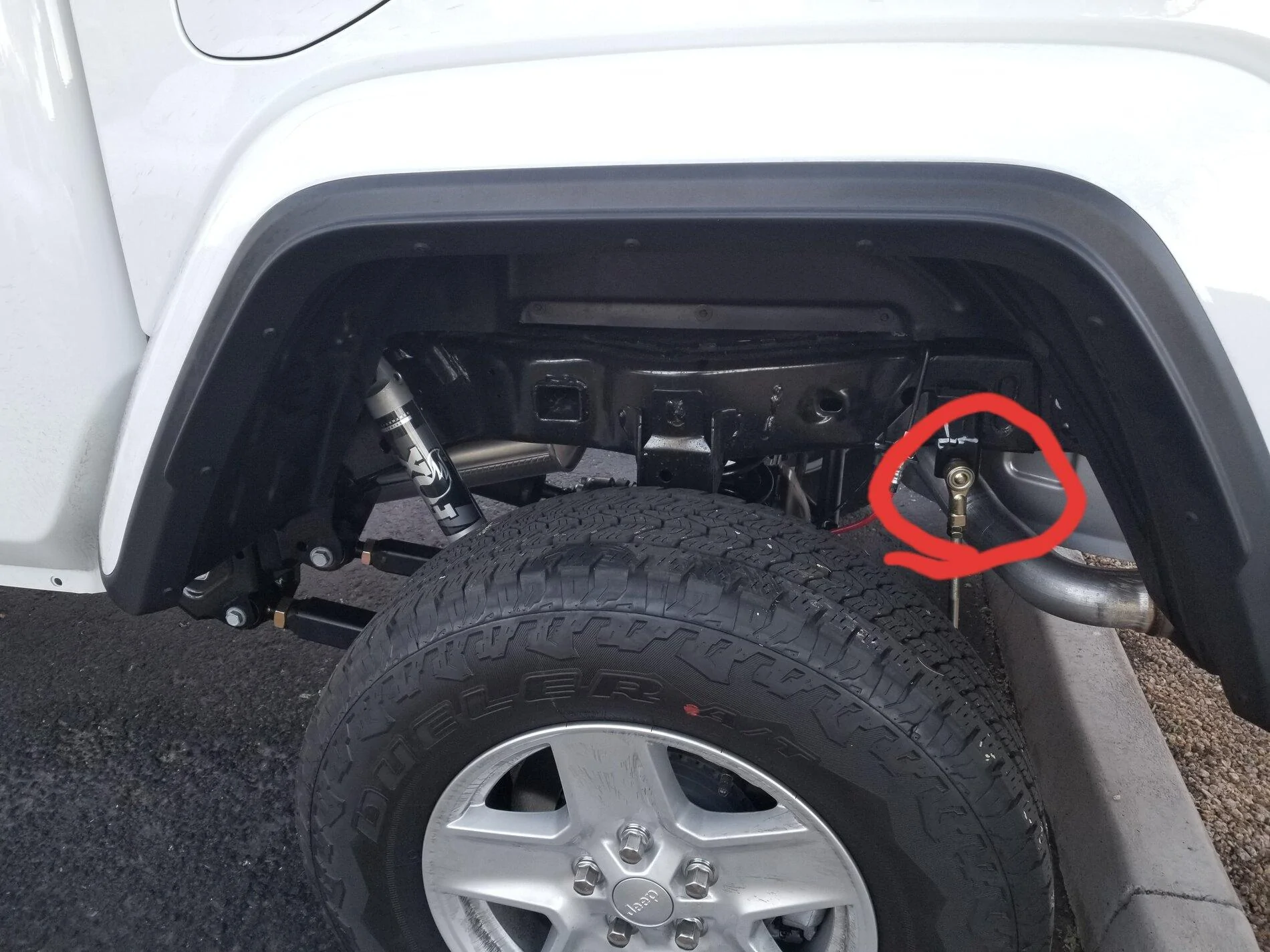

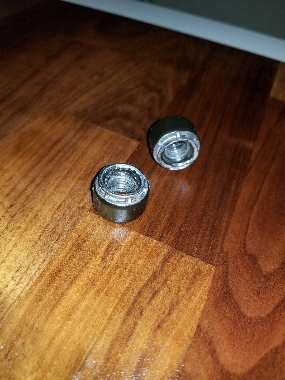

I recently found that my rear sway bar link was loose after hitting fairly easy trails this weekend. On closer look the upper captive nut broke cleanly off.
Jeep Gladiator Rear sway bar link captive nut 20201118_100028
Anyone else have this happen or know what might have caused it?

I had trouble with them coming loose, then ripped one out while running some links which were too short. I have since fabricated some brackets which bolt on over the factory mounts, and use a regular nut on the back. Jeep's design on the stock bracket sucks!

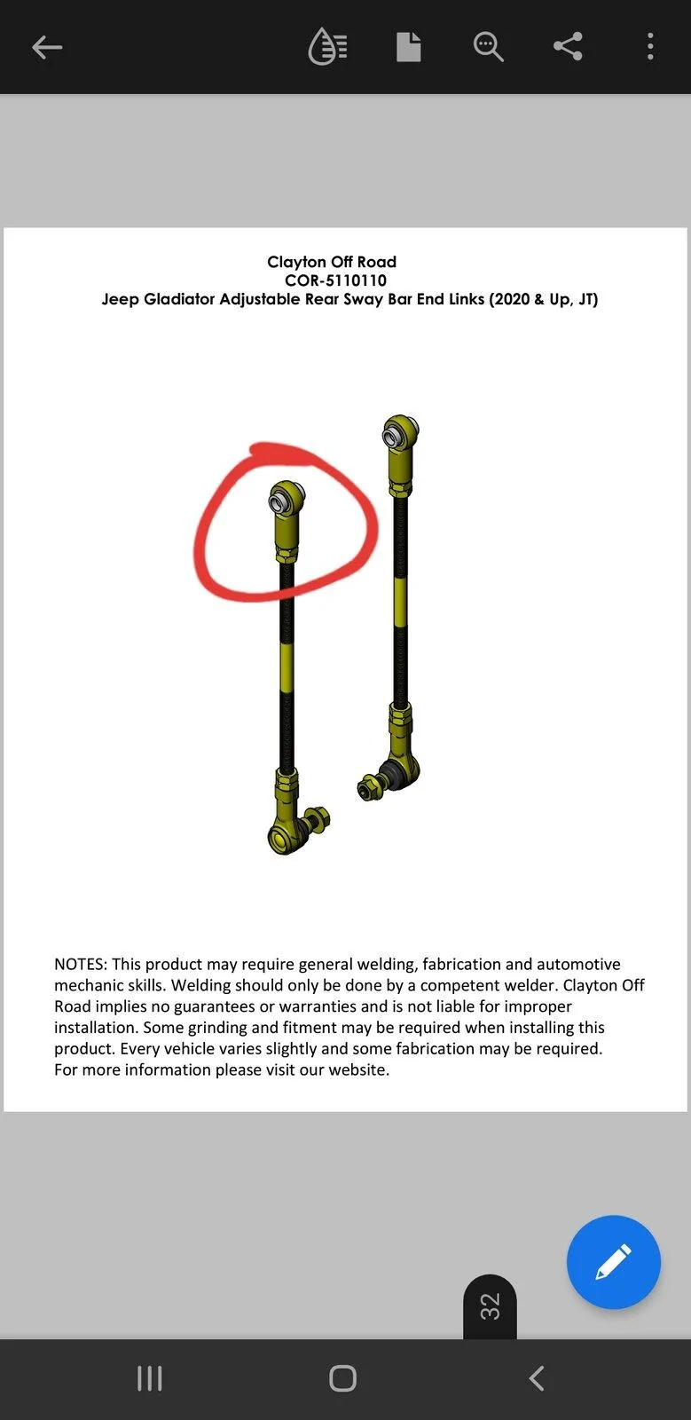

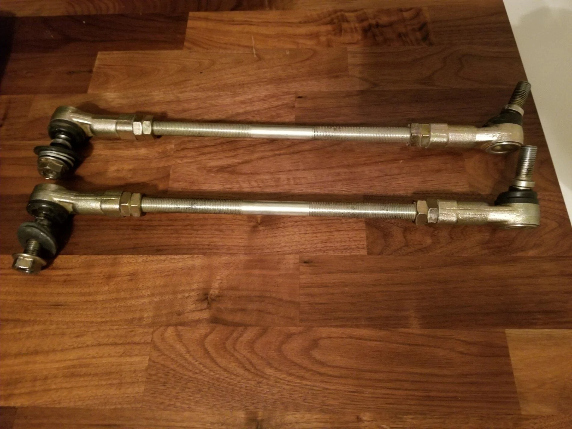

Question for anyone with experience. I'm thinking this rod end could be what may have caused the issue since I'm not even sure how my mechanic would have been able to torque it correctly the first time. In looking at the installation pdf for the 3.5" overland + kit It's definitely different Any thoughts?

Yes for some reason you have the incorrect part, give us a call when you can and we can help look into this for you! (203) 691 8593

Thanks for getting back to me and sending the parts right away @Clayton Off Road
Also, the shop will weld more steel to the bracket shortly.
