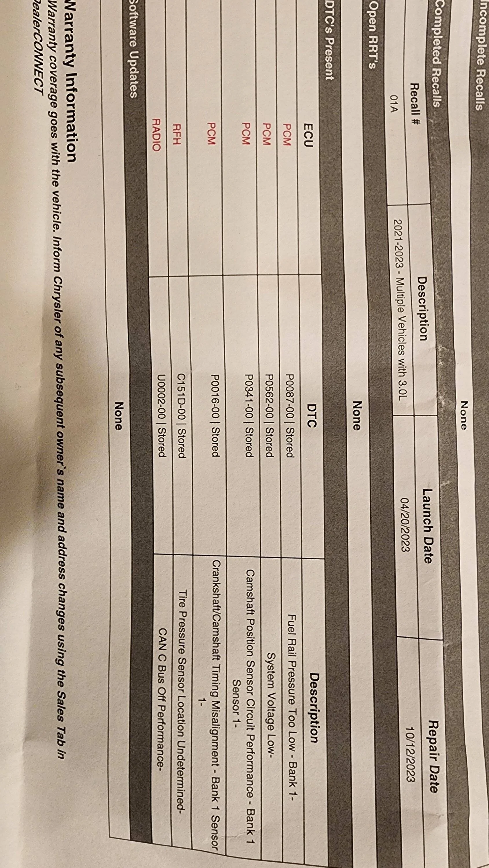

We purchased our Gladiator Diesel in October of 23 and it threw a check engine light the 1st time we drove it. It did have the fuel.pump recall done before we picked it up. It currently has 2k miles and the check engine light has been a weekly occurence since. It took 2months to get it into our local Jeep dealer's service and they basically told me "nothing wrong with it" when i picked it up today. Their analysis of the "low rail pressure" code was "maybe there was some blockage that just cleared it self out". Below is a screen shot of the codes that were stored.
My gut says "camshaft timing/misalignment" and "fuel rail pressure too low" are signs of something more serious than "nothing" or "maybe there was a blockage that was cleared out?"

The P0087 low fuel pressure and starting difficulties may be due to gelled diesel fuel at the low temps you mentioned. Are you using any products to fight fuel gelling? Are you plugging in your block heater at least two hours prior to trying to start the engine at low temps?
The P0562 system voltage low likely kicked out due to the extended cranking and thus killing the batteries. Throwing a battery charger on to top them back up should clear that code provided they aren't worn out.
Can't really say why your P0016 and P0341 codes tripped... might just be random faults associated with the low system voltage, might be something else. For the time being I'd say charge the batteries up and drive the vehicle a few times, see if the codes pop back up again or not.
