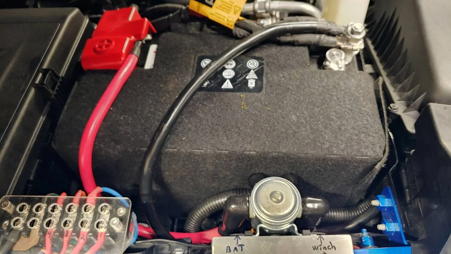

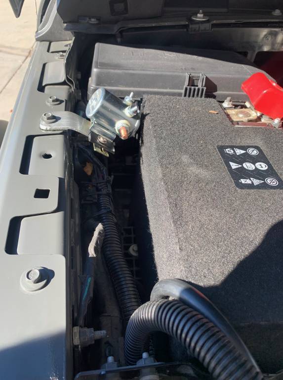

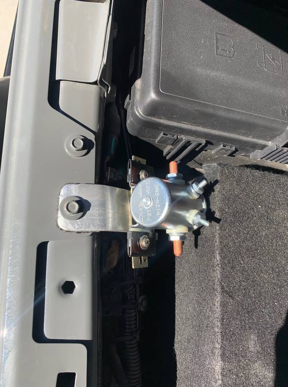

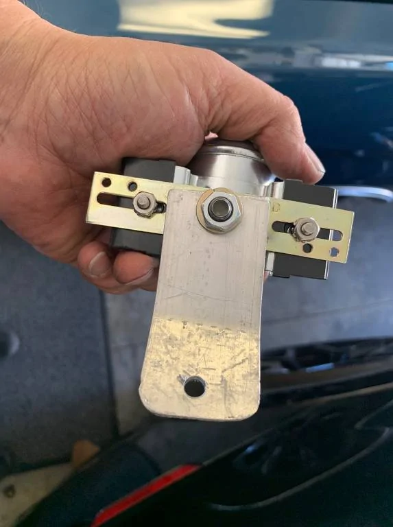

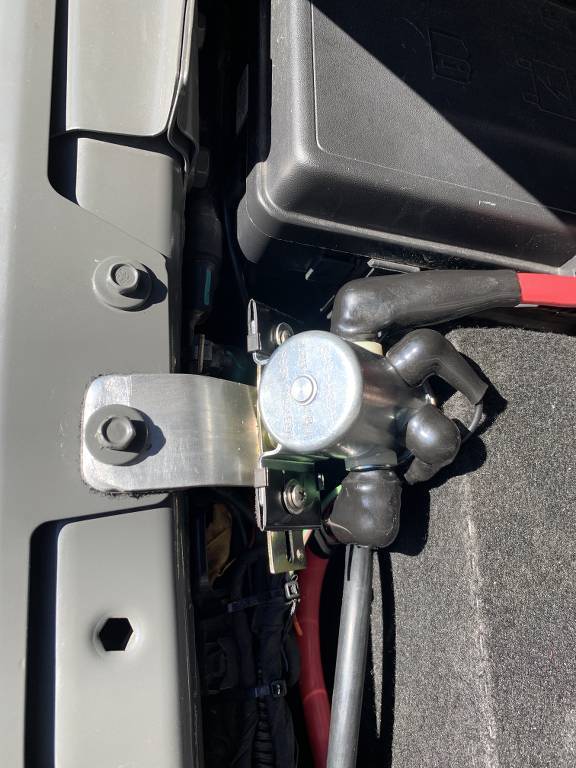

The winch heavy duty power cables should be routed directly to the battery. The fuse box and relays should not be involved at all... For Safety, To turn off power to the positive cable , there is an WARN 62132 Power Interrupt Kit with Battery Lead, Hardware, Solenoid, Switch and Wiring... Instead of wiring a new switch you can just use your aux switches in the cab like I do to switch off the power at the solenoid. This is for safety, incase of an accident, you do not have a long power cable arcing on the frame possibly causing a fire. The aux switch hookup is right next to where I mounted the Solenoid, so, it makes it super easy to hook up... Note: I put some fuzzy velcro padding under the bracket to avoid scuffing the paint. Here are a couple of pics:
