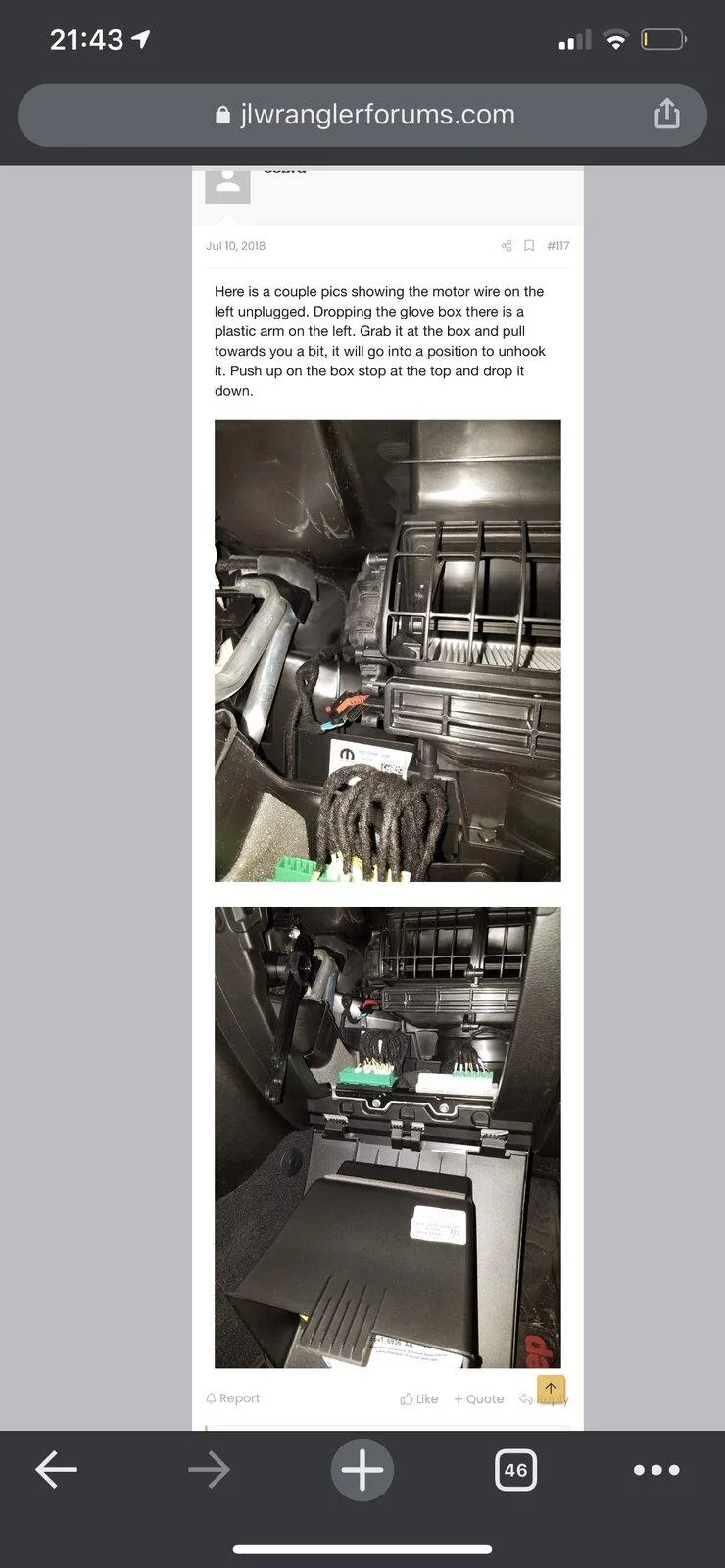

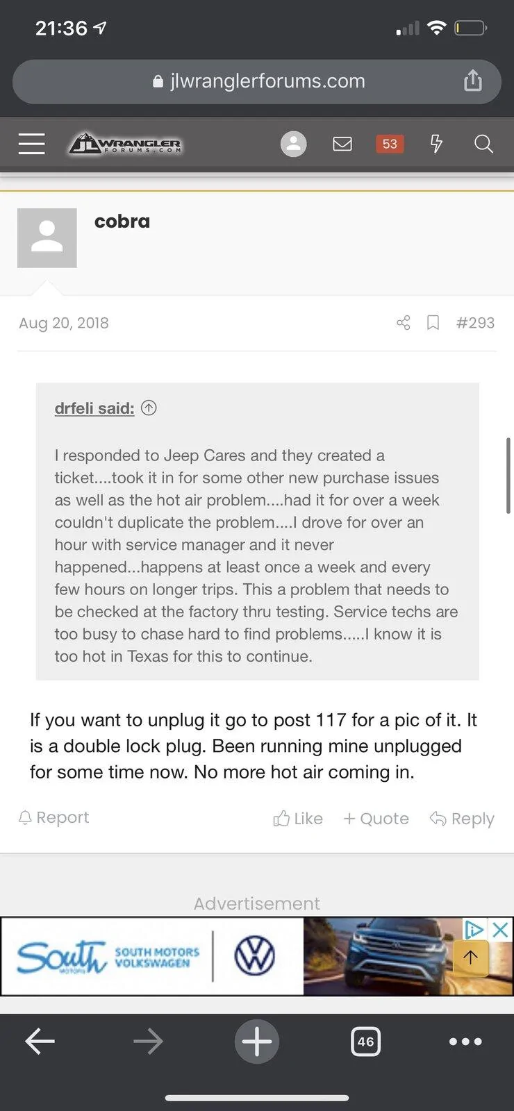

Yeah I have felt that too. i think the evaporator may be on the small side and to keep from freezing up they run hot air over sometimes.
Found this “fix” on the JL forms
