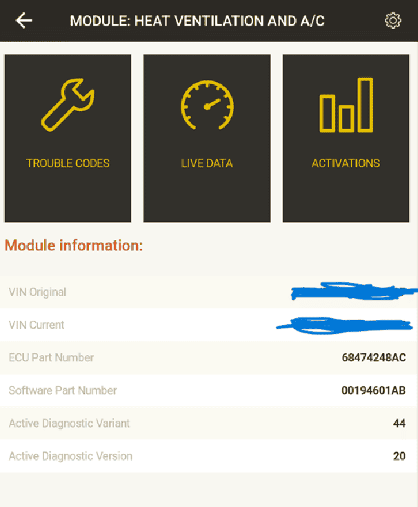

Anyone who had the 24-007-21 update have a OBD adapter and Jscan or another app, and could check the software version of the module? My dealer says they did the update but there was no change in my HVAC module versions.
Jeep Gladiator A/C, sudden burst of warm air? 2023-04-02 10_12_35-2023-04-02 10_05_10-.png ‎- Photos
