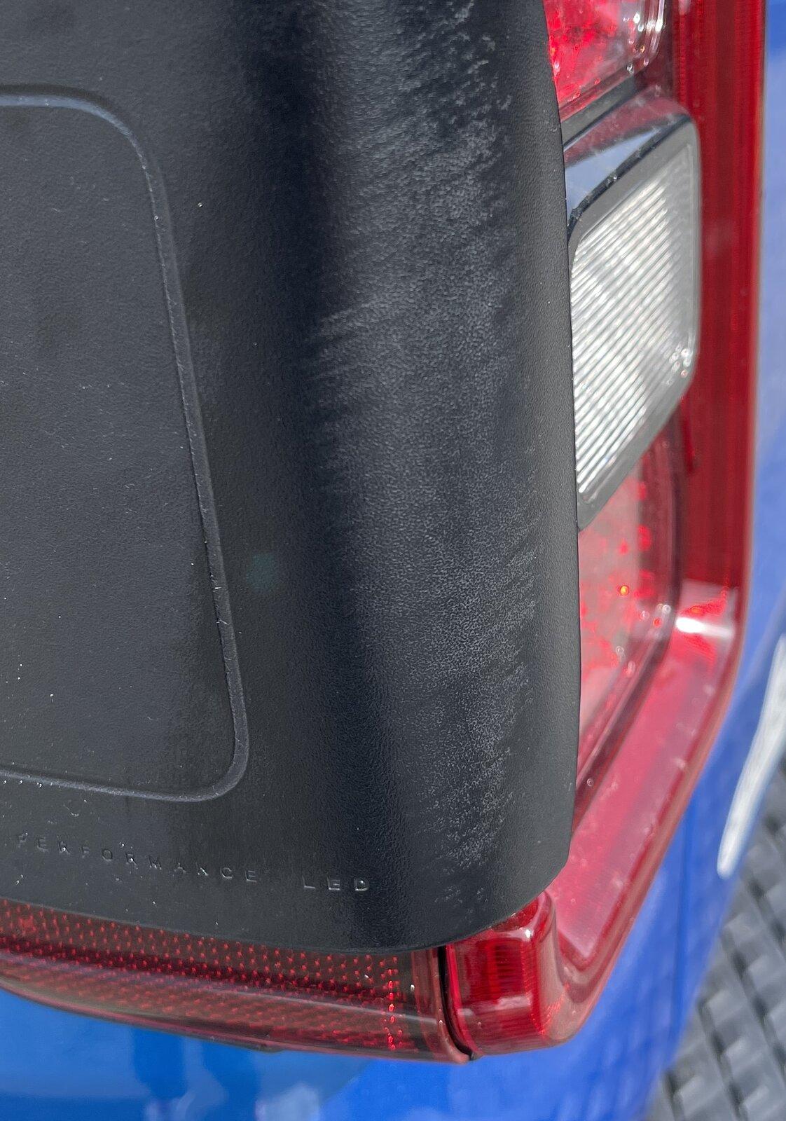

Someone hit-and-ran our less-than-two-week old Gladiator. Just very minor cosmetic damage, but damage nonetheless.
Any recommendations for removing or covering this scuff from the plastic on the taillight? It's pretty shallow.
Jeep Gladiator Removal of Scuffs On Left-Rear Taillight + Left-Rear Bumper 2021-06-01 16.06.46

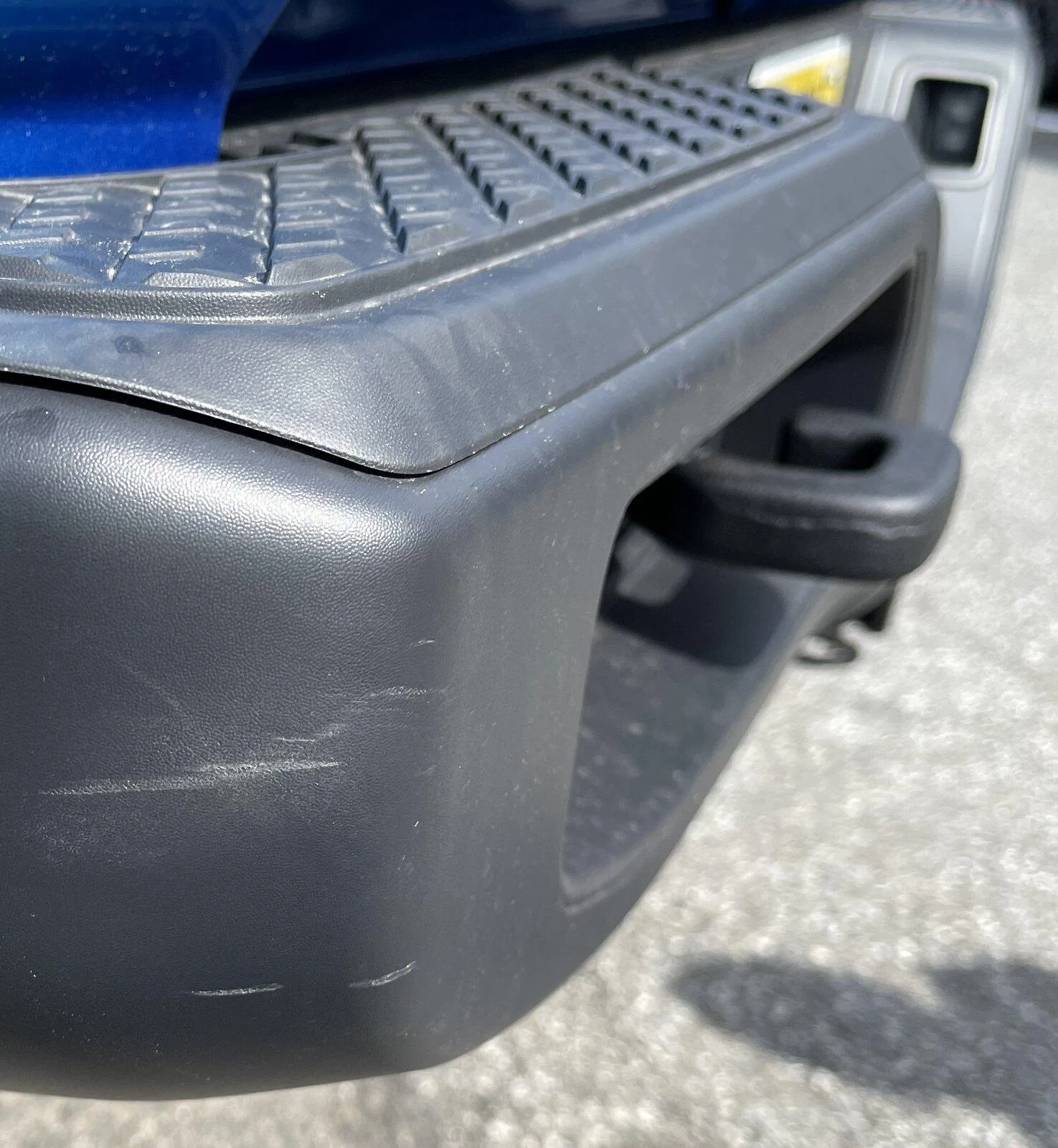

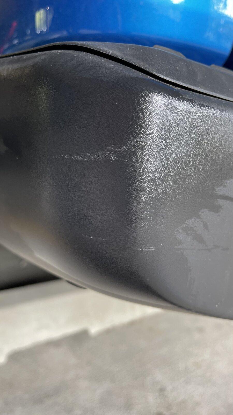

And the corner of the bumper sustained a some deeper scratches, but still not super deep; same question as above:
Jeep Gladiator Removal of Scuffs On Left-Rear Taillight + Left-Rear Bumper 2021-06-01 16.06.49

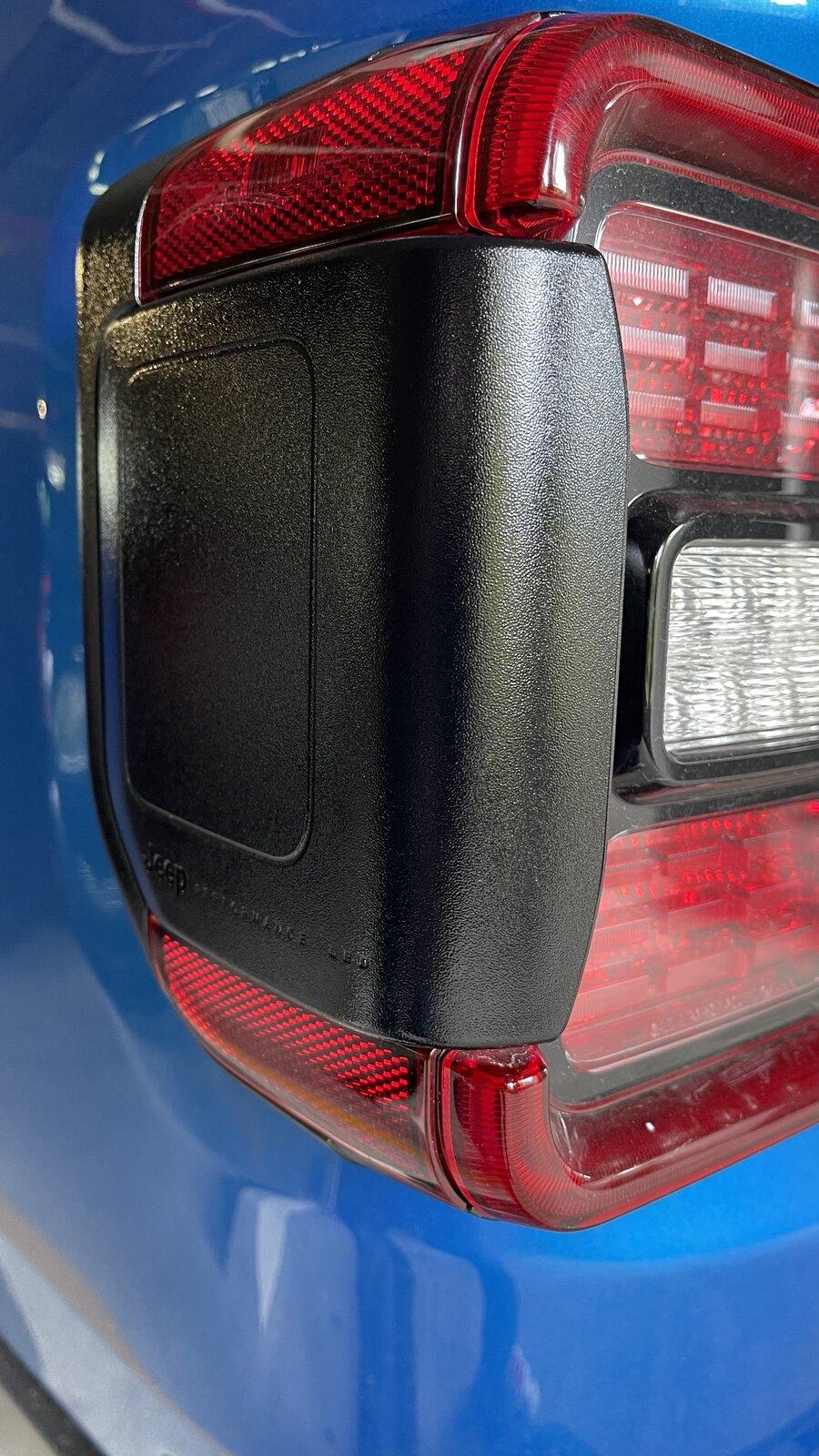

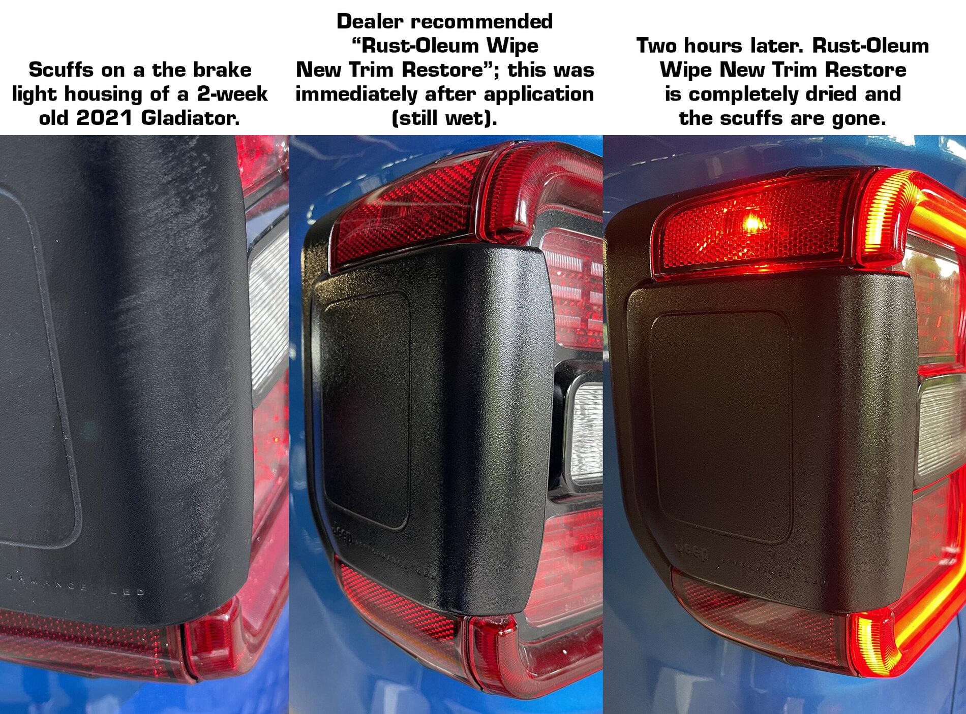

So, these are the immediate results with the Rust-Oleum Wipe New Trim Restore. I'll take more photos again in a few hours when it's fully dried. Appears to have worked on the scuffs on the brake light and bumper's corner, but not the scratches themselves (wasn't expecting it to) on the bumper's corner.
Brake light:
Jeep Gladiator Removal of Scuffs On Left-Rear Taillight + Left-Rear Bumper 2021-07-29 10.46.39
Bumper's corner:
Jeep Gladiator Removal of Scuffs On Left-Rear Taillight + Left-Rear Bumper 2021-07-29 10.46.36

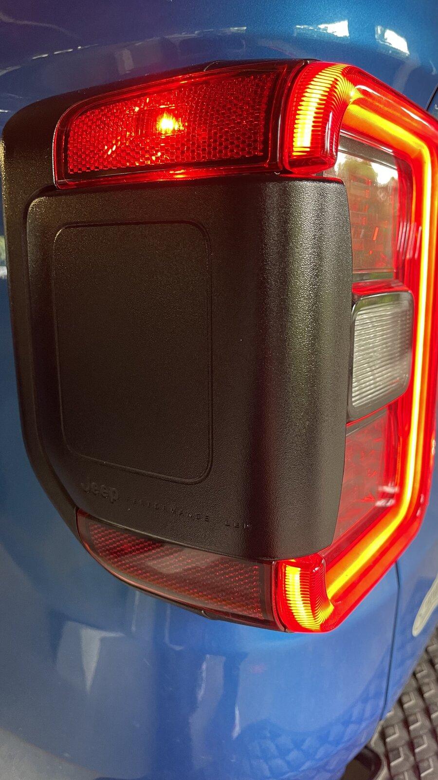

No change in the bottom (scratches still there, obviously), but the scuffs on the brake light are gone. The Rust-Oleum is completely dry now:
Jeep Gladiator Removal of Scuffs On Left-Rear Taillight + Left-Rear Bumper 03-dry
