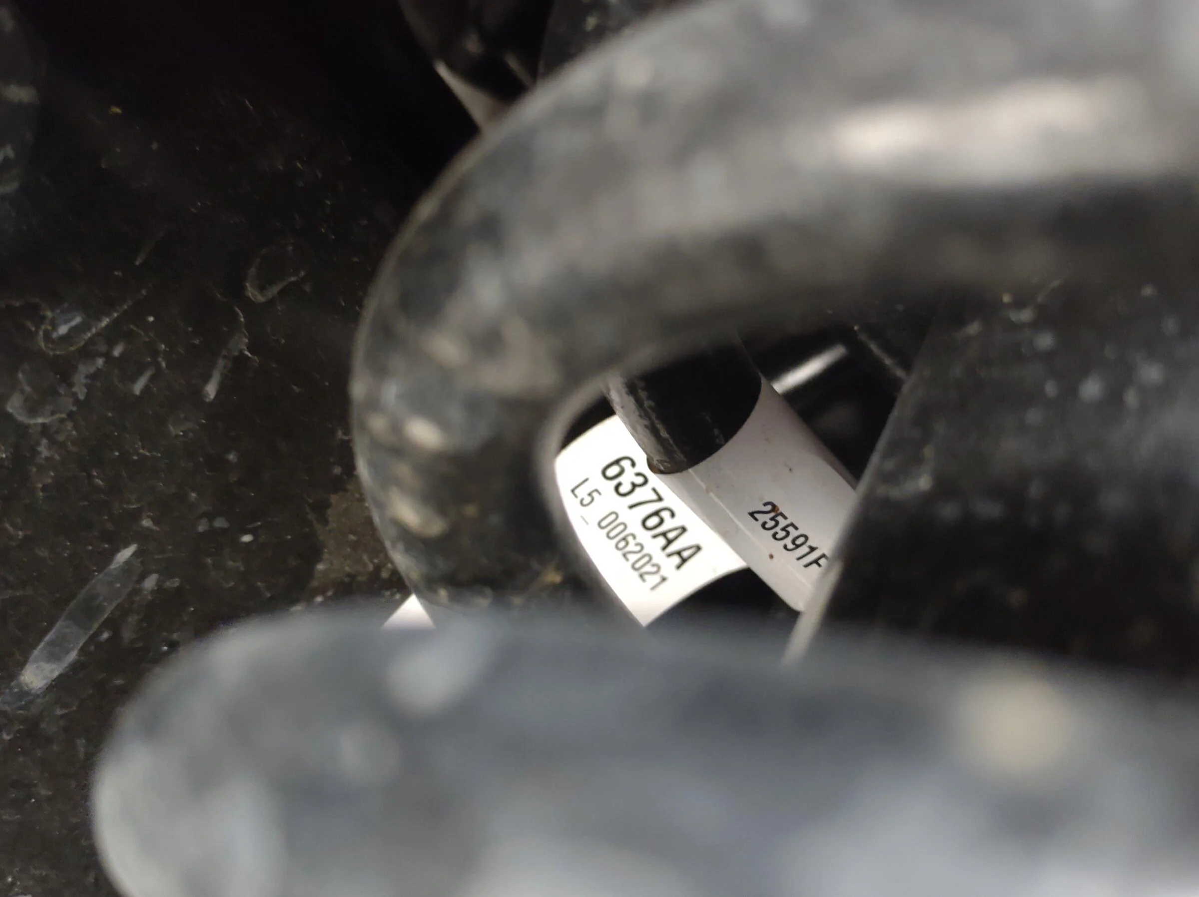

What's odd is that my truck has the same part numbers left and right. 377AA in the front, for example, but on both sides. I've never seen that before on a Jeep until I got this one.
It rides amazing. Much nicer ride than my old Max Tow.
Mine has different numbers. But they are the same on both sides. Sport S Ecodiesel.
Jeep Gladiator Rubicon Diesel Springs on Sport S IMG_20211115_125958571
