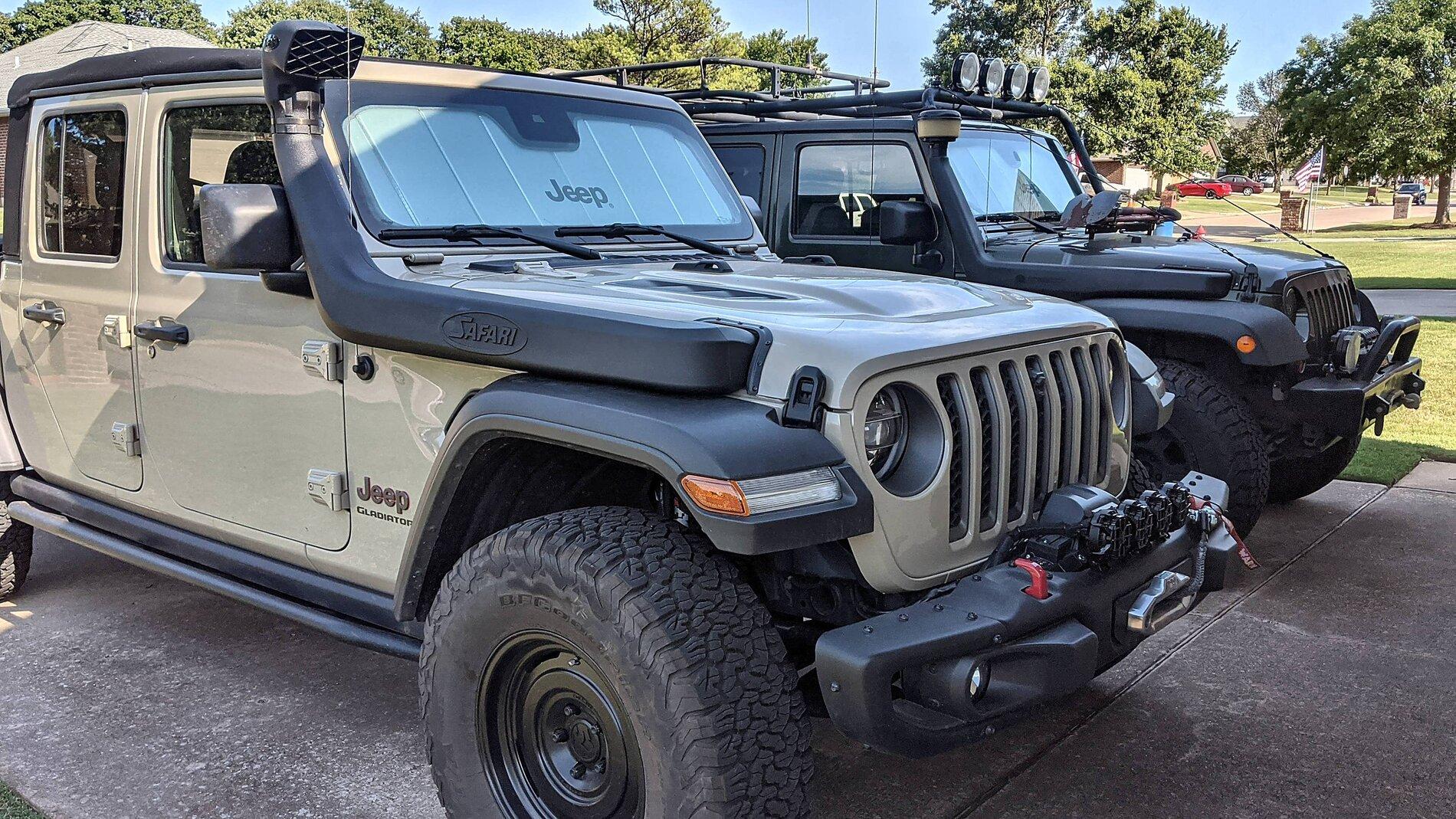

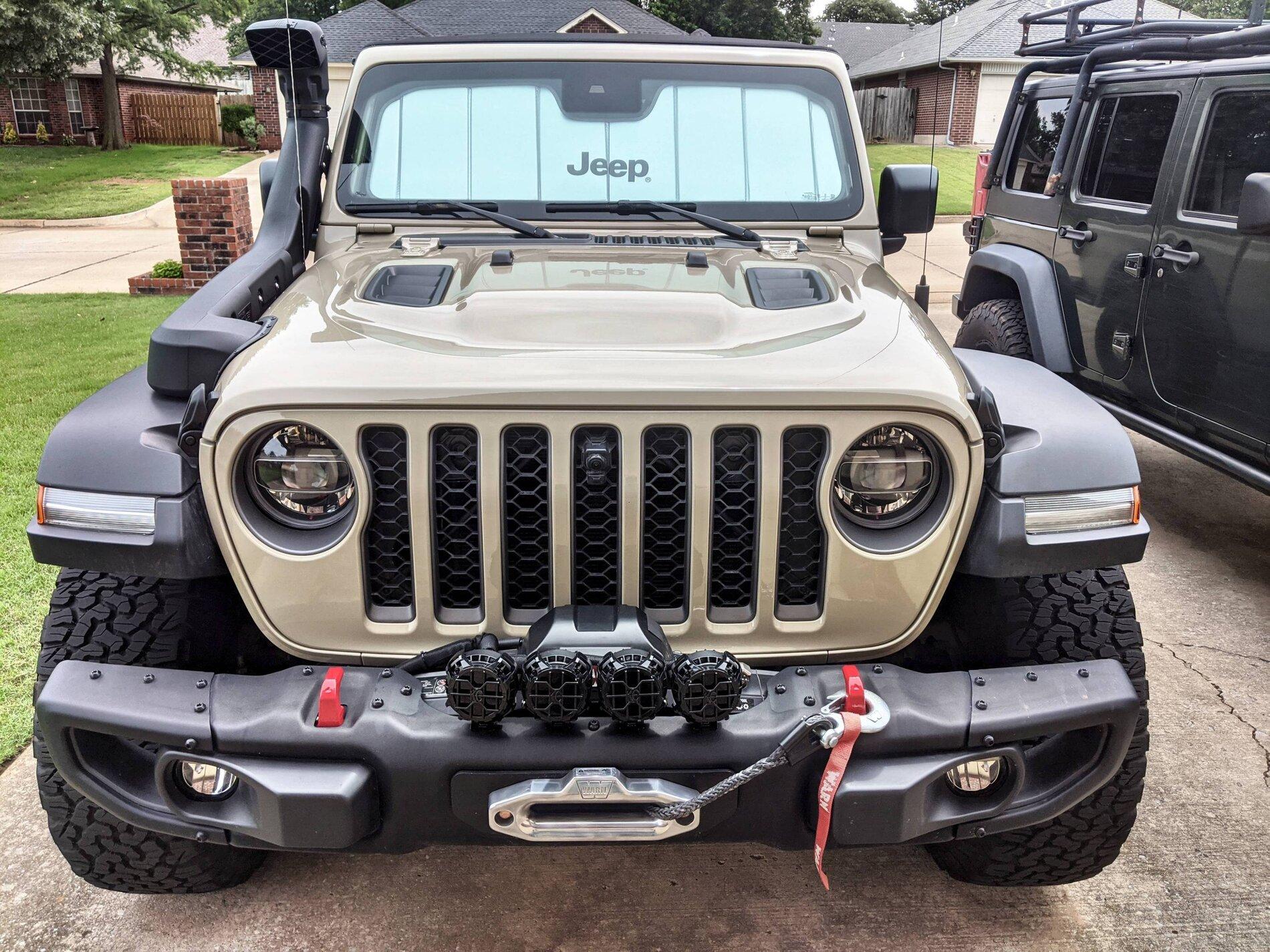

I opted for a Warn Zeon 10-S. A 10,000 pound winch is sufficient for the Gladiator (5,000 pounds curb weight doubled to 10,000 pounds is the common rule of thumb). The advantage with the 12,000 pound is, you can pull yourself out along with a trailer. If that's not your use case, then disadvantages of an oversized winch are slower pull rate and shorter winchline. The extra twenty feet of a typical 10,000 pound winch may not seem like much, but you can use up line quickly if you need to toss a snatch block into the rigging. And adding an extension in that event can get tricky since the joint won't pass through the snatch block.
Your other consideration is the winch mounting plate. I bought mine from Rock Hard. There are many other options for the OEM steel bumper.
Here's what my Jeep looks like with the factory bumper, Warn EVO 10S winch and (hidden) Rock Hard winch mounting plate ...
Jeep Gladiator Rubicon/Gladiator Winch? Gladiator, Jun 20, CP_171435, 12 Hours After Start
Jeep Gladiator Rubicon/Gladiator Winch? Gladiator, Jun 20, CP_114908, Gladiator Front View
