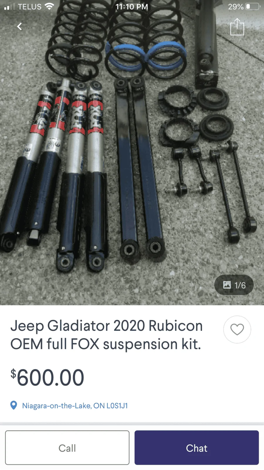

Hello all , I have a sport with dealer installed rubicon rims and at3s . I have been seeing the rubicon suspension coming up on Kijiji and I am wondering your thoughts on if it’s a good deal . I would be putting 35s on and likely a 1.5 front and 3/4 rear spacer . I’m not looking to do any hardcore wheeling just logging roads etc . The seller from the pic is asking 600 CDN but I may be able to get it for less . Looks to be a complete kit . Thanks for you help
Jeep Gladiator Rubicon suspension on a sport worth it ? 3D1ECE33-FC08-4A82-898D-753E15A68A0B

Seller has agreed to $400 for all items pictured if that makes a difference to your thoughts . Thanks
40,514
54,041
Only difference is the shocks and springs. All other parts are the same.
You don't need any of the links or control arms or the spring pads, etc. - they are all exactly like what's on your truck now.
IF you have max tow - you'd be losing something going to Rubicon rear springs because the Sport S max tow springs are progressive and handle weight a bit better, but if you don't care about the slight difference, no biggy.
If I was you, I'd use the shocks and simply lift it with the spacers you plan and skip the springs.
I put Rubicon FRONT springs on my Overland because I wanted a less soft and mushy ride and the stiffer springs up front (overland has the softest springs) and I actually put Sport S max tow springs under the back of my OVerland - the Rubicon rear springs are sitting in a box on a shelf.
I guess I should have FIRST asked - what do you want to gain with changing springs? Shocks, yeah, the Fox shocks from a Rubicon would be a notch up - but only for ride and handling. Won't help you off-rode really.
If I had a sport, I'd simply lift it with spacers, level it a bit, and put on Fox shocks.........

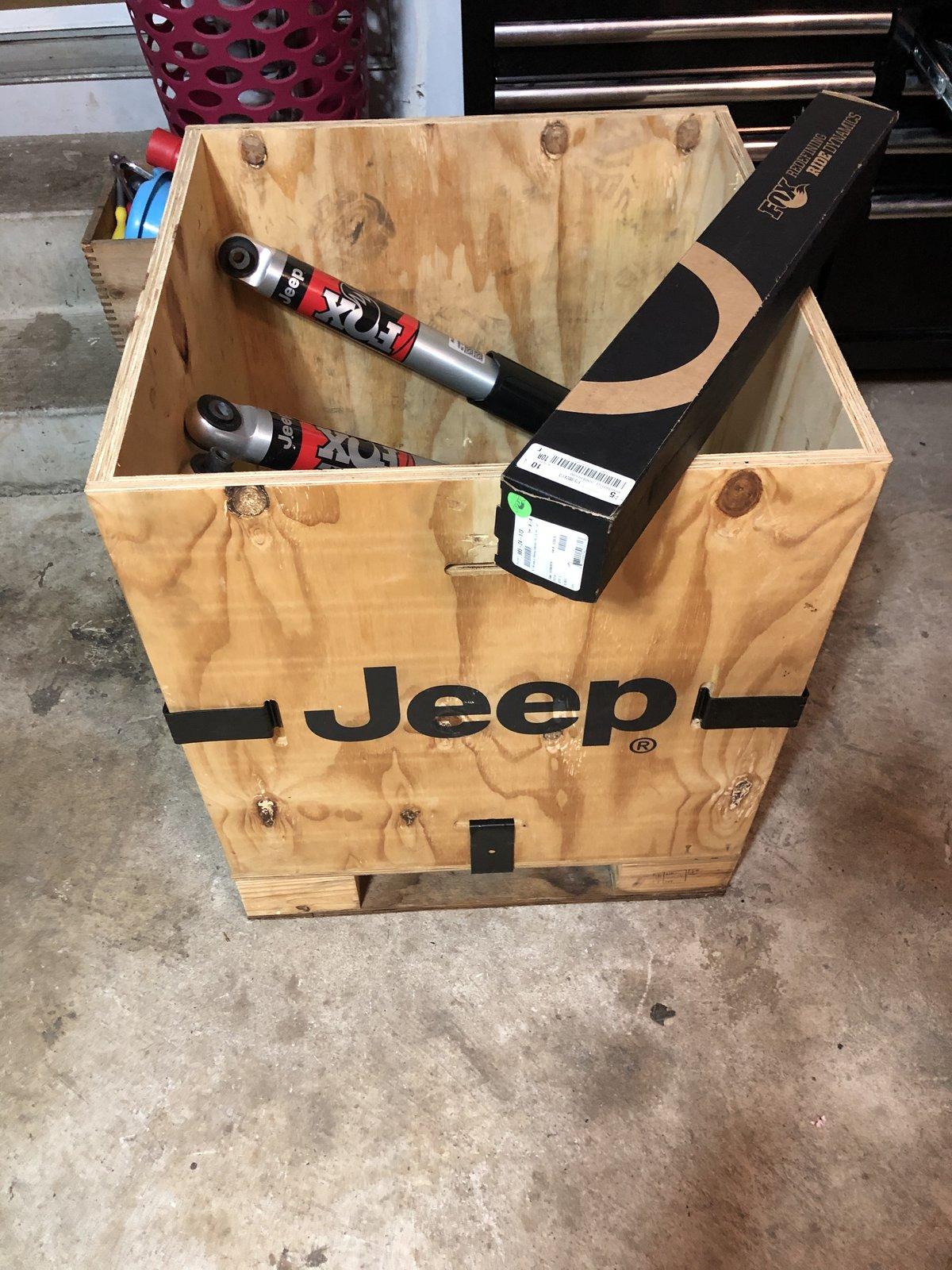

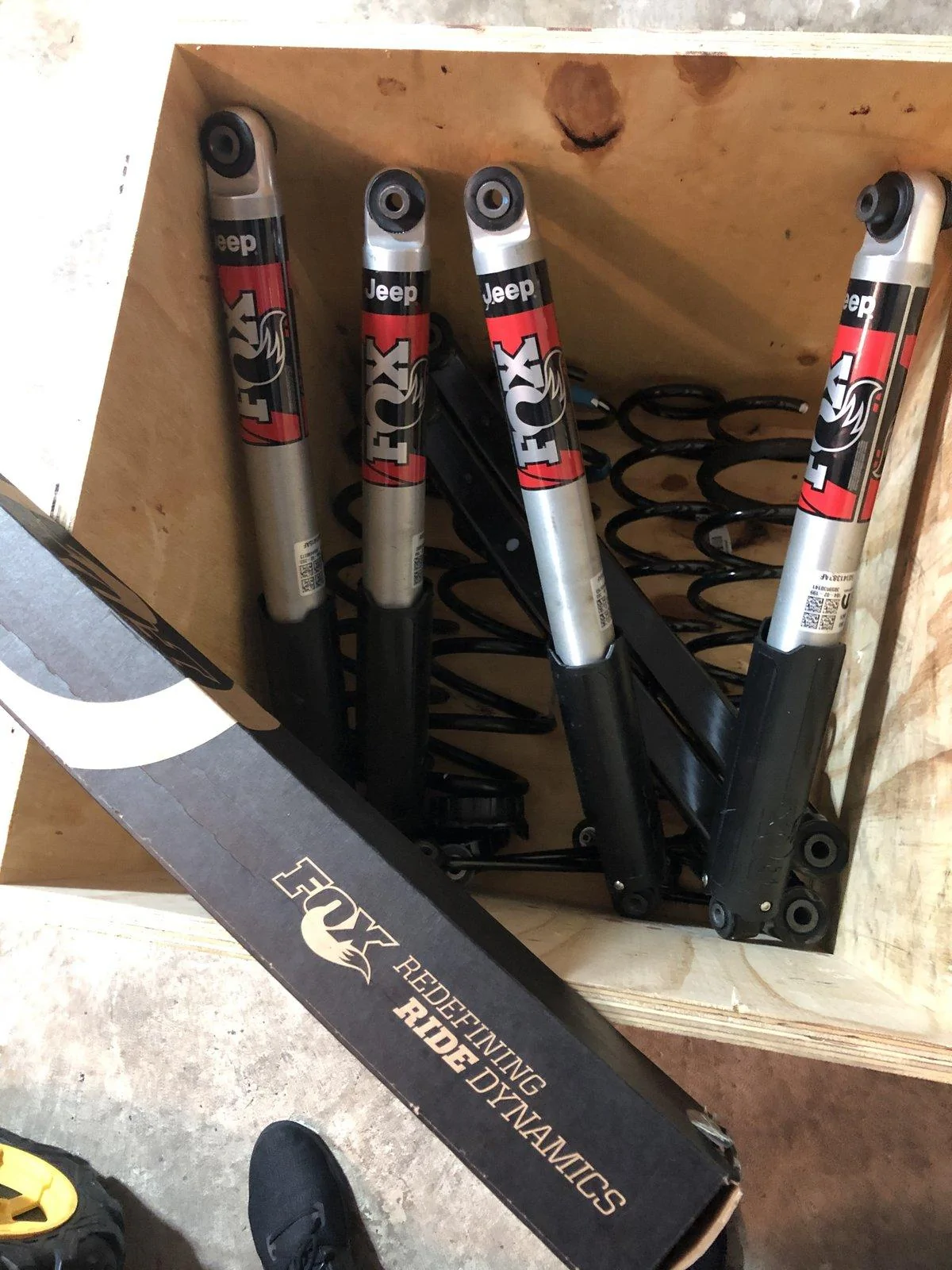

Seller was a great guy and his gladiator was on 39s lol , made mine look like a baby . Crate will be varnished and used as a side table in my bar / pool table area
