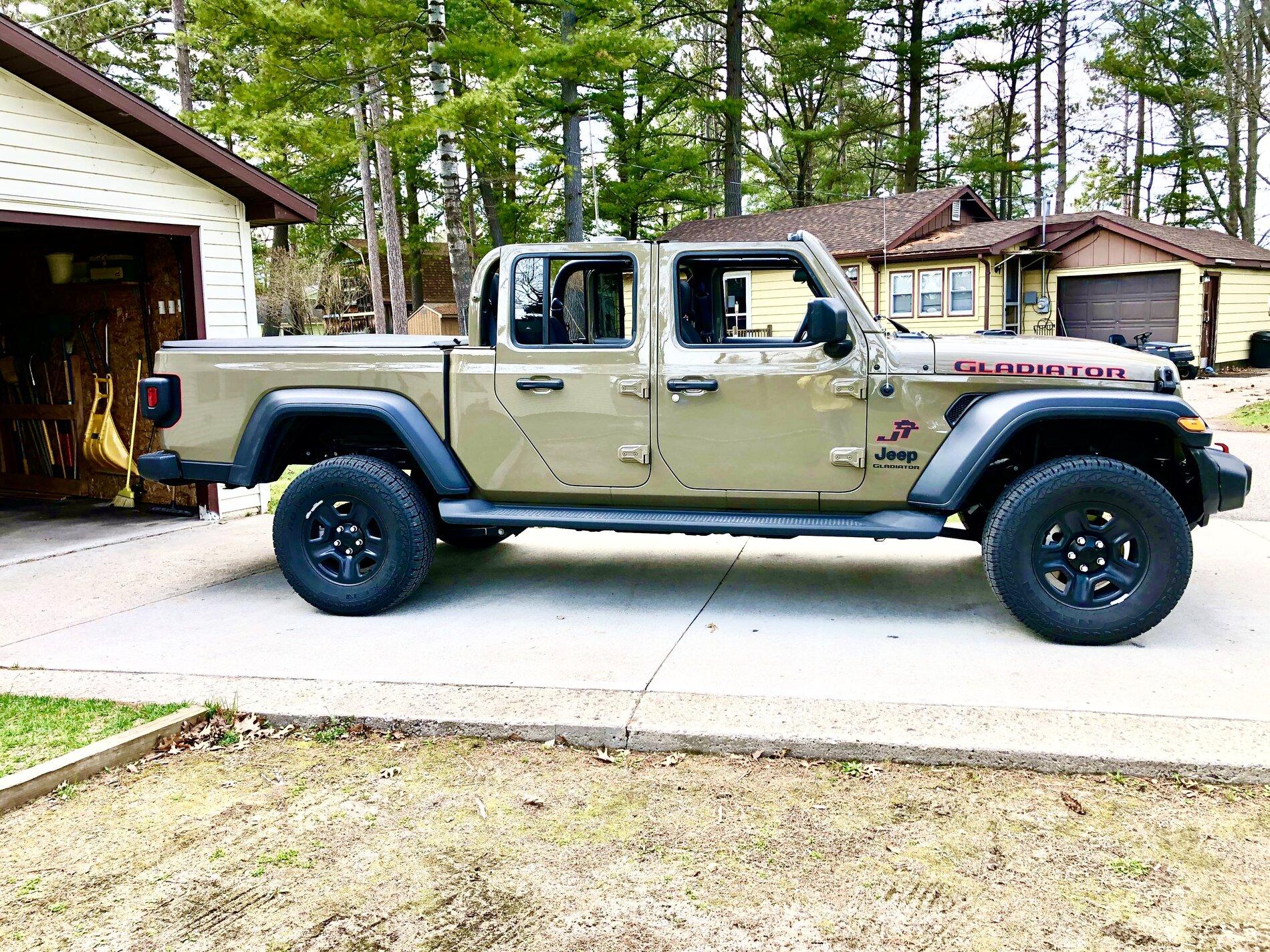

I can tell you from experience with my Iron Rock OffRoad 2” spacer kit. Did not change my ride at all, bolt on and added 285-70-17 raised almost 4”. Easy peezy.

That looks pretty good! Ride quality is about the same?
180
29,483
35,076
Spacer lifts mean you are riding on the exact same springs with the springs in the exact same position of being relaxed or compressed.
The spacers should make no ride difference at all in that respect. (as long as all of the bolts that hold any parts with bushings (control arms, links, track bar, whatever) are loosened and then torqued again once the spacers are in place and the truck on the ground)
Any time springs are replaced or spacers added or removed, anything that changes the curb height of the truck, bolts must be loosened and then torqued once the change is made and the truck is on the ground. Otherwise the bushings are twisted and stressed. So any link, bar, arm, whatever, that has a bushing, those bolts need to be loosened, add the springs or spacers, then set it down and torque those bolts again.

And that was how it was done! Very well stated. đź‘Ť I really like it this way. I did it this way to maintain factory rake for towing. Once torqued back to factory specs same factory ride.
