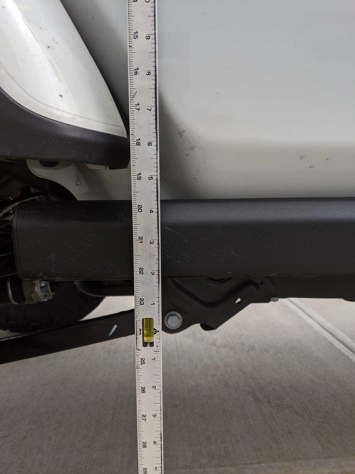

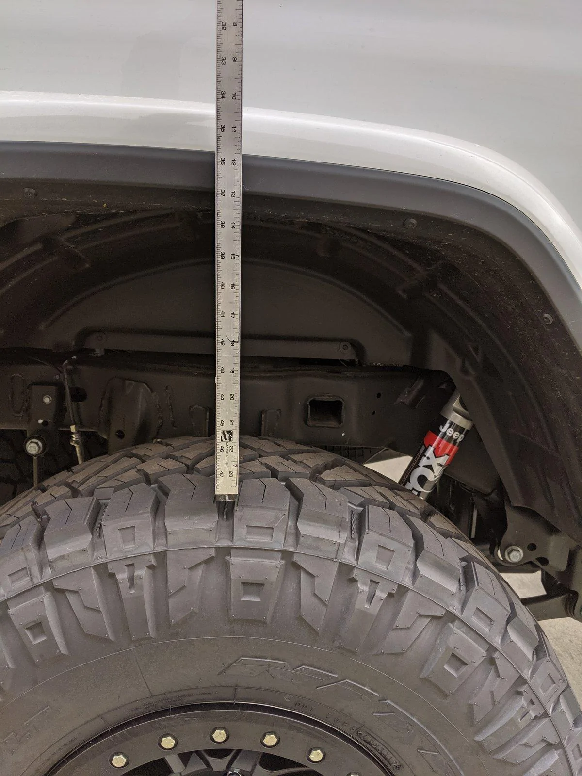

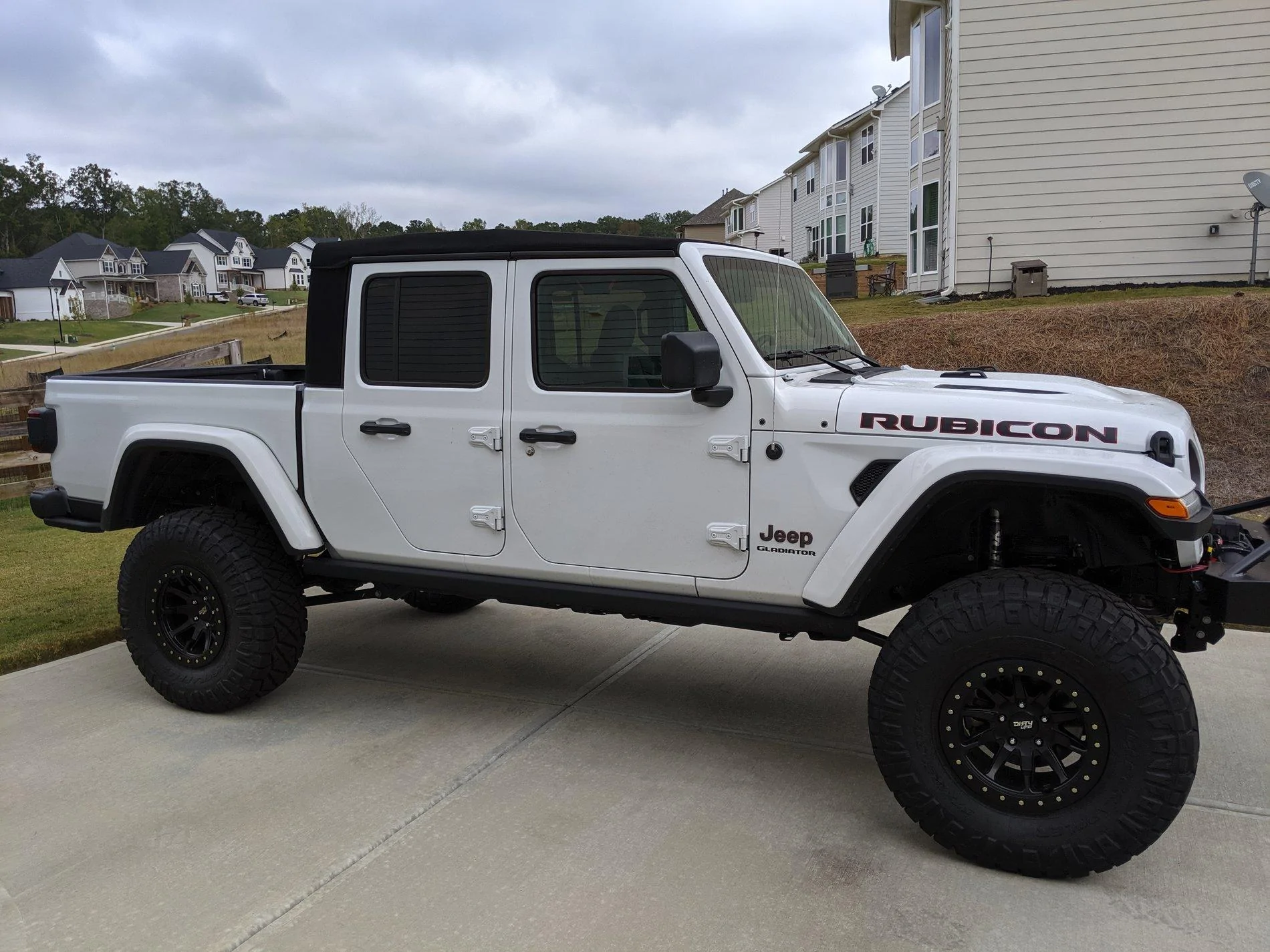

I have the EVO 4.5 3+ kit. I am running Nitro 37s and it sits at 6' 8 3/4" (very tall). From the top of the tire to the front fender there is about 10". I have only had the lift installed for about 500 miles. If I were going to do it again and run 37s I would go with the 2.5" lift. Since I did the 4.5" I am already looking at how to run 40s. This is a daily driver for me and will not be doing much hardcore wheeling.

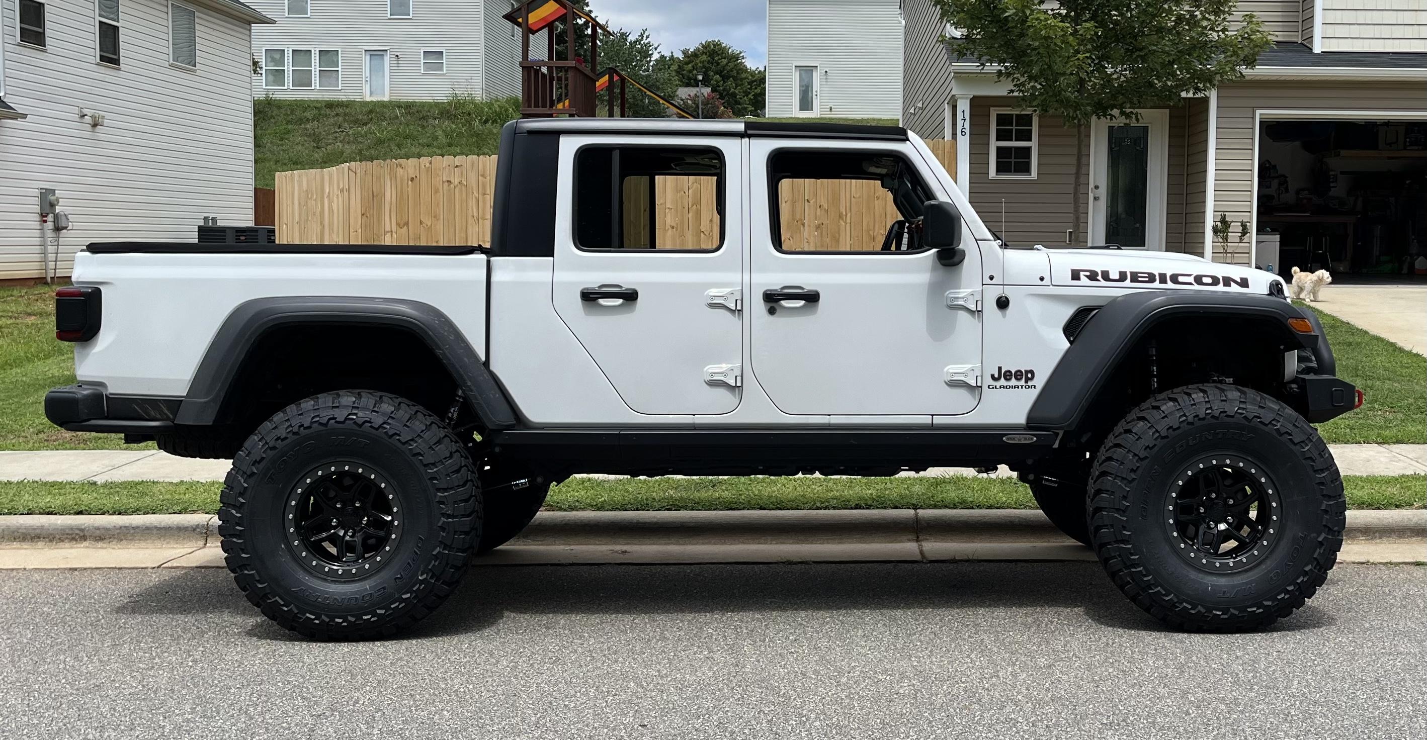

I can’t speak for the 4.5” but I like the 6.5”.
It’s tall but looks awesome.
Do you have problems with your springs sitting correctly? My passenger side bows inward even after using the correction spacers. I've read I need to try removing the spacers back to stock. Alignment and trackbar all dialed in.

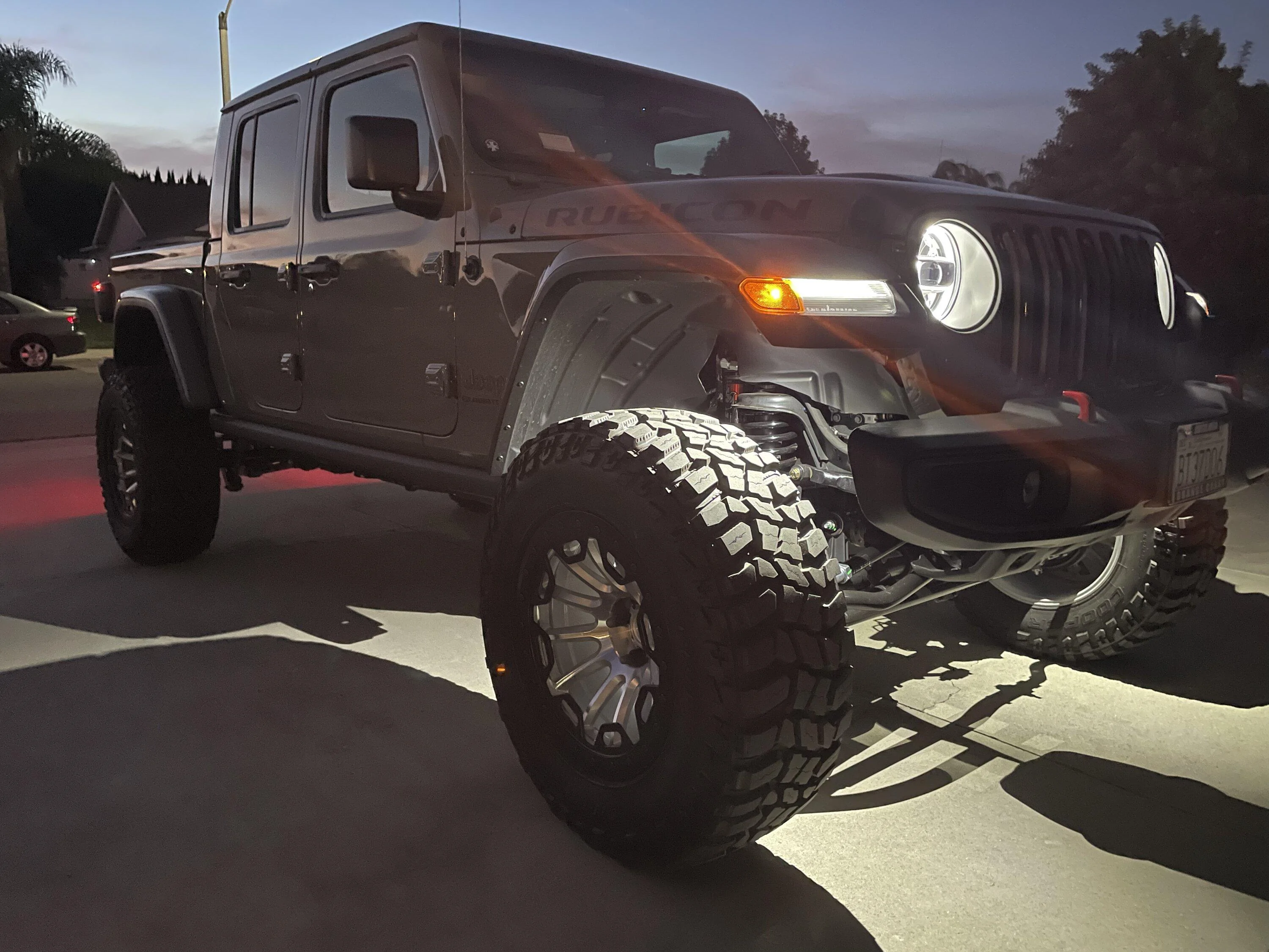

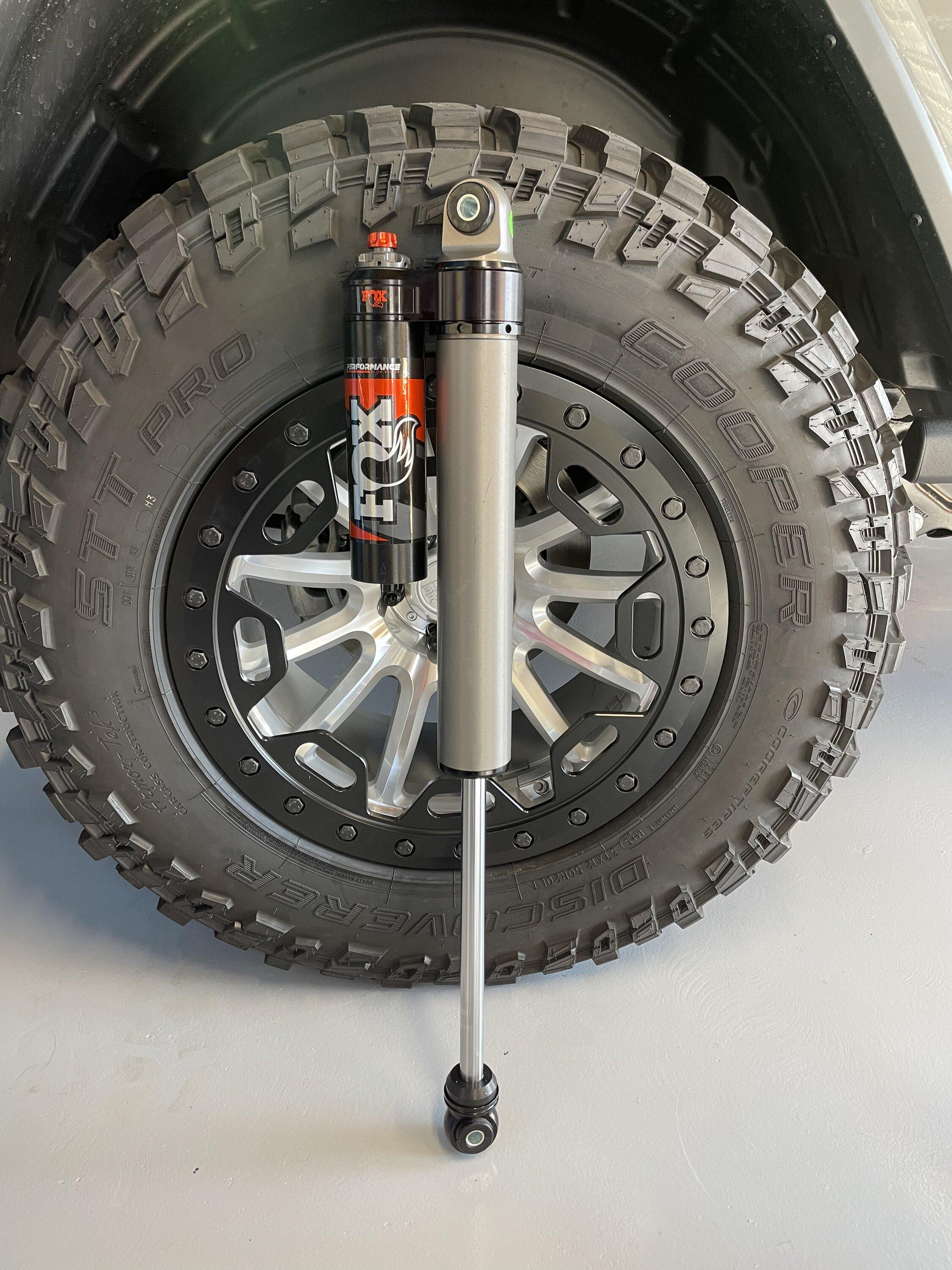

I have the exact set up your contemplating on using. Evo 4.5 overlander 37” pro coopers and fox 2.5 performance elite shocks.
as for the ride amazing! Not a single complaint about it. Off-road use, I’ve had two former jeeps with fab tech and a Mopar lifts. This set up out performs anything I’ve used in the past. Pricey yes, worthy of the cost? I say yes. We all have are preferences this was mine and I’m happy with it.

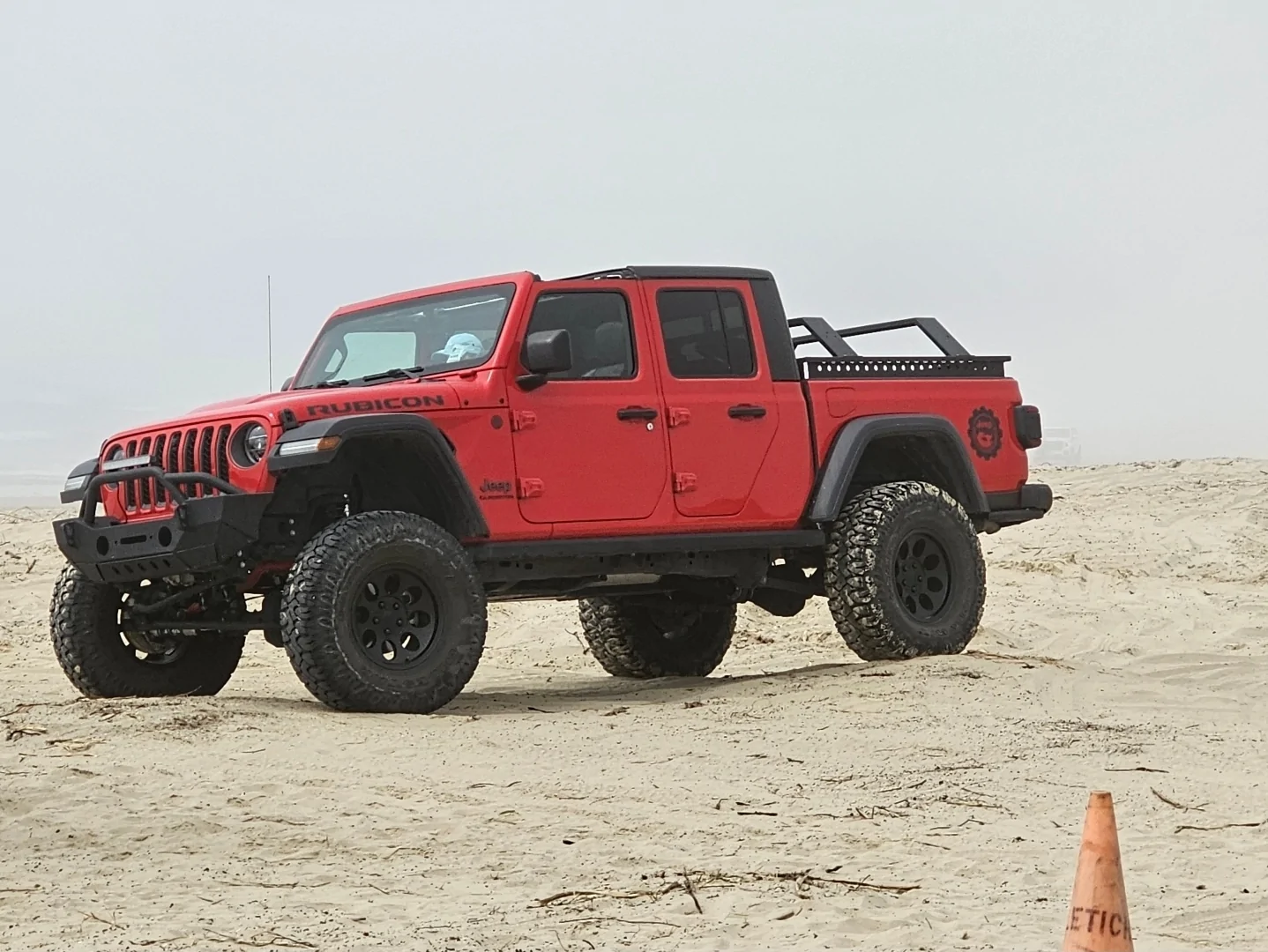

Oceano Dunes

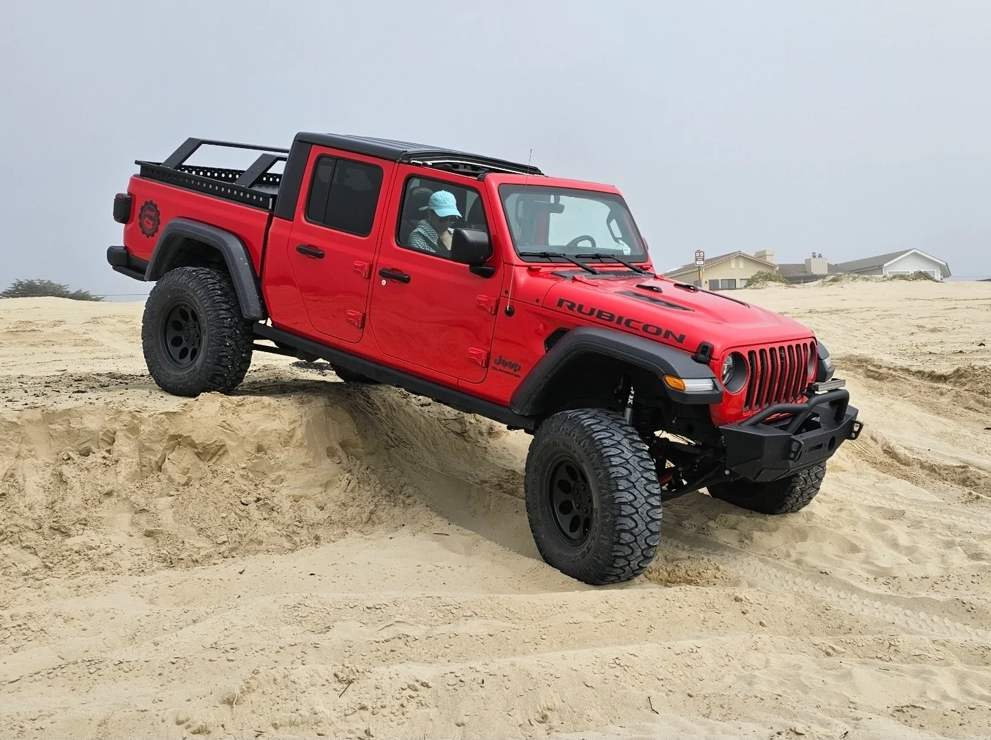

Full extension

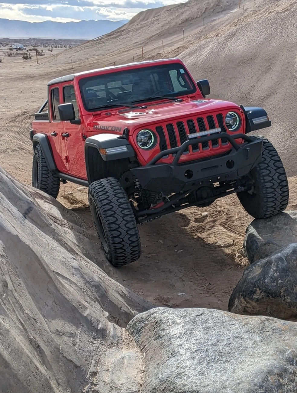

Rear stuff 38s - roughly 1" uptravel clearance with stock flares.
Jeep Gladiator Is 4.5' Evo lift kit worth it? 1000031459

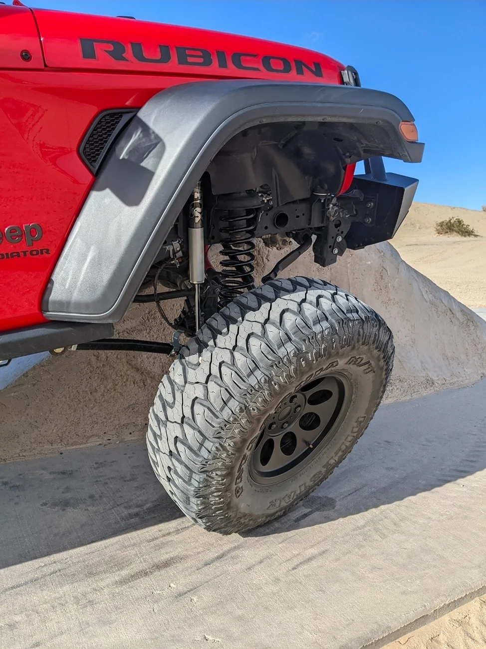

Front full stuff - light fender flare rubbing 38s

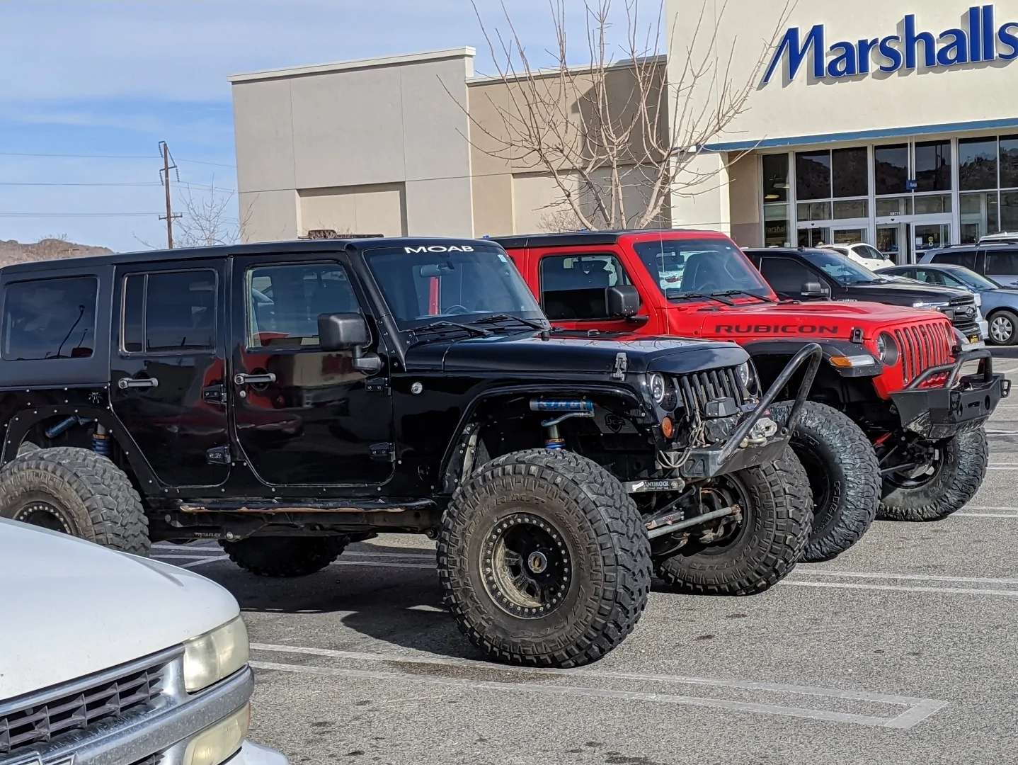

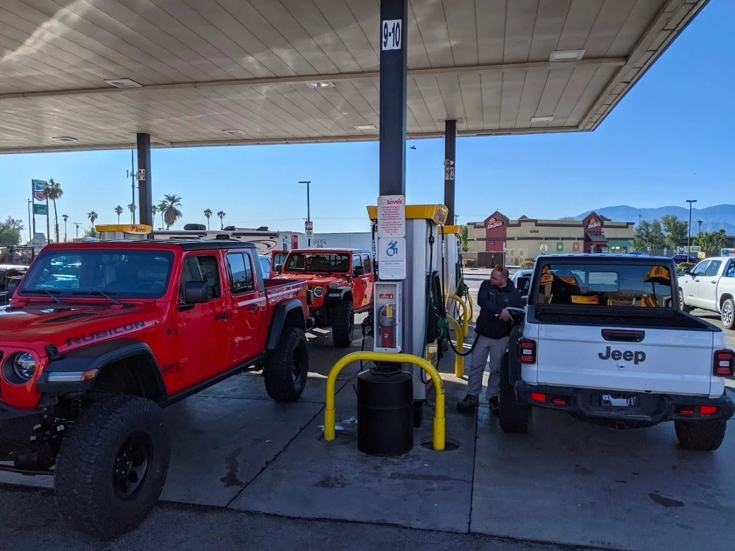

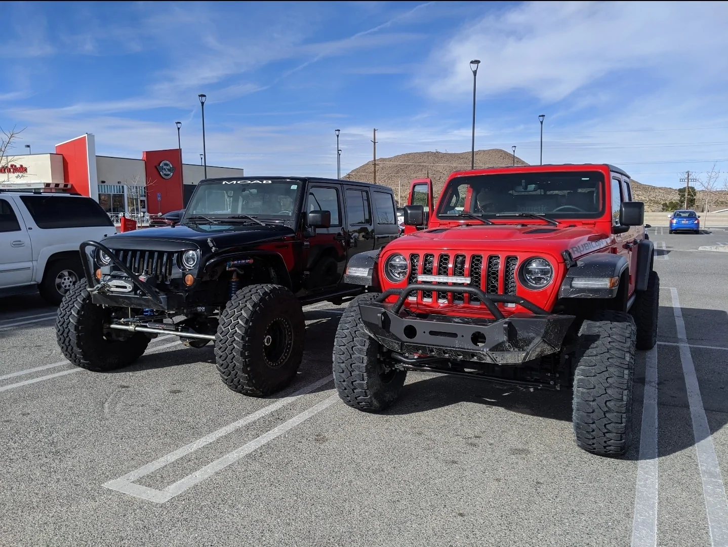

Side comparison next to lifted JK on 40" Trail Grapplers. I could run 40s with just fender modifications, gearing, trussed axles, steel knuckles.

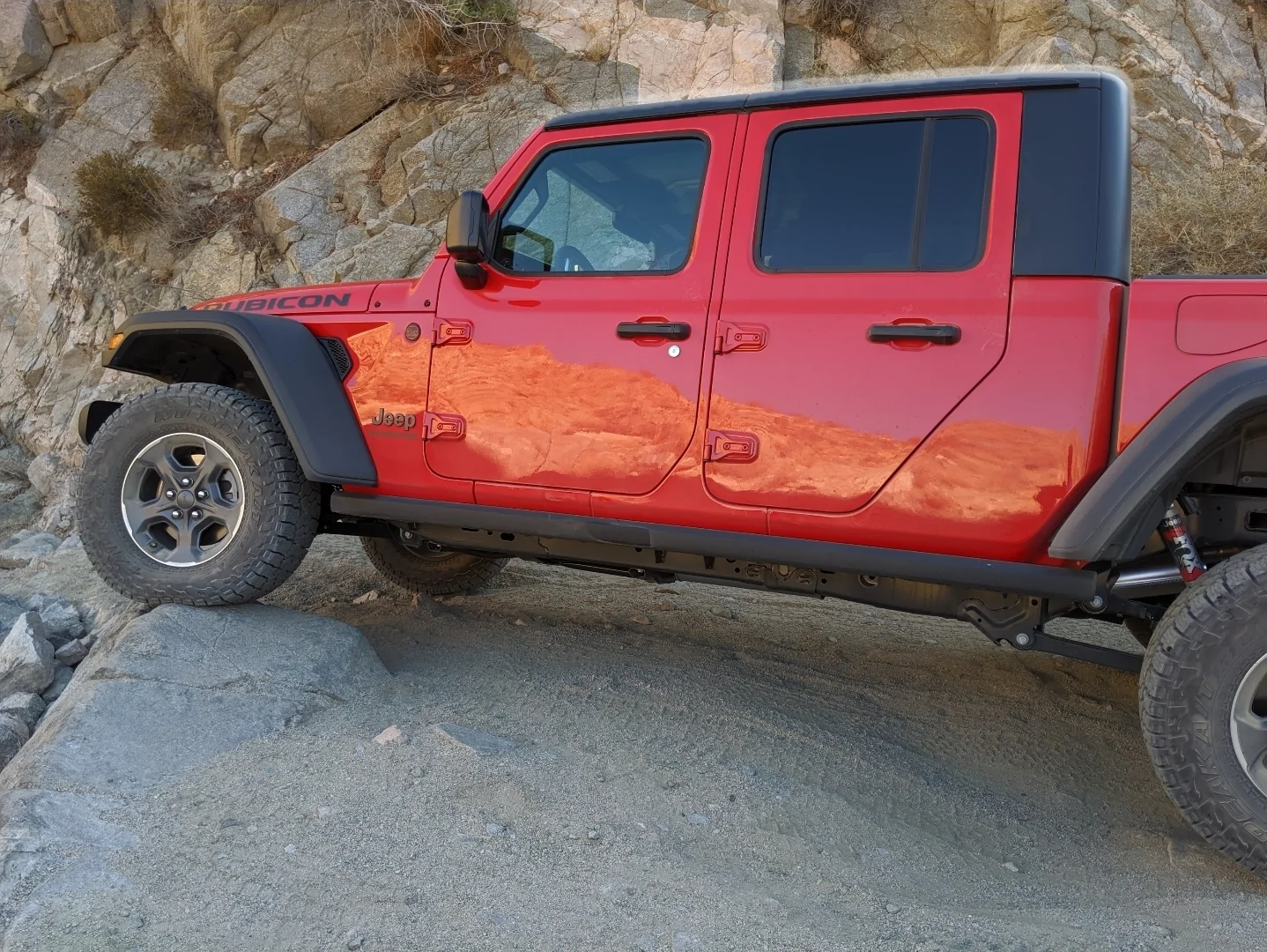

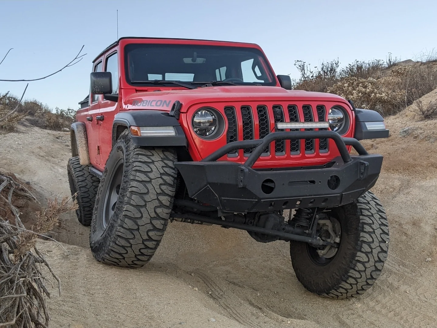

Before - tire placement was important going down this small outcropping on Berdoo Canyon Road.
Jeep Gladiator Is 4.5' Evo lift kit worth it? 1000031439

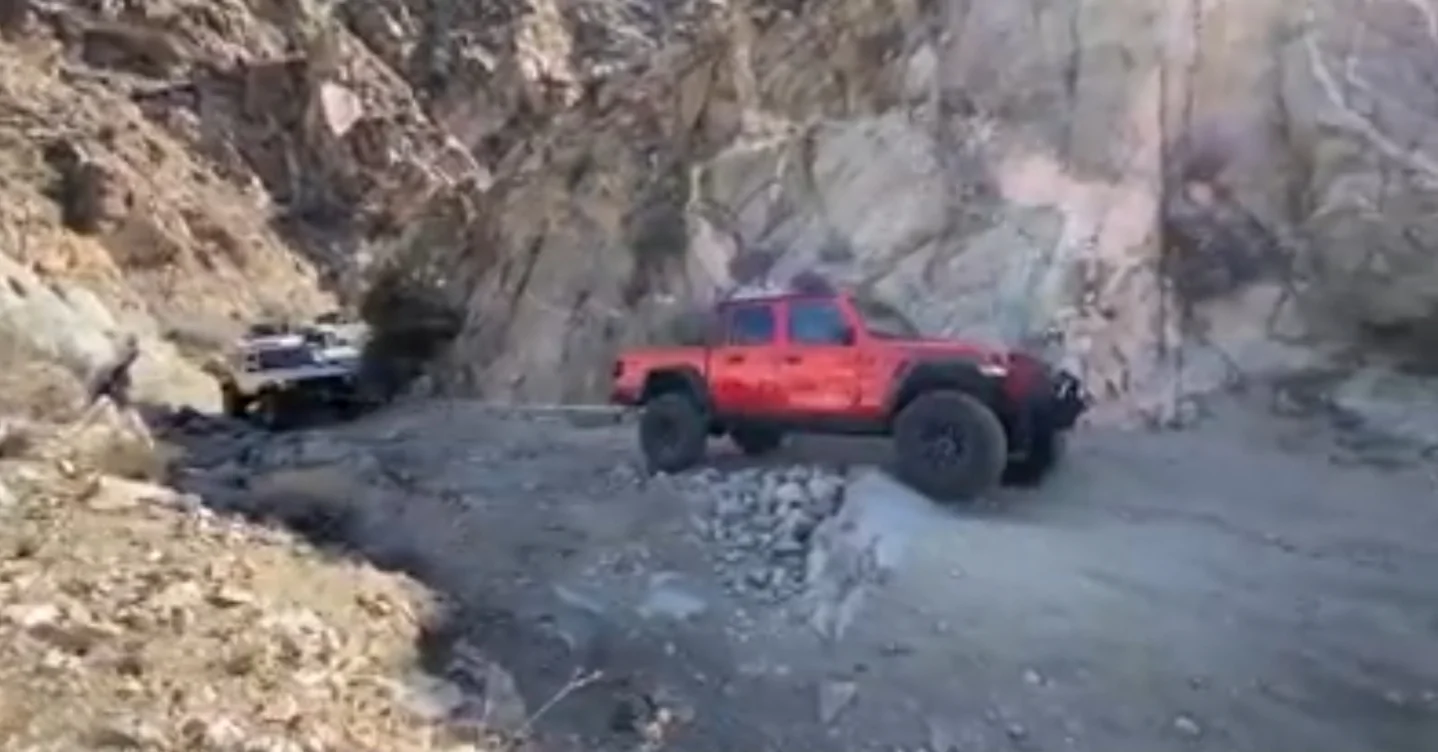

Same outcropping traveling in the opposite direction while towing overheated XJ - NO PROBLEM!!
Jeep Gladiator Is 4.5' Evo lift kit worth it? 1000031443
I'm obviously taller than the 1.5", 2.5" and 3" lifted Gladiators, but I love what my Gladiator can do - while still fitting inside of my garage each night.

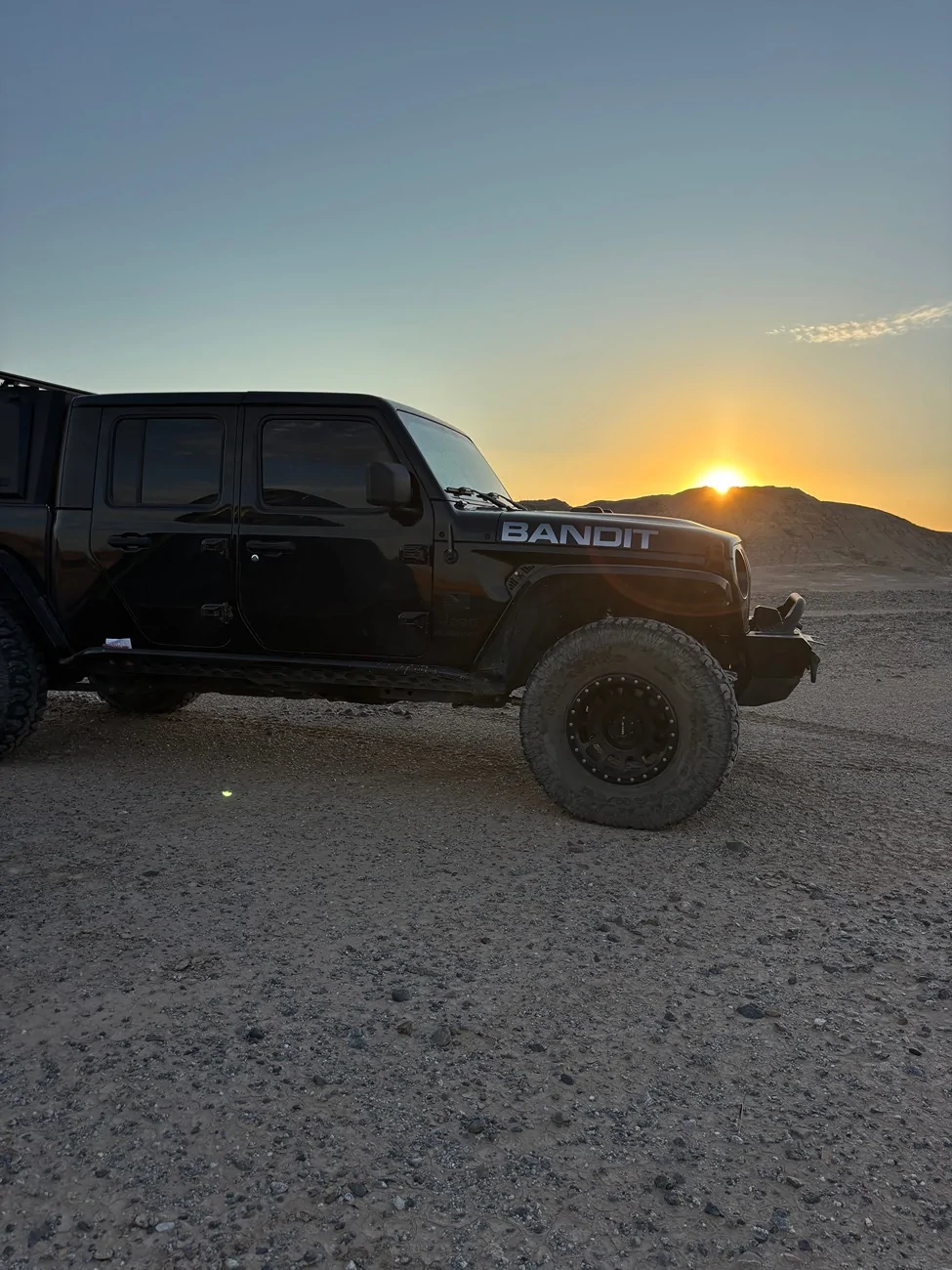

Agreed. Depends on what and where you wheel but the longer rigs have issues with the break over. I remember wheeling the LJ with the stock skids and it truly was a “shovel”. Crest over a dune and you’re going nowhere. Sucker dug in every time. Rocks it did ok. Sand it was horrible.
Side note: they don’t do “Belly up” stuff for these anymore. Glad Jeep addressed that issue.
