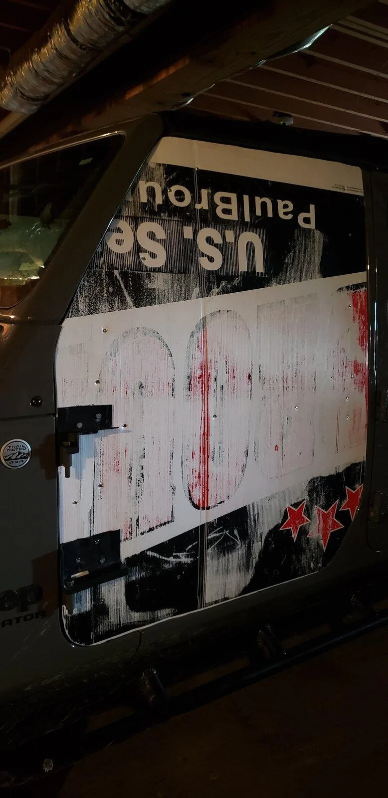

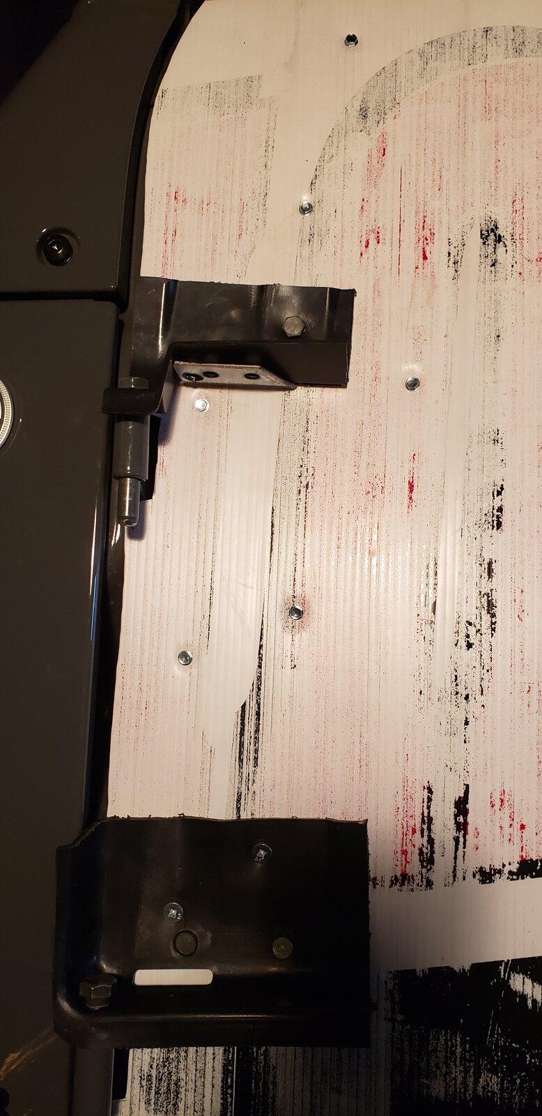

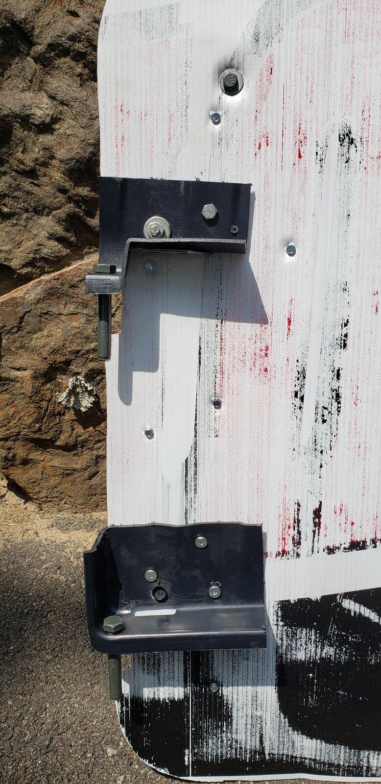

Today I basically finished the driver door. Tomorrow I have 4 hrs in truck cross country(55-60mph) so it'll be a good test. Still using the hook system when leaving just to keep door closed but looped a piece of velcro I had behind the frame(once inside stick one end through latch point and then back to itself), works great but still kinda finicky to latch(may revisit in future).
Jeep Gladiator Soft door build 20210827_194248
I also used small metal corner pieces I had to strengthen the corners(really surprised at well they worked).

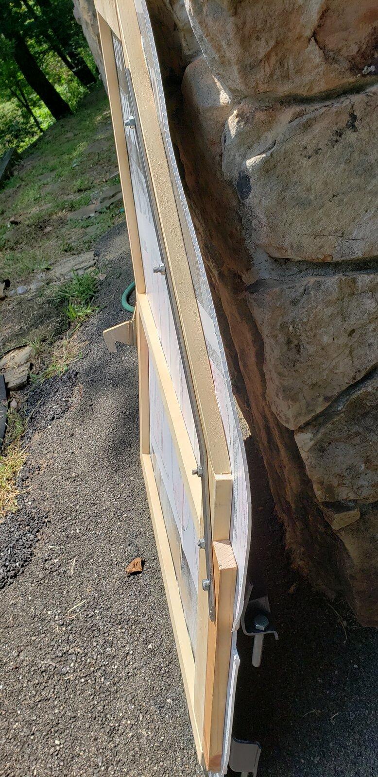

For weatherstripping I used one piece of house 3/4" foam at front(stuck to body as it isn't a place the real door seals to and the door's front pushes into it). And for the door I chanced a Z-shape weatherstripping I bought off ebay(search z-shaped 26' ). I was unsure it would stick but so far its exceeded expectations. It did require trimming the door and beveled it(thinner inside to out).

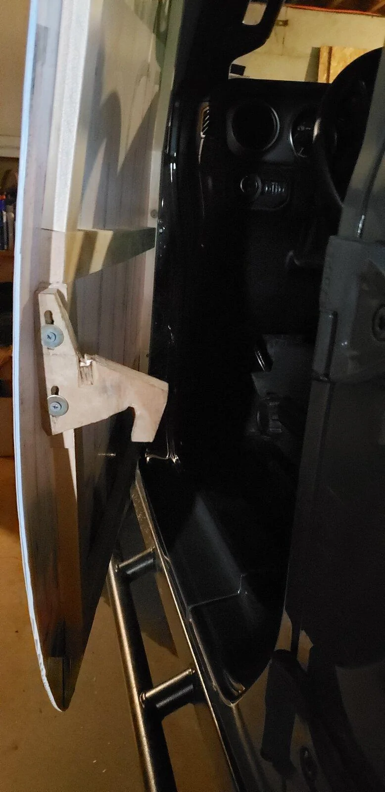

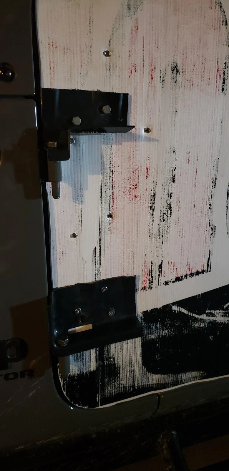

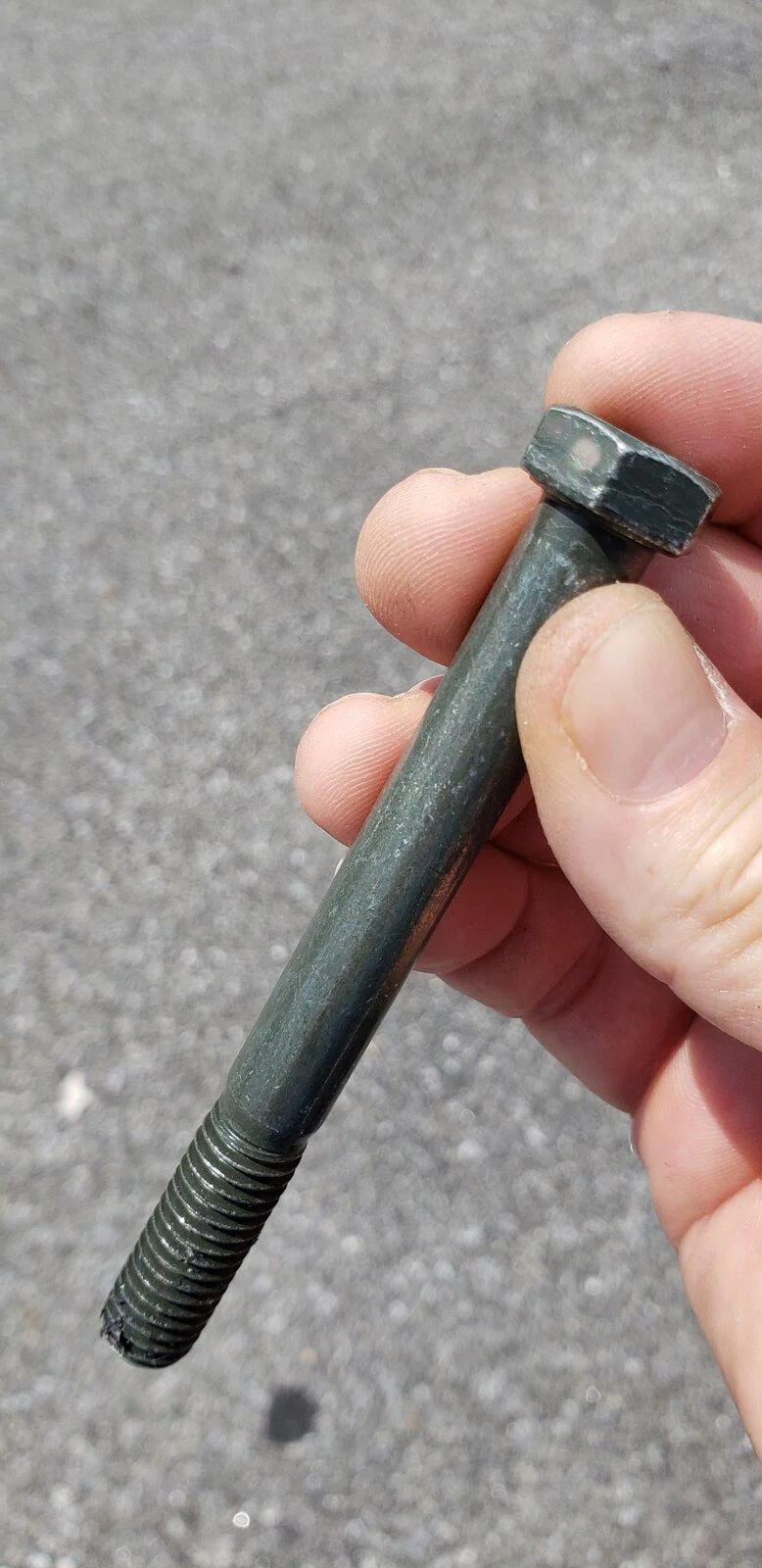

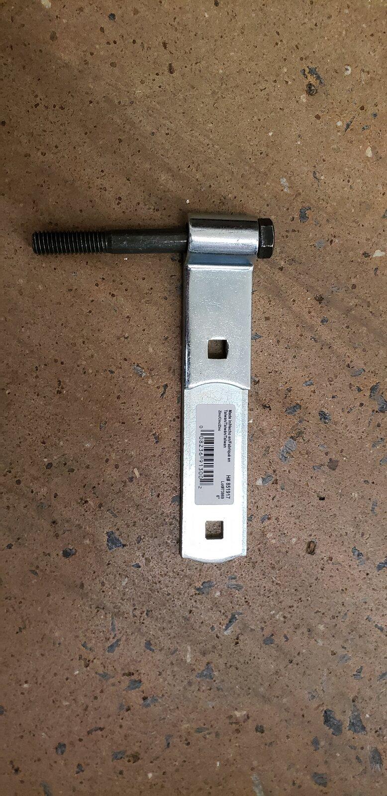

I also picked up some shorter 7/16 bolts( grade 8, 3" long for top hinge pin, already had 3.5", different length make installing easier). These bolts have a large area that isn't threaded( I cut them off right below the smooth area) and they have a slick coating on them) at Tractor Supply. I also cut some plastic molding(window seal extension(not sure thats correct name)) to put over the hinge to keep the hinge from cutting through the other door when hauling in bed and also to retain the hinge pin.

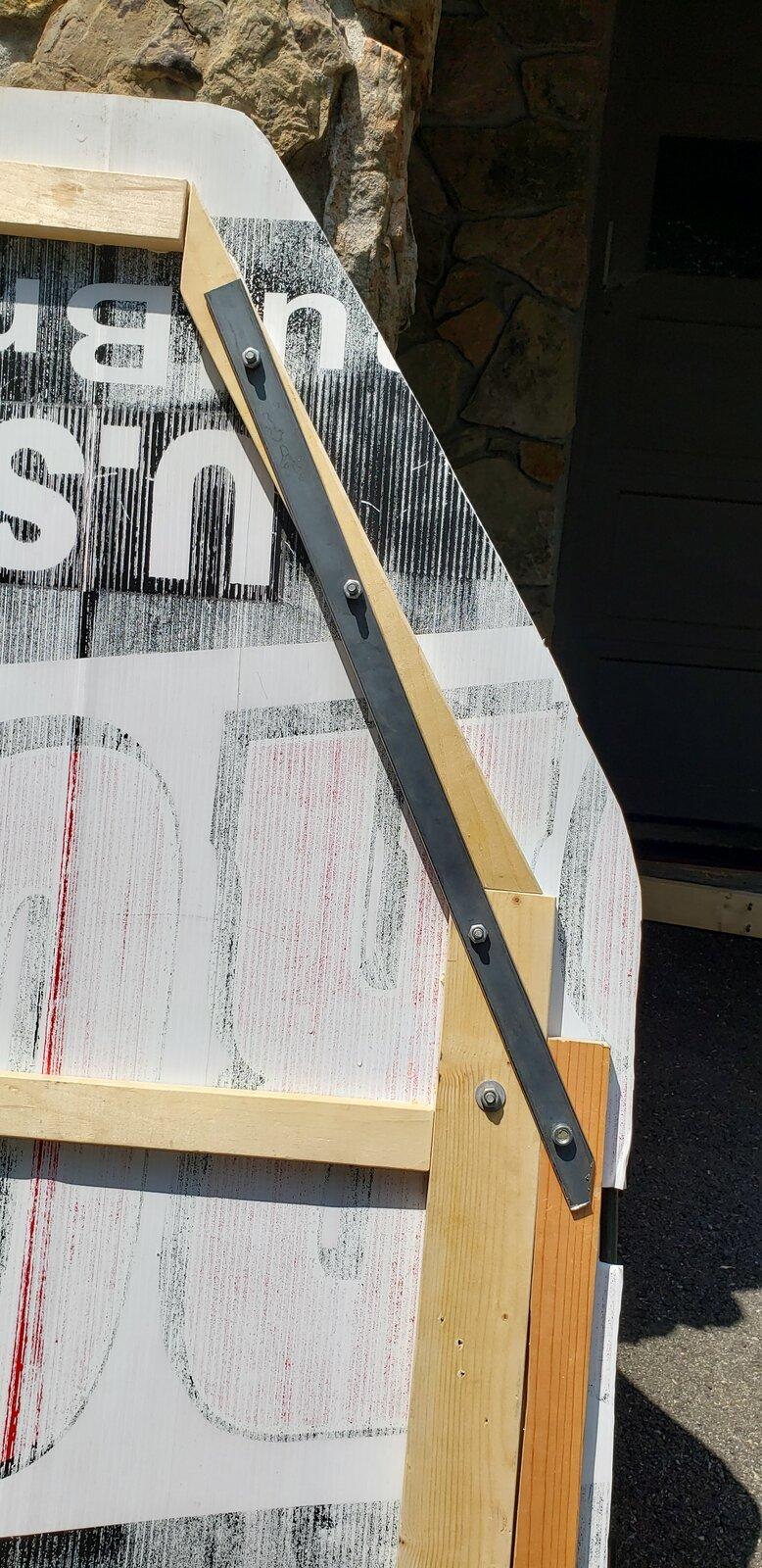

The dang nuts holding steel brace were just loose.....
Since I have them going through the skin they can only be so tight that I risk pulling them through it. So I think it would be better to get a carriage bolt and put it under skin. That and a lock washer(which I've read don't really work) as I'm afraid loctite might eat up the plastic skin(guess i could be careful).
But even though I found the problem early I decided to try what I came up with anyway. I used a 2x4 and screwed it to the board between the hinges and then cut the top to fit shape of jeep. A 10 degree angle fit well. Plus it's stronger than the steel, although it doesn't look as elegant. I think I could cut some of its mass and not hurt the strength, but for now I'm gonna test it as is.
