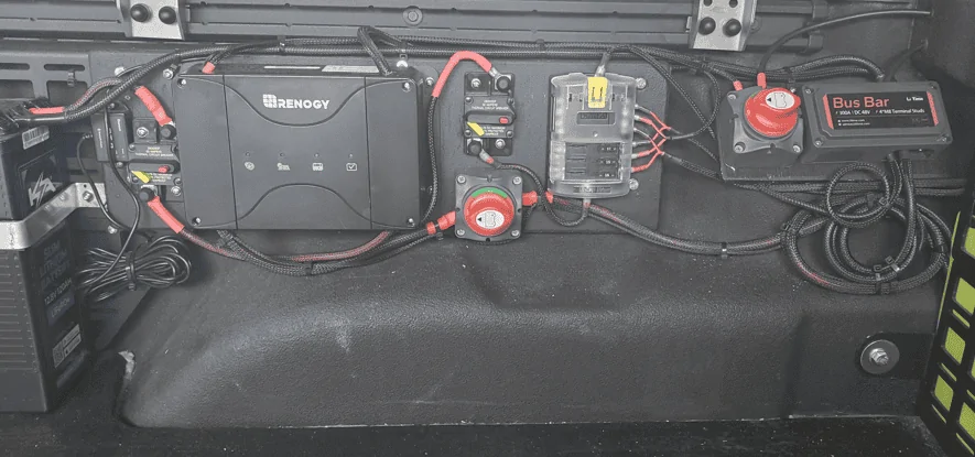

I really can't believe this happened and I am so depressed... Just finished installing the SolarHawk panel on my iKamper. Now I find out the Renogy DCC50 max input voltage (VOC) is 25v and the solar panel produces 28v. Are there any options to step down the panel's output? Any other solutions besides getting another solar panel or controller? Swapping controllers is not something I want to do. And the solar panel is so intensely glued to the tent, it'll be hell to get off.
Ain't that pretty?
The specification for that solar panel states right on their site max output is 22.88v. So I think you need to give them a call for a faulty part. Probably needs to be warrantied out for a new one.
That being said, several companies have higher voltage ratings. Here is an option from Zamp - up to 40v input. I have come to really like them. Hand made components in the USA (Oregon), and their controllers are simple and small.
https://cdn.shopify.com/s/files/1/0344/2973/0953/files/SCC1011_User_Manual.pdf?v=1683736525
By the way, that's a pretty nice looking setup you have. But what in the world is that big Renogy box? Is that the charge controller?? That thing is huge, and nearly 10x the size of the Zamp option. But it does not have the cool bluetooth monitoring features. Oh and the Zamp options work with led acid, AGM and lithium.
