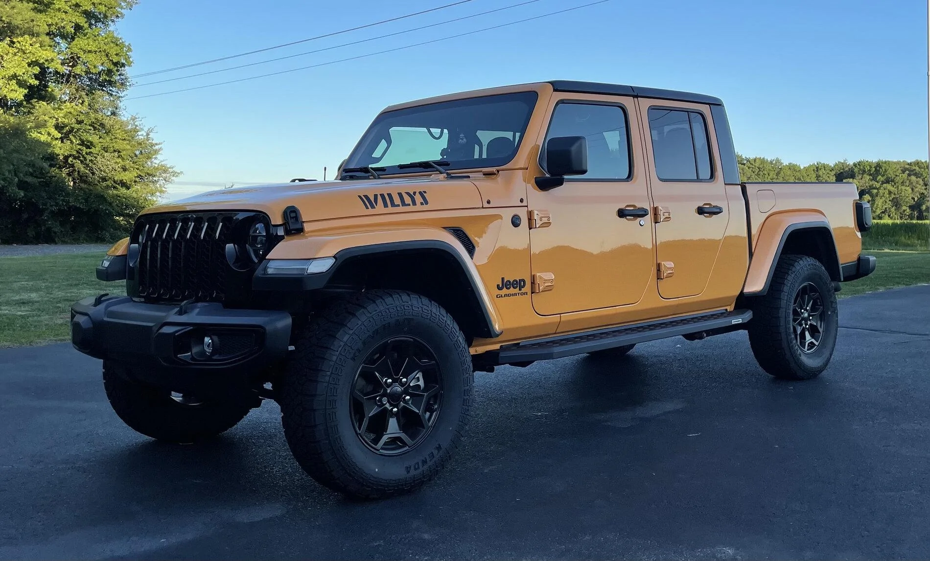

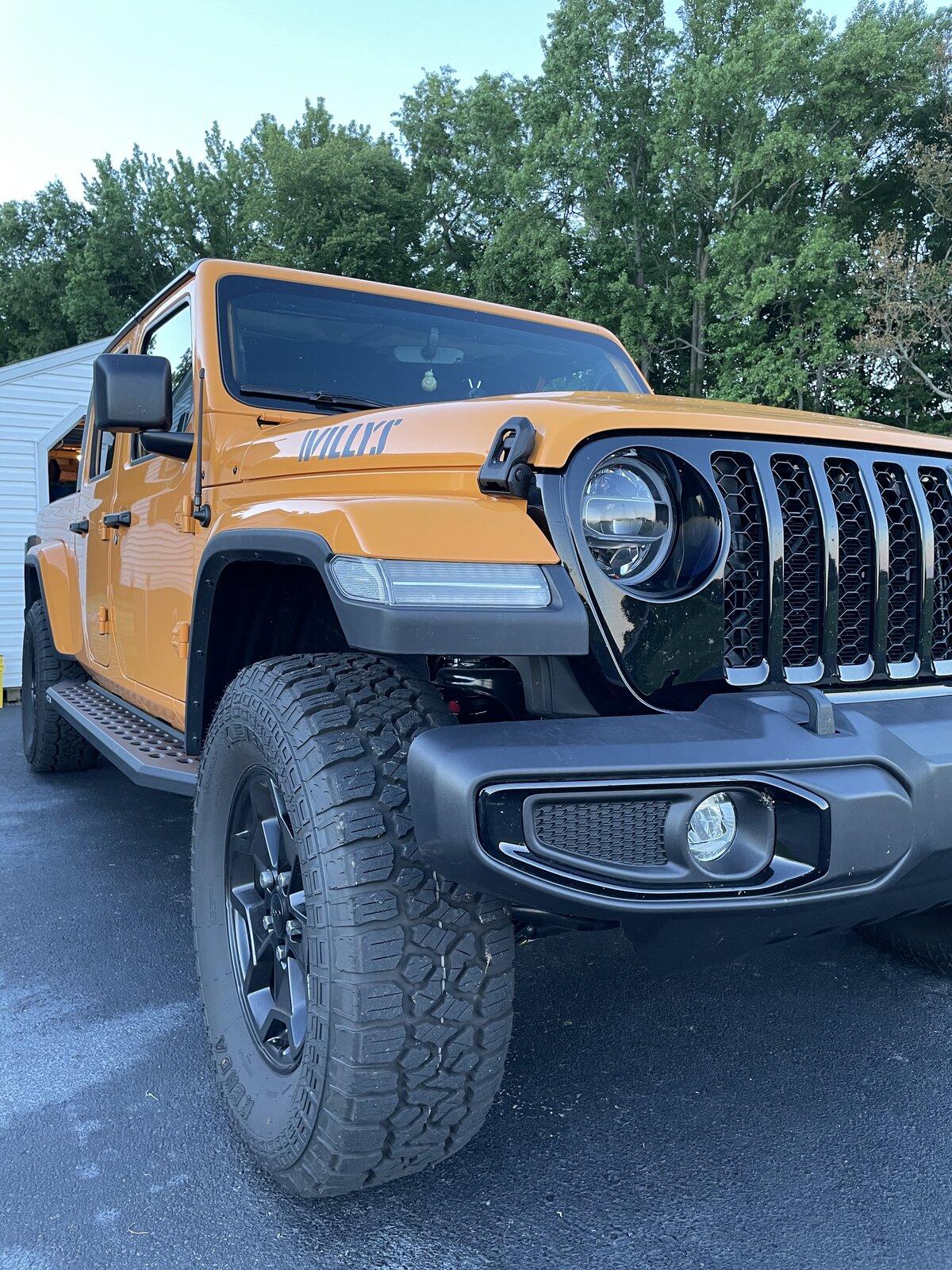

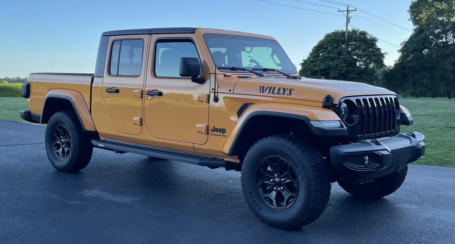

This is my Willys with Rubicon front springs, max tow rear springs and a teraflex 1" spacer from the 1.5" kit. There is still a slight rake. But nowhere near as much as stock.
Tires are 285/70-17

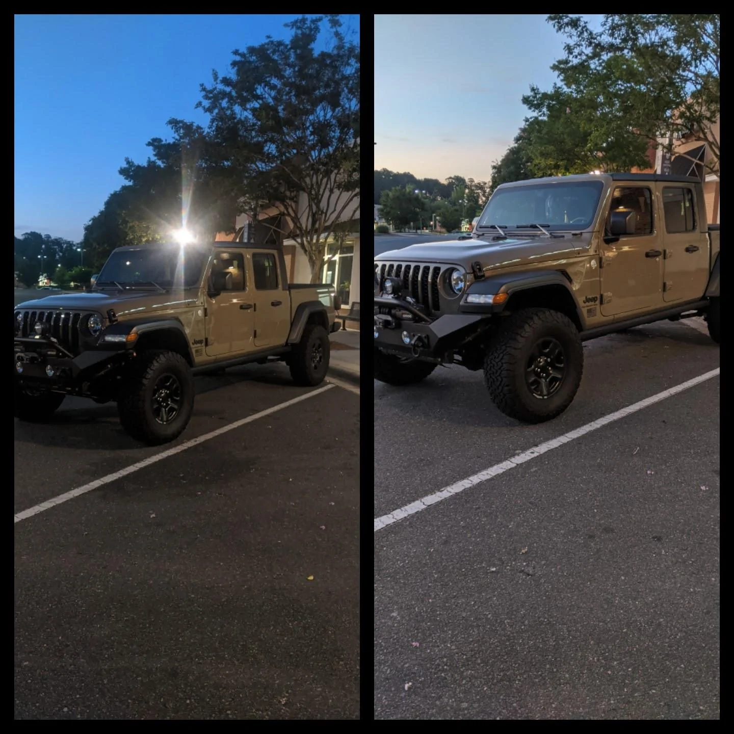

Heres my Sport Max tow with Rubicon Front Springs, Max tow Rear Springs and 2.5 inch Readylift SST lift kit which gives you a 2.5" spacer up front and 2" spacer in the rear. Mine has about a 1/4 inch of rake still front to back but I wanted a little for towing purposes. Here is a before and after picture of it, one before the Rubicon springs and just the spacers and the other with the Rubicon springs and spacers.
Jeep Gladiator Sport S w/ Rubicon Springs - What Level Kit Size? IMG_2020-08-02_06-14-59
Left is Spacers and Rubicon springs, right is just spacers

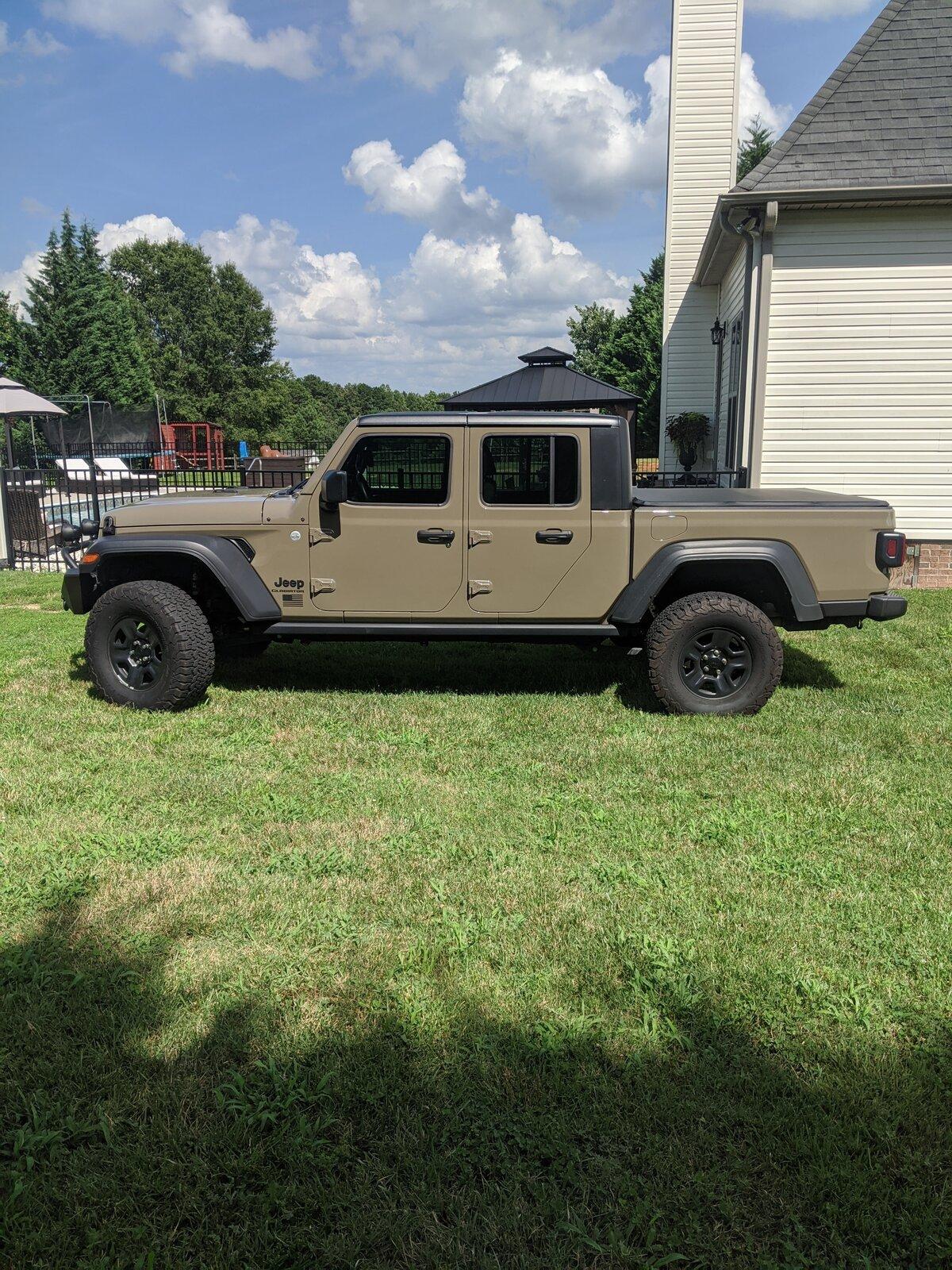

Here is a side profile of it with the Rubi Springs and spacers
