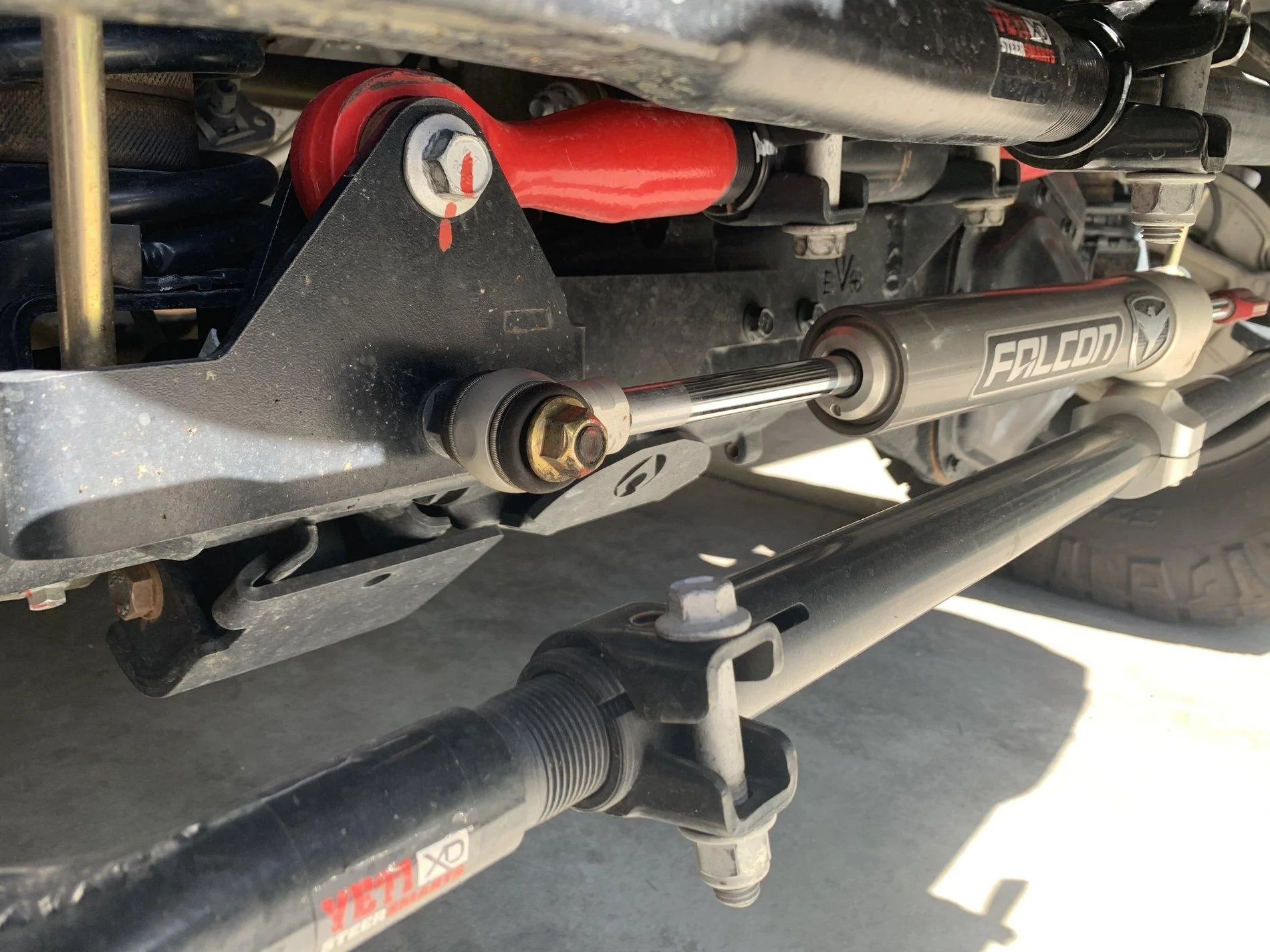

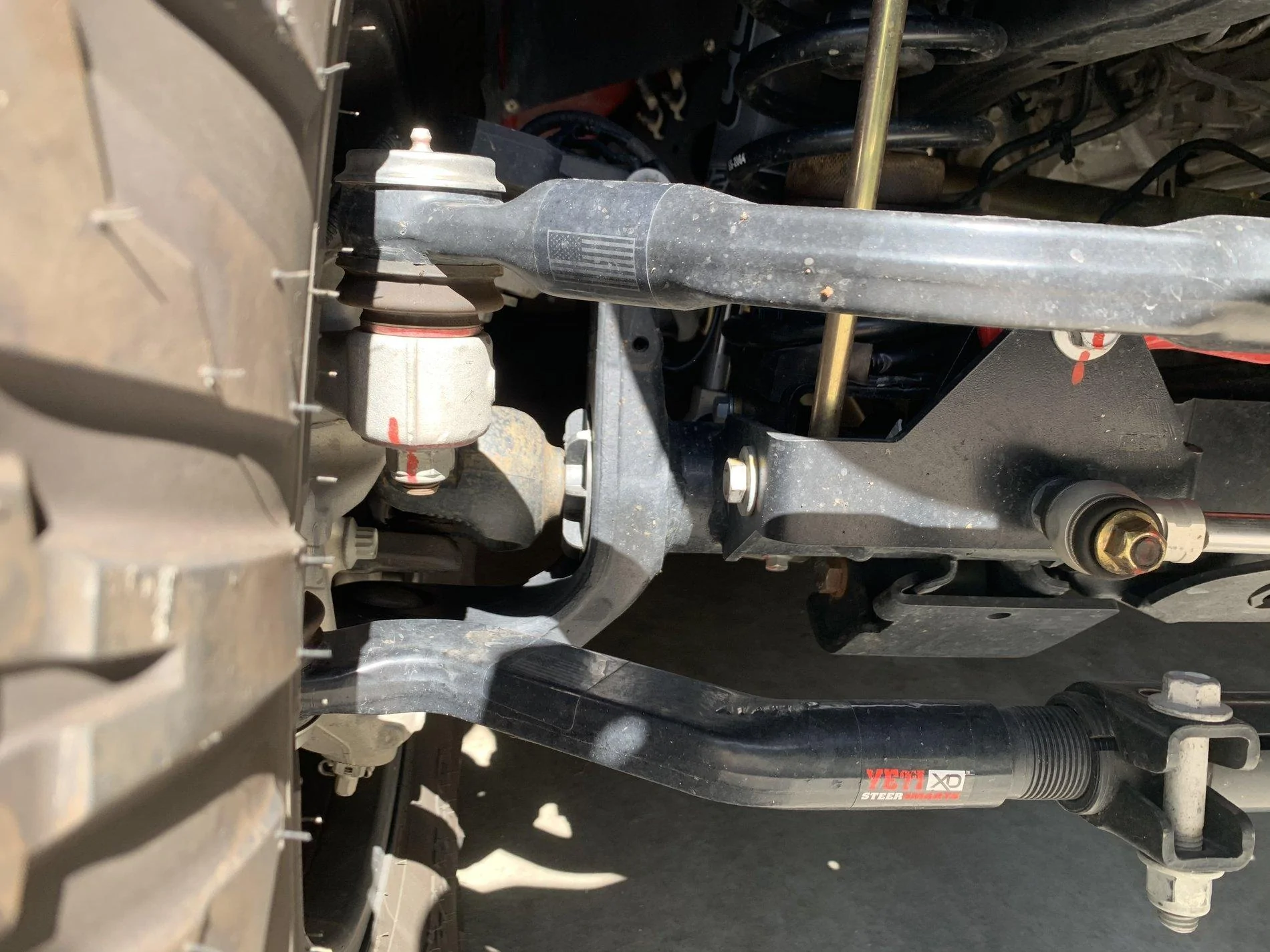

yes I have steersmarts steering components. I have a flipped draglink, trackbar with raised bracket and tierod... all for the rubicon. I went a Metalcloak 3.5” gamechanger lift, in which they don’t recommend a flipped draglink(in which I did anyways for bump steer removal) and the falcon 2.2 steering stabilizer from a “JK”.
with what you described above you should be able to do 1-6 without any issues if you use the standard mount on the draglink. Technically, you have to be above a 4”of lift to use the drag flip and the raised trackbar bracket. If you use the JK style nexus 2.2, you don’t need 4 or 5 on your list ( just have to use the 1 5/8” clamp size for the tierod side)
I hope this helps...

the shock is the same between the two of them jk/JL but they mount differently. The JL/jt version mounts low on the axle And extends to the corner of the tie rod by your steering knuckle and the jk version attaches through the trackbar bolt on the axle side to the tie rod and its position is high... look at the picture I posted at where it sits and then go look at your stock one. The advantage of having it high is that if you go through rocks you have less chance of destroying the stabilizer. The disadvantage is that if you don’t have enough lift you can destroy the shock when your axle up travels.
Also... if you take the JL version and use the relocation brackets you can run into the same thing as the JK version if you don’t have enough lift. Honestly, I’m not sure if a raised stabilizer has enough clearance with just a level on your ride... that’s a question a shop can answer .
