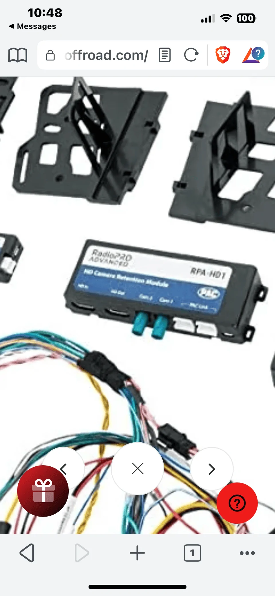

Here is a response from a question on their website.
The RPA-HD1 made by PAC is included in the kit. This allows two HDMI camera inputs from your backup cam (1) and your front trail cam (2) and has an HDMI out that goes into the deck. This also has an HDMI input that we use for an Apple TV and it works fantastic!! You also have four analog (yellow rca) inputs for additional cameras or video inputs beyond the hdmi ones. Use “WARNINGLIGHTZ!” At checkout to save 10% and to say thanks for the helpful input to the question. Feel free to follow us on social media as well @warninglightz
Anonymous
the part in the response is the long thin rectangle box in the picture. The 4 analog should be on one of the cable bundles.
