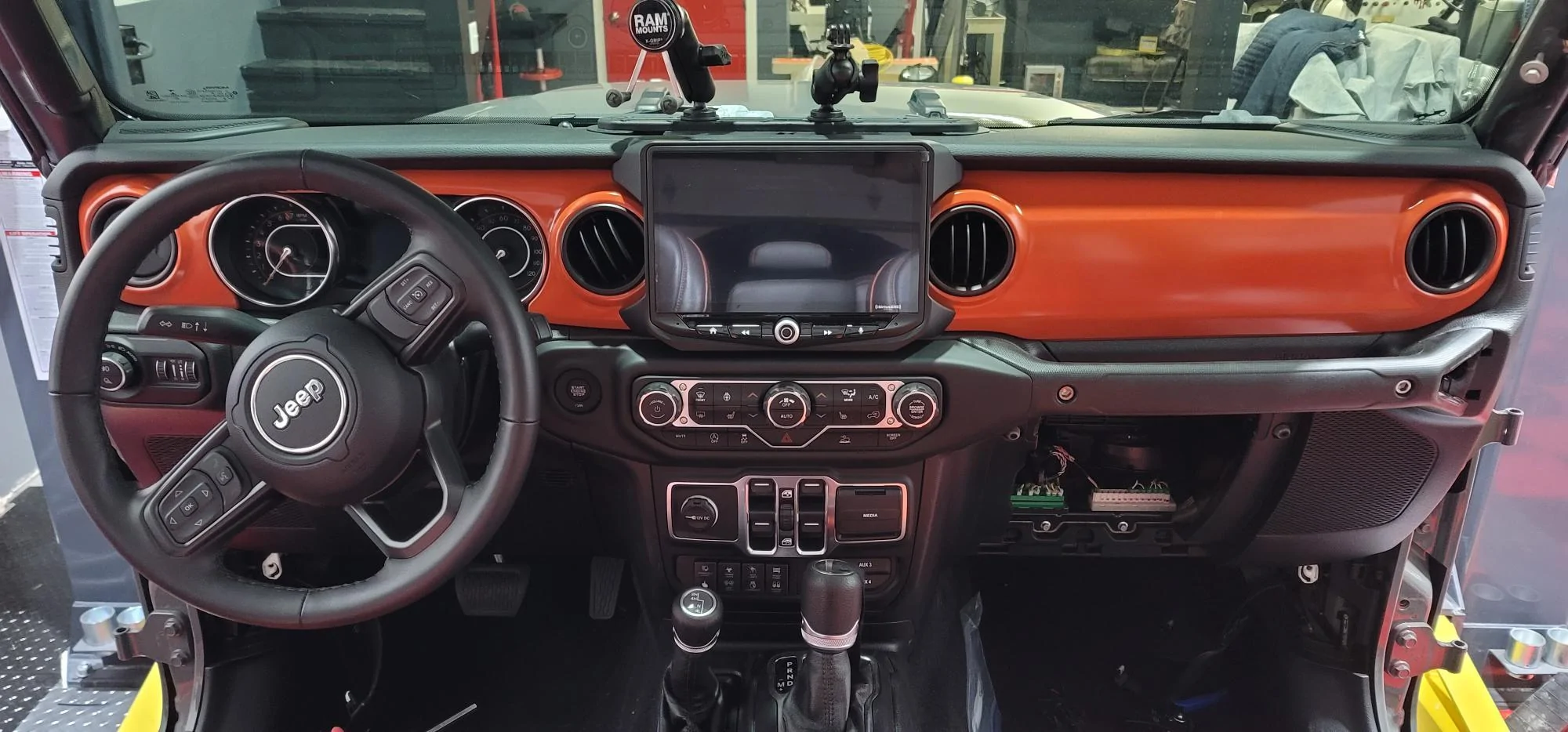

I know a lot of you guys run them. I just installed mine. Anyone had issues with the rear view mirror and/or steering wheel controls not working? I'v been talking to tech support but not getting anywhere. I've checked every connection multiple times, updated the firmware, etc.
I'm so frustrated. It was 48 yesterday so I was able to install it. Today it's 28 and snowing and I'm out trying to troubleshoot it.

I got my steering wheel controls to work. The directions show it plugging into a black plug. It's wrong. I had to plug it into a red one. That fixed it.
I replaced the hdmi for the reverse cam today. It worked for a few minutes but I had to go back into the dash to fix an RCA so when I opened it up, it quit working again.
These things are a nightmare to fit into the dash.
