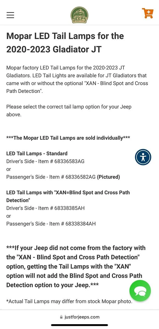

So I have the non blind spot monitoring LED tails on my JT. Not the halogen version. However one recently took some light damage on a trail so looking to replace.
Been doing a lot of research and seen differ lent part numbers for each side and model.
I may be able to grab a single one that I need replaced that is a BSM part number. My question is will it work with what I have operation wise especially since it would only be one replaced. I don't care or need the BSM feature just need a tail light, so I'm assuming it's the same harness and functional operation wise.
Jeep Gladiator Stock led tail lights part numbers IMG_3567
Jeep Gladiator Stock led tail lights part numbers IMG_3566

Here's the LED without sensors. 68336582AG (R), 68336583AG (L)
They should plug and play without issue.

Right but I was asking if the the ones with sensor would plug in to a JT without

They should plug in with no issues, the harness just doesn't have the extra sensor wiring. Did you get a deal on the sensor units?

Well, I found a single tail light online that matches the part number with the sensor although it's listed as not having the sensor so that's kind of confusing to me but whatever. But the price isn't fairly bad, so I kind of want to pull the trigger on it, but just didn't know if it would plug into my current harness that does not have the BSM. If it does, I know that it's not going to give me BMS automatically, which is fine. I just want a working functional tail light.
