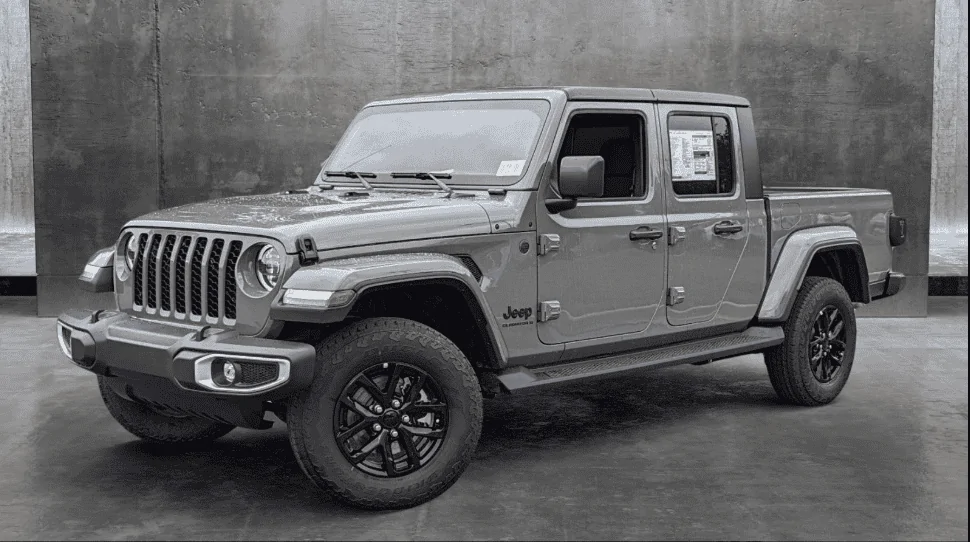

Hello everybody,
Just picked up this 2023 Sport S with max tow and the LED headlight package. The tail lights are however, not LED. Would it require a dealership flash if I installed a set of OEM LED tail lights to it even though it has the front LED option?
Much appreciate and thanks in advance.
Sorry if this has already been asked. I searched the forum but couldn't find my answer...
