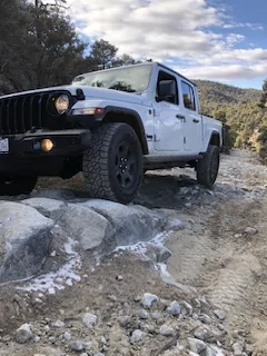

I initially grabbed a set of brand new Mojave take offs and looked and fit great with only a 3/4 spacer lift front and rear. Maybe look into that route, it will probably be cheaper than buying a set of new tires anyways. Unless you’re dead set on keeping your stock wheels.
