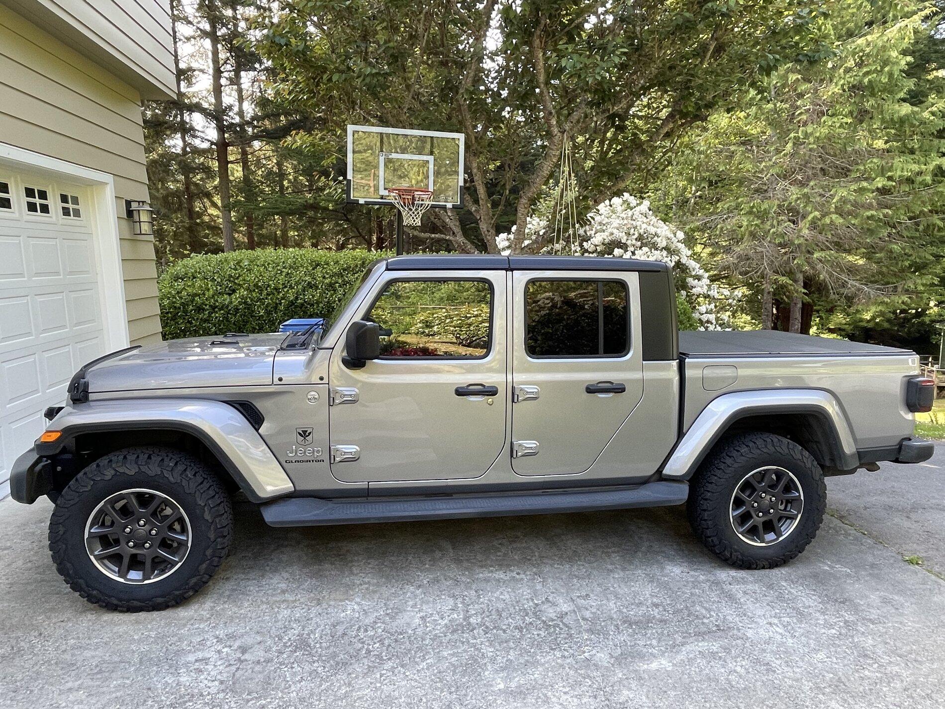

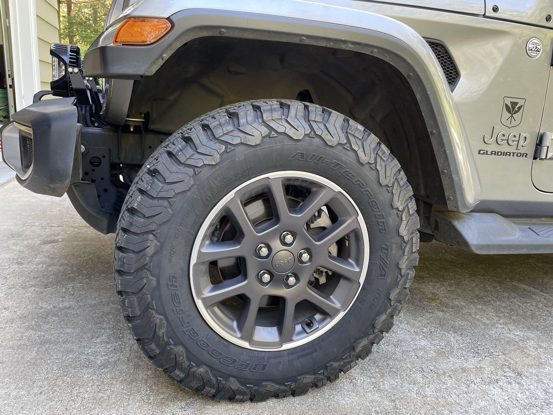

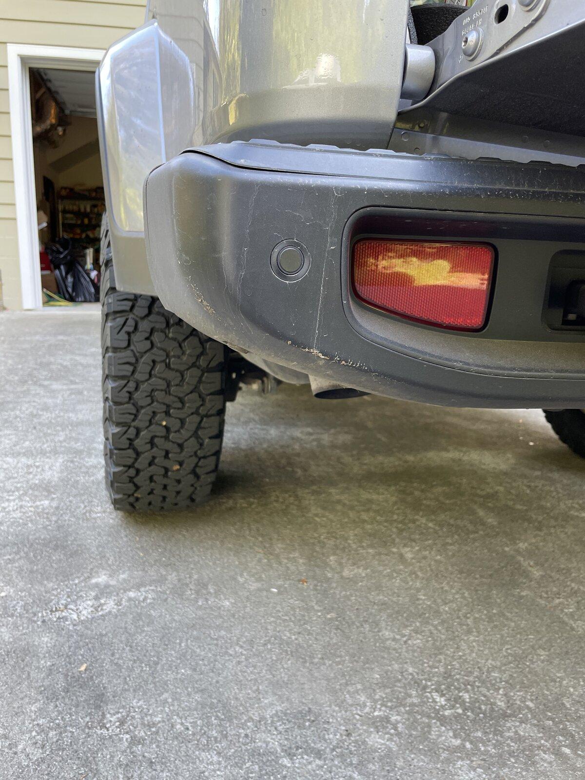

Zero rub lock to lock. I like these much more than the 275/65/18 Falken Wildpeak A/T that I had previously. The BFGs are just as quiet. They measure 33.2” tall and 10.9” wide. The load rating is “E” vs. the Wildpeak’s softer “D” rating... and you feel the difference a little (firmer) but not remotely uncomfortable or jarring. Just right IMO.

Shouldn't be any rub not even close as I was running 285/70R17s and those are 32.8 and 11.2" wide

Correct. Zero rub. I’m just offering a data point for those interested in the same size/brand/model. 👍🏻

These KO2s are surprisingly quiet. I don’t really detect any appreciable road noise from them. The ride is a little firmer over bumpy roads but I’m totally satisfied and happy with them.

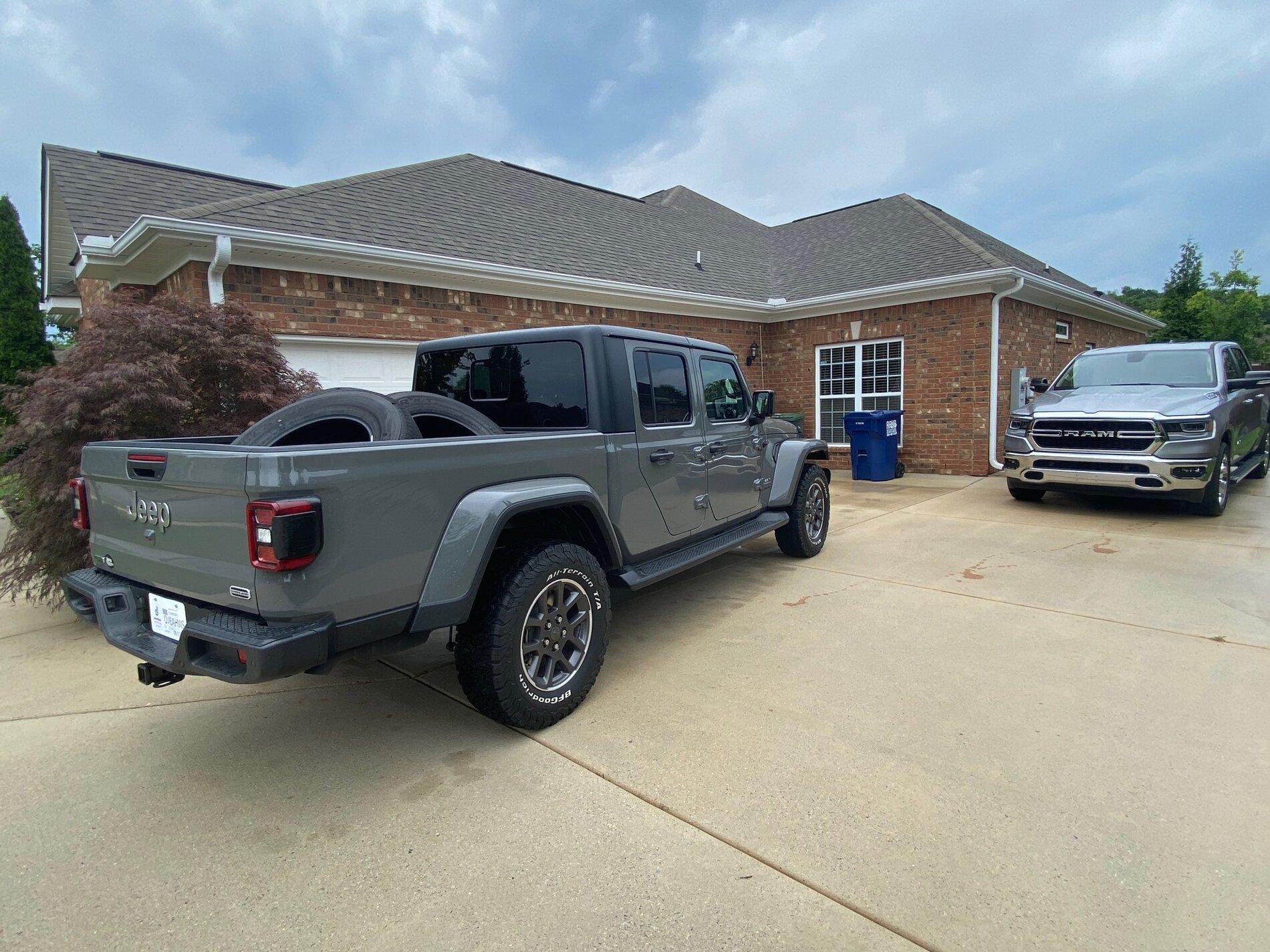

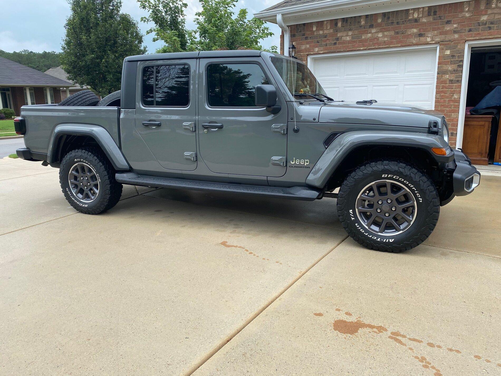

Appreciate your thread and pictures, just got a Gladiator yesterday, had BFG AT KO2 275/70r18 added today, stock suspension. I like the ride a lot better than the stock overland tires.
