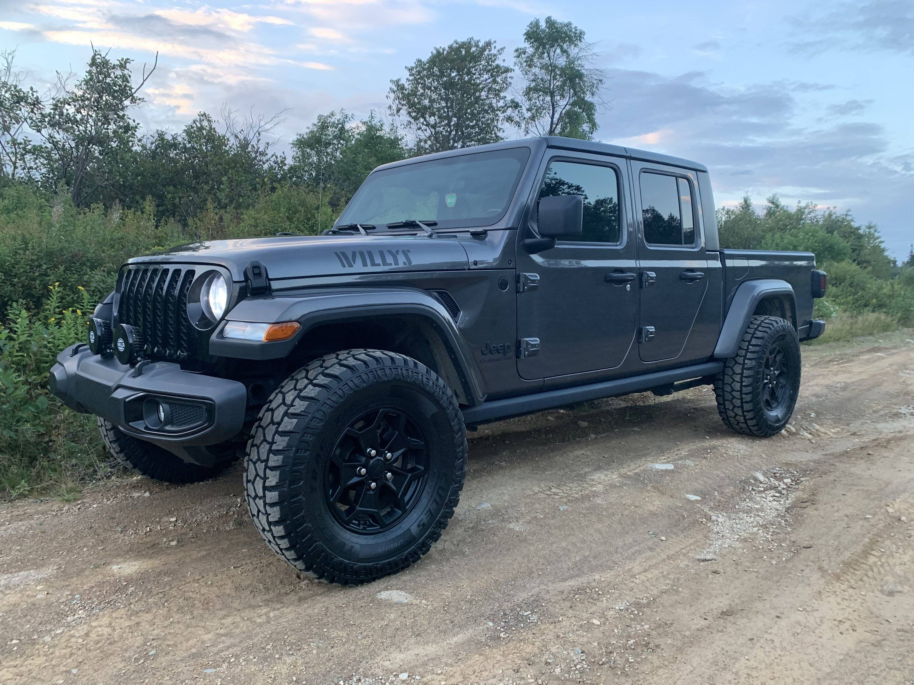

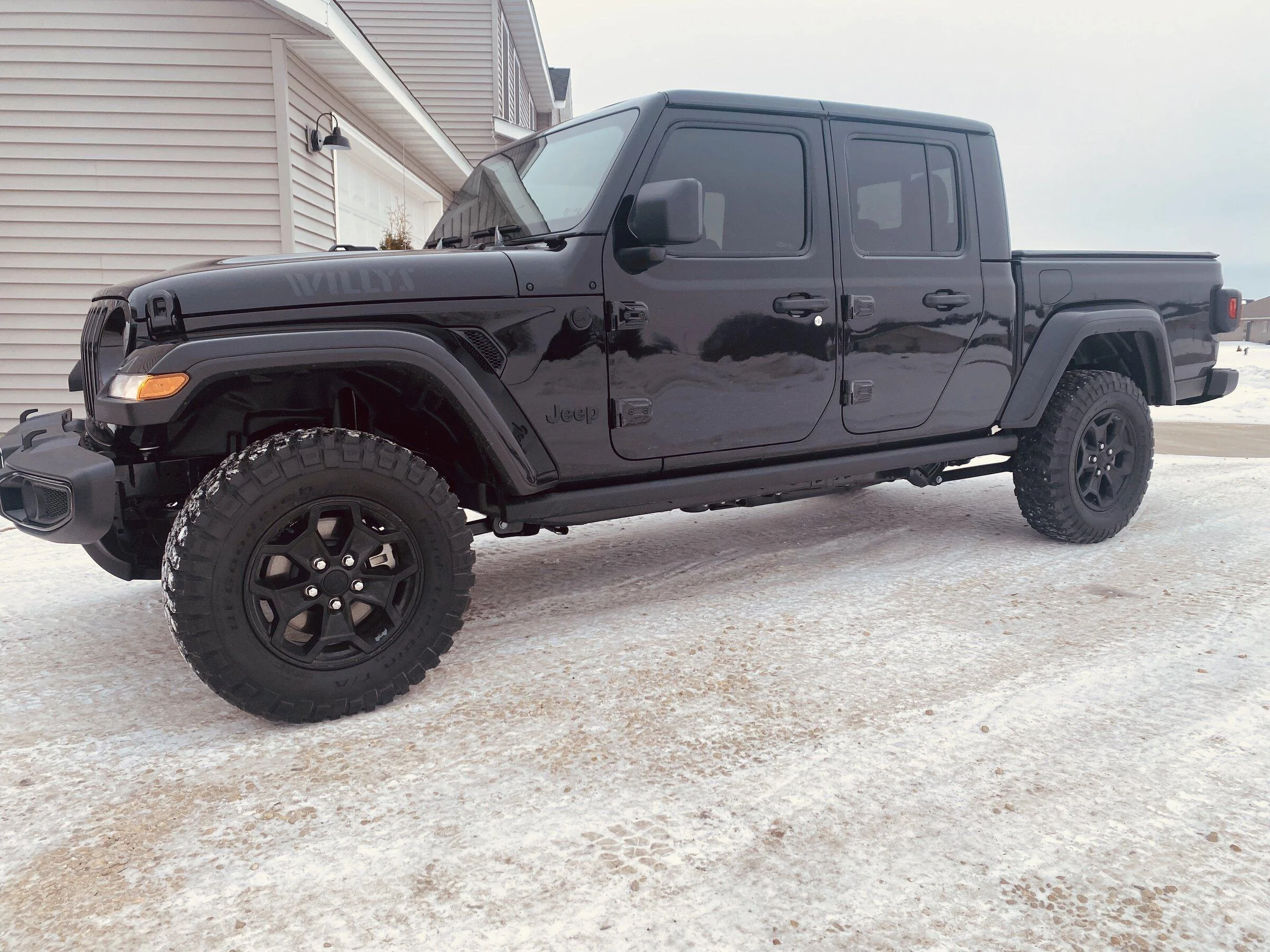

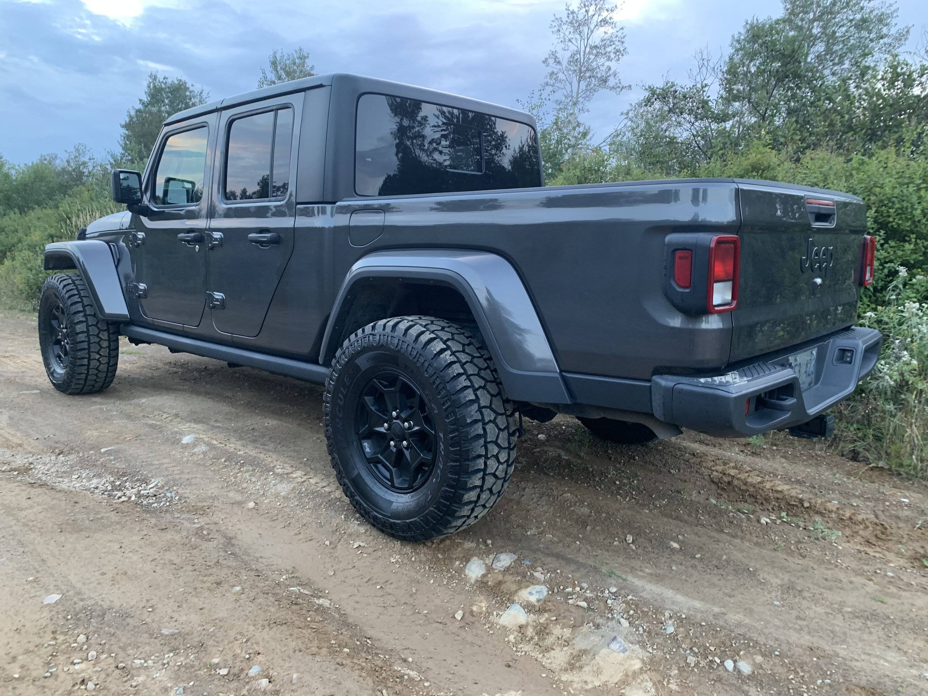

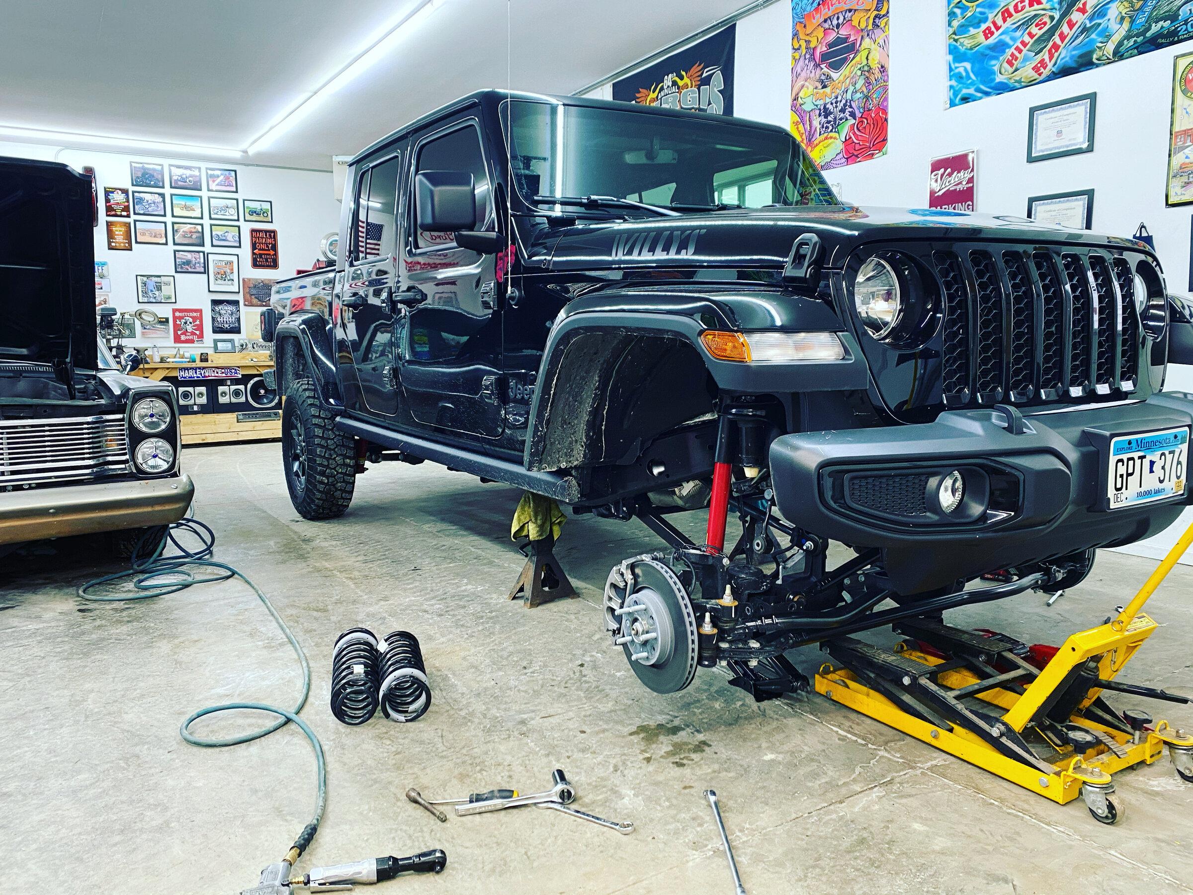

Have a new 2021 Willys Gladiator eco-diesel with about 500 miles on it. I’ve done a few simple mods so far. Teraflex 1.5 level, tints, roll up bed cover. I ordered 315/70-17 (35x12.50) Firestone destination MT2s for the stock rims. I also plan to order a 1.5 inch hub centric wheel spacer. Is there anyone on here who has the same or similar setup? I should specify that the likelihood I will do any actual 4 wheeling with this vehicle is very slim, if I ever wheel it at all. Mostly did the level and wanting to do the tires strictly for aesthetics. I’m wanting to know from anyone who has done 35s on stock wheels, with level and spacers if there is any rubbing or other known issues. Will be towing my boat with the vehicle also. Mostly just want this for a cool tow vehicle/around town slight head turner. Any input is appreciated. A couple photos of my truck attached. Love these things!!!

I have a ‘21 Willys with a 2 1/2” level kit, 1 3/4” spacers, stock wheels and 315/70 tires. No issues, looks great (IMO), no rubbing whatsoever. If running stock wheels you will need some spacers.
