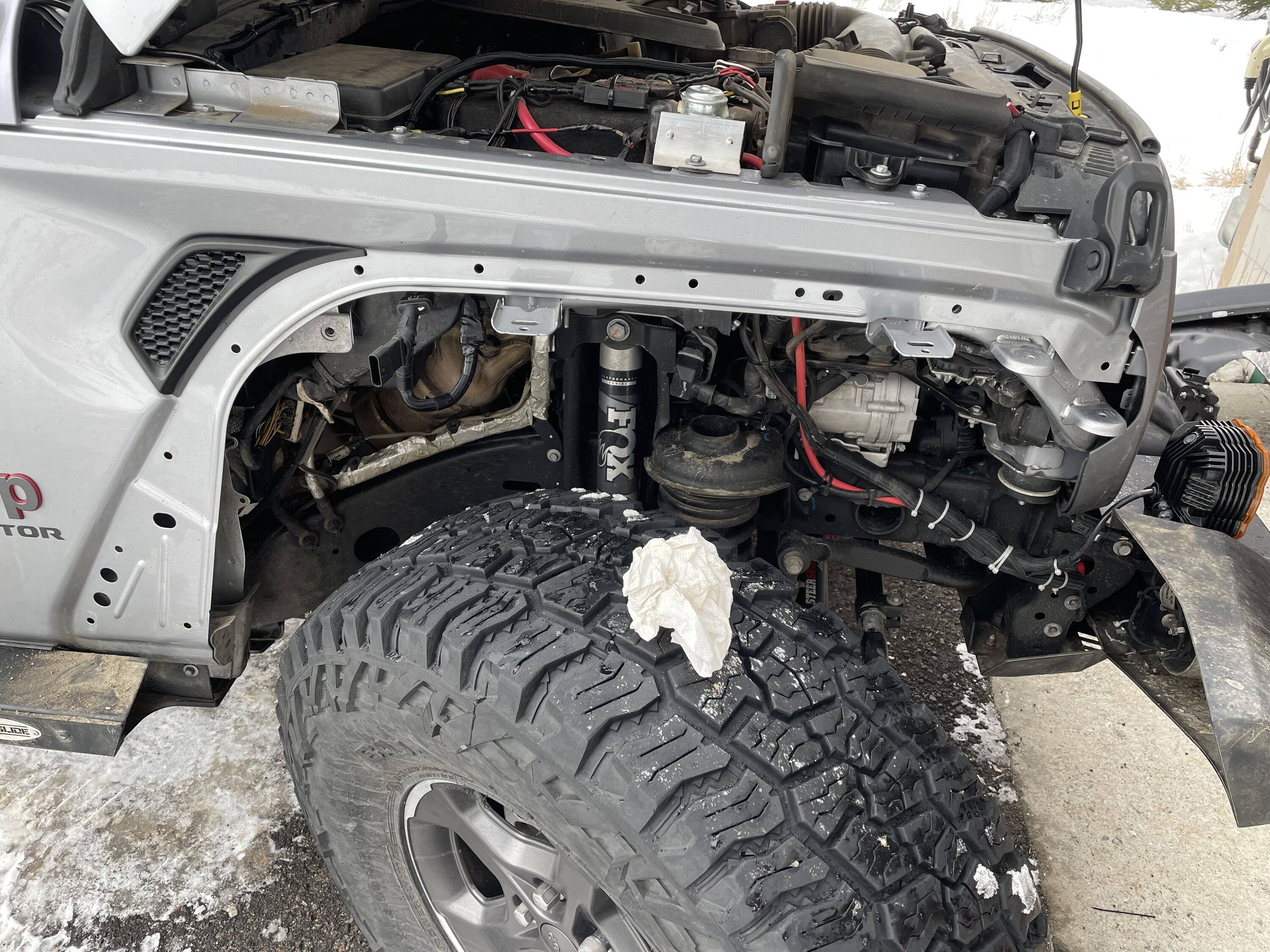

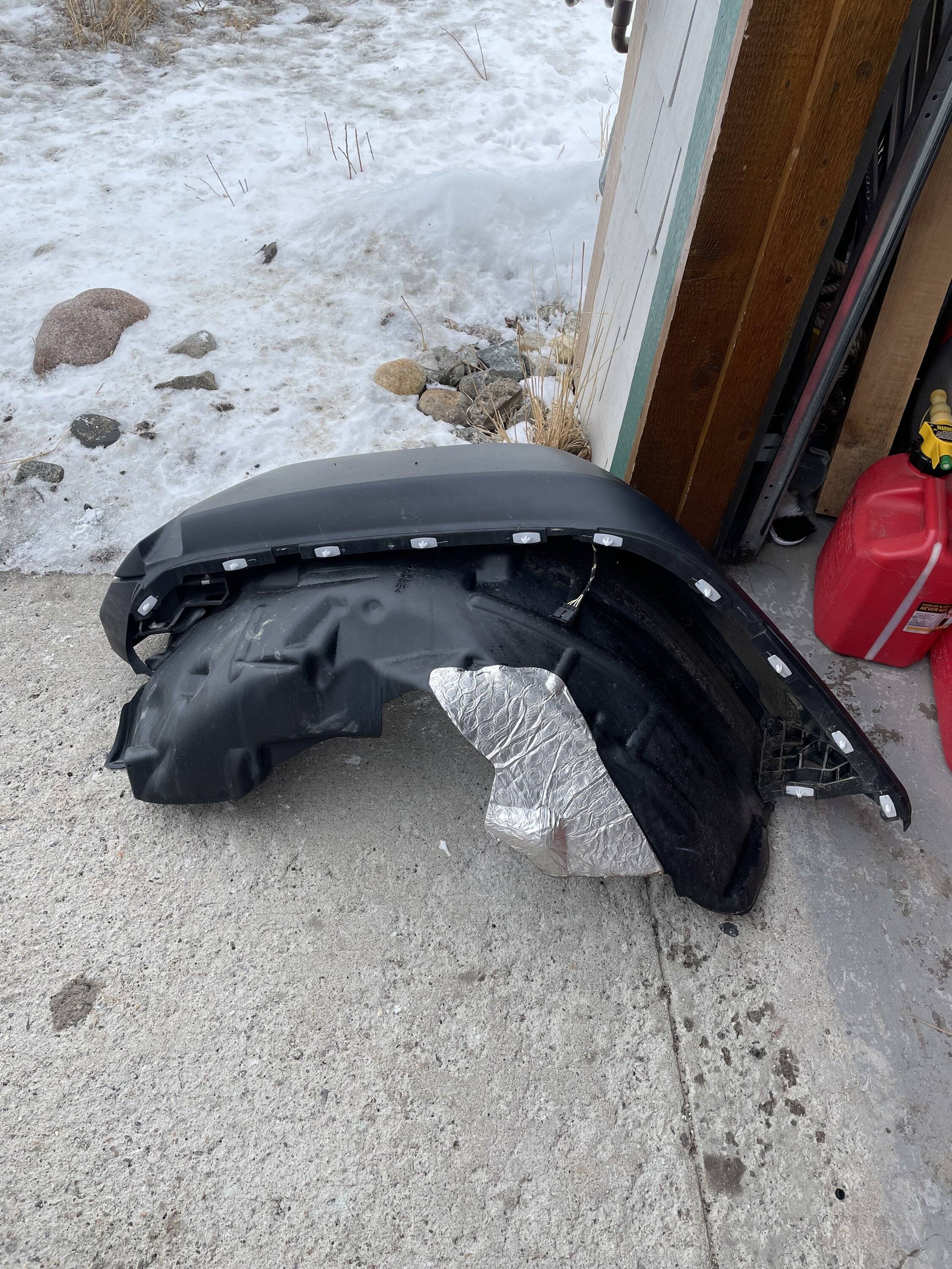

This picture shows the assembly after I’ve replaced the broken white clips before putting it back on. And the body with it removed.
Jeep Gladiator Suggestions on fender clips, liner clips, plastic rivets, christmas tree plugs, etc.... IMG_4624
Jeep Gladiator Suggestions on fender clips, liner clips, plastic rivets, christmas tree plugs, etc.... IMG_4623
