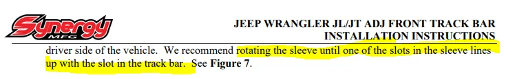

Also, I feel like Synergy doesn't make this part of the install instruction guide as prominent as it should be because after watching a bunch of Waya-Eddy-Life videos he specifically calls it out as very important. They prefer the slot in the adjuster sleeve to line up with the slot in the bar so the pinch bolt clamps everything done in unison. I have Synergy TB, Tie Rod, Sector Brace and LCA's going on my truck soon too.
Thanks,
This time I did align everything up the sleeves, so hopefully it’s the last time it happens. But just wanted to reach out and see if anyone else had the same problem

Lastly (don't quote me on this), I thought I recall that Synergy said that 100ft/lb was the max in case 90ft/lb didn't clamp it enough. Again, I can't remember where I heard or read this but I swear I'm not making it up...too much :)
