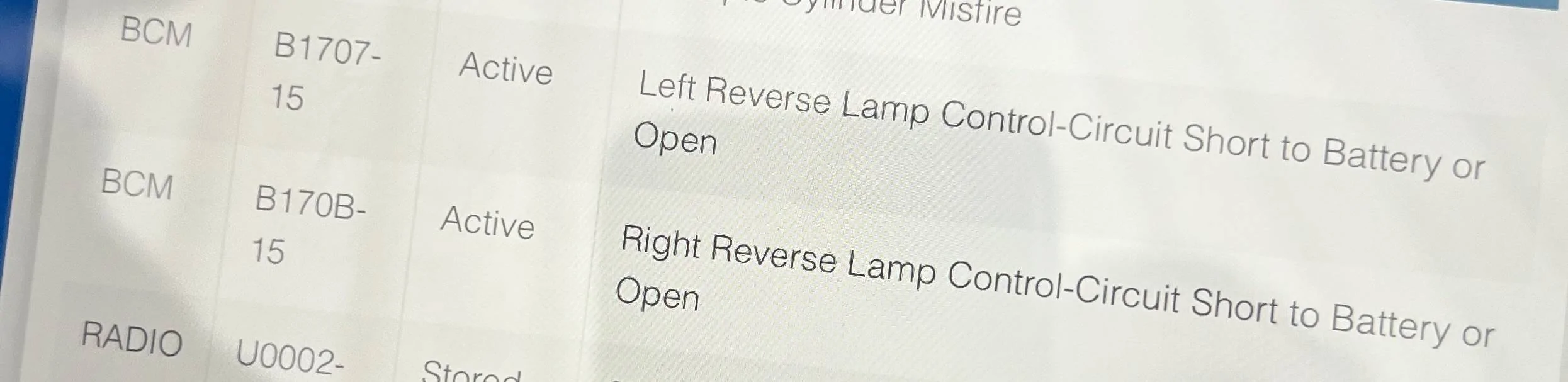

You’re welcome. I’m running the Wolfstorm ones and haven’t been pleased with them and am planning on replacing them with those. As advertised, the Wolfstorm set do not throw a warning on the dash - but they do throw an error that is detected by Jeeps scanning tool when I go to the dealership for oil changes. YMMV…

Happened to grab a screenshot of the warning the cheaper lights throw in the dealer tools.
Jeep Gladiator Tail Light Lens IMG_2095
