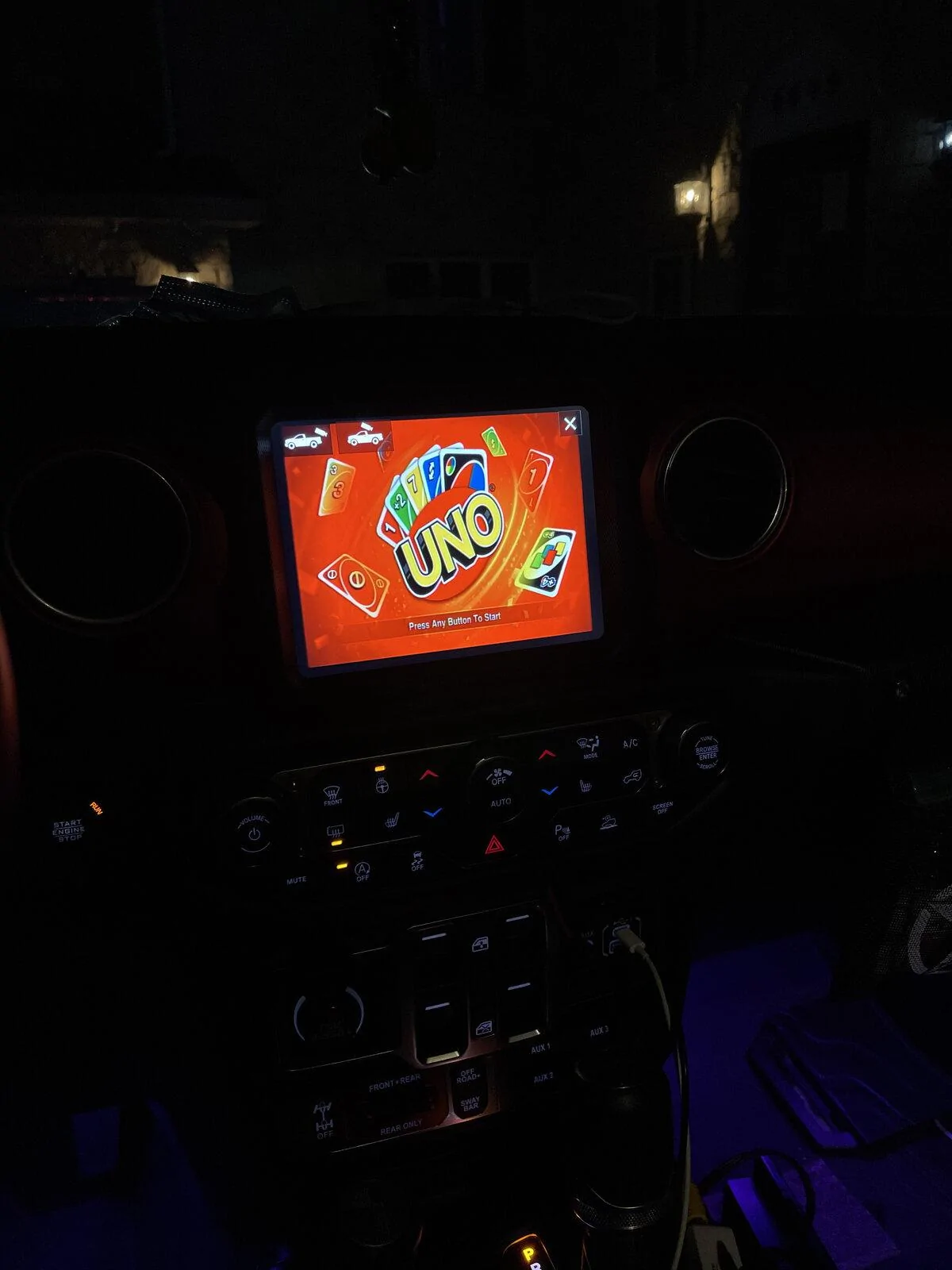

I received the following response from Z Automotive. I’m going this route along with what “Zipper” did with the rca splitter.
Is you front camera the factory trailcam? And you will use a RCA signal going to the cargo camera pins?
if yes, please let us know if a third icon will appear.

Sorry for any ambiguity. I have the factory trail cam and of course the backup camera. According to Z automotive I can add their unit as a third camera, under the cargo camera input.
