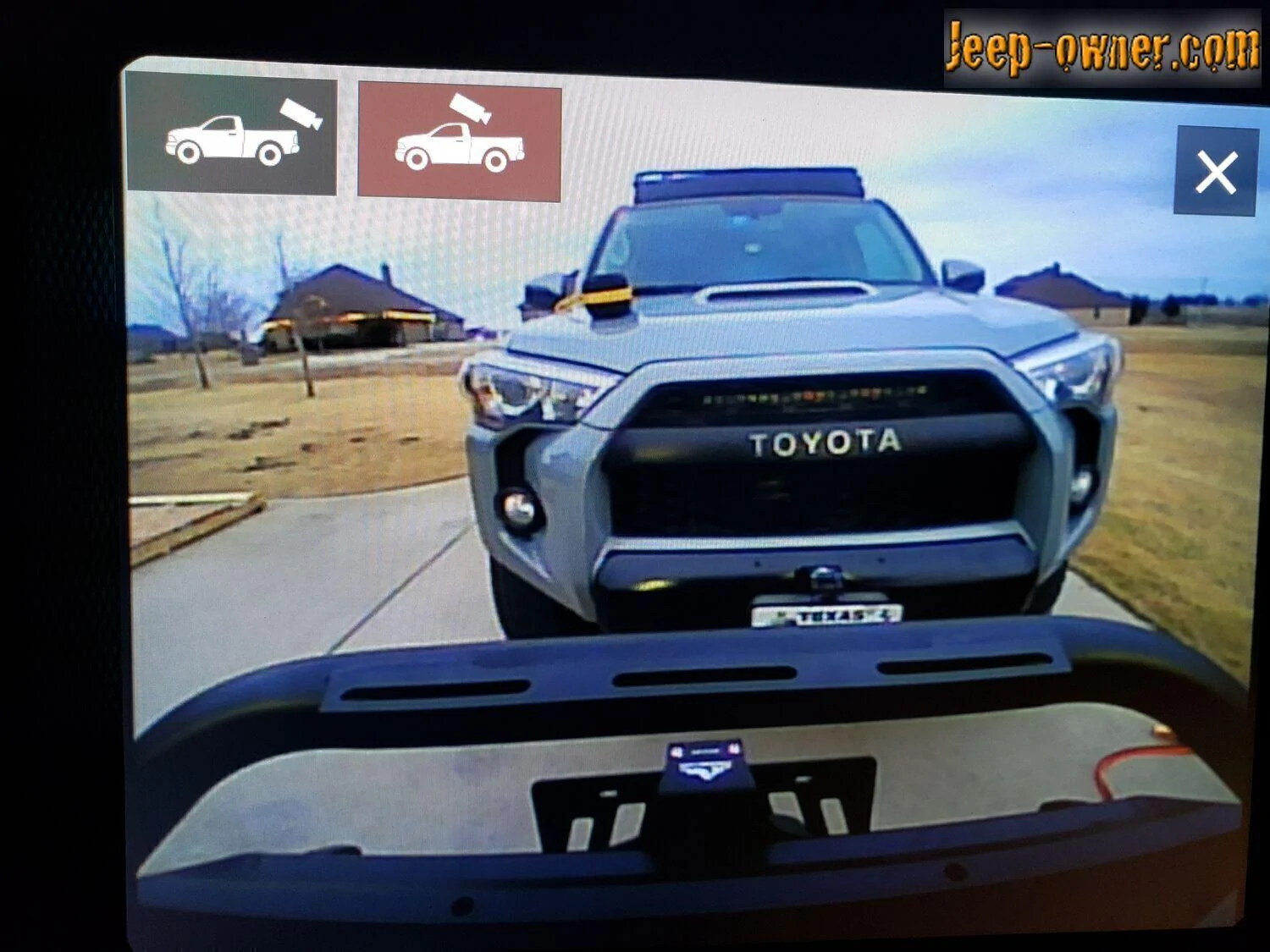

Zipper
Isaac
Nov 25, 2020
41
Illinois
Jeep Gladiator
I just bought one and started installing it
