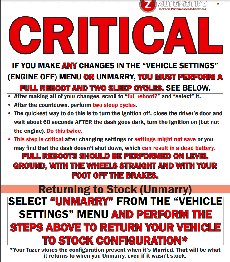

After unmarrying it, did you do the full 2.5 minute reboot, and then run it though two actual sleep cycles?
Level ground, foot off the brake, turn the ignition off, close the driver’s door and
wait about 60 seconds AFTER the dash goes dark, turn the ignition on (but not the engine).
Repeat.
Not trying to revive this post, but could you please tell me where to find the information on doing what you described. I'm thinking I might have accidentally made changes I didn't want and I want to make sure everything is back to OEM and I did not F-Up anything... I thought unmarring and the 30 second or so reboot took care of this ? Thanks
Sure. It's in the instructions. Page 6 of the current manual:
https://www.zautomotive.com/zpu/instructions/TazerJLMiniUserGuide1137.pdf
