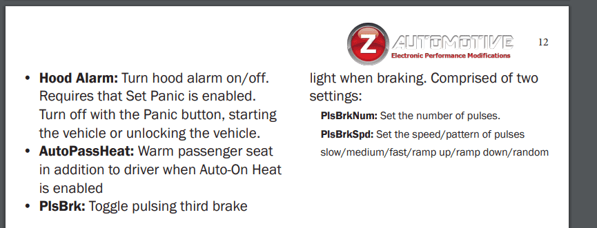

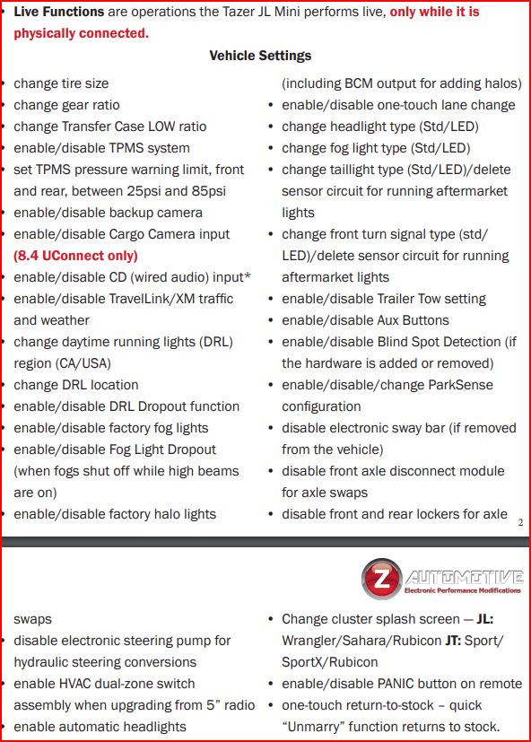

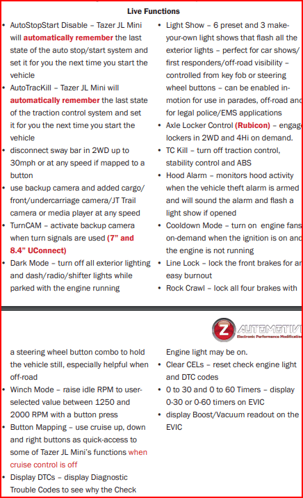

I bought my Tazer JL Mini about 3 weeks ago, new. Going through the instructions, and every menu, it appears they removed the 3rd brake light pulse feature. I cannot find it anywhere in the instructions. It is still mentioned in their product description from the website.
For those that do have the feature, I assume it is offline setting, what menu is it under?

It's a Live Setting and it's listed on page 12 of the manual
Thanks. The Rev of my instructions does not look like yours. My page numbers are on bottom, and there is no plsbrk category. Going out to try in truck now.

UPDATE: ALthough not in instructions, the menu is in my programmer. Gotta get a 2nd person so I can figure out which setting I want to use...lol. Thanks for the follow-up!
