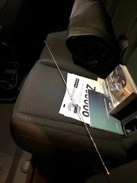

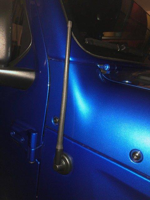

First mod (before leaving the dealership) - replaced wire whip antenna with the same 13" one I put on my JLU.
https://www.amazon.com/gp/product/B00651CLCS/ref=ppx_yo_dt_b_asin_title_o01_s01?ie=UTF8&psc=1
Jeep Gladiator The BEAST Antenna Old
Jeep Gladiator The BEAST Antenna New

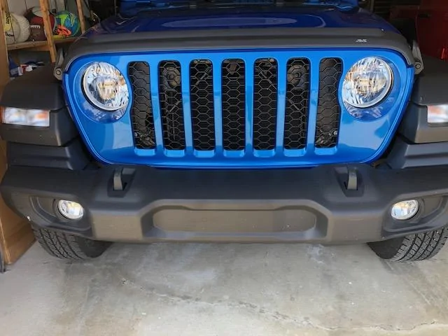

Washed the bugs off of my grill, headlights, and hood ... then installed my hood protector.
https://www.ebay.com/itm/Auto-Ventshade-436148-Aeroskin-II-Hood-Protector-Textured-Black/283409896697?ssPageName=STRK:MEBIDX:IT&_trksid=p2057872.m2749.l2649
Jeep Gladiator The BEAST Front hood guard

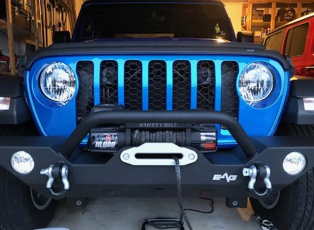

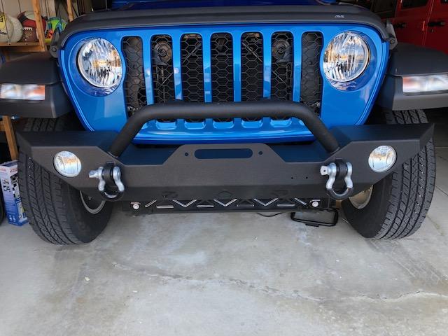

Then, a 3-way bumper swap ... Removed bumper from JLU, then removed fog lamps & wire harness. Installed fog lamps & wire harness onto new EAG bumper. Removed bumper from JT, then installed it on the JLU. Then installed the EAG bumper on my JT.
https://www.amazon.com/gp/product/B07BP37G7Z/ref=ppx_yo_dt_b_asin_title_o09_s00?ie=UTF8&psc=1
Jeep Gladiator The BEAST Bumper swap befor
Jeep Gladiator The BEAST Front new bumper

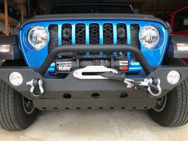

I nearly completed the install of a Smittybilt X20 synthetic winch, but wasn't going to have enough daylight to finish the solenoid mount & wiring to an Aux switch. That'll be the next update.

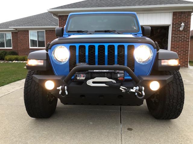

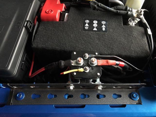

Alright! Winch is assembled, mounted, and wired to a solenoid & Aux 3 under the hood.
I used a steel bracket I had laying around as a mount for the solenoid (idea from other forum members). I put a few soft pads between the bracket and the paint on the JT.
I had to crimp & solder a few ring terminals which I did with a propane torch (sooo much faster than using a soldering iron for larger wire!)
Jeep Gladiator The BEAST Winch Wirin
Solenoid - https://www.amazon.com/gp/product/B082HMDMLG/ref=ppx_yo_dt_b_asin_title_o06_s01?ie=UTF8&psc=1
I still need to spool the line with tension. I just spooled it by hand for now to get it out of the way.
Winch - https://www.ebay.com/itm/Smittybilt...e=STRK:MEBIDX:IT&_trksid=p2057872.m2749.l2649
My front skid plate was going to leave a 4" gap under the bumper, so I contacted EAG about it. Hopefully I'll have a skid under the bumper soon.

Front skid plate is being returned to EAG. Just received an email back from them. Apparently they don't make a front skid that fits a Gladiator and is compatible with their bumper. :angry:

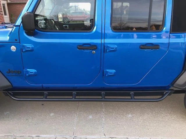

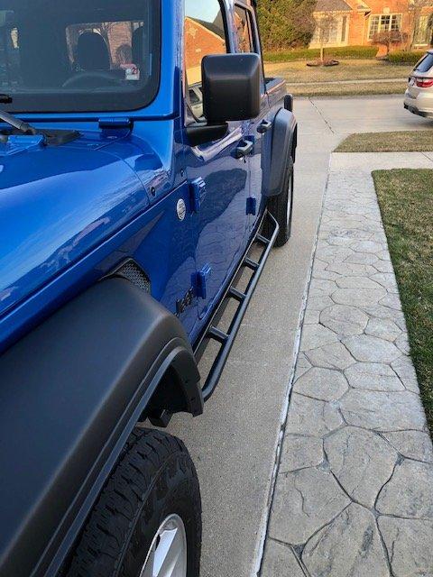

Installed my HardRock rock sliders today. I really like that they cover the pinch seam at the bottom of the body and also mount to the body mounts on the frame. Solid! Their down-angle should also serve as a reasonable step when I get 37s on. Despite the down-angle, they're still higher than all of the belly skid plates.
https://www.rockhard4x4.com/product_p/rh-80104.htm
Jeep Gladiator The BEAST Rock Sliders sid
Jeep Gladiator The BEAST Rock Sliders front

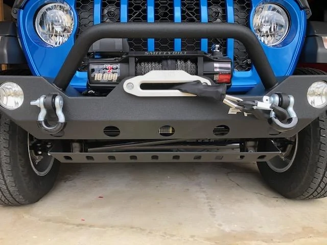

I mounted the skid plate rather than returning it. I really like both the bumper & the skid. I just don't like that they leave a 3" gap. Since EAG doesn't make a skid that will cooperate with their bumper, I decided to keep both & just cover the gap with a piece of sheet metal, screw it to the bumper with stainless self-tapping screws, and hit it with spray-in bedliner.
Before:
Jeep Gladiator The BEAST Skid ga
After:
Jeep Gladiator The BEAST Skid no ga
I think it'll last. If not, I'll devise a new solution. Suggestions welcome (in the event that this doesn't last).

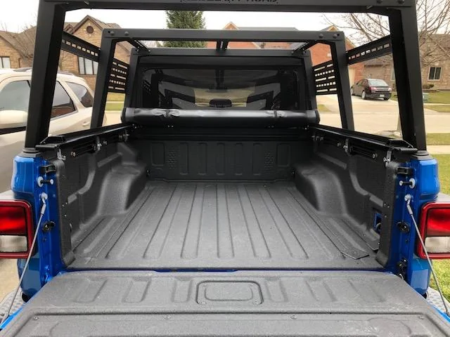

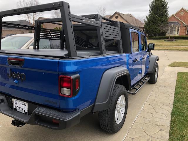

Big day today! I finished a few installs ... bed rack & tonneau cover, dash phone mount, and I also swapped the wheels/tires with my JLU.

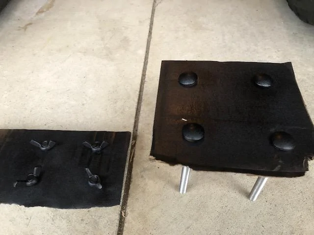

In order to transport my mtn bikes on the tailgate, I need to be able to remove the bed rack's rear crossbar. So, I replaced the sets of bolts on both sides of it with 5" long stainless carriage bolts & wing nuts. I coated the exposed surfaces with a spray bedliner so they will blend visually.
Jeep Gladiator The BEAST Tonneau closed
Jeep Gladiator The BEAST Bed Rack QR bolts
Jeep Gladiator The BEAST Bed rack tailgate open
The Bed rack & Tonneau combo was a little bit tricky. I applied some 5/8" weather stripping between the bed rack mounts to seal with the tonneau rails. I have to roll it, then shift one side to get it past the bed rack pillar, then continue to roll. I knew I'd have to do that going into the project, so I'm ok with it.
I also have the cap removed ... ready to wire & install 12v DC power to the bed. I'm just waiting on the parts.
Jeep Gladiator The BEAST Bed rack & Tonneau mounts

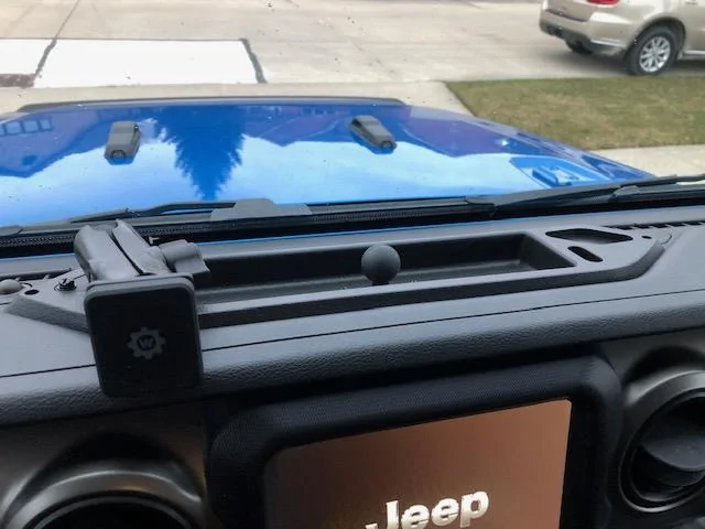

Here's the in-dash phone mount I'm using.
Jeep Gladiator The BEAST phone mount

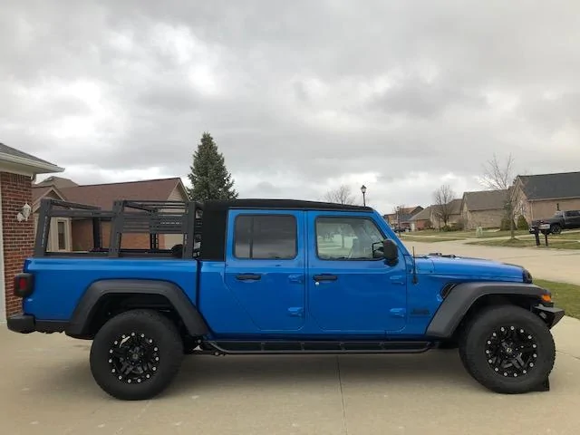

After the tire swap I took a few pics, profile & front. I have a lift ready to install this weekend. I'm just going to run these tires until they're worn out. I plan to replace them with 37" Patagonias at that time.
Jeep Gladiator The BEAST wheel swap profil

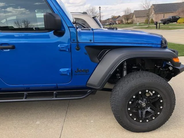

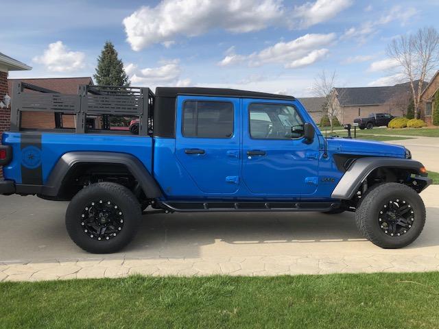

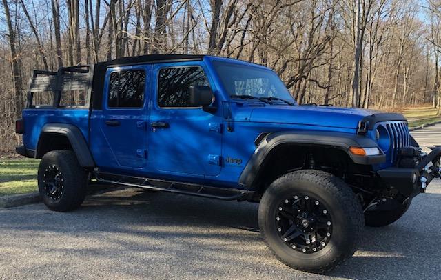

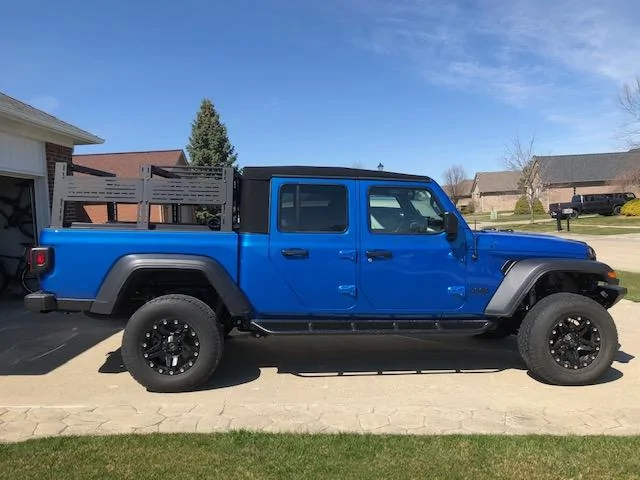

A buddy came over yesterday to give me a hand with my Mopar 2" lift. Within that install I added a 0.75" Daystar spacer to the front, and also installed my JKS quicker disconnect swaybar links. I left a slight rake intentionally. I want to get closer to level and still prevent that saggy back end look despite moderate cargo.
It was a nice break from social distancing. We were chatty ... Jeep stuff, COVID, politics, family, hopeful upcoming trips, etc. We wrapped up at dusk, so we went to a local parking lot that works well for adjusting headlights. (He's been getting flashed for 8 months after his 2.5" lift and 35s on his JLU) We got flashed by almost every vehicle on the way to the lot. Having done the adjustment on my JLU in 2018, we were able to properly adjust his JLU & my JT headlights very quickly. No one flashed us on the way home. :like:
I took some pics of the lifted JT this afternoon just before my wife and I went for a hike on some nearby trails.
Jeep Gladiator The BEAST Lifted
Jeep Gladiator The BEAST Lifted at trail

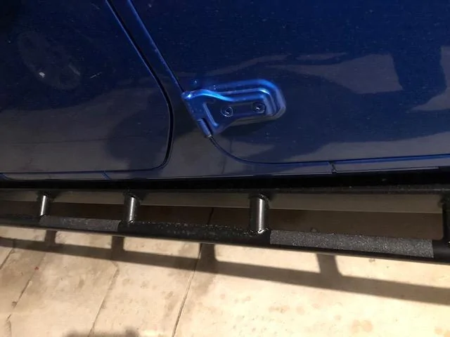

The paint on the rock sliders is pretty smooth, so I cut & applied strips of grip tape to the spots used as steps. In person, you can hardly tell the tape is on the rails. The picture conveniently created contrast showing tape more clearly.
Jeep Gladiator The BEAST Grip Ta

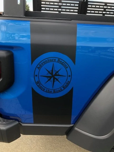

My Etsy vinyl decals arrived ... mtn biker, rock climber, and "Adventure Begins Where The Road Ends" circle. I also received the 1.5'x5' roll of satin black vinyl wrap to measure/mask, cut, and apply to the inset area near the front fender flare as well as the 'ribbon' above and below the 'adventure' decal in the rear.
Youtube videos of vinyl wrap application make it look reasonably easy. While I'm happy with the result, the recessed area behind the fender flare pushed my youtube education to the limit. :whew:

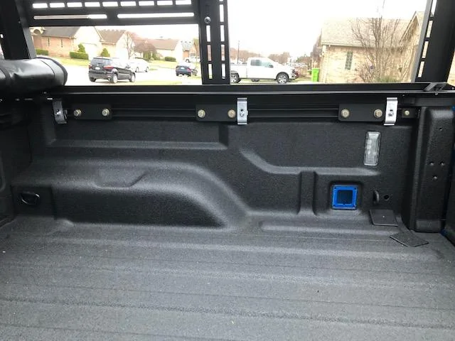

I now have my main front to back wire terminating at an Anderson style connector for my air compressor. I tied into that line for a pair of 12v cigarette outlets with a 30amp inline fuse as well as a double USB outlet with a 5amp inline fuse. This is all currently connected to my Aux 1 wire in the engine compartment (with its 40amp fuse).
Wired & ready to test before mounting.

Supplied screws wouldn't 'self tap' despite pre-drilling holes almost as large as the outer edges of the threads. I used some 1/2" self tapping stainless screws for now. I may end up painting the heads of them.
