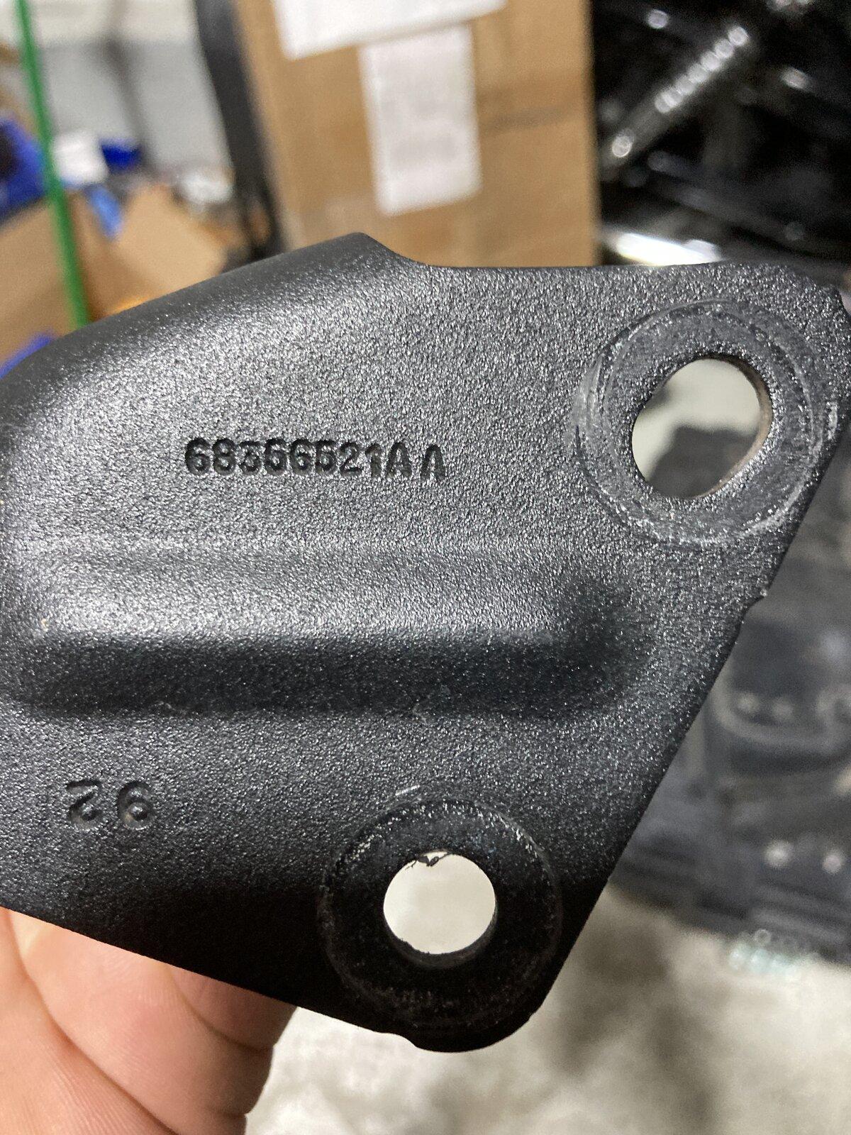

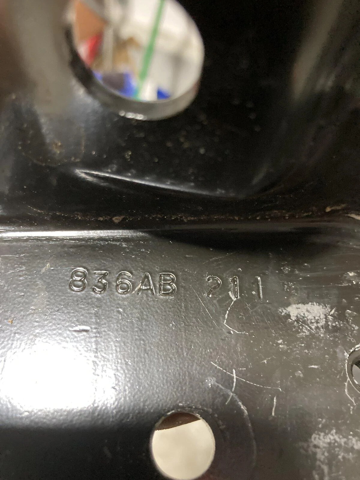

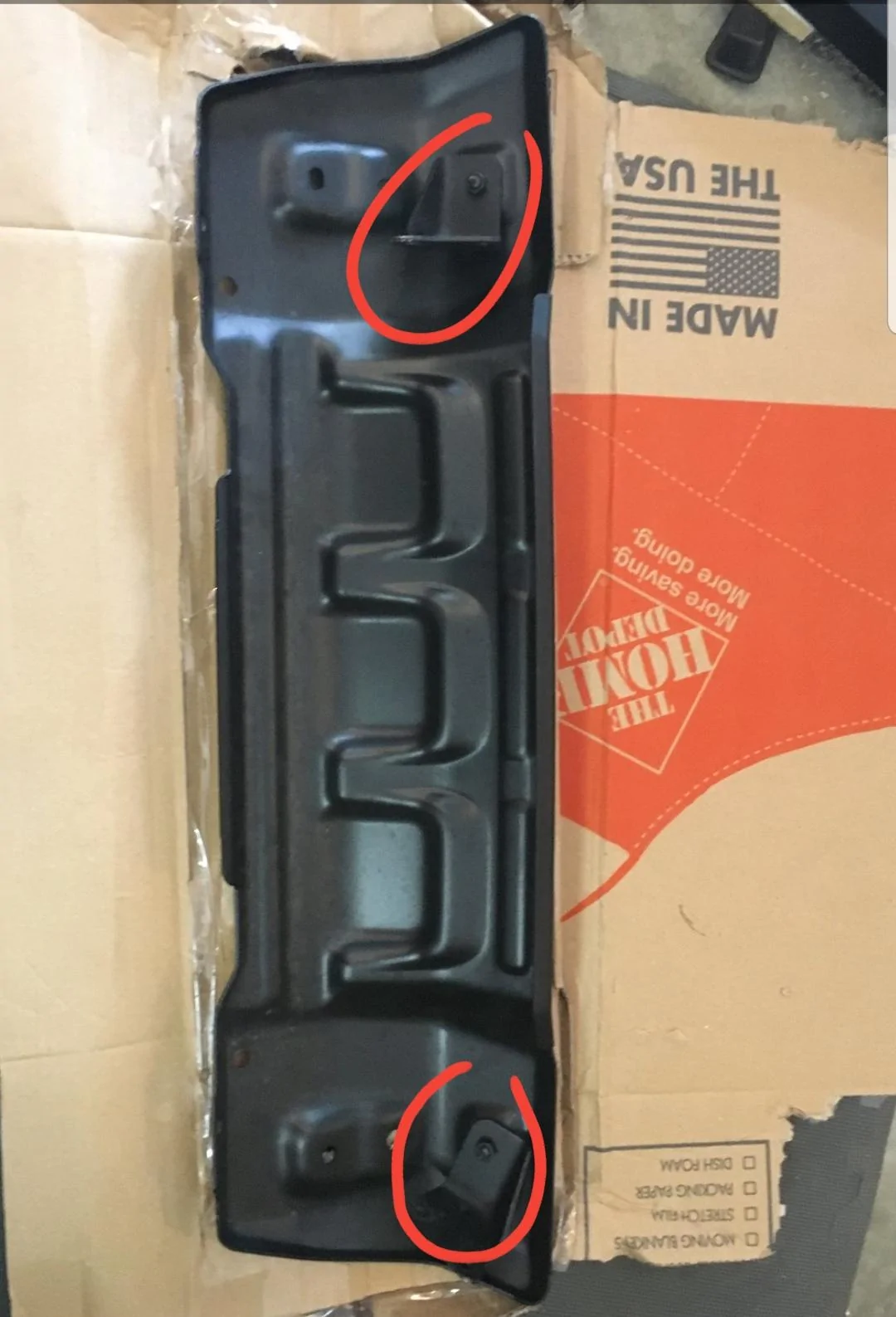

So my skid plate I got from a Rubicon take off doesn't have the brackets I circled in red. Can you confirm if the following parts is still all I need to attach to my rubicon take off steel front bumper? Or do I need those brackets circled in red also? If so are there part numbers for them too?
Part Number Part Name Price QuantityTotal
68353836AB Skid Plate Bracket, Right $8.27 1 $8.27
68353837AB Skid Plate Bracket, Left $8.27 1 $8.27
6104414AA Hex Head Bolt And Coned Washer $2.70 8 $21.60
6511076AA Nut/Rivet $2.70 8 $21.60
6512587AA Screw $1.13 2 $2.26
When I had it on I originally only had the bottom brackets, it was solid for driving but as a legit skid id want both.
Bottom bracket
Jeep Gladiator The Overcon 0CF7E3AA-C2C0-40DB-AACB-C923A1F76DB0
Top bracket
Jeep Gladiator The Overcon 040C5511-59F9-4A28-A57D-F01DA3BEDA56

I got the parts list off another thread, you need top and bottom brackets revnuts and bolts. Be careful not to over tighten the rev’s easily stripped out, no gun!, hand only.
The ones in the picture are the top ones, I think, I’ll look.

Mine came with the top brackets and bolts. I don’t have the part #’s but they are here on another thread.

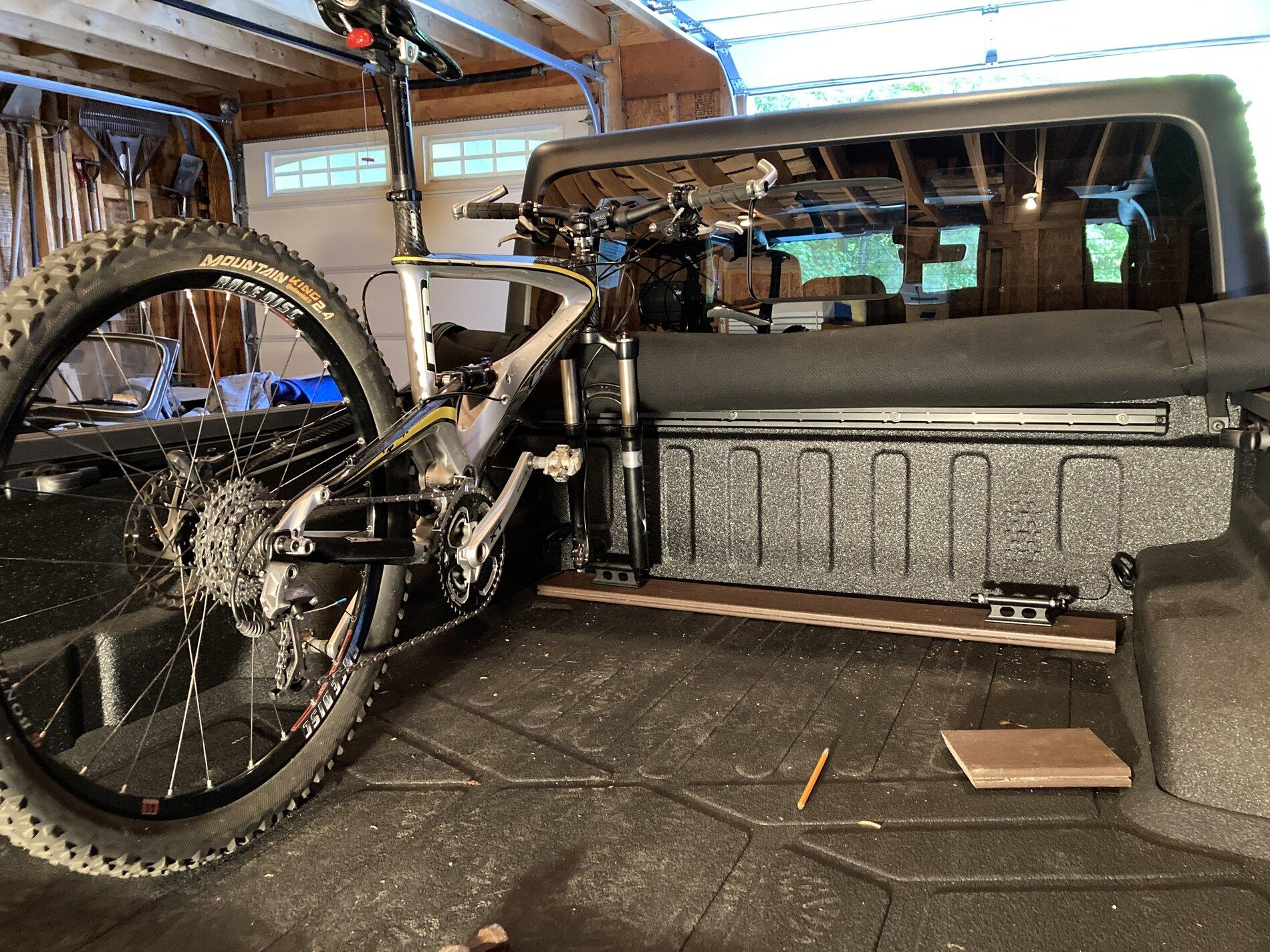

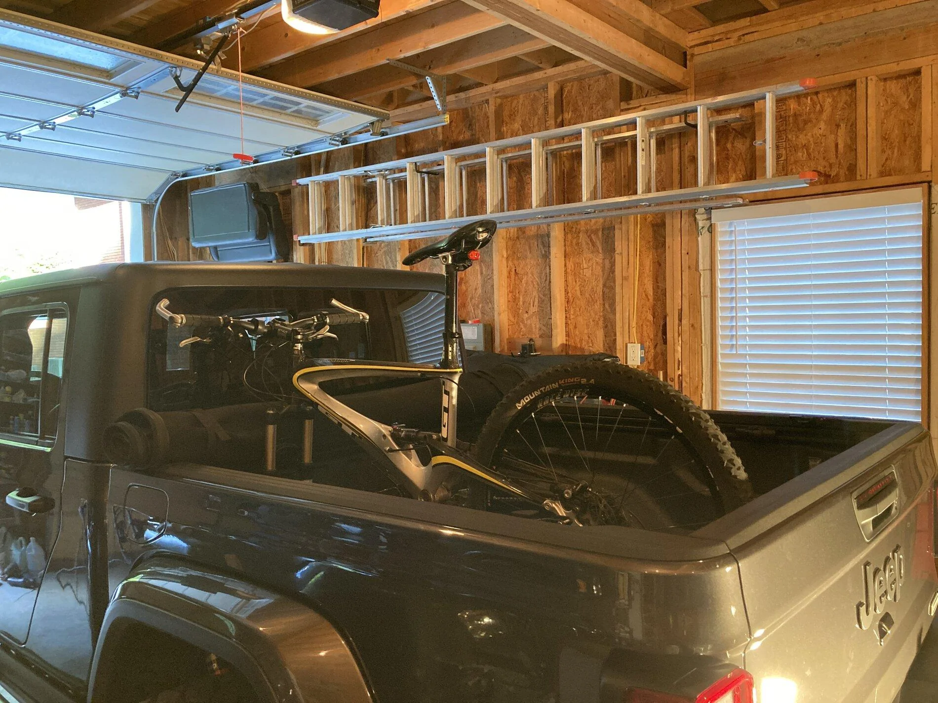

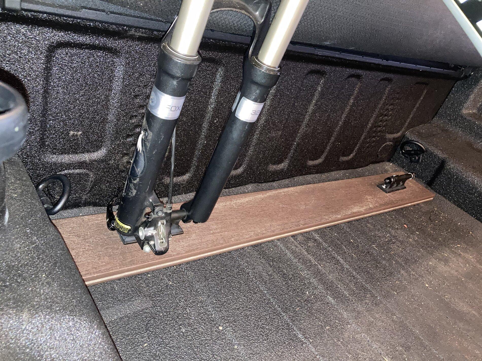

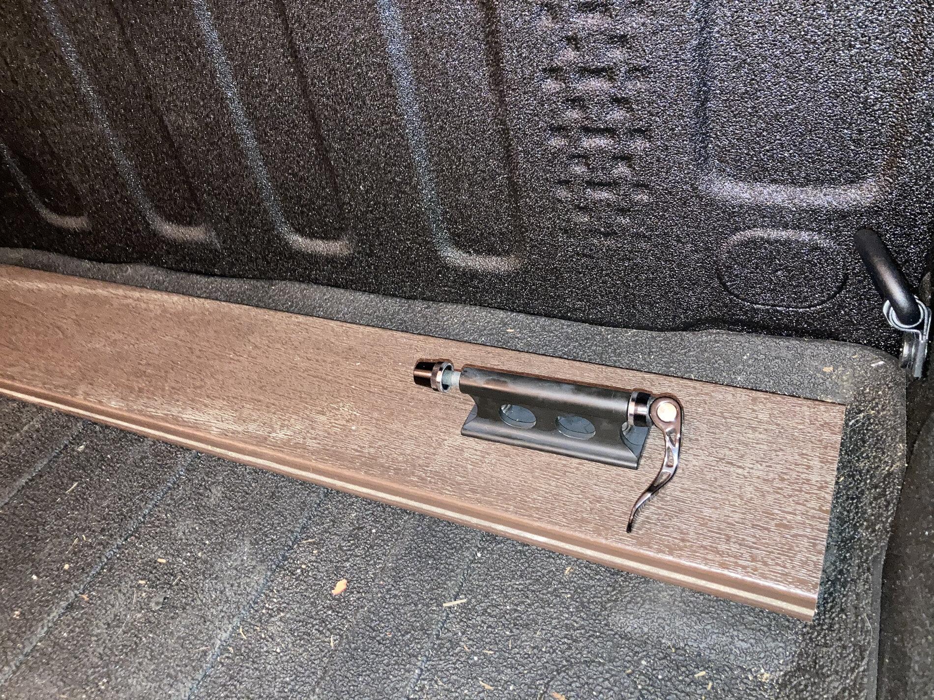

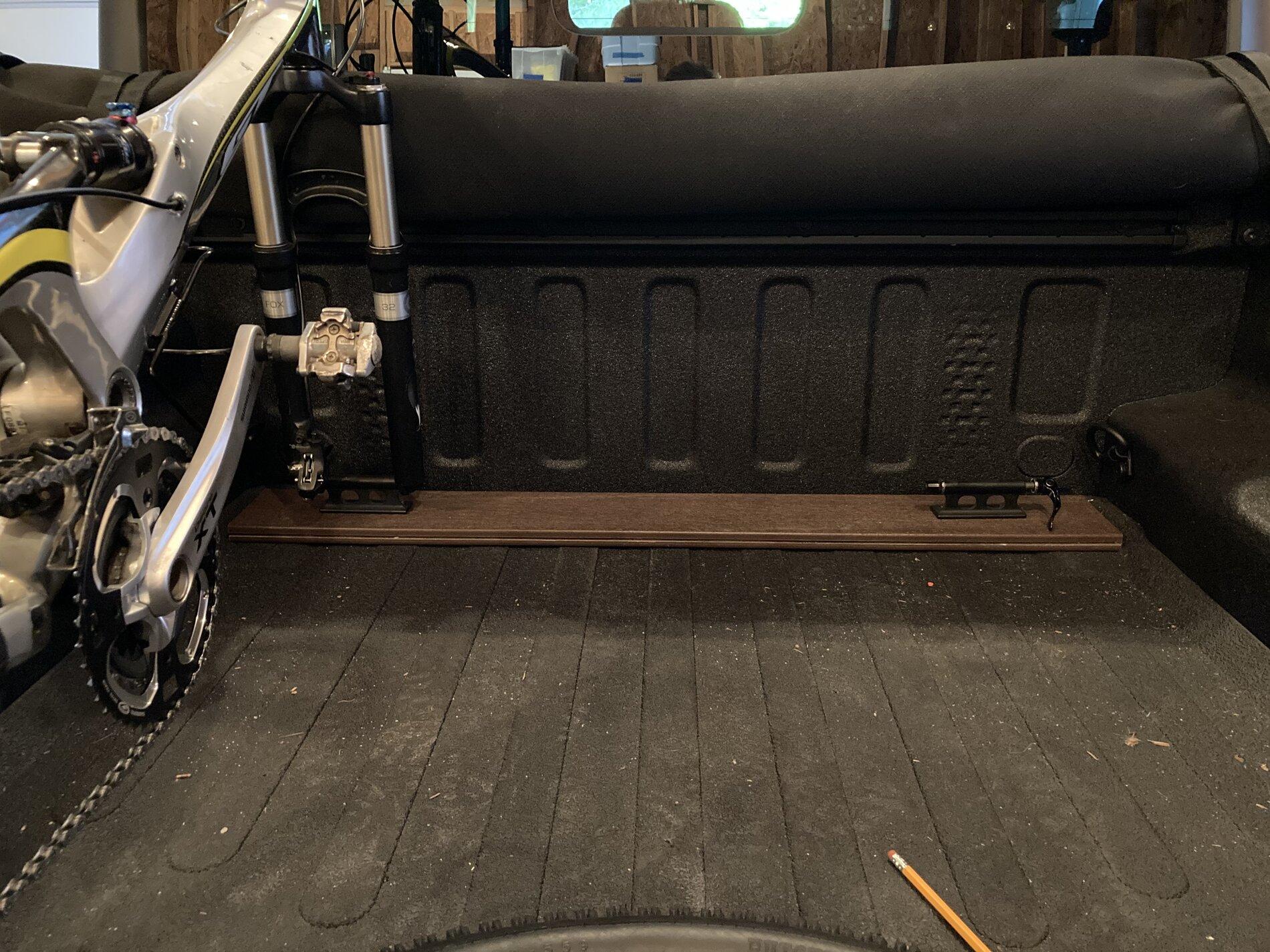

Made a dual bed bike rack.
Scrap decking and skewers I had from a tray rack.

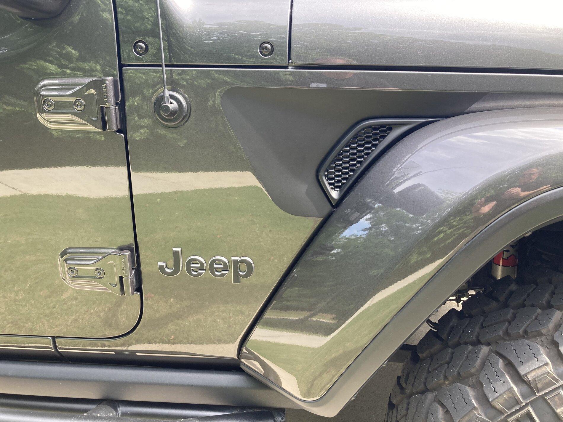

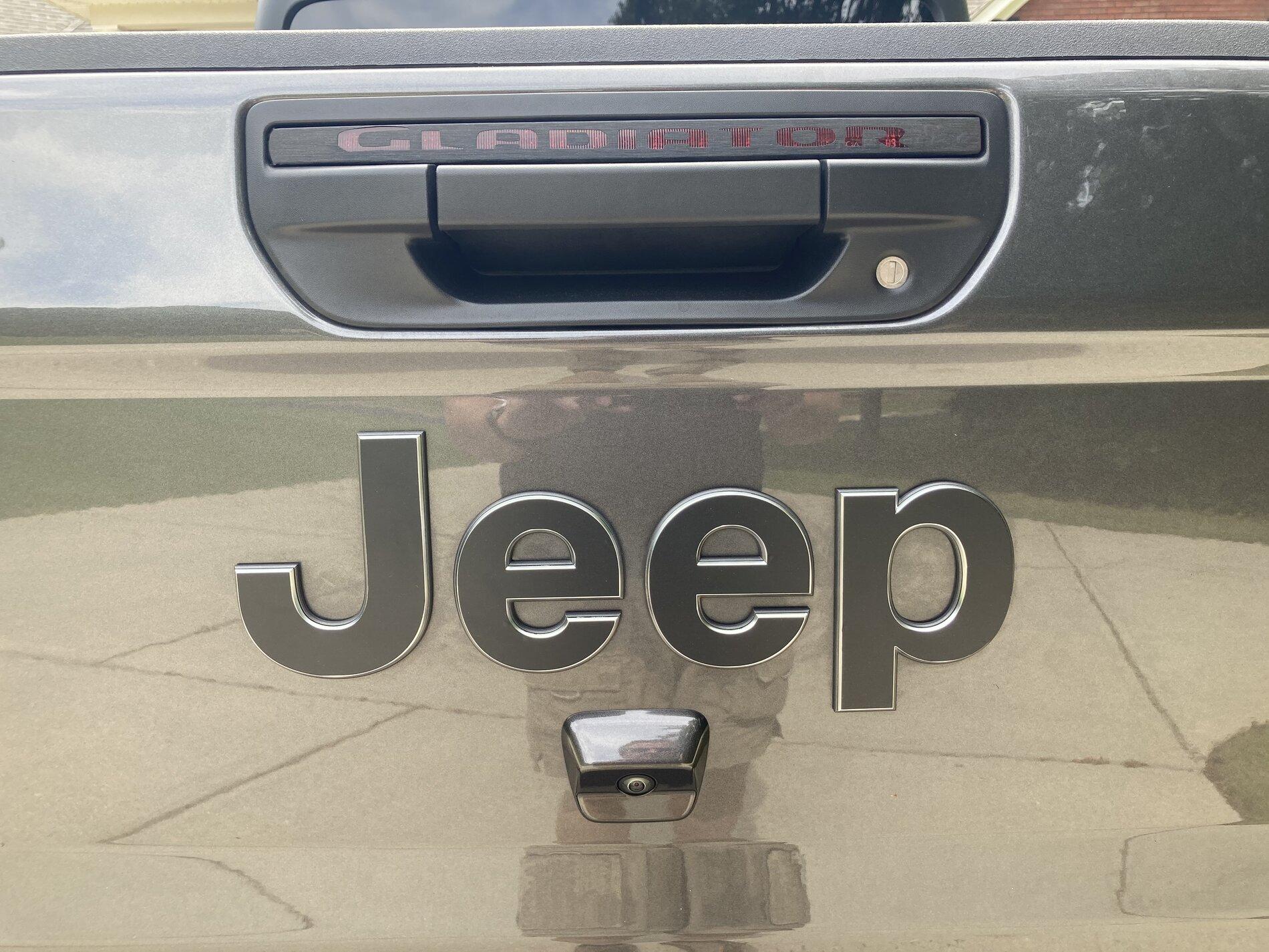

Cove Black Out and Chrome tone down. Removed Gladiator decals.

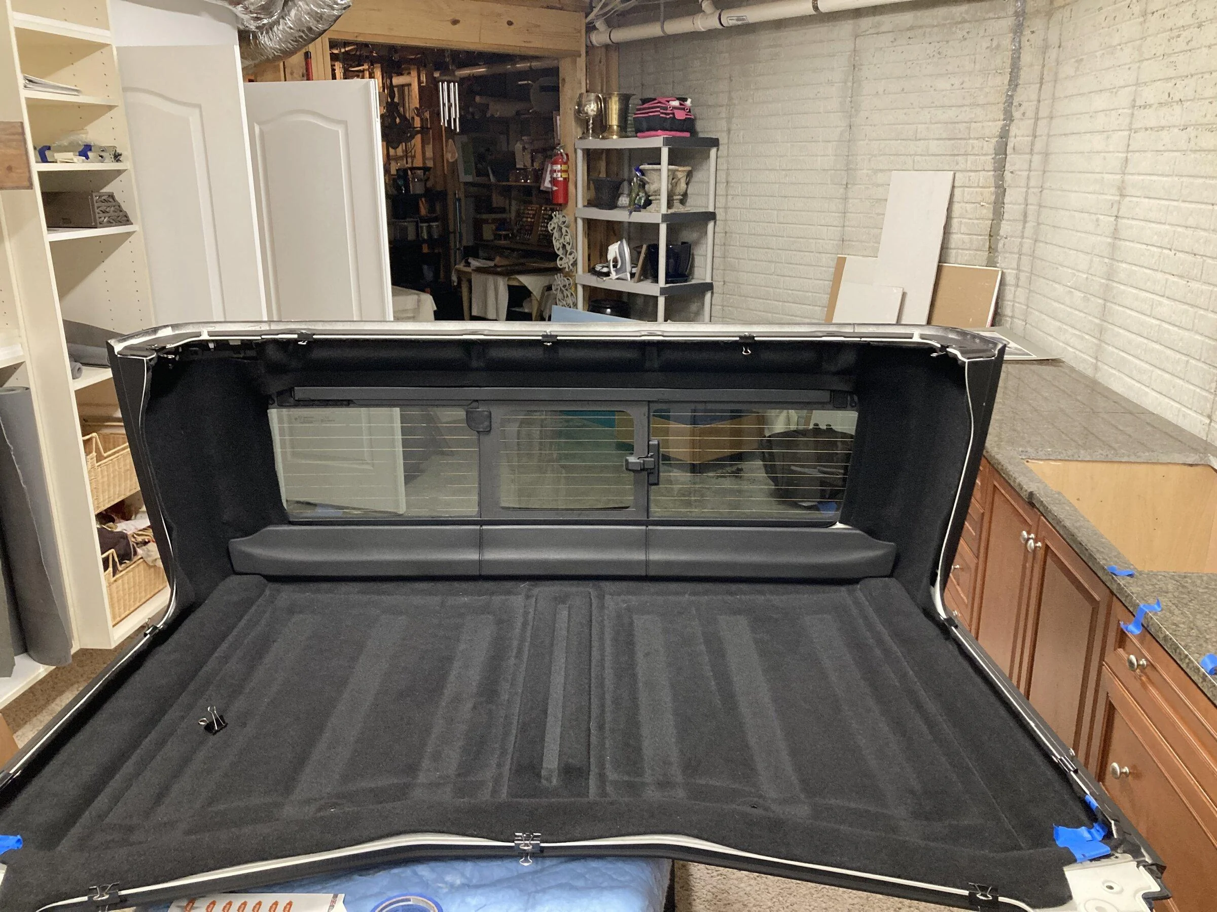

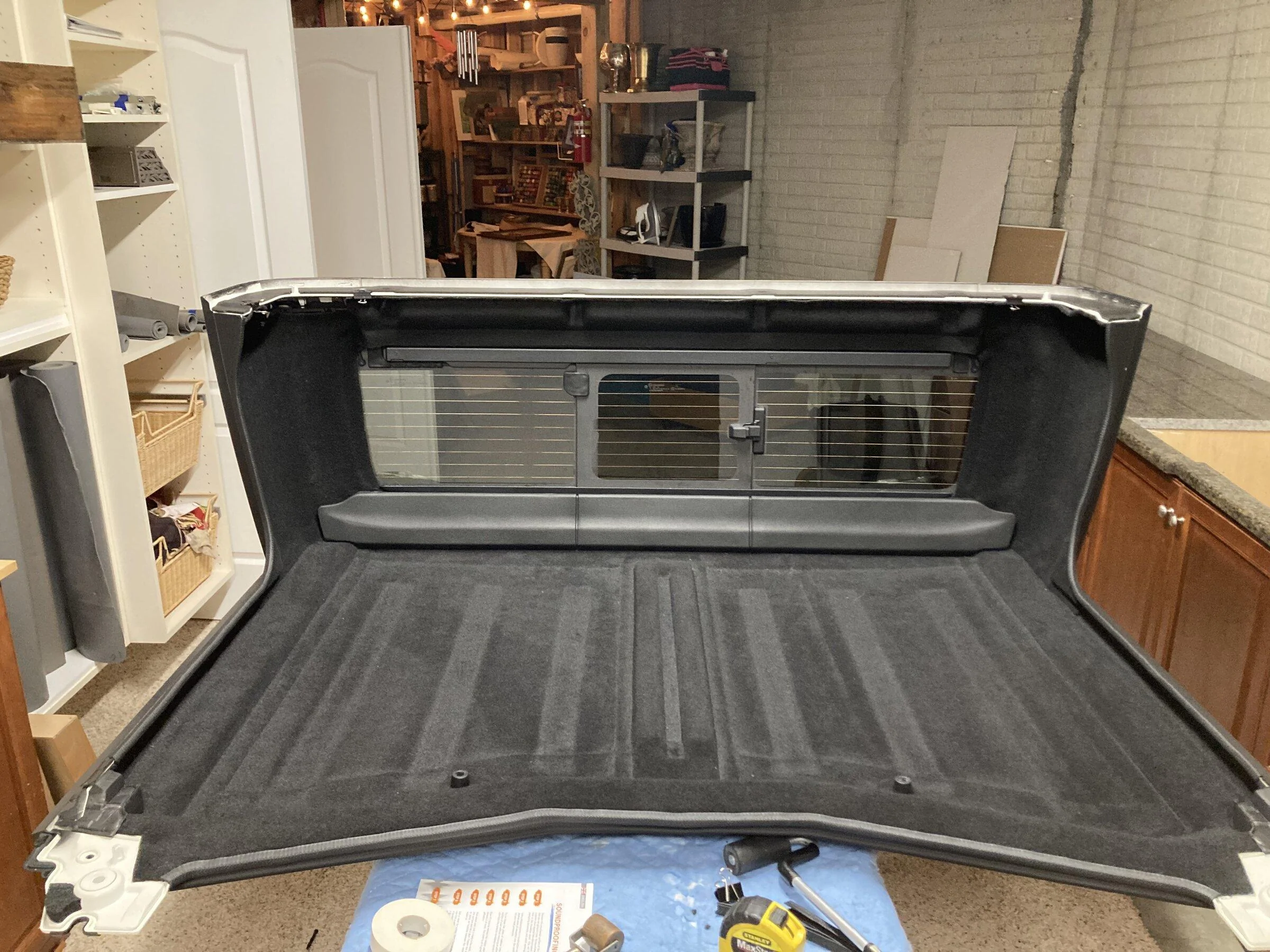

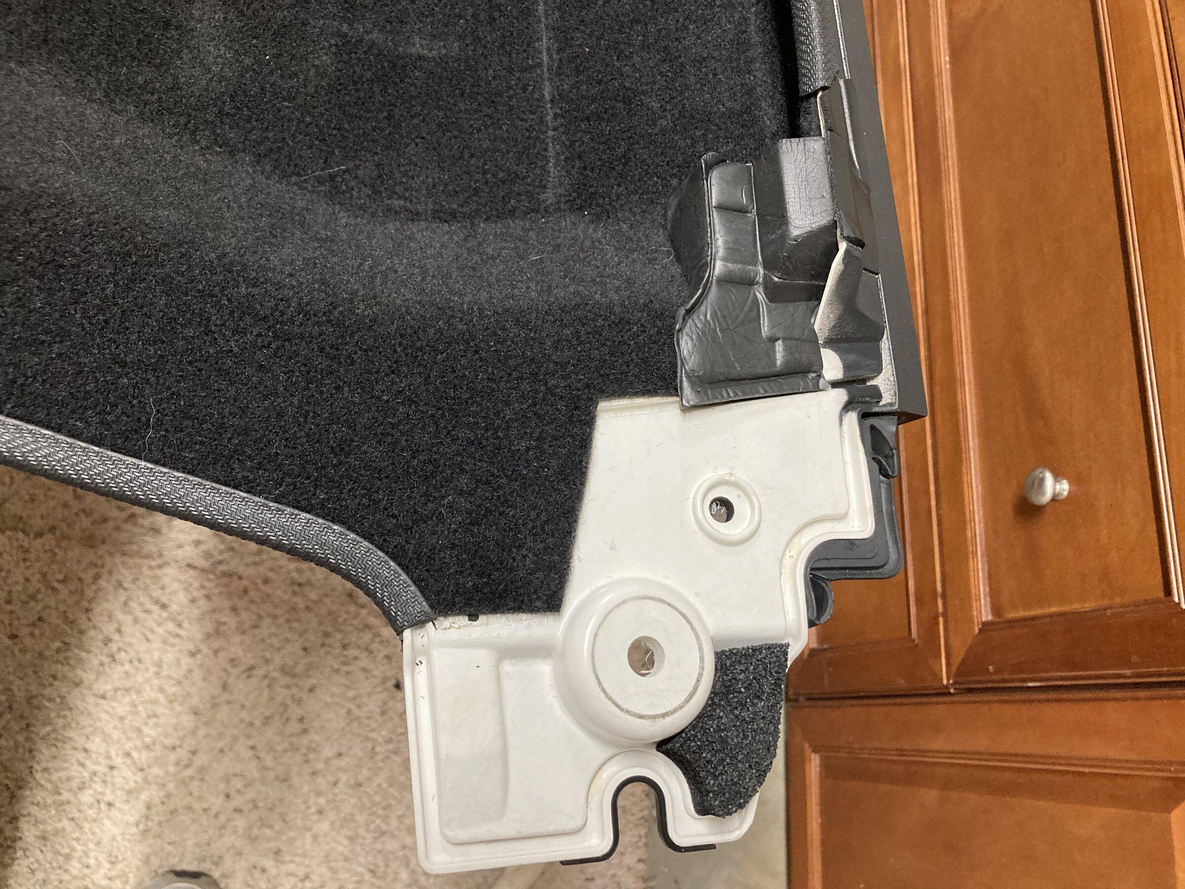

Got the Coverking Topliner, Stage 1 Done āœ….
Freedom panels with Kilmat.
Jeep Gladiator The Overcon 9EC8B23C-2B67-4A8D-9890-BD8528E4AB01
Jeep Gladiator The Overcon 3E532DD1-D88D-4794-8E52-80B0E548776F
Jeep Gladiator The Overcon 87150C1B-FC33-4549-92C8-3A1A185AF553
Jeep Gladiator The Overcon CA61DF7C-B69C-4A2C-93EE-12C54F0F778E

Since you have started installing your Coverking topliner, how do you like the fit and quality of the material? How much clearance/room did you have for sound deadener? I just received my topliner and getting ready to order sound deadener.
Buzzlb
Buzzlb
James
Nov 13, 2019
411
772
Atlanta
Gladiator Overland: The Overcon ā€˜82 CJ-7
Plenty of clearance, I didn’t want to go all the way to the edge with the Killmat but I think you can, fit is really good, had to cut out some of the holes (not stamped out) and one of the emblems poorly sewn.
Happy with the look, sound and final outcome ?
Sound deadening is a Must Do!
The material is thin/cosmetic, little or no sound &heat benefit with out it?

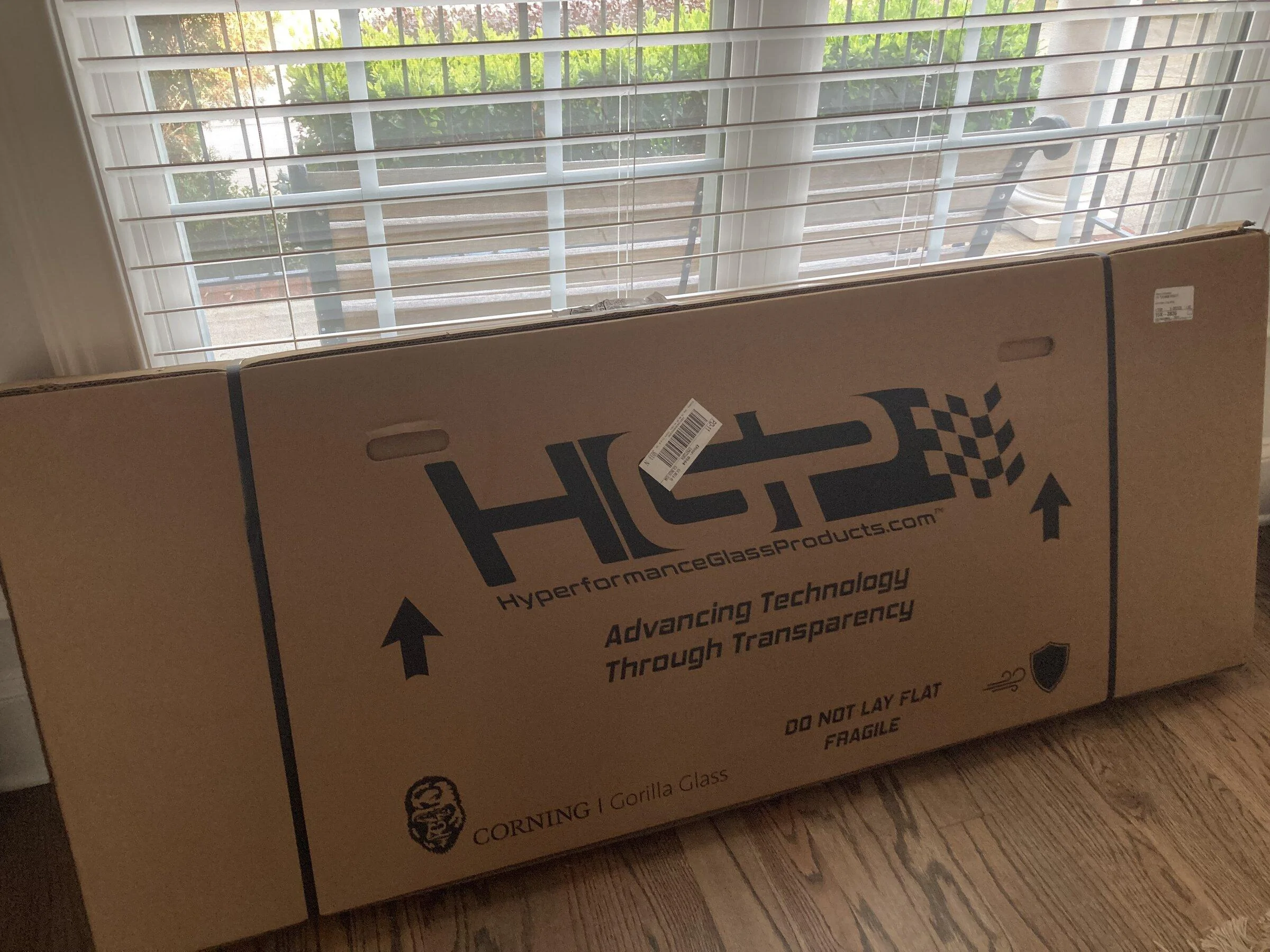

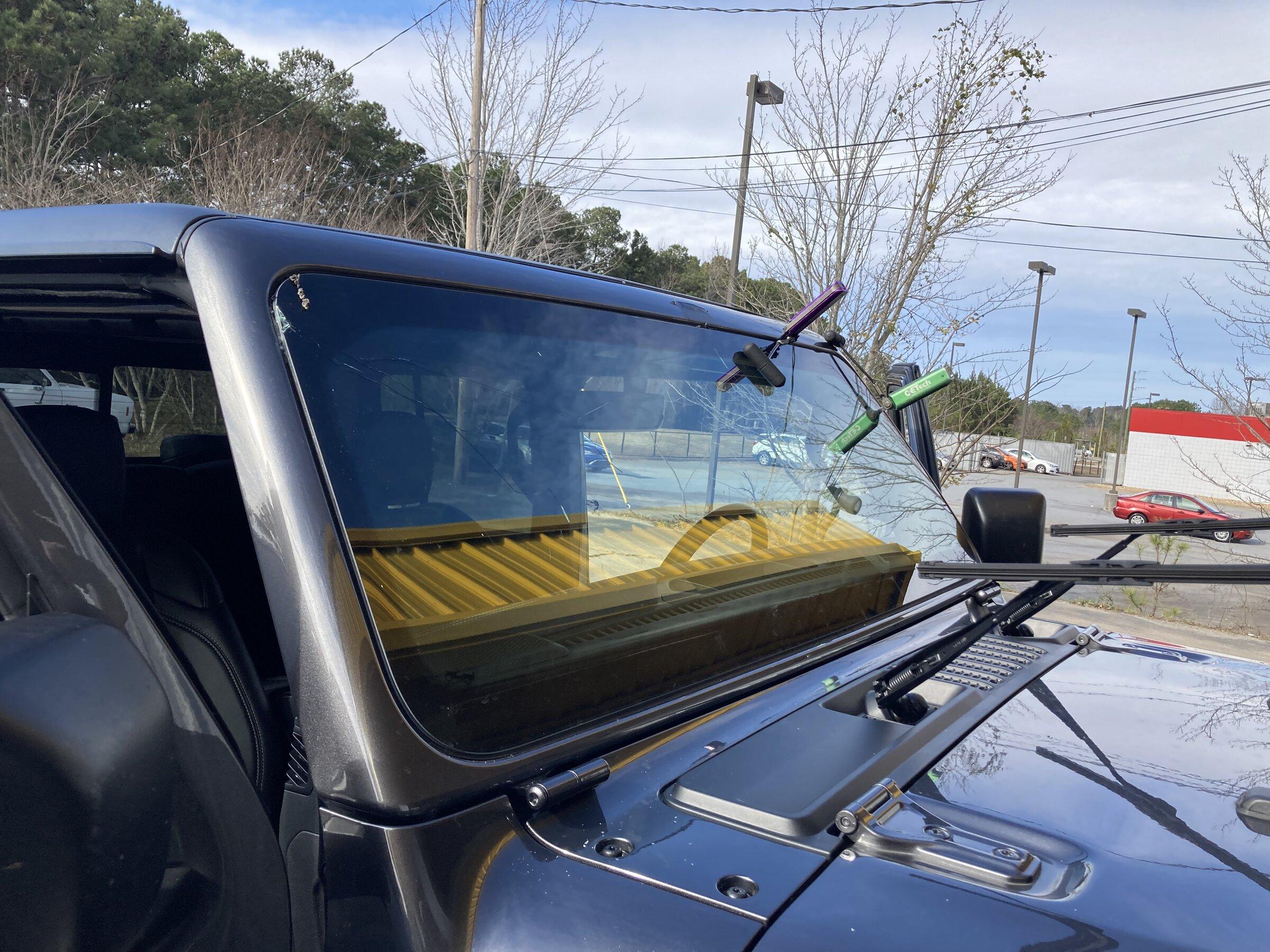

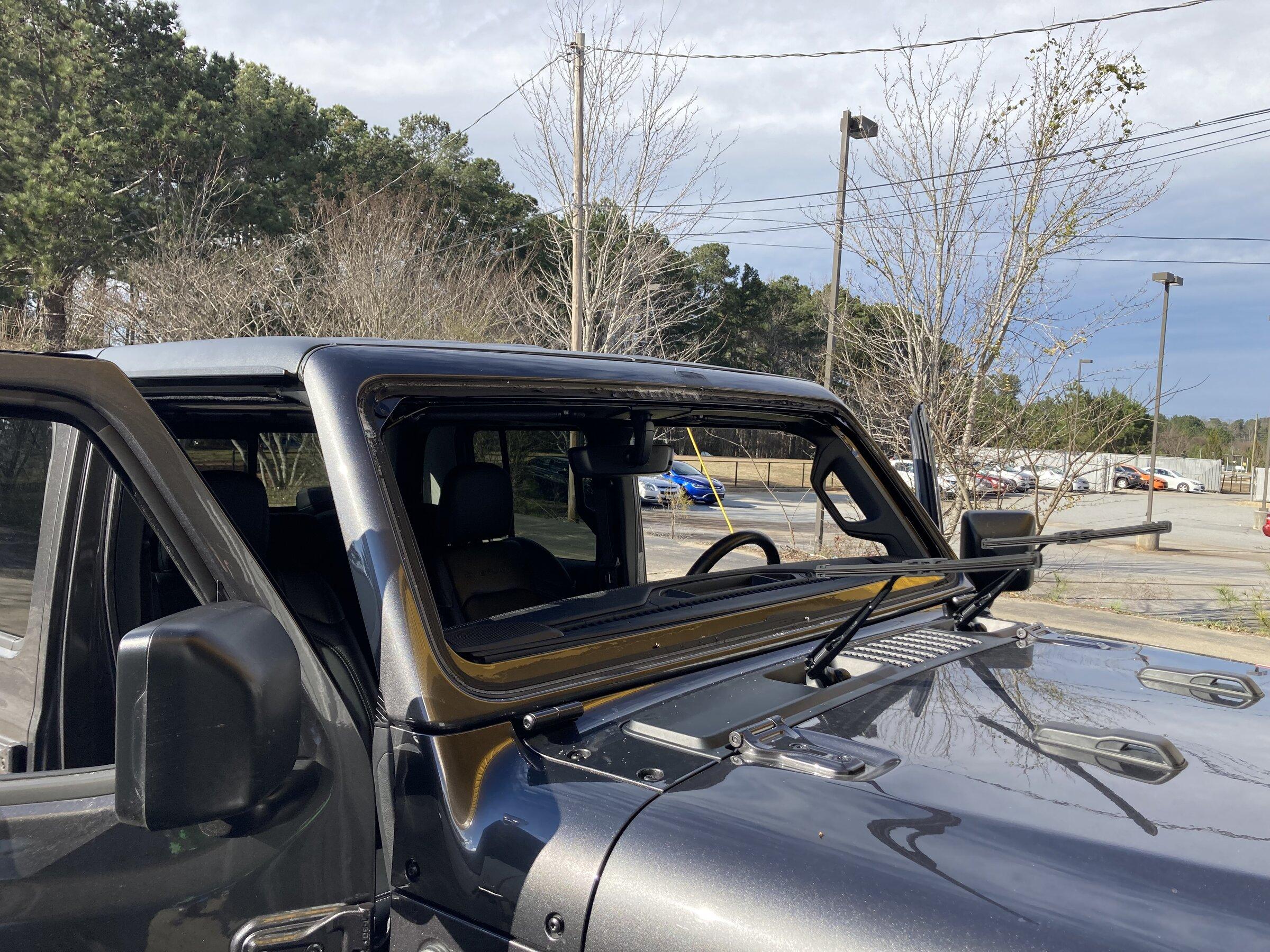

Got a new shield.
Jeep Gladiator The Overcon C304D41C-C4AC-4926-84C4-9676DFC723CB
Jeep Gladiator The Overcon A4C661DD-7A72-4C3F-8699-E56EF984CF77

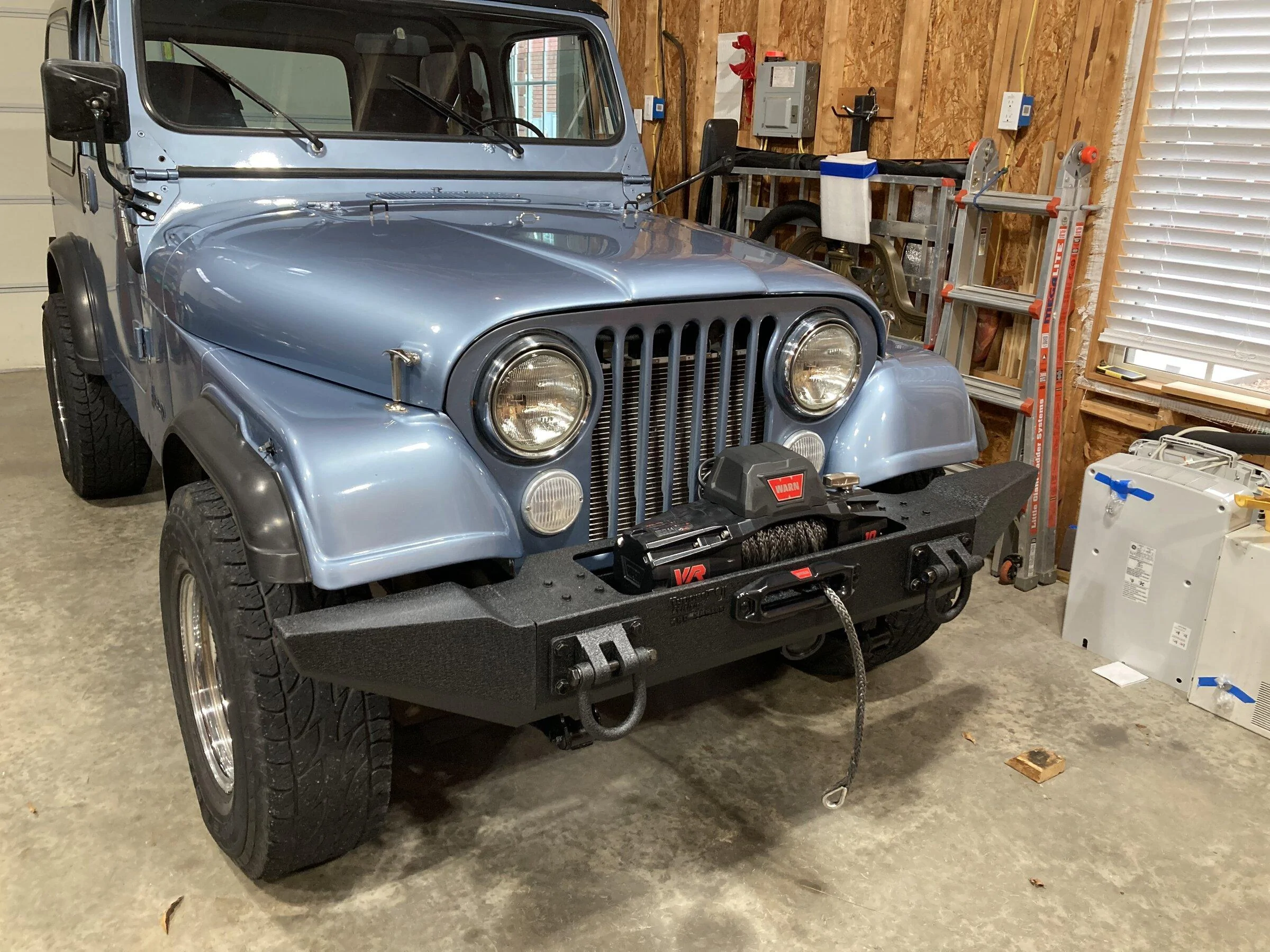

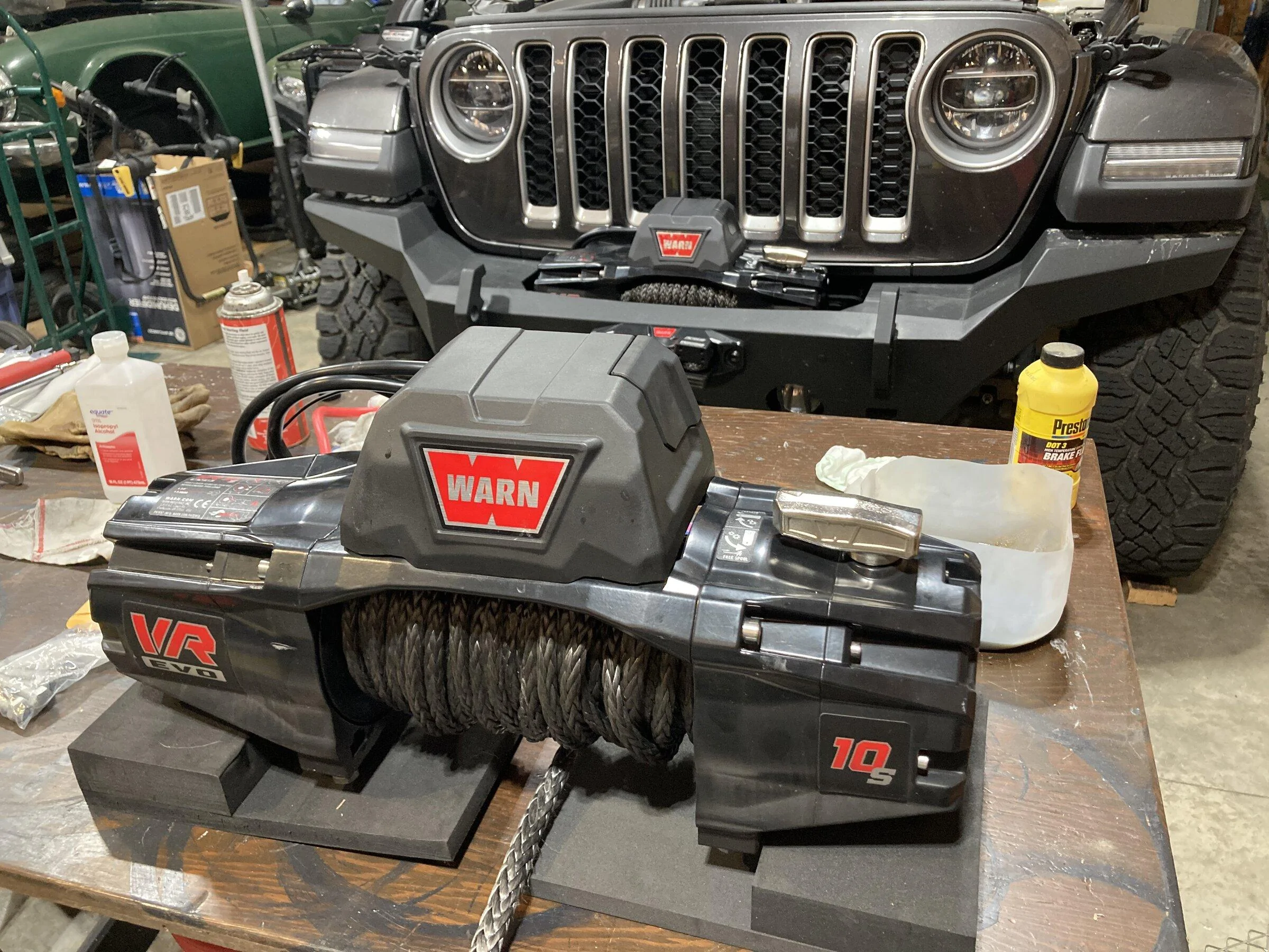

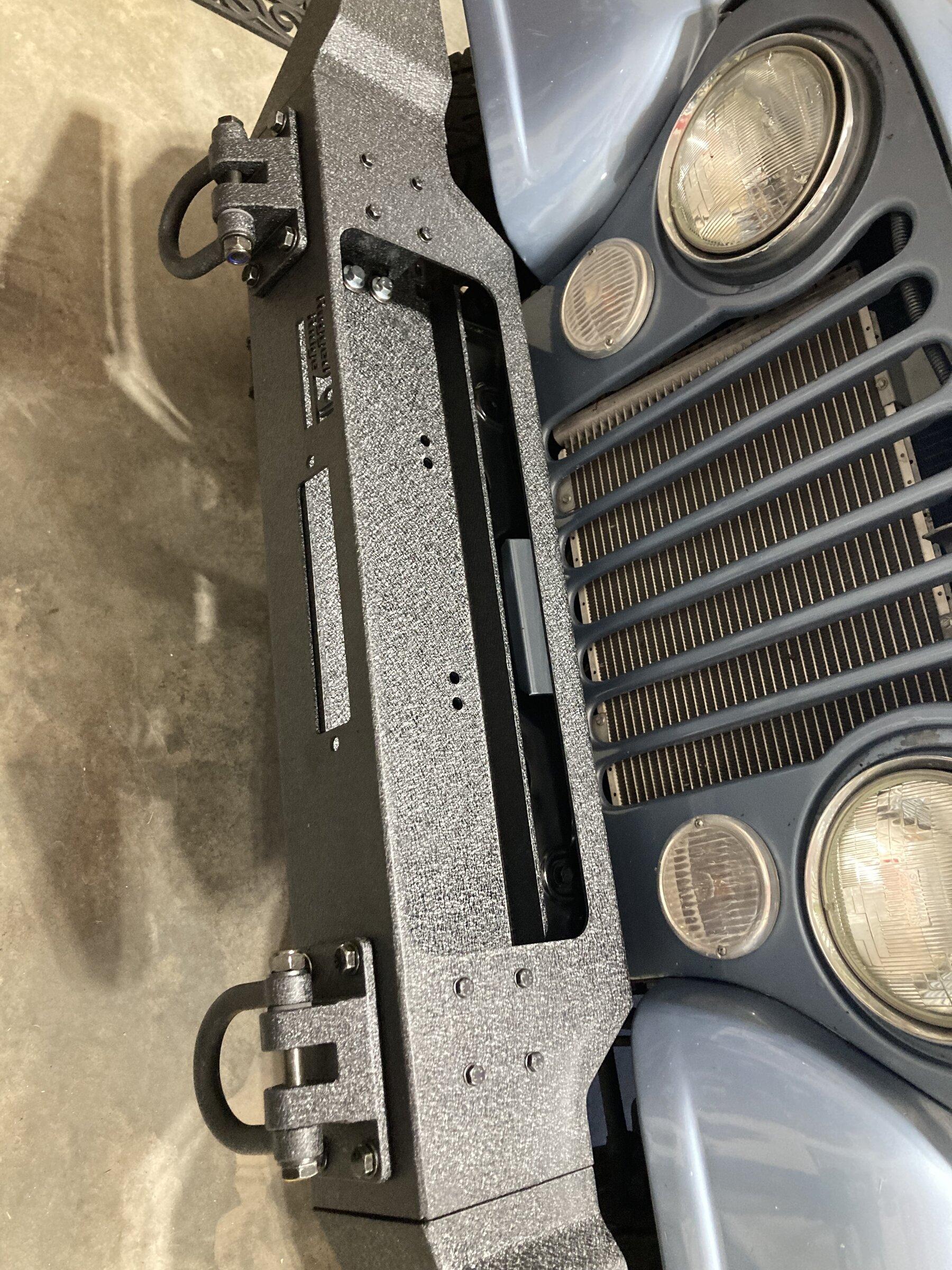

Swapped out the 10s for a 12s I got off eBay for less than the 10s.

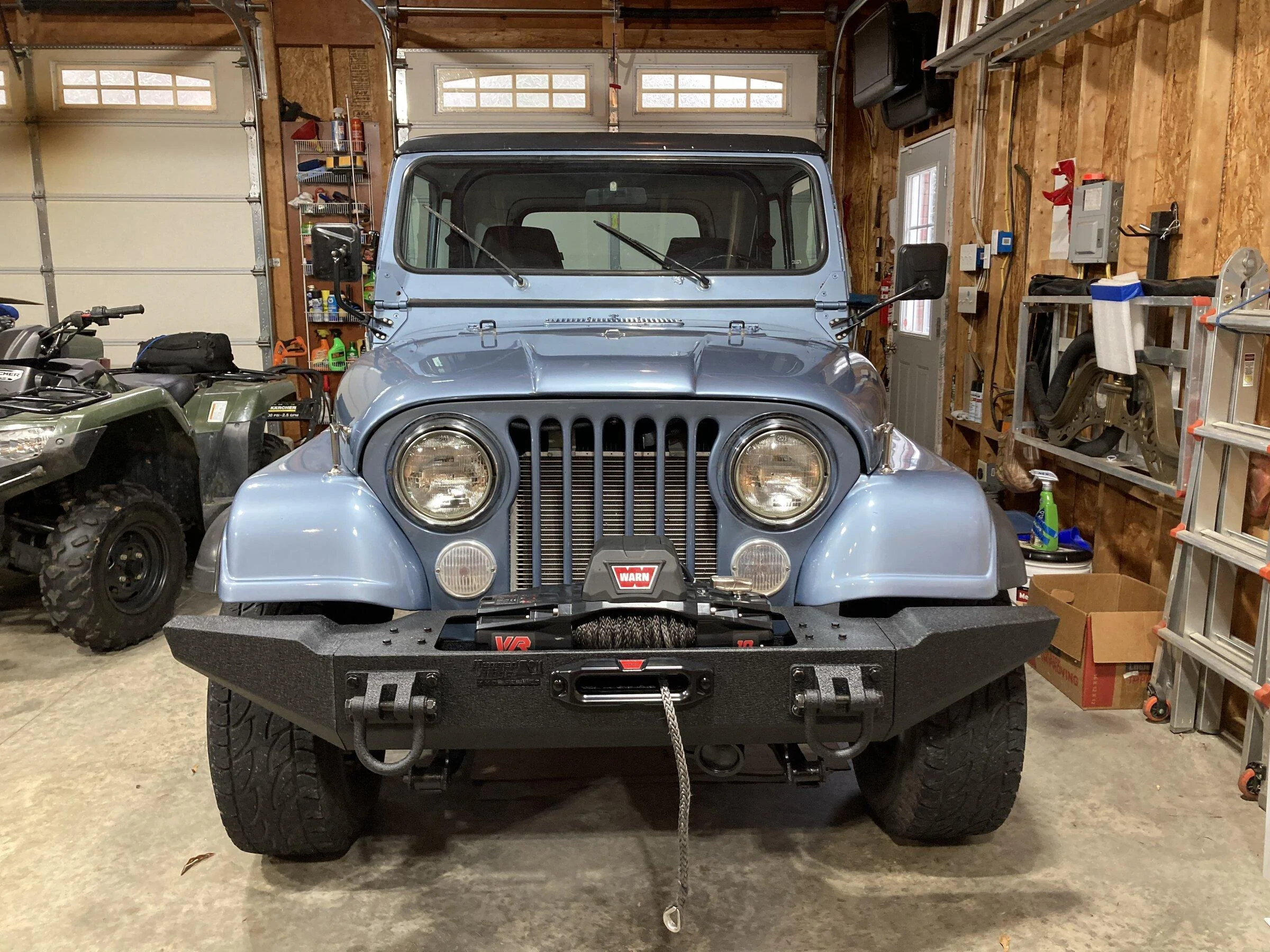

Got a new bumper for the CJ-7, had to fill in the hole…..

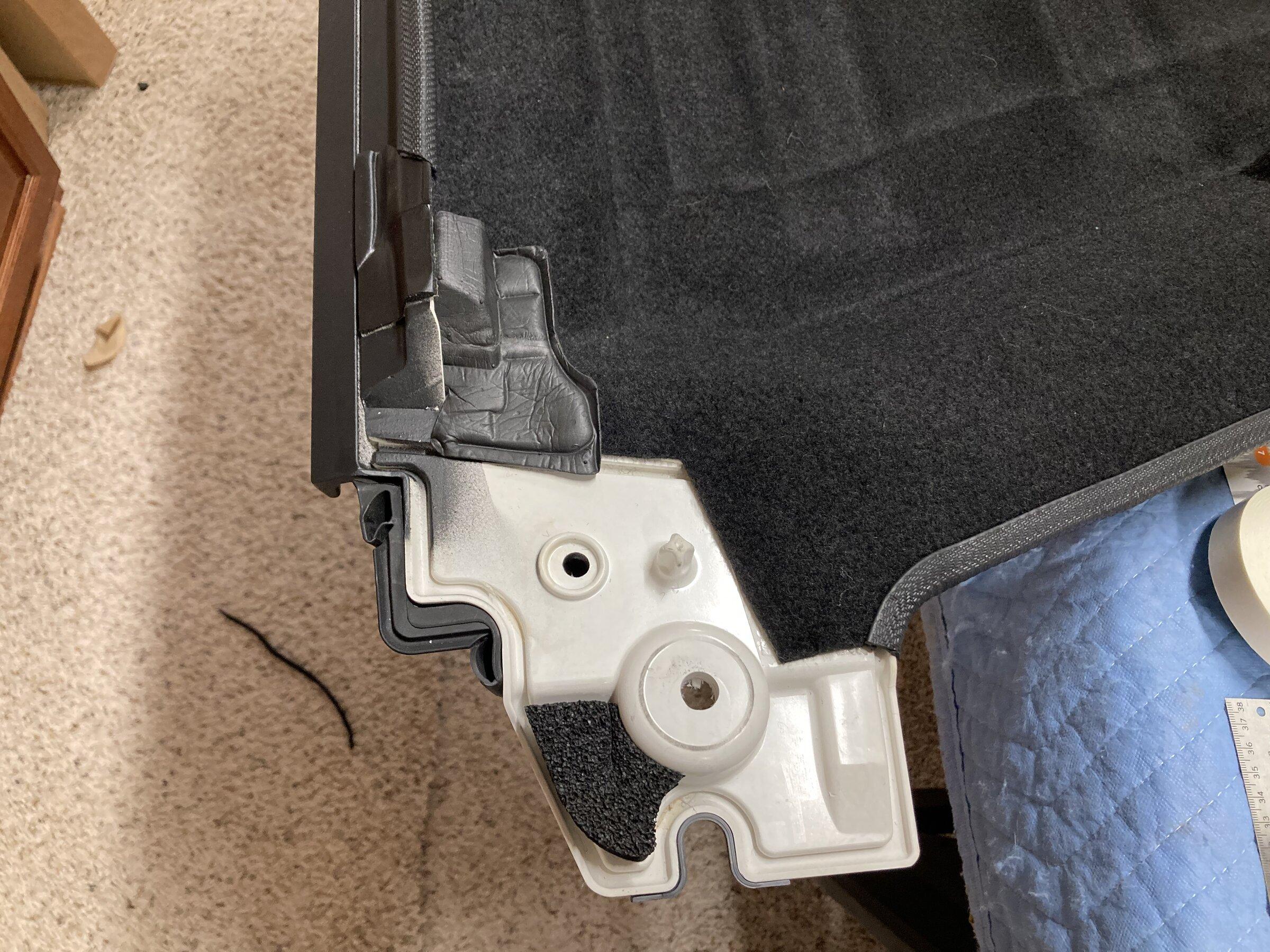

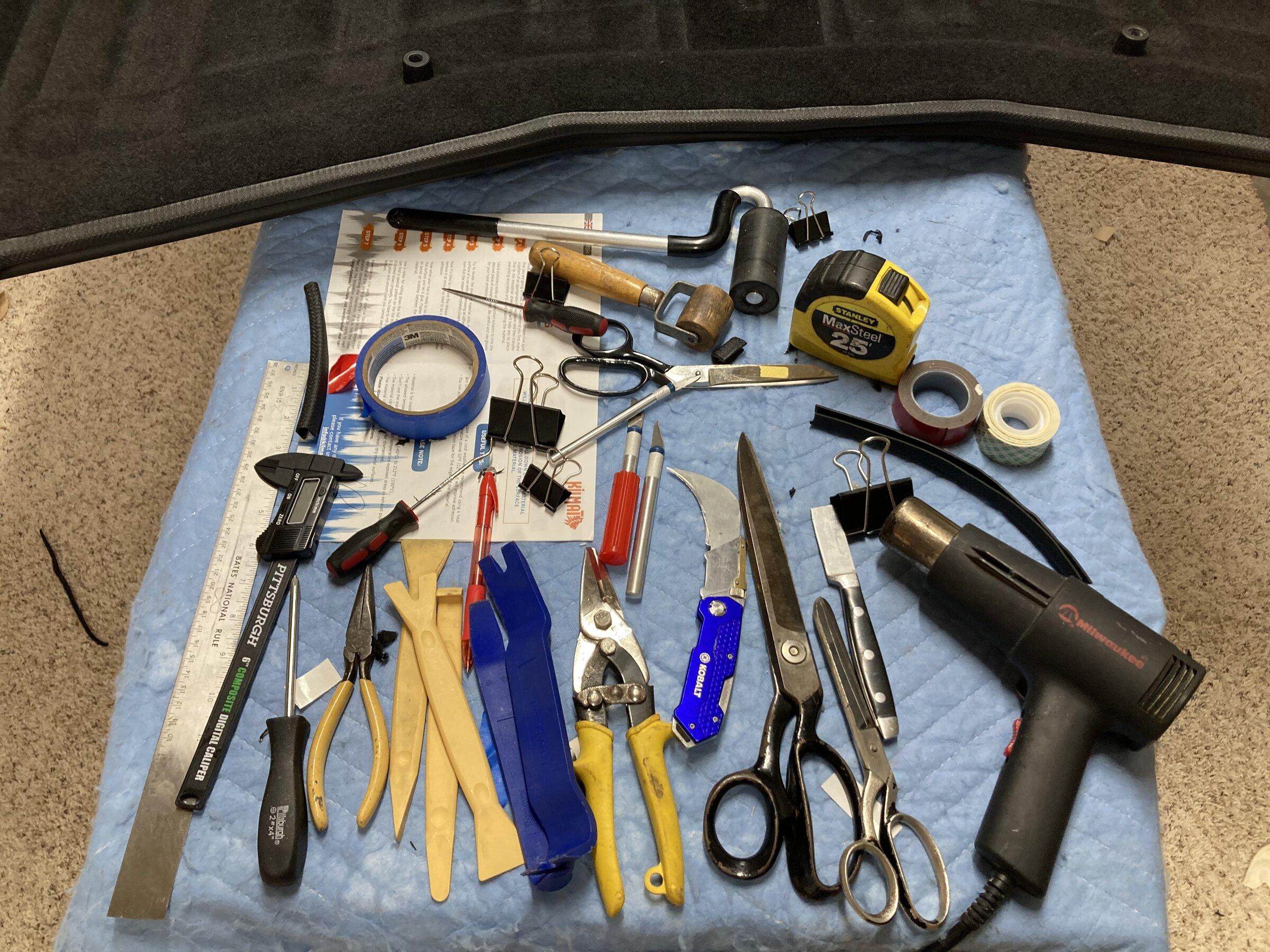

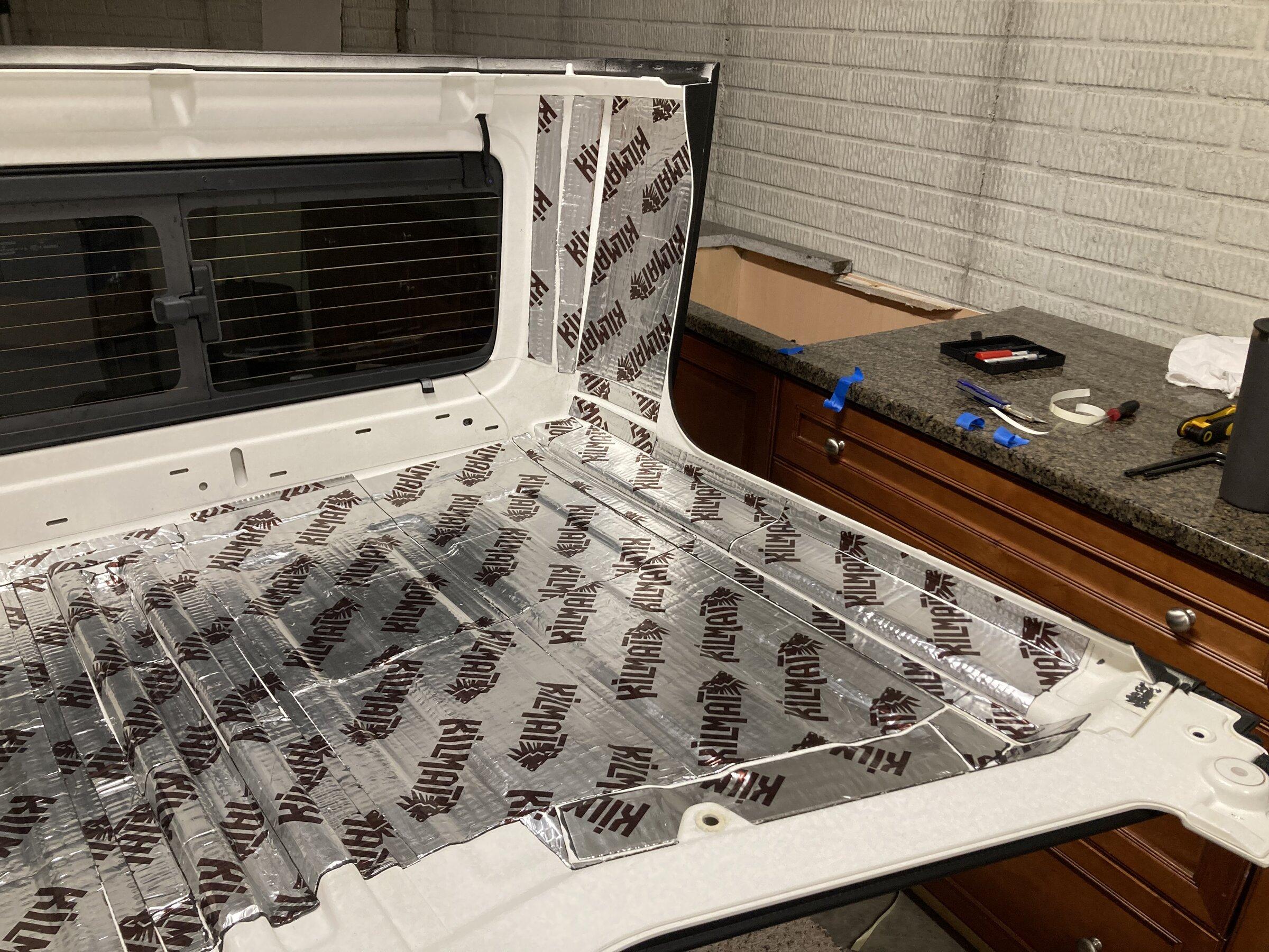

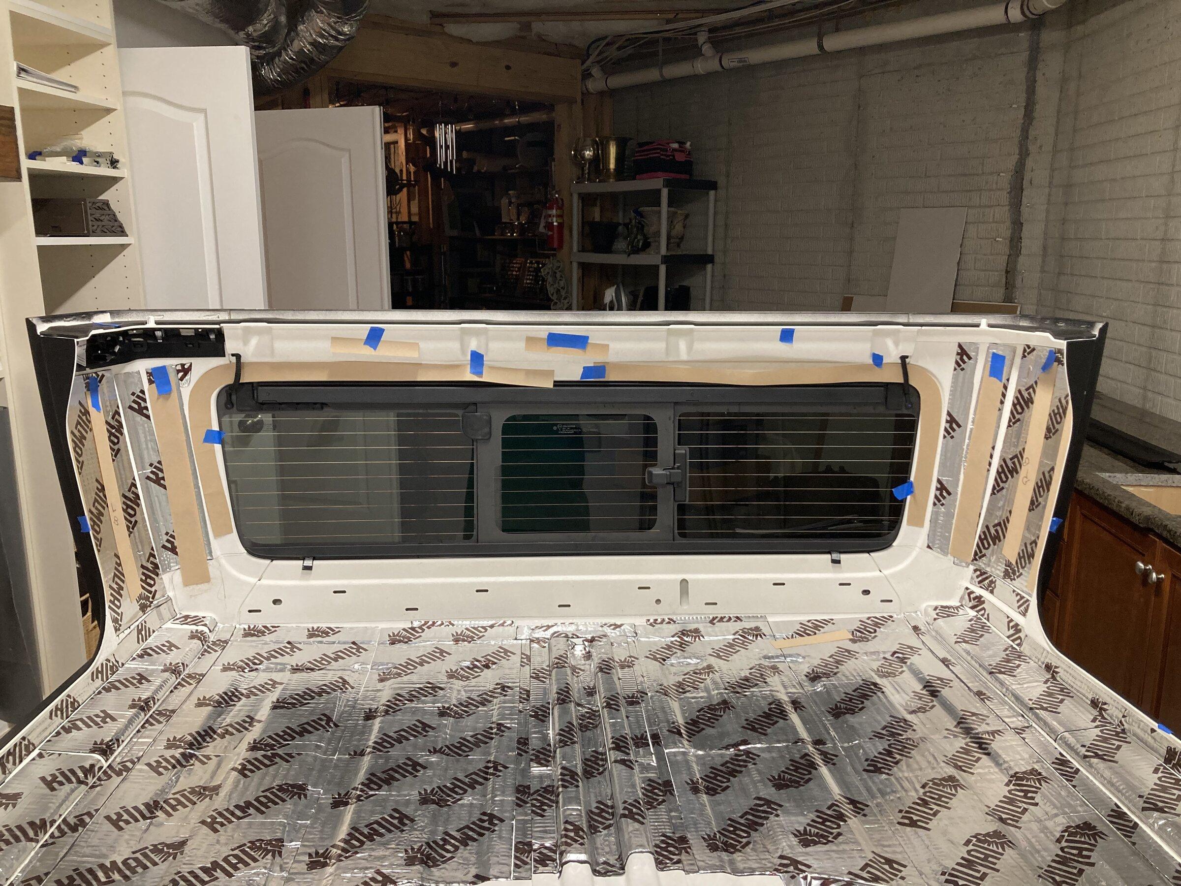

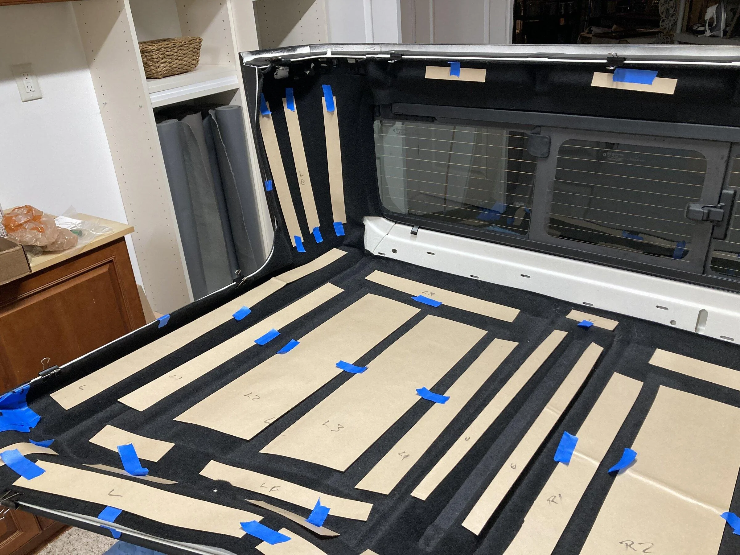

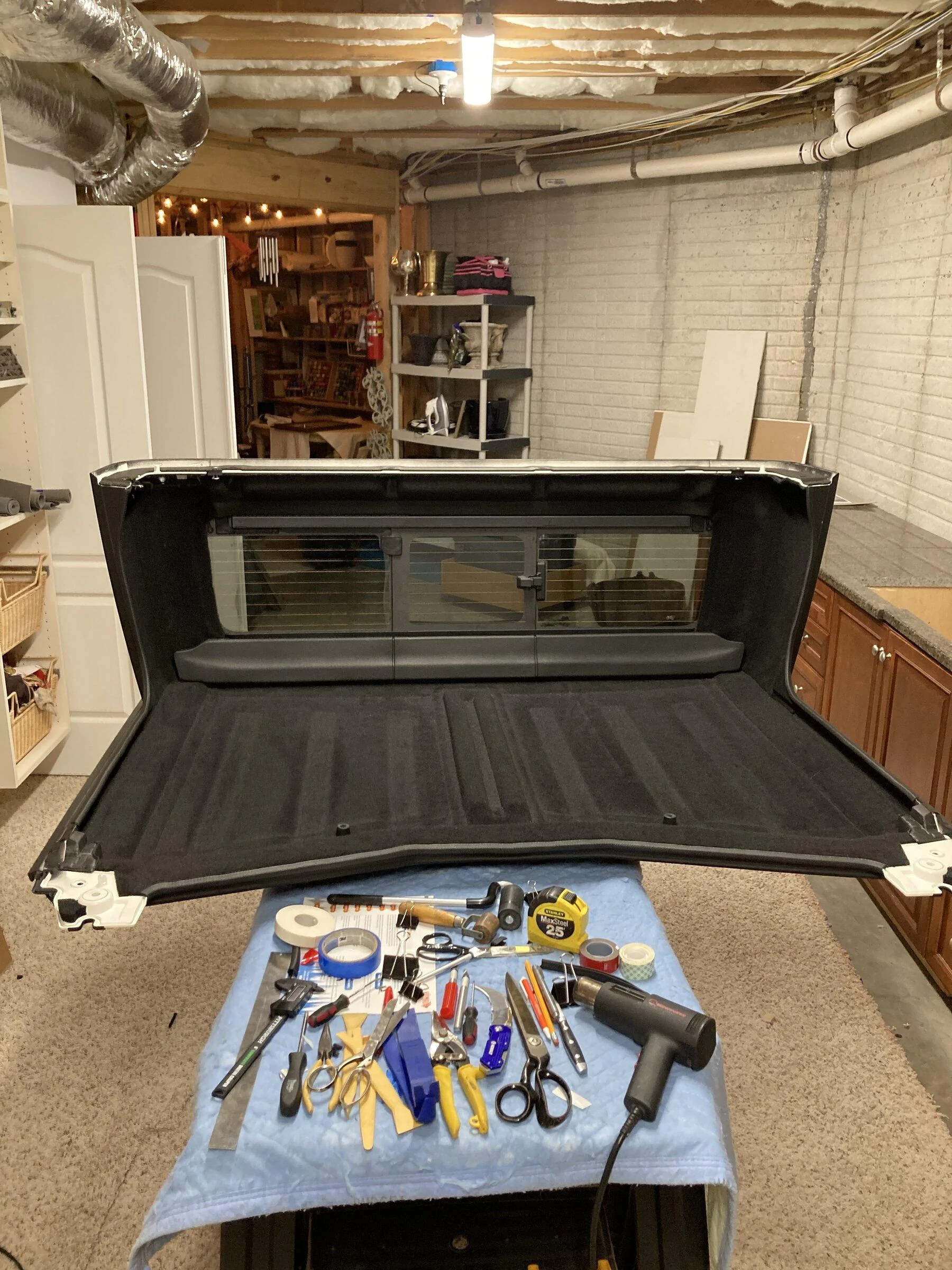

Working on the hatch….
Killmat and Coverking.
Jeep Gladiator The Overcon 1E91B9ED-6DA8-4066-8277-9CB9F2FC8C01
Jeep Gladiator The Overcon F6E1DE9D-AE8F-452F-AB8C-22C58F5F7794
Jeep Gladiator The Overcon FF245273-3AA0-4F41-939E-D60669A16280
Jeep Gladiator The Overcon 107A144B-2C05-4804-B26E-DA4E512F9138
Jeep Gladiator The Overcon D87FCCF1-2B44-449E-9228-F84C54CFD05A

Finished the back hatch āœ…?
