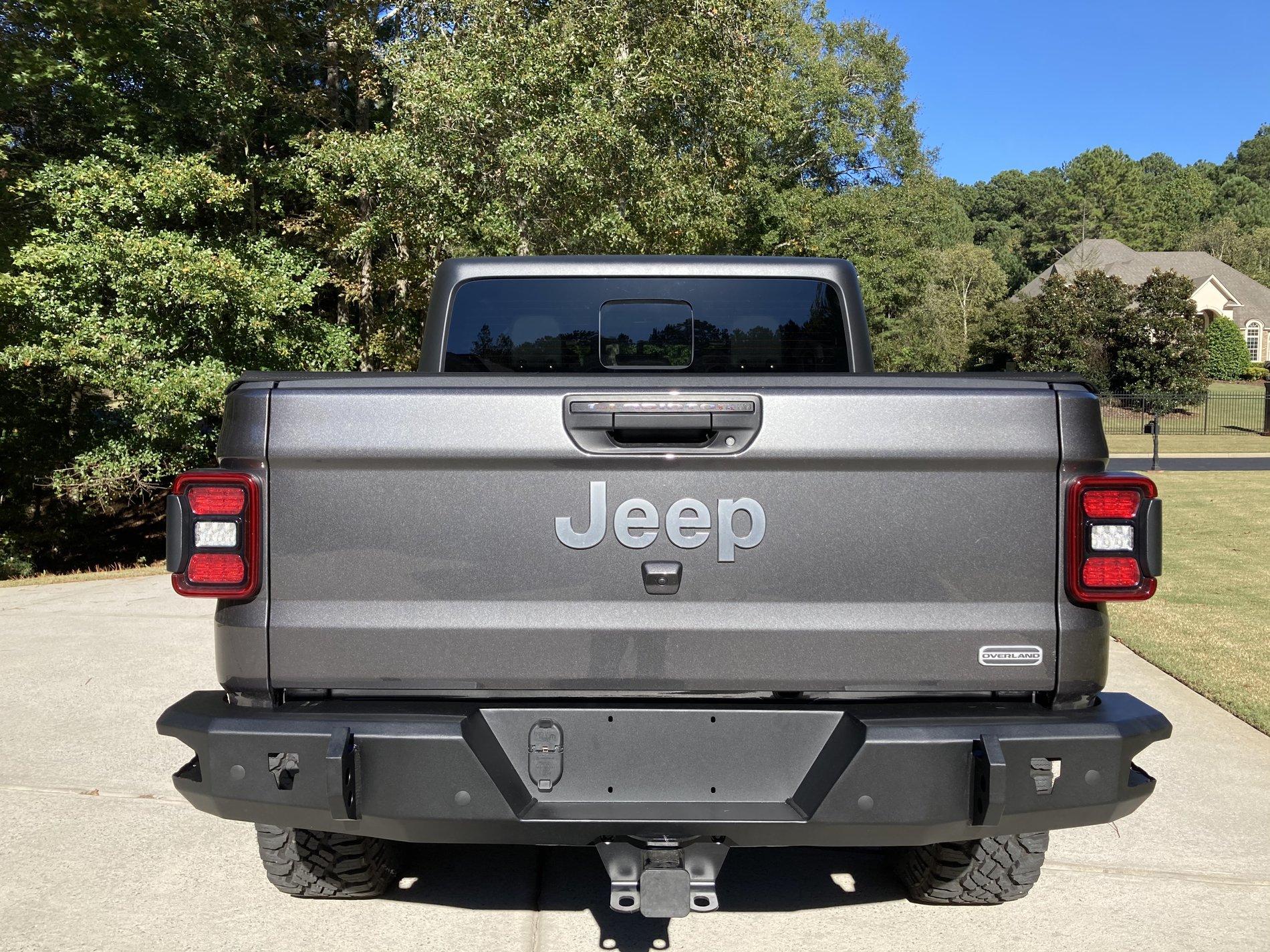

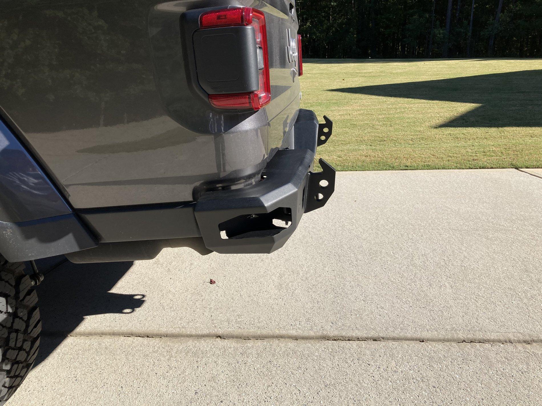

RR Hd Rear Bumper is ON!

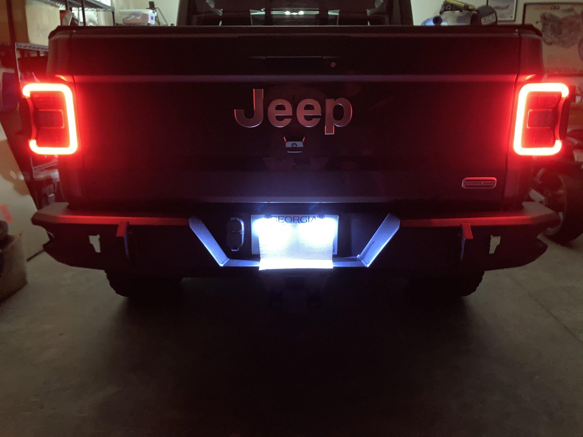

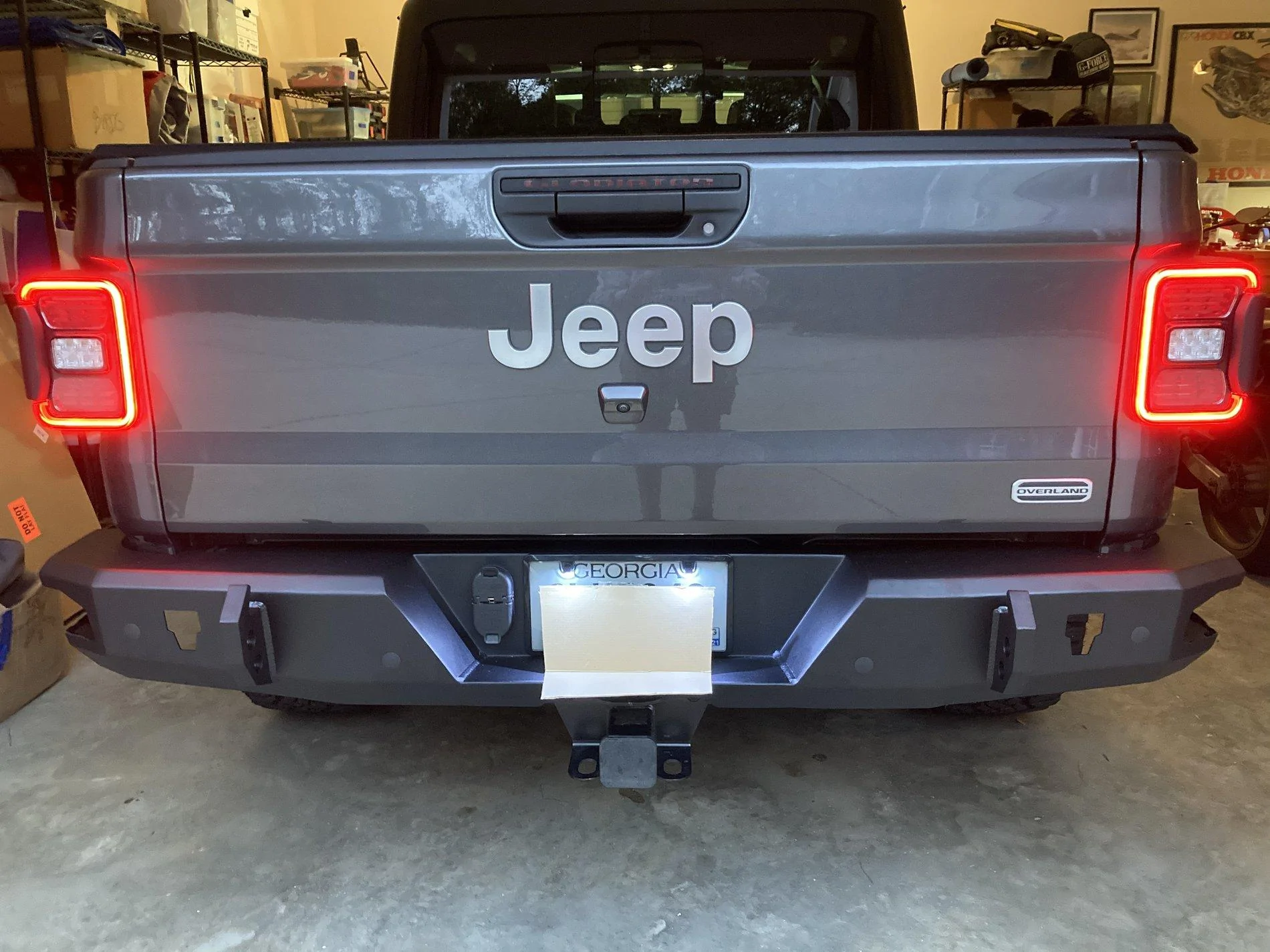

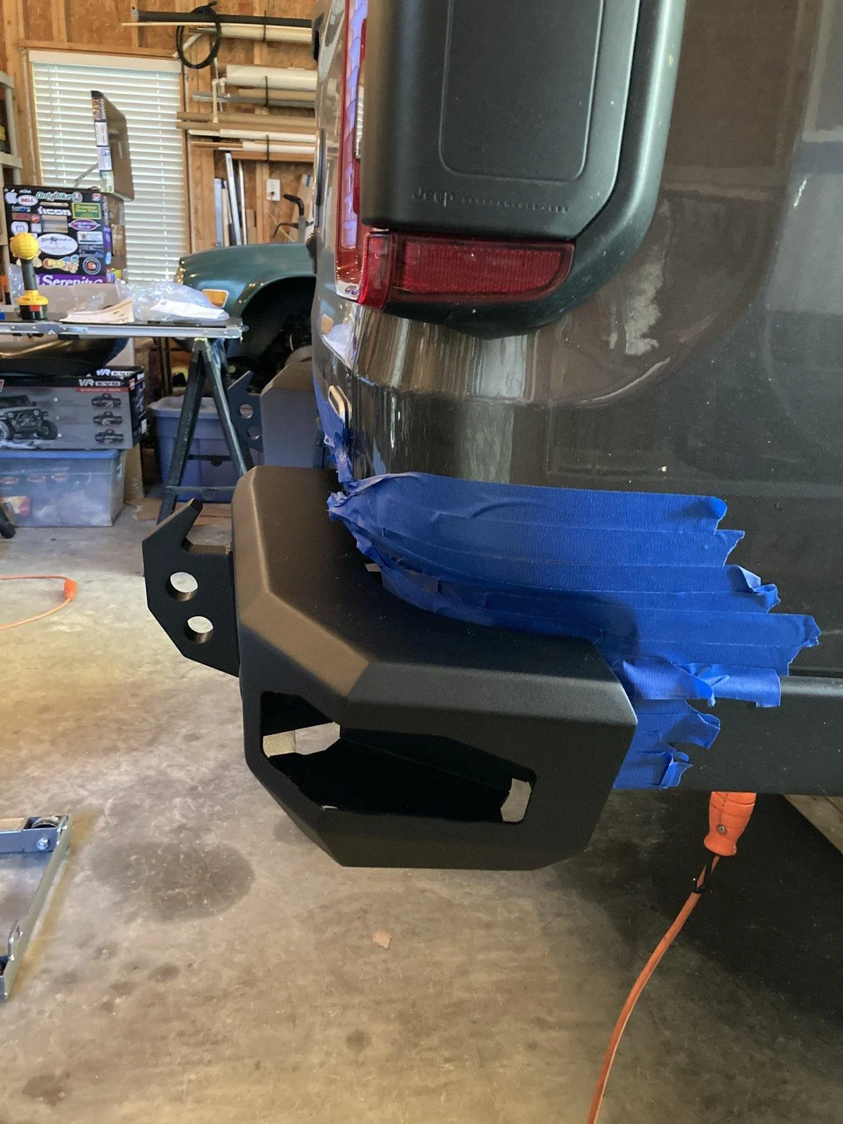

Gladiator Overland: The Overcon ‘82 CJ-7

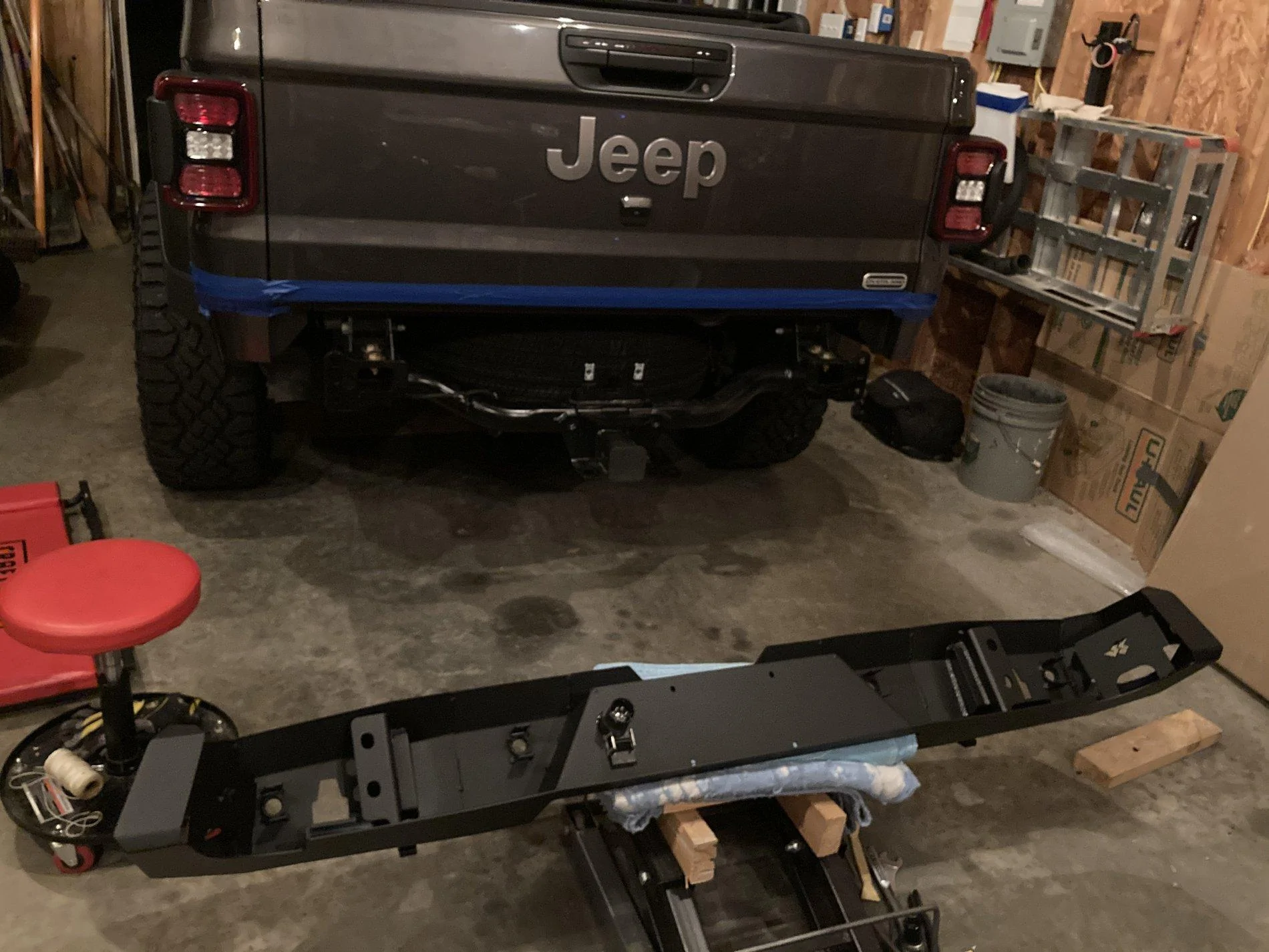

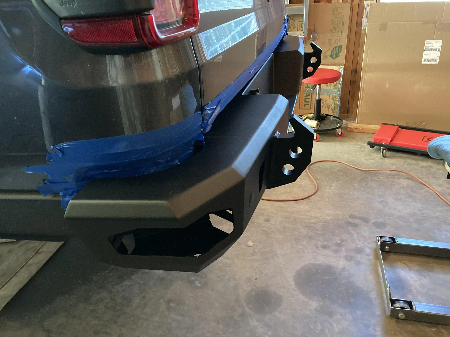

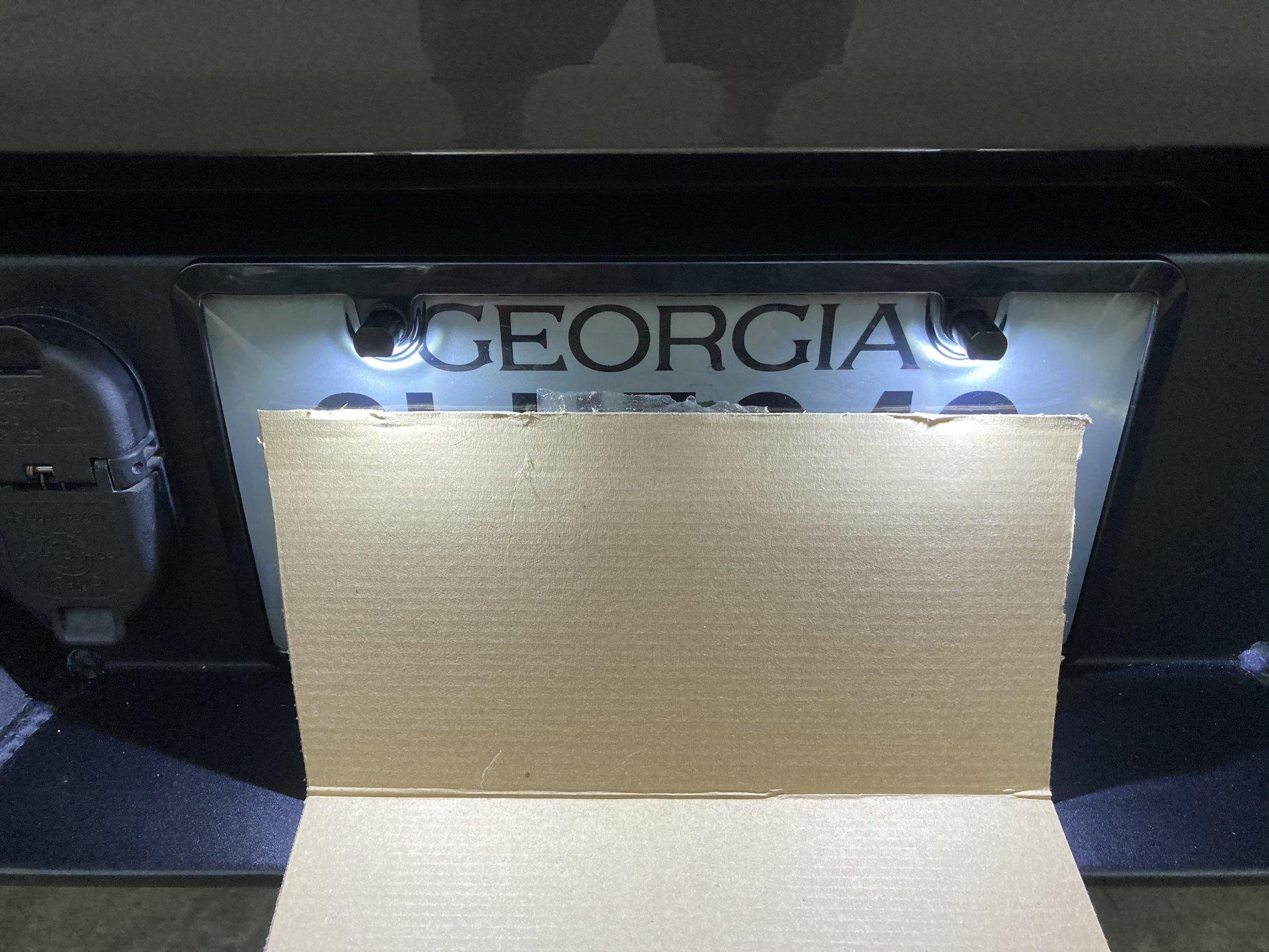

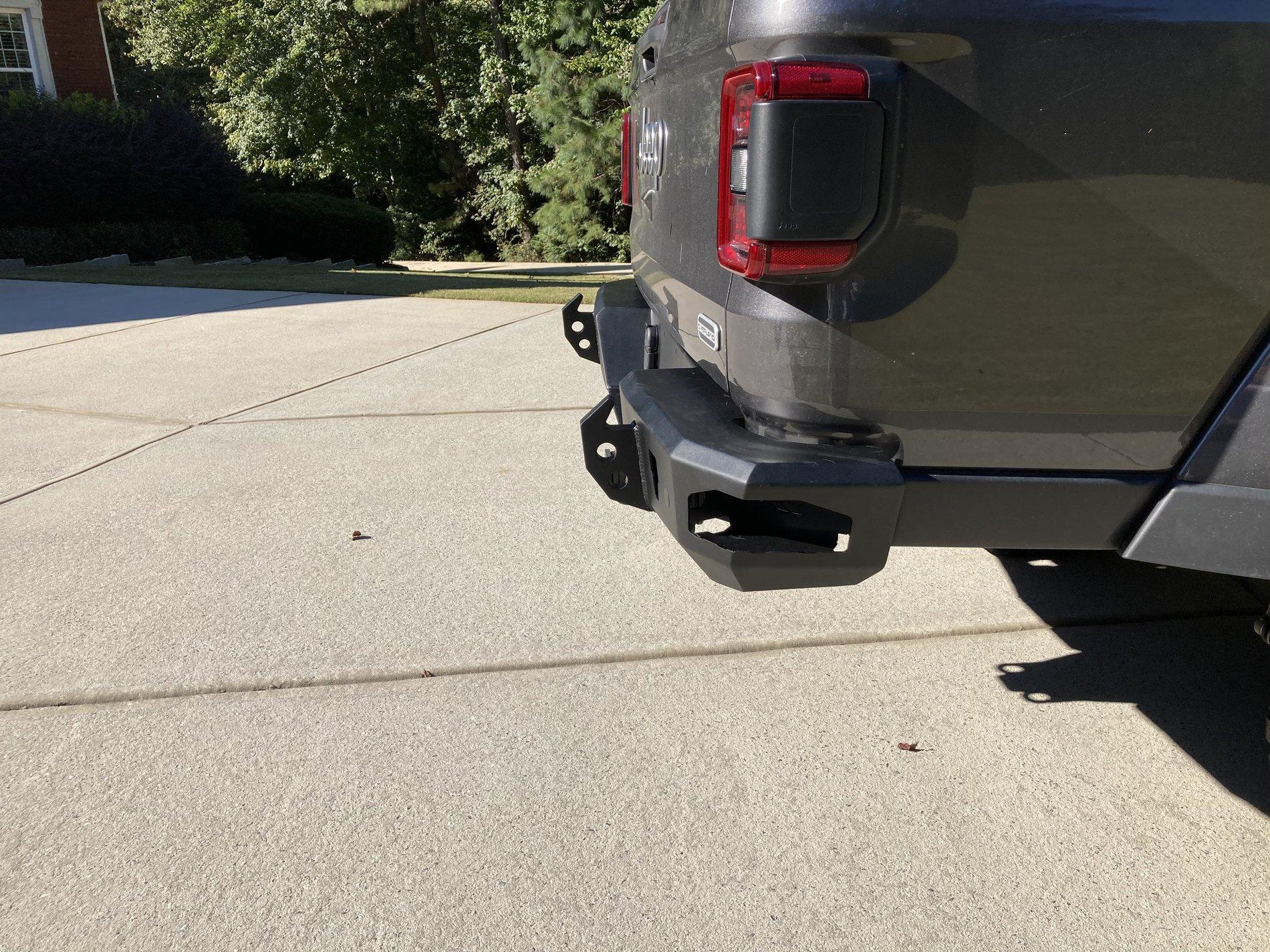

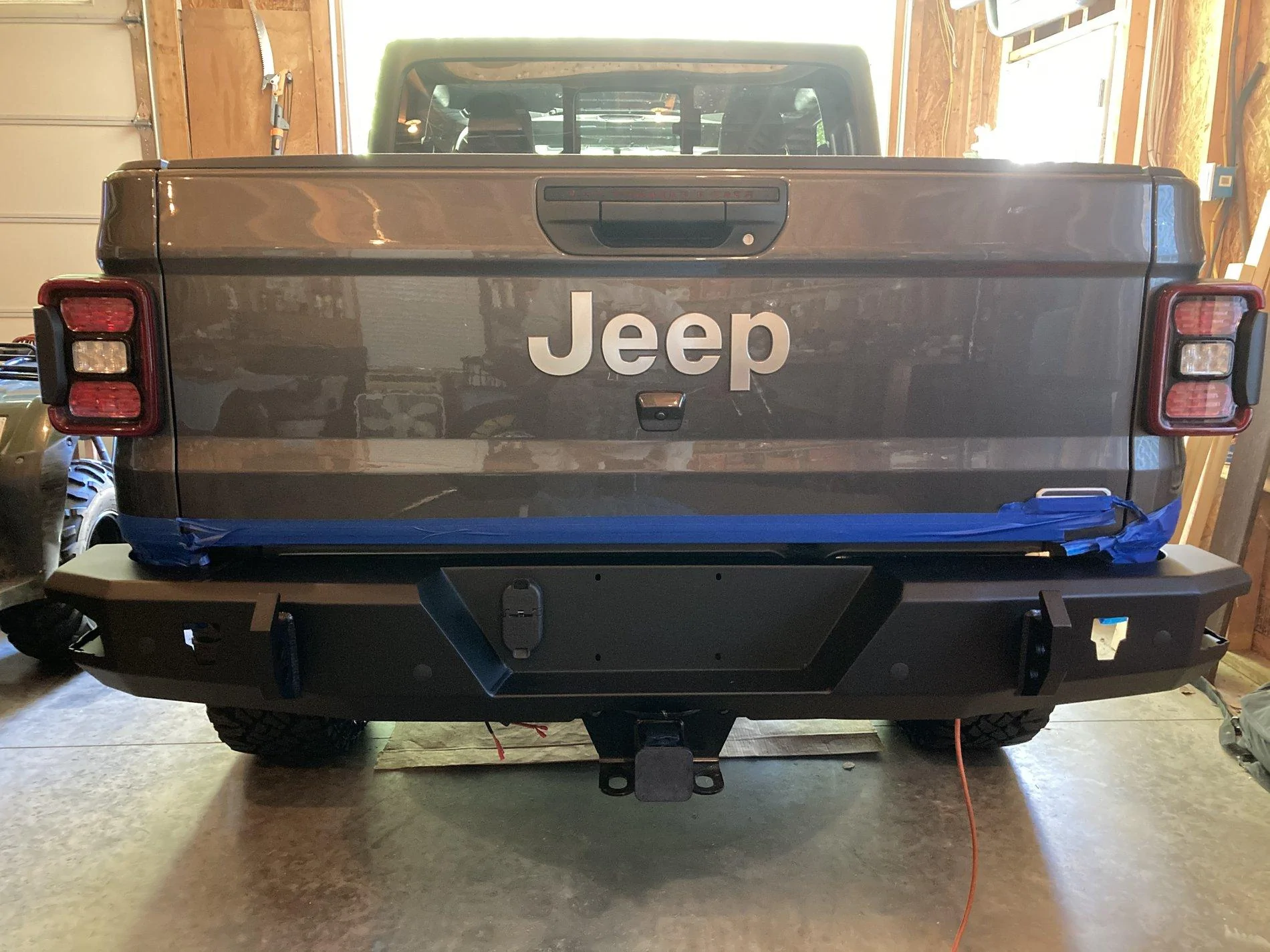

Easy install, took longer to disconnect the plug and tag light than do the Bumper.
Notes;

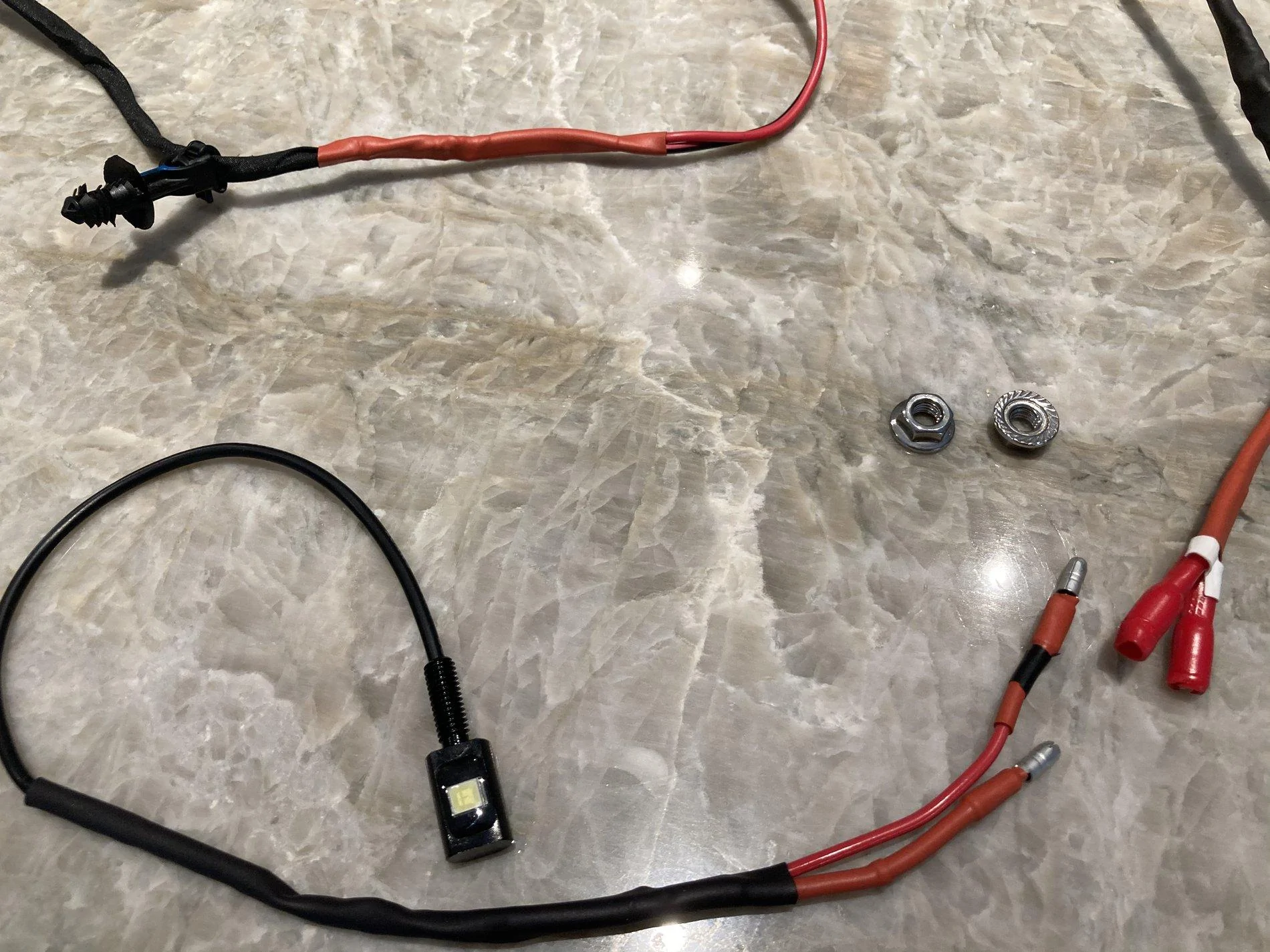

1. No ‘Overland Tag Light on the HD bumper. I had bolt lights for a motorcycle project that I had to rewire to make them work with the factory harness.
2. Nice well made bumper, no problems with the fit, revile or hardware.

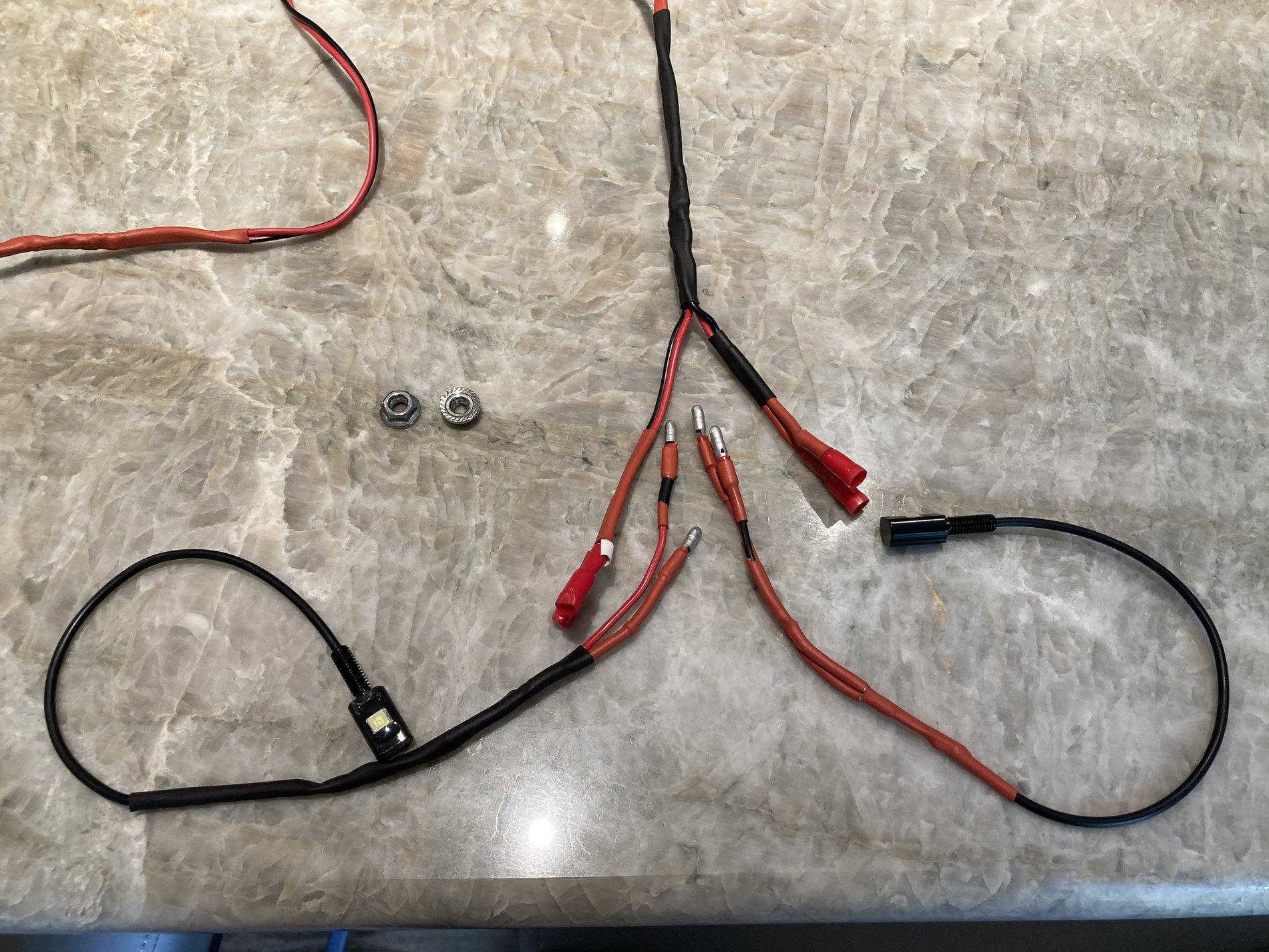

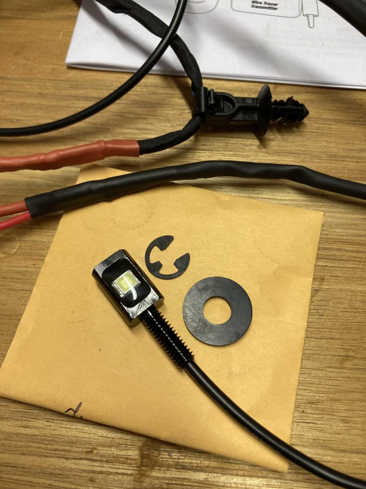

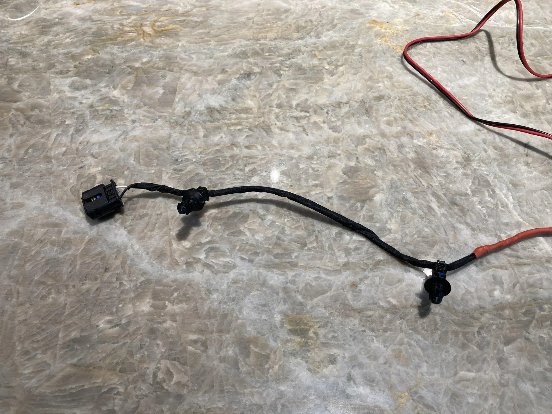

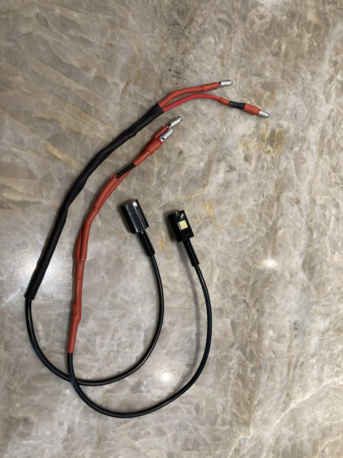

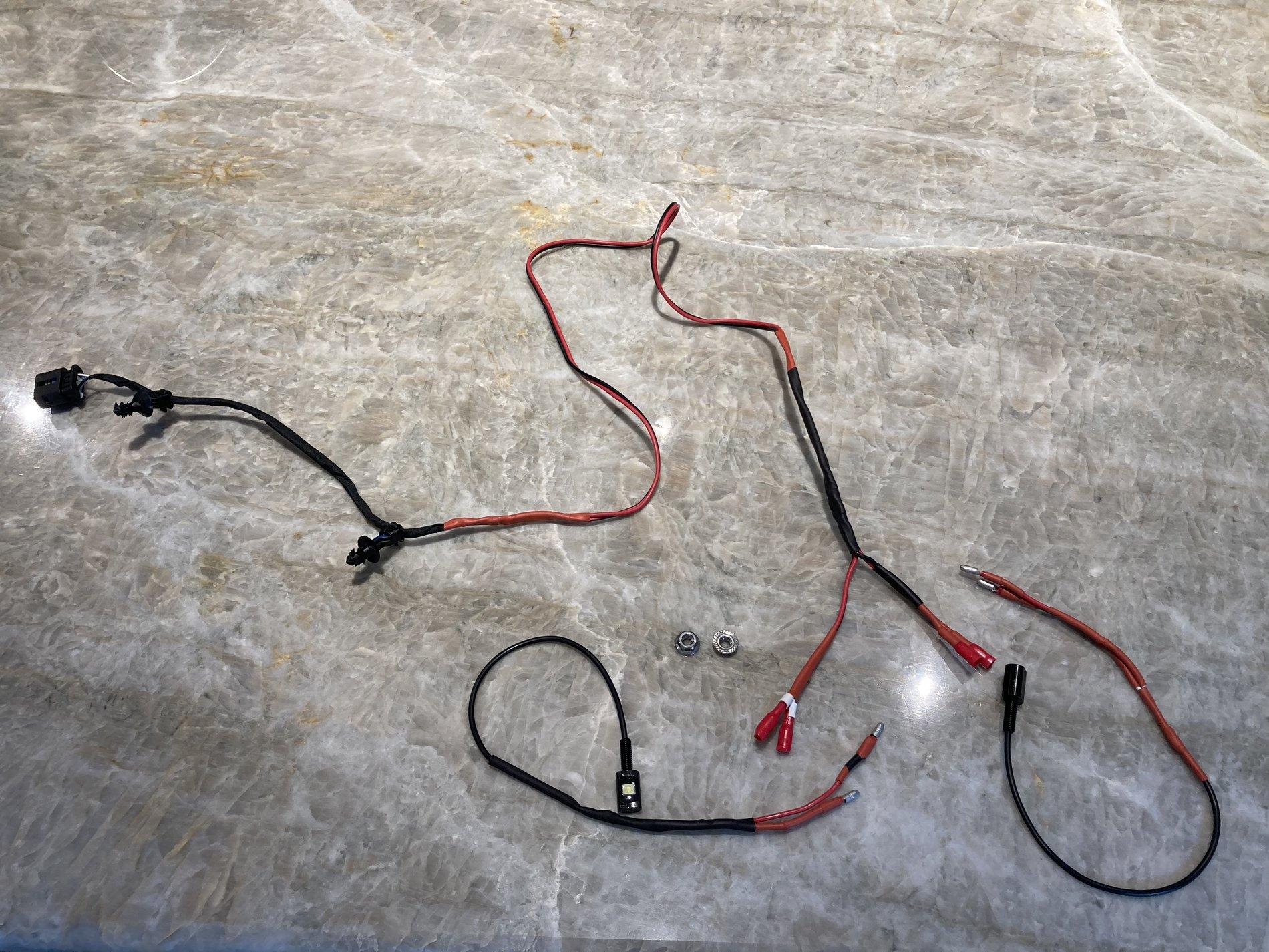

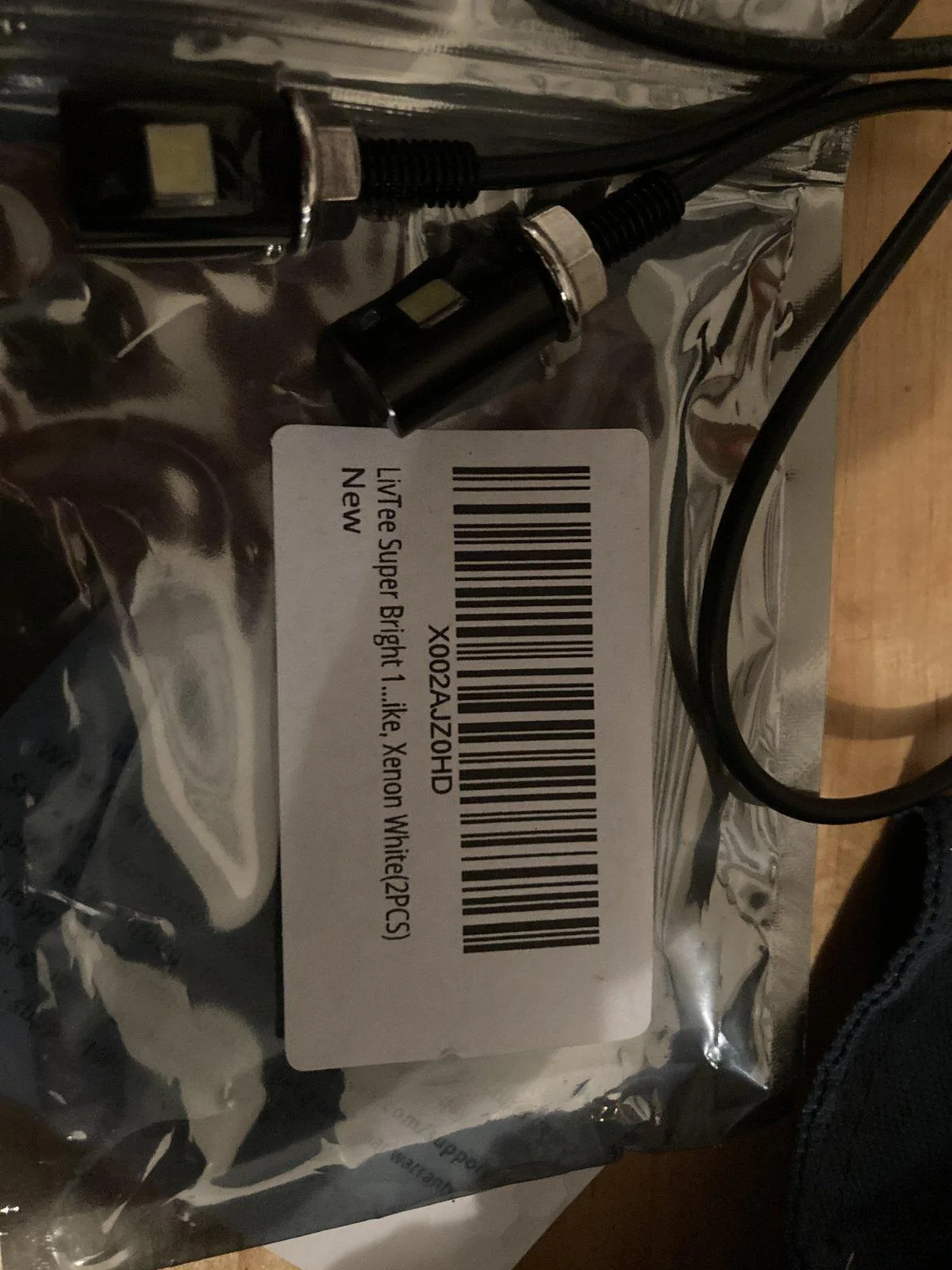

Here is the wire harness I made for the Tag Lights. Used rubber washers and C retaining clips for the lights. Bottom bolts hold the Tag in place.

Didn’t know RR has a kit for the Bolt Lights. Just lucky I had some for a motorcycle project.

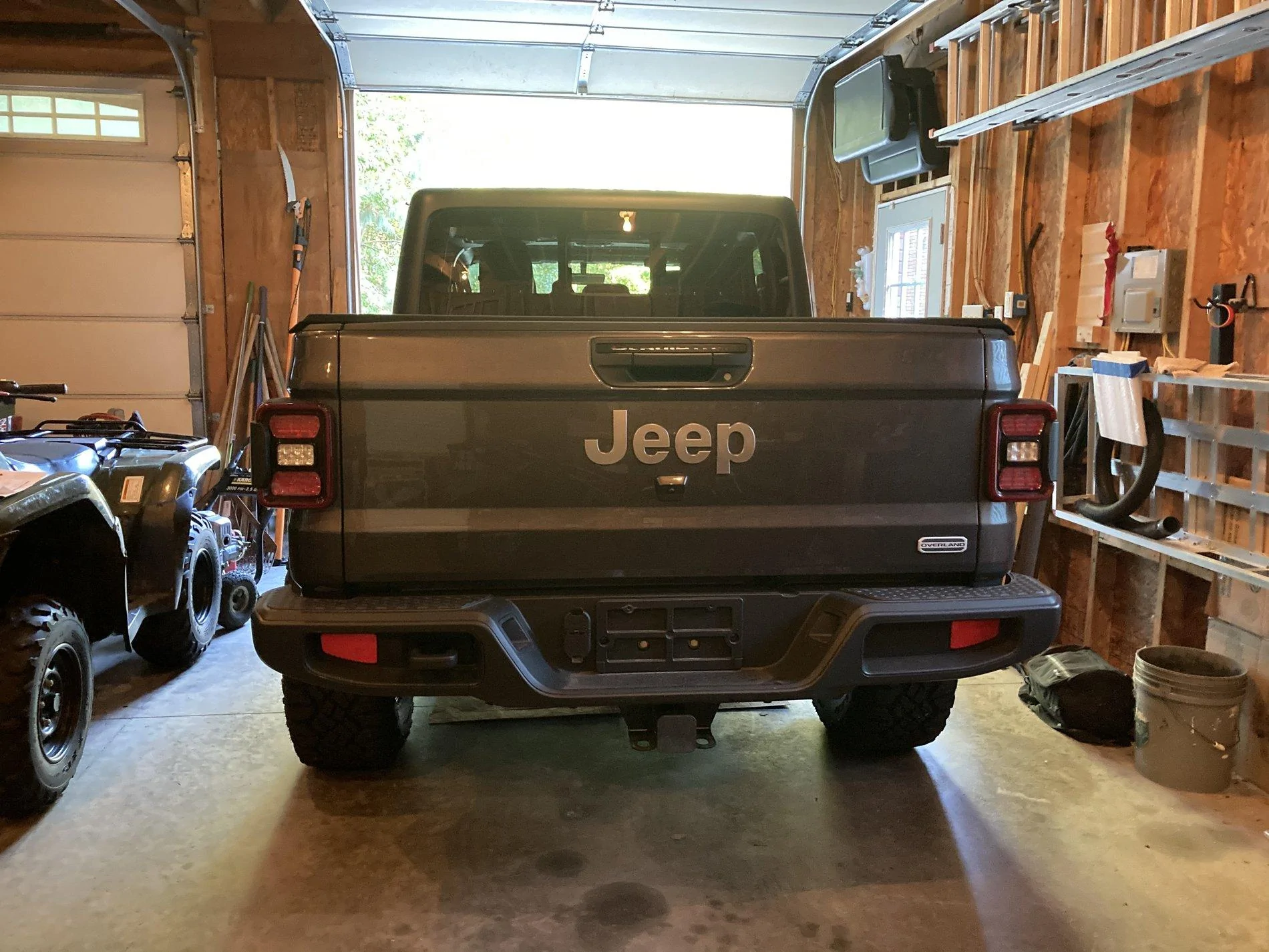

Just 2 plugs on my Overland, don’t have the Sensors, one for the trailer and the other for the tag light. Had a hard time with the trailer plug it’s press the release Then ‘push pull’.
Used the factory plug to wire the Bolt Lights for the Tag.
don’t know yet about the glare or if they are too bright yet.....

There is Less glare on the backup camera from the bolt lights, they are bright but are pointing down away from the camera lighting the ground area better.
Don’t have to dim them:like:

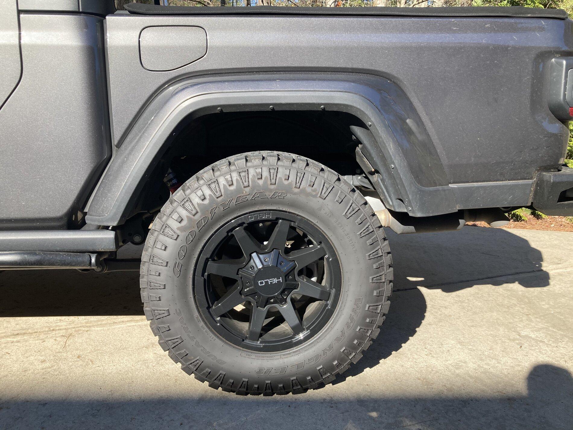

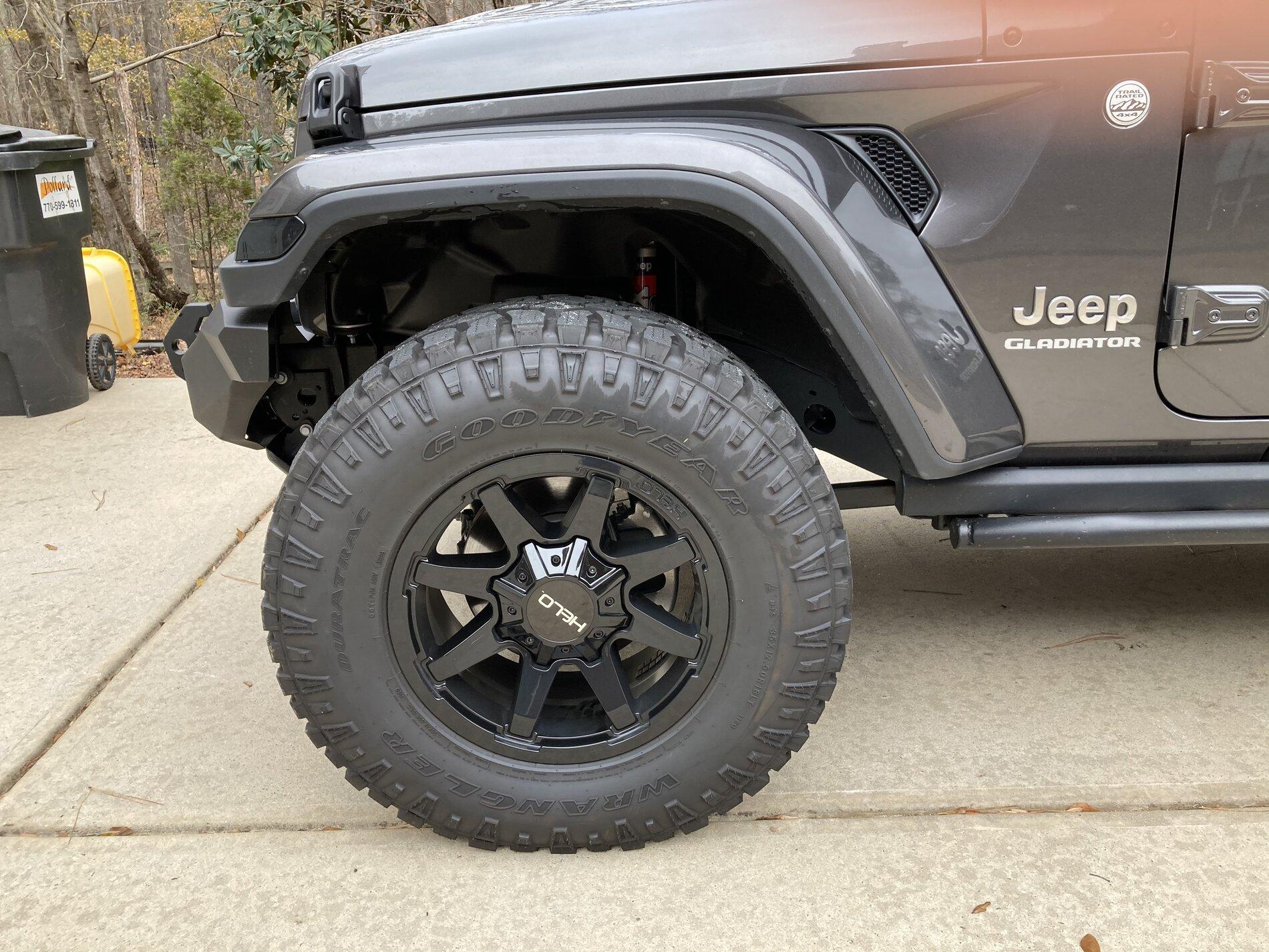

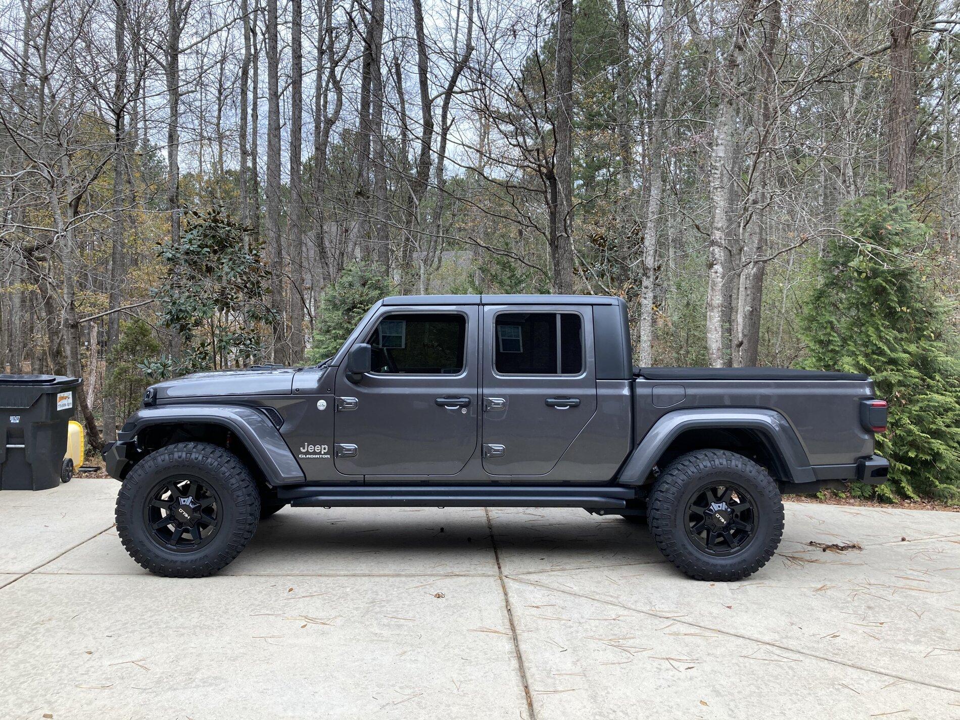

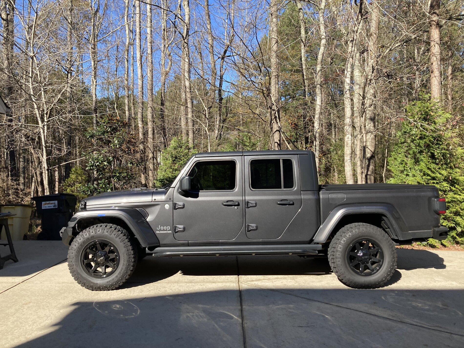

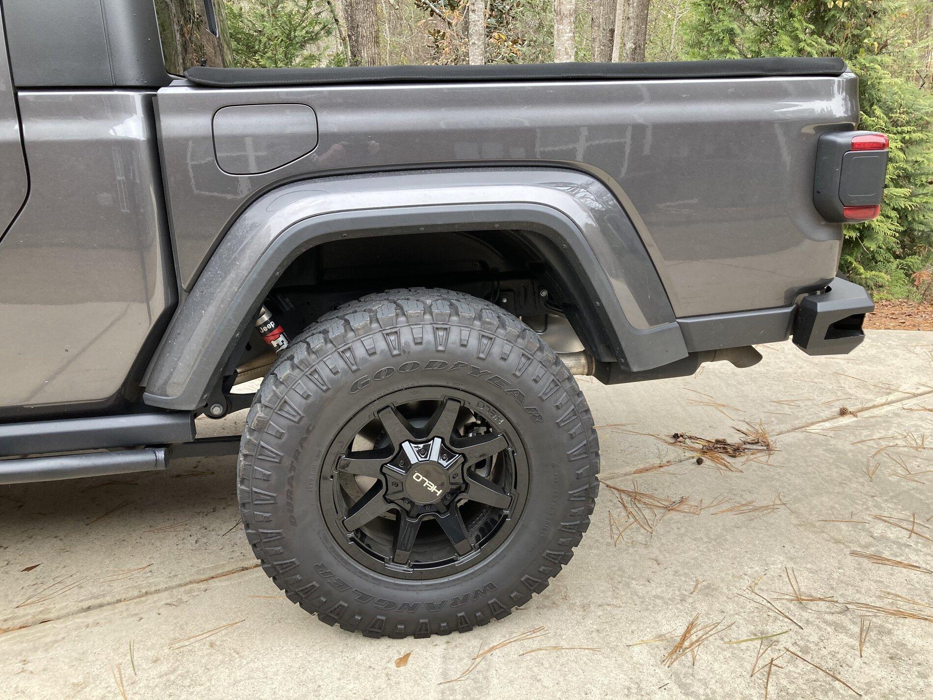

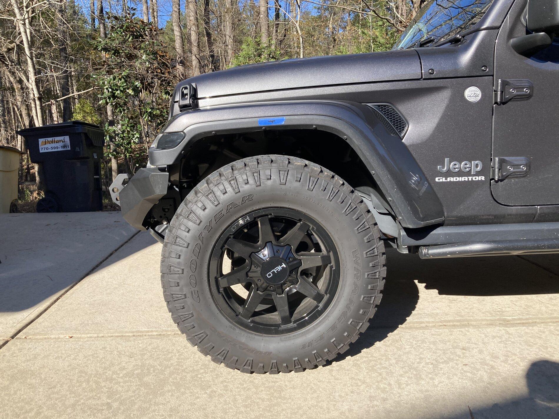

Had a bump rub on the front, went with the TerraFlex 1.5 front and Daystar .75 rear to keep some rake. Went on easy, used a rental spring compressor on the rear so I did not have drop the back as much to get the ”puck” under the spring, only had to undo the shock and drag link.
