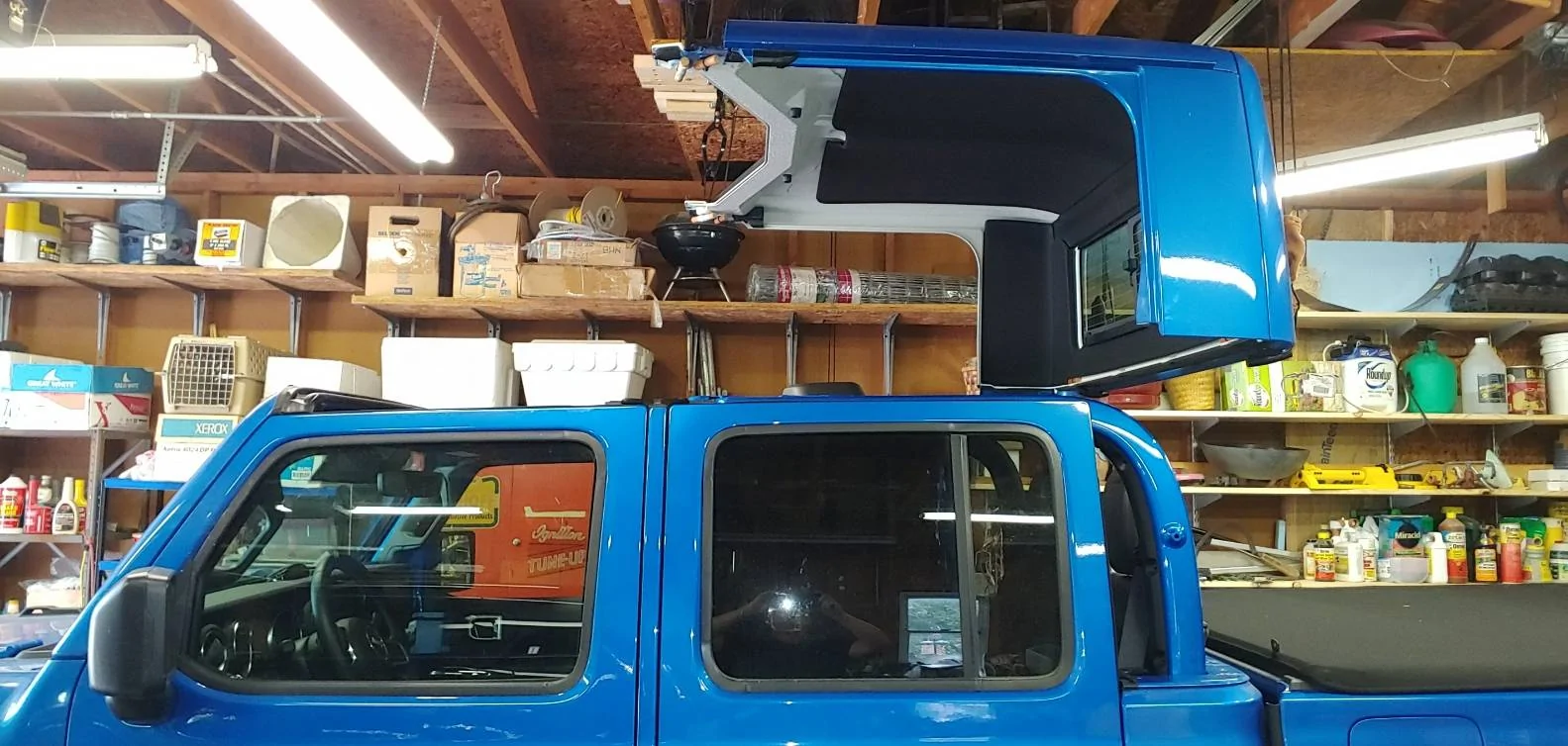

I bought the Lange hoist and it’s been great. No issue leaving it up there for weeks at a time and I don’t have any backup straps

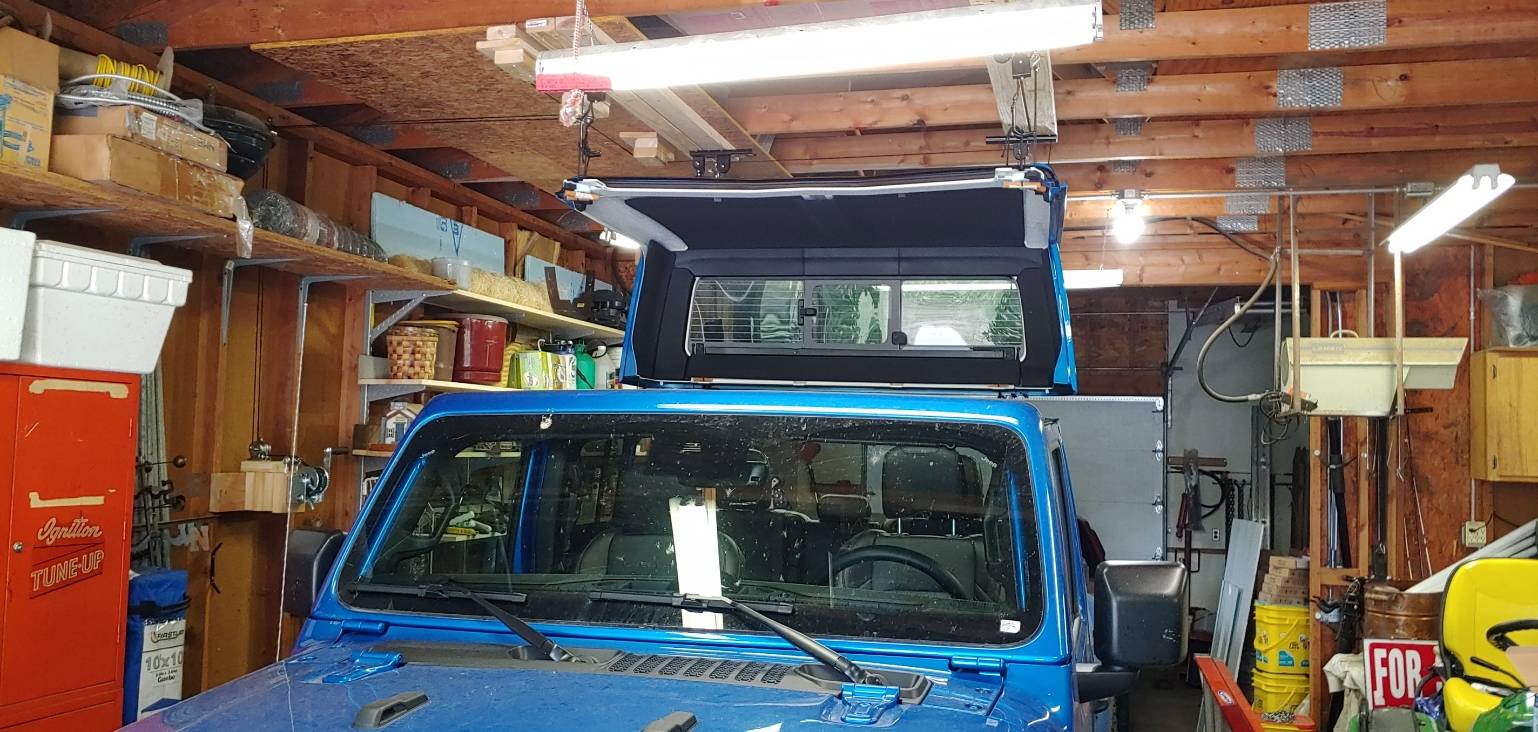

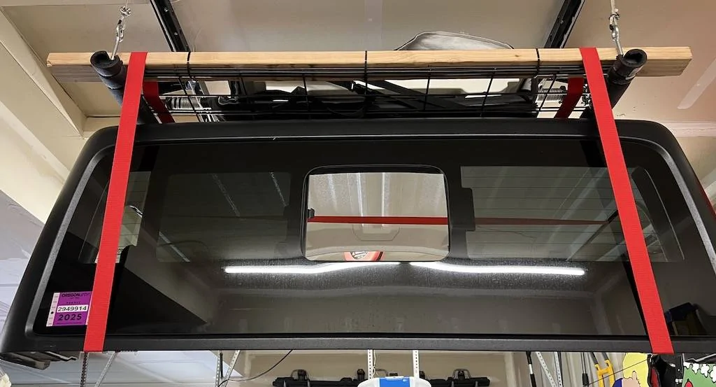

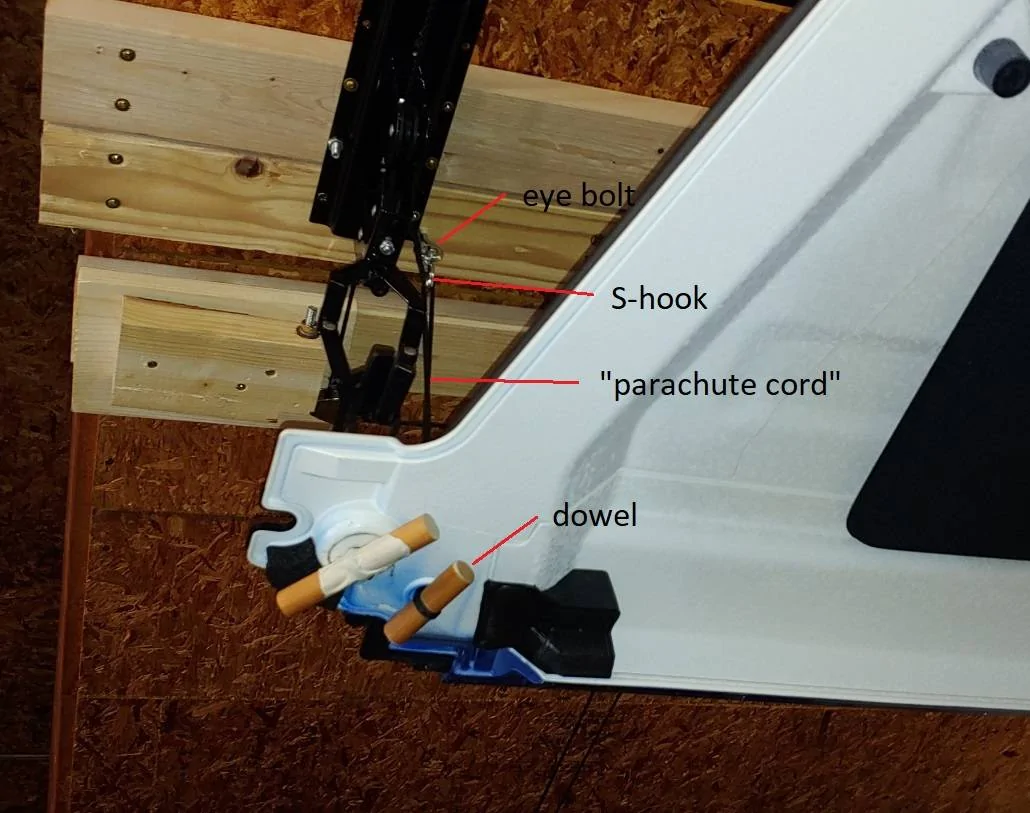

Boat winch. Not electric. Not sure if that matters - I'd hope most electric "hoists" for this purpose have a brake of some sort.
Jeep Gladiator Those with 'electric hoists' (Hard top hoists) 20200714_165608_HDR
Jeep Gladiator Those with 'electric hoists' (Hard top hoists) 20200714_165555_HDR
I do have hooks in the trusses and paracord loops I made so I can secure it up there just because I'm paranoid, but they aren't necessary.
Takes seconds with my dowels and loops of paracord. Slip look through hole in roof, slip dowel through the loop, secured.
Also worth noting, I can remove or put it back on in under 5 minutes

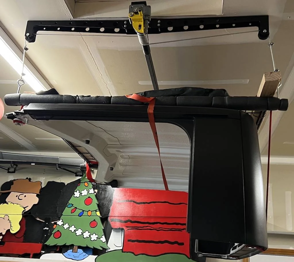

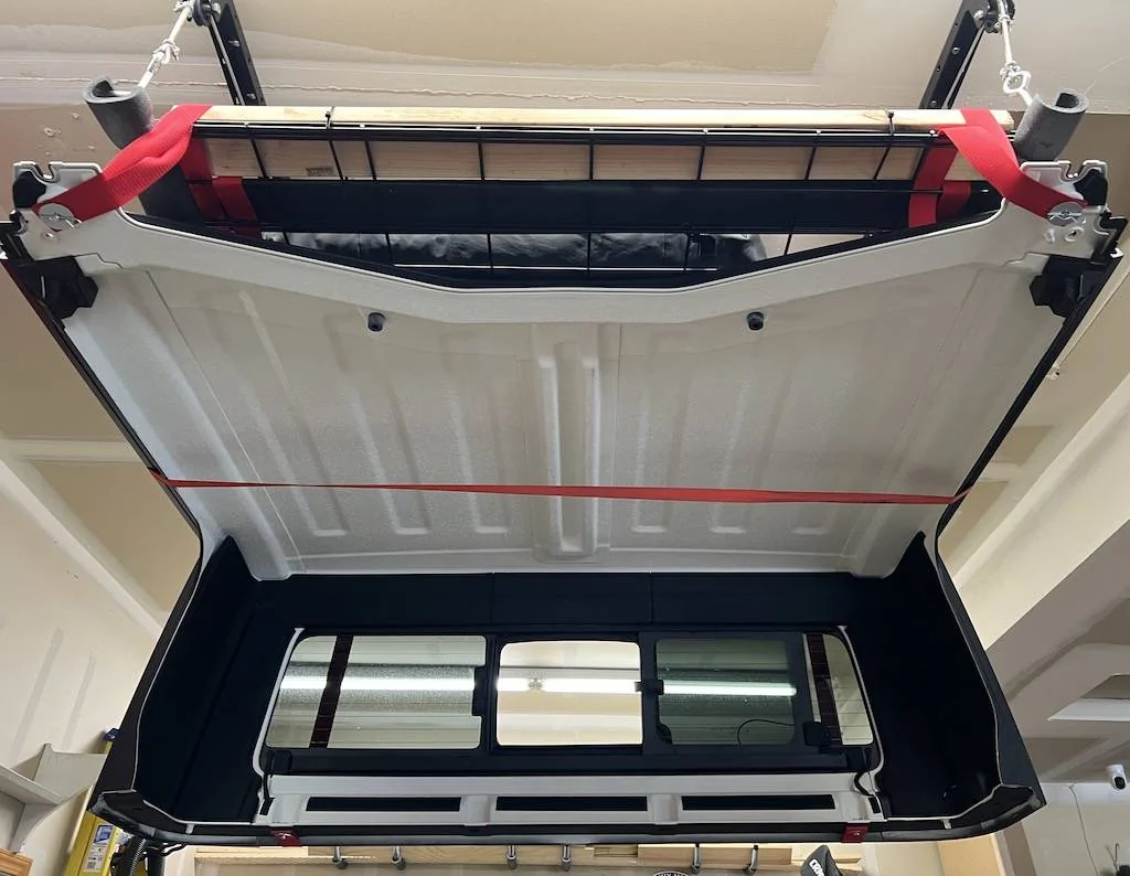

I use the Racor Hoist with my drill, it does have a locking mechanism to help prevent it from releasing and dropping the rack/roof. However, since I leave my top up for about 120 days I ran a safety strap under it for extra piece of mind.

Will be working on an E-hoist soon for my top. Nice to see some great examples of attachment points here. I had considered three points of contact through the rear window and front corners but these examples look much more stable. Looks like there is a place for the Freedom Tops on a rack above too. Perfect!

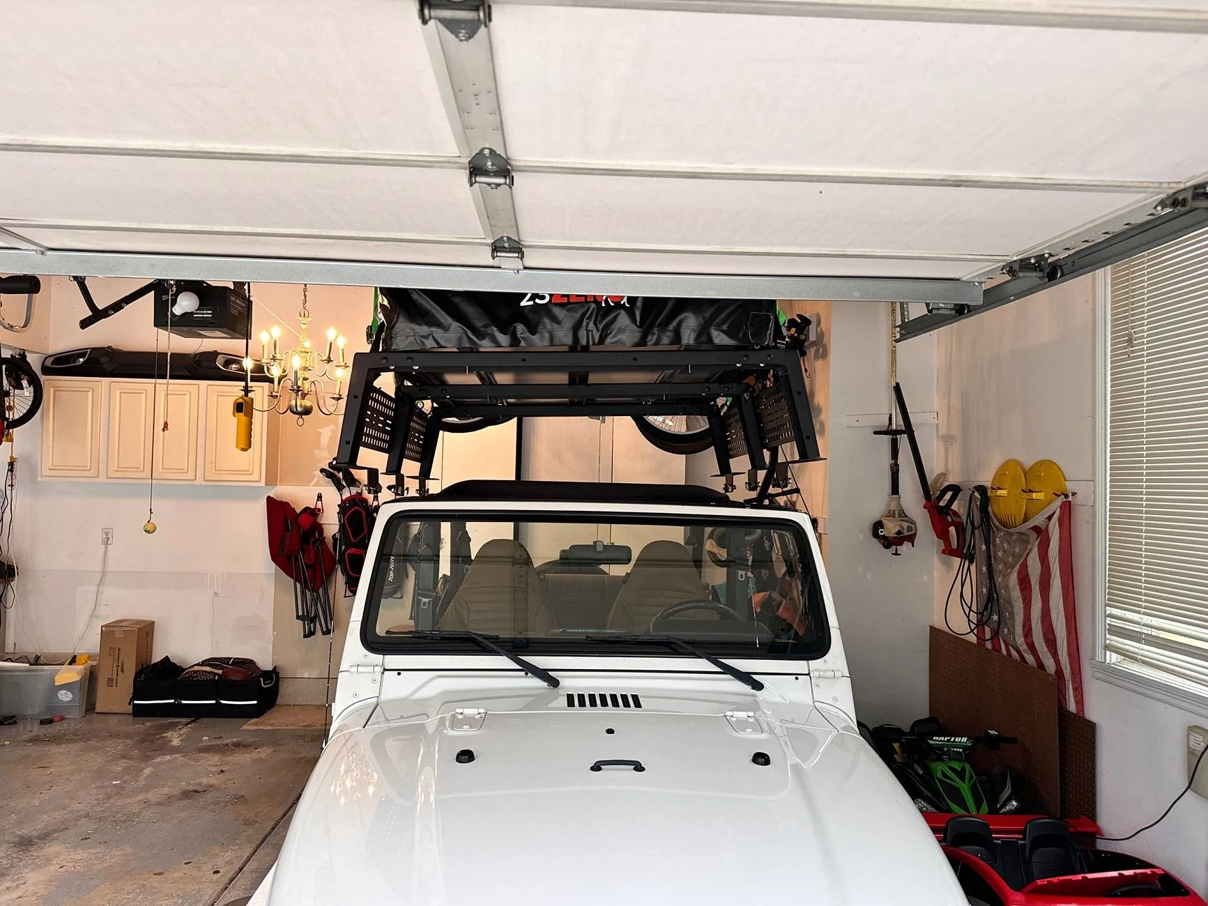

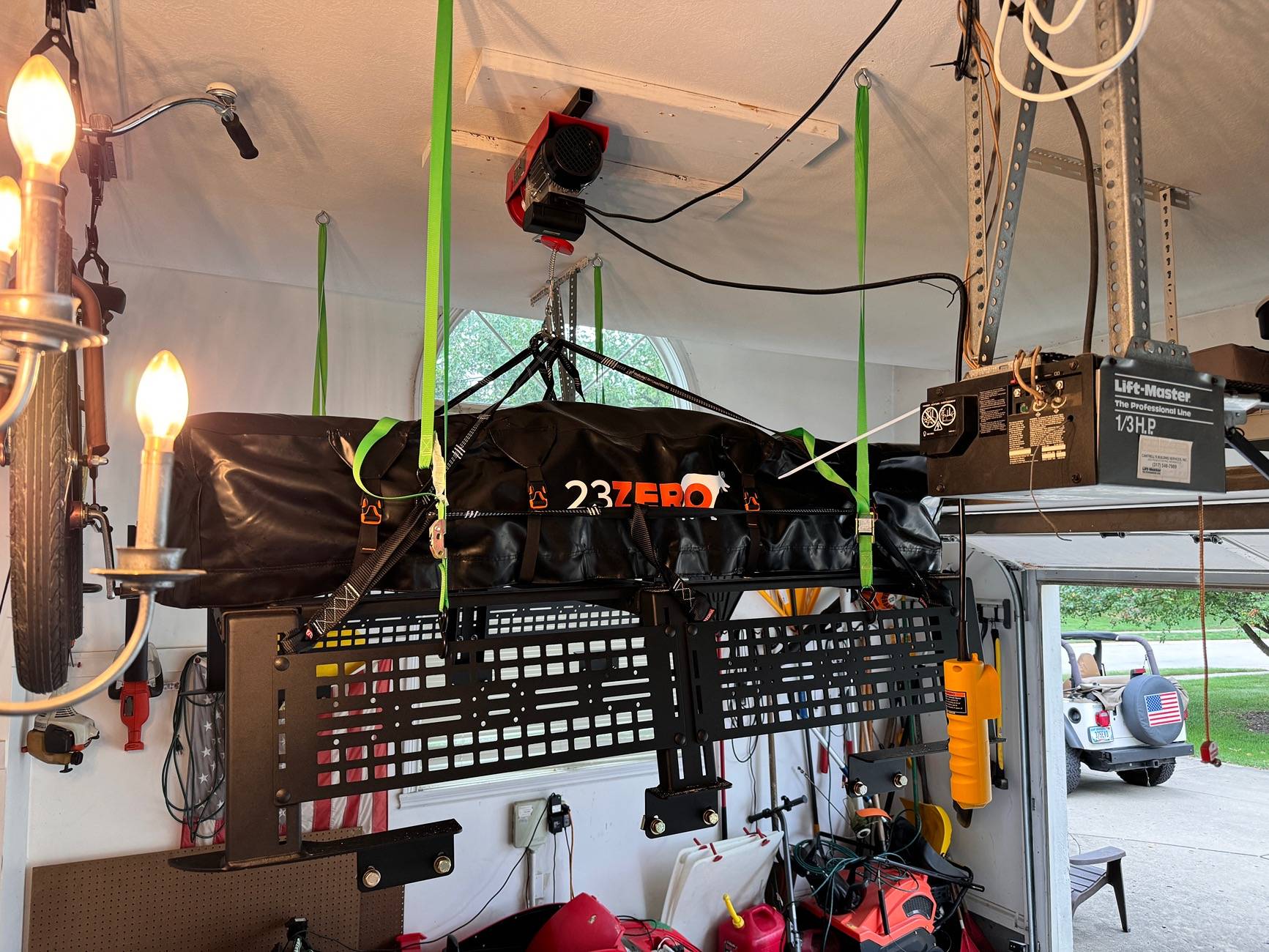

I have the Lange originals lift for mine, loved the concept so much that I did the same for my rack and rooftop tent. Added straps to the corners for some insurance, since the setup weighs about 340lbs
