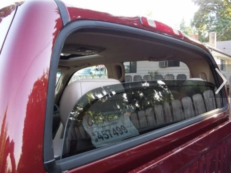

I really fail to understand why Jeep didn’t engineer the top so that the glass could not just roll all the way down “into” the rear wall of the truck. You can’t really stow the glass behind the rear seats because the seats have to attach to the rear wall of the truck. Am certain that they did not do this because it would have made the truck a tad more expensive. But hey why not make that an option for people to pay for should they want to pay a few extra bucks? Ok a tad more than a few extra bucks.
Oh and for those of you that may still want to have a removeable rear window I suggest that you check out Breezer removeable rear windows. They even come with storage bags for the rear windows once they are removed. And I don’t think they will have rear defrost.

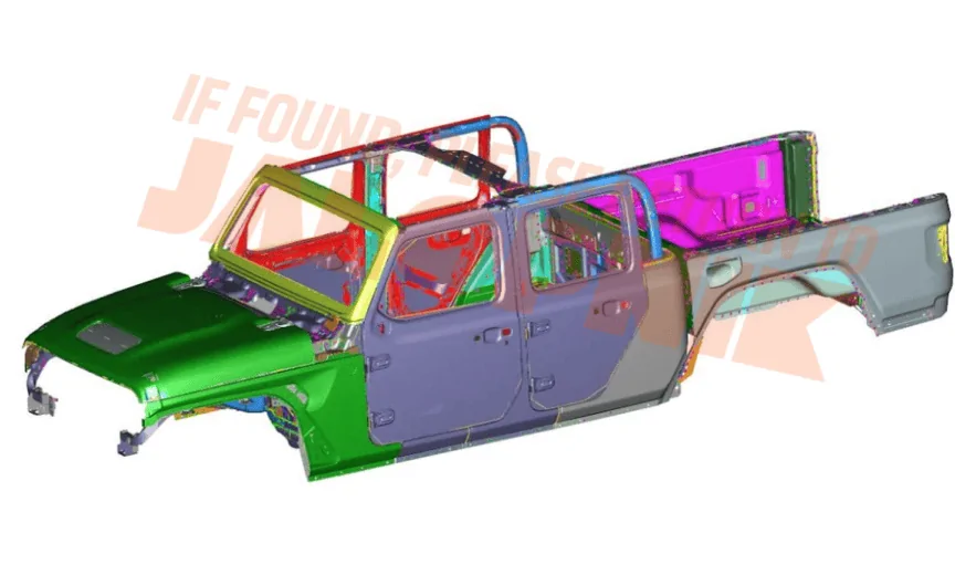

Hey Guys, I just joined today and can't see how old this conversation is regarding rear window roll over inside the back wall, I kind of impossible due to not enough space vertical as person placed CAD file for rear iner fender . there is also more room also must need for regulator mechanism which push and pull glass windows.
than Only one option left is Just remove complete window from rear and place back when needed to close. But in Automotive vehicle possible AIr and water leakage is very common due to rough use and so much vibration while vehicle in the speed.

For everyone saying the glass should roll down into the truck... how do you imagine it interesting with the removable roof? Needs to be separate but come together for watertight seal.
You would need this to be frameless widow. One miscue by the owner not setting the L back into place quite right and the rear window will shatter on rolling it up.
You also need to design access for the motors and stuff, so now you're adding like 4-6" of cab depth. Either losing the little rear leg space there is or stretching the already long design.
Also the JT is based off the JL which has no possibility for such a feature. You'd be adding a lot of cost to the JT.
