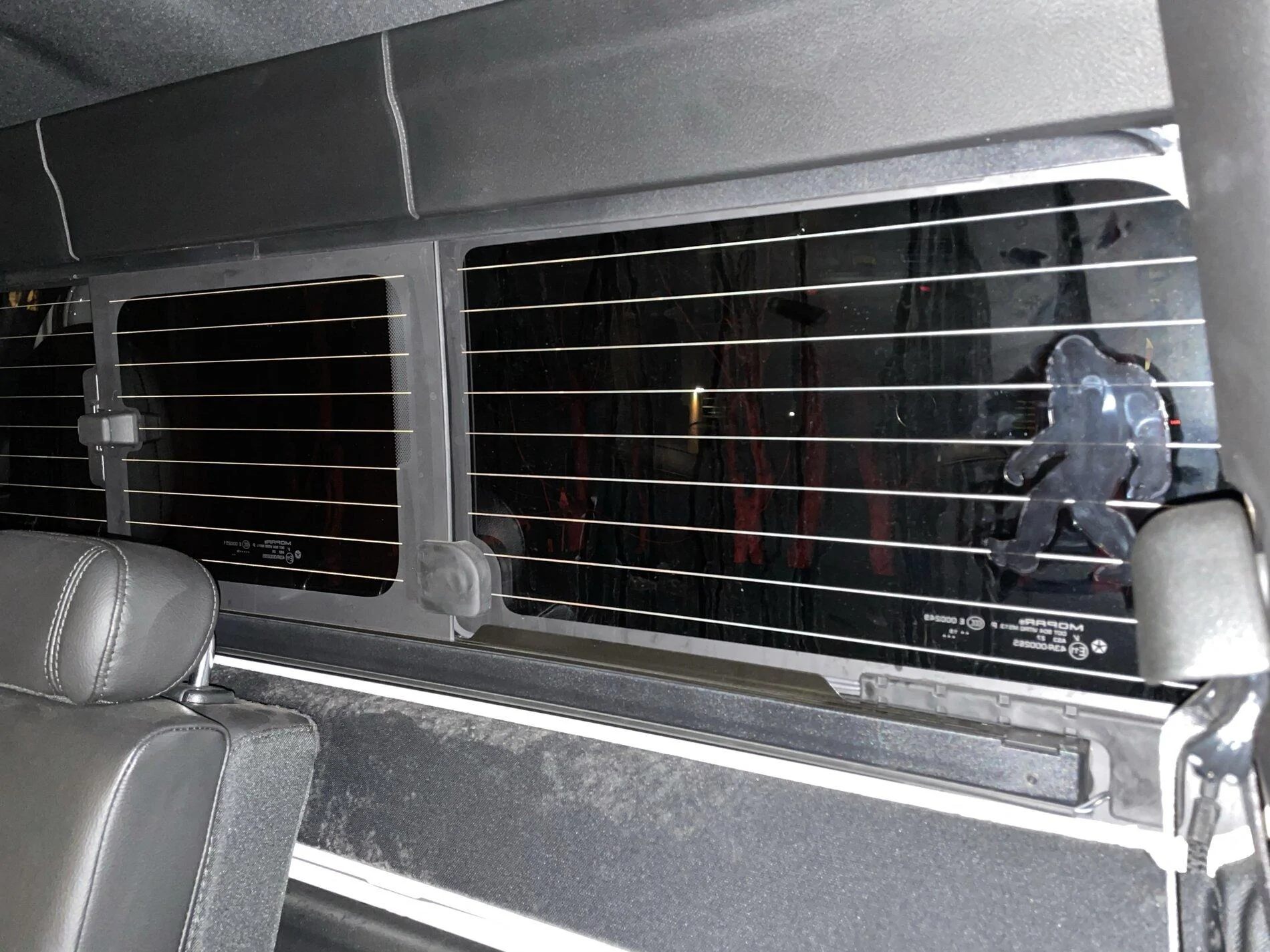

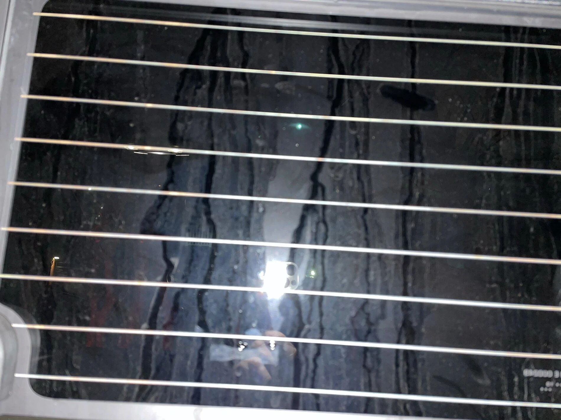

I was storing some stuff behind the rear seats a few days ago and noticed the velcro'd fabric trim piece that hides the hard top mounting torx bolts was wet. I looked a bit closer and there were water streaks on the inside of the window!
I had no idea this was a common problem. I'll make an appointment with my dealership to get an oil change and have this checked out at the same time... I hope the rear trim piece and/or the hard top sound deadening aren't water damaged... Also would be concerned about water damage to the subwoofer or other stuff back there.
