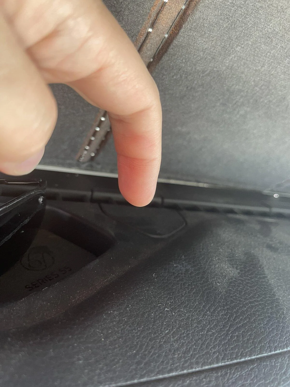

I want to install a USB outlet on the top of my dash. I have the 67 Designs series 55 rail in the center, and want to add USB. With the rail in the way, I can’t use that tray area. So, how do you remove the daylight sensor? Why do I care about the daylight sensor? Because it’s mounted in a small panel that has a sister panel on the passenger side of the top tray. I want to remove that “blank” piece and put my USB outlets there.
Has anyone removed this, or does anyone have knowledge about how to remove that piece?
photo for reference:

That piece will pop out with a trim tool. There is a single screw below it holding down the windshield vent trough IIRC.
