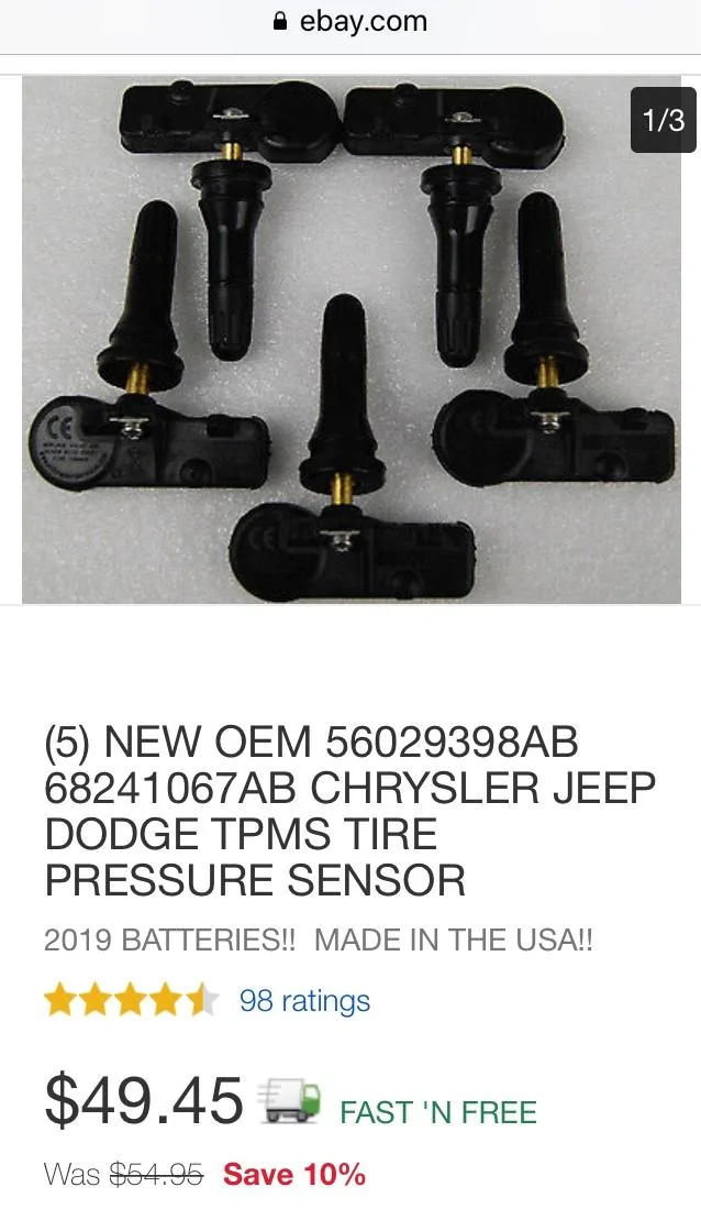

If I replace my tpms with new ones do i need to have the dealer program the new sensors to the truck?

No, as long as you buy the correct part, your Jeep will detect the signal as you drive. I bought a set off of eBay and they work just fine.
Would you mind posting a link or the pn for the ones you purchased?

Had my sensor put in at the dealership today. Forgot to take a picture of the sensor. But the mechanic told me that it’s exactly the same as the factory sensors. And it looked exactly like the ones shown above that @Renegade posted. Sorry about forgetting snap this picture. Was mainly there to get my step bars put on.
