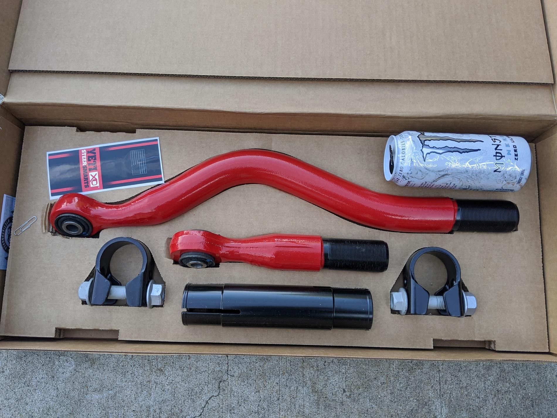

I am running Steer Smarts Yeti XD and Fox 2.0 steering stabilizer in the stock location (temporarily). I photographed the Yeti XD next to a can of Monster for perspective. Be sure to snug down your tie rod ends as mine required repeated tightening.
Had steer smarts Yeti front end on my JK after I bent my stick drag link and tie rod. This stuff is super tough. Met the guys who make these at Bantam Jeep festival a few years ago and they really impressed me with their knowledge and dedication. Plan to go to this when I lift.

Forged construction, $260 price tag - Steer Smarts is really a no-brainer.
