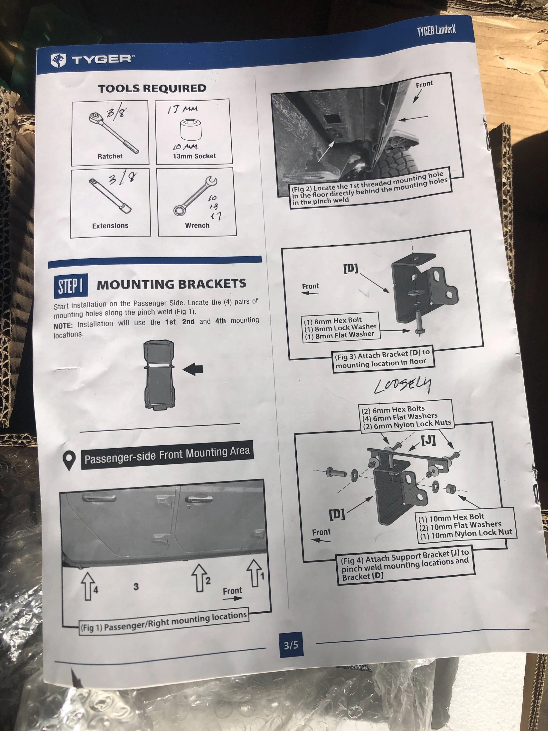

as well as the best instructions I've seen.
Although I could make a few suggestions.

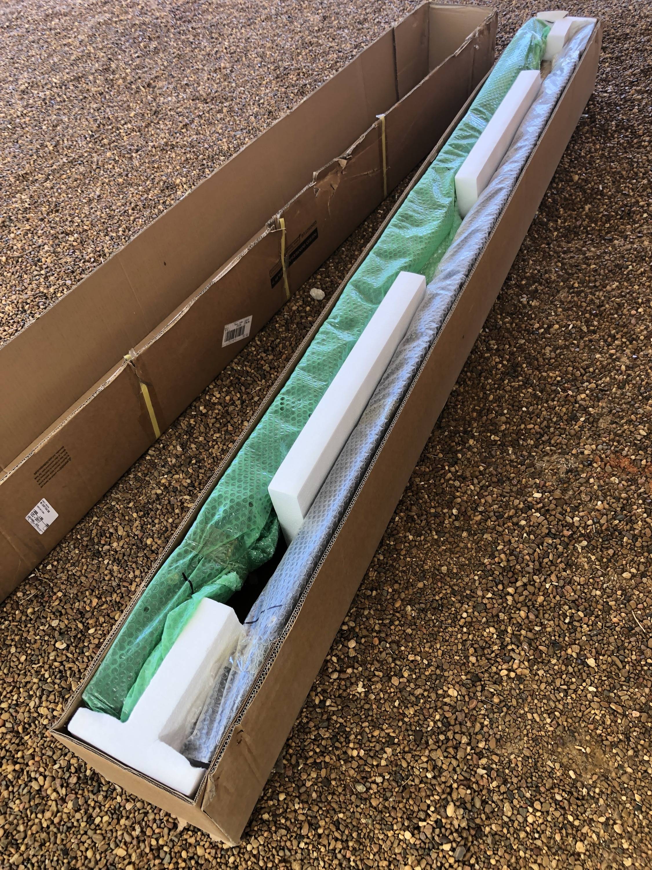

Very well packaged and finished.
The only fly in the ointment
was two D brackets and no F bracket
on the passenger side.
Jeep Gladiator Tyger Auto Lander X Running Boards 0W2DY5_gQhCMqGyKzp2i14z7K1yyxTftA_XaROUTZOT7=w2400
Having been burned before
I checked off the parts list before I began.
Customer service was easily contacted,
promptly replied
and is shipping a replacement,
which is refreshing.

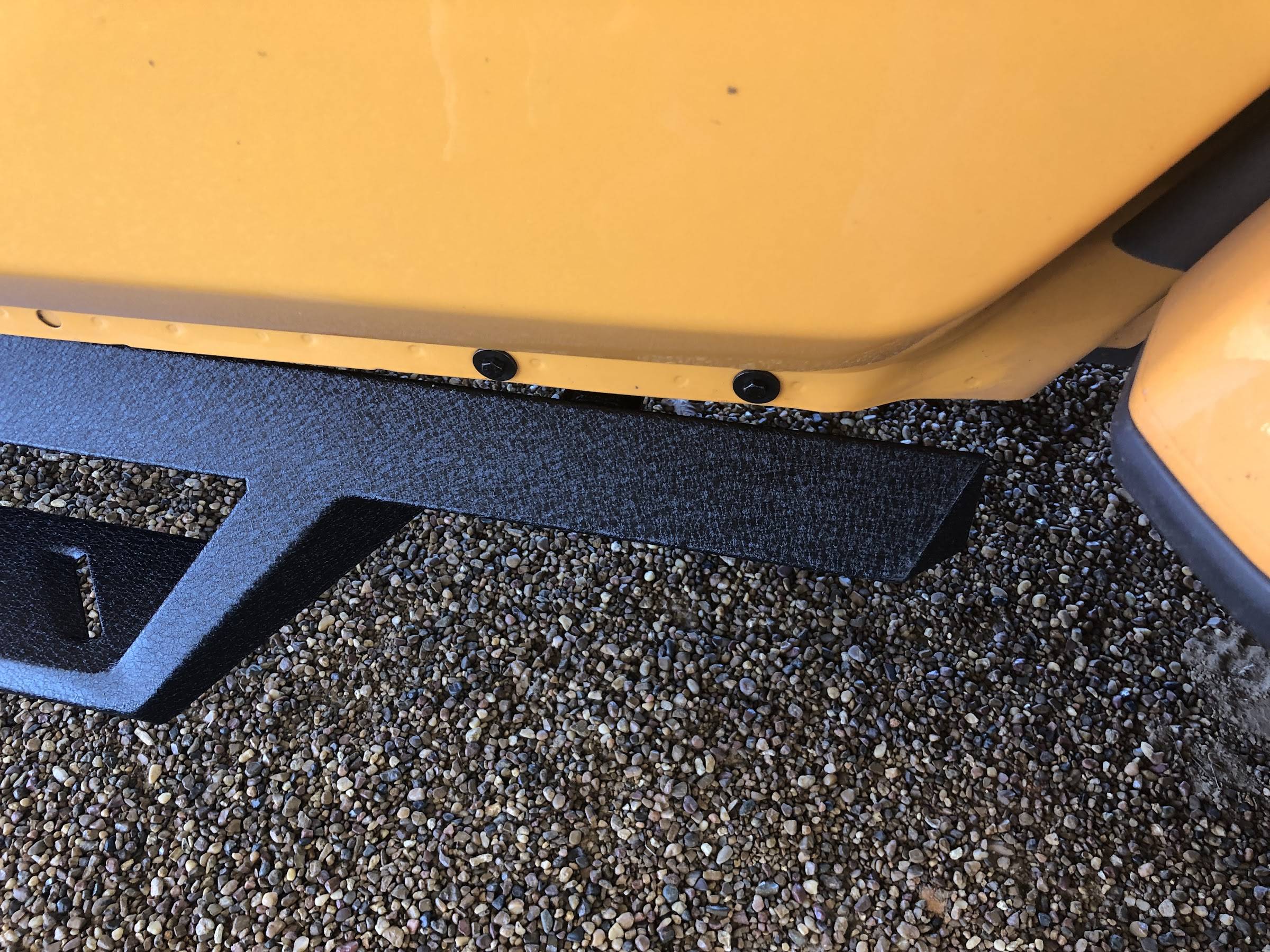

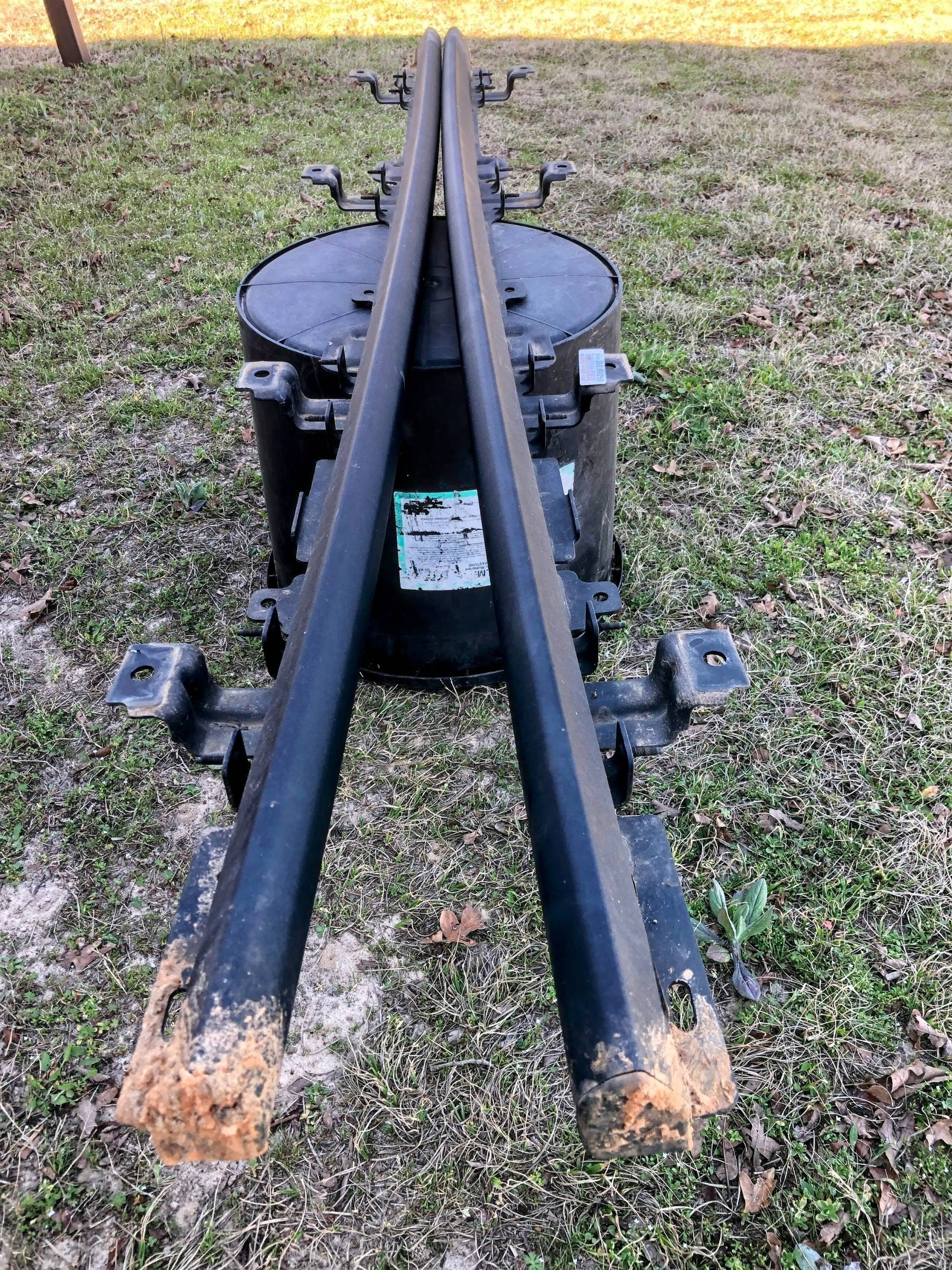

Here the discarded rock rails show one problem.
The Gladiator tub is not slab sided.
It has a belly to it
and the rock rails are curved to fit it.
Jeep Gladiator Tyger Auto Lander X Running Boards z1BJ05fKR7ZfyOgZuXT70x0N20LJU52x4xOOoFEf6Dnh=w2400

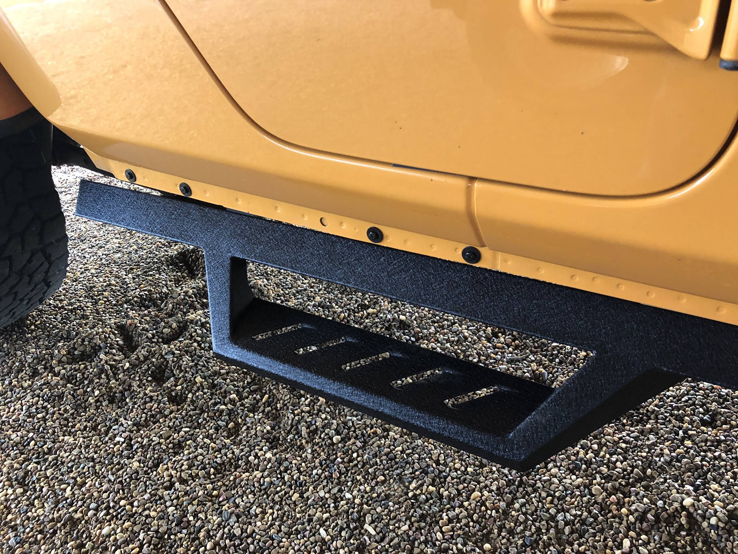

The Tyger rails are string straight.
As most aftermarket running boards probably are.
So a decision has to be made.
Leave an equal sized gap at each end
or favor one end or the other.
I chose to close up the front, the leading end,
to prevent snagging brush and collecting mud.
That's also the end I see getting in and out.
This is the gap at the rear,
one I can live with.
Jeep Gladiator Tyger Auto Lander X Running Boards AB0k0pkjRcBO4tPuqbOCuqA9AzJ-CkbxMHf7GdWwvO-C=w2400
There is some adjustment available in the brackets
and when I do the passenger side
I will see if I can minimize the gap more.
It is very disappointing that the pinch seam
and its fasteners are exposed.
The Mopar Rock Rail neatly covered those.

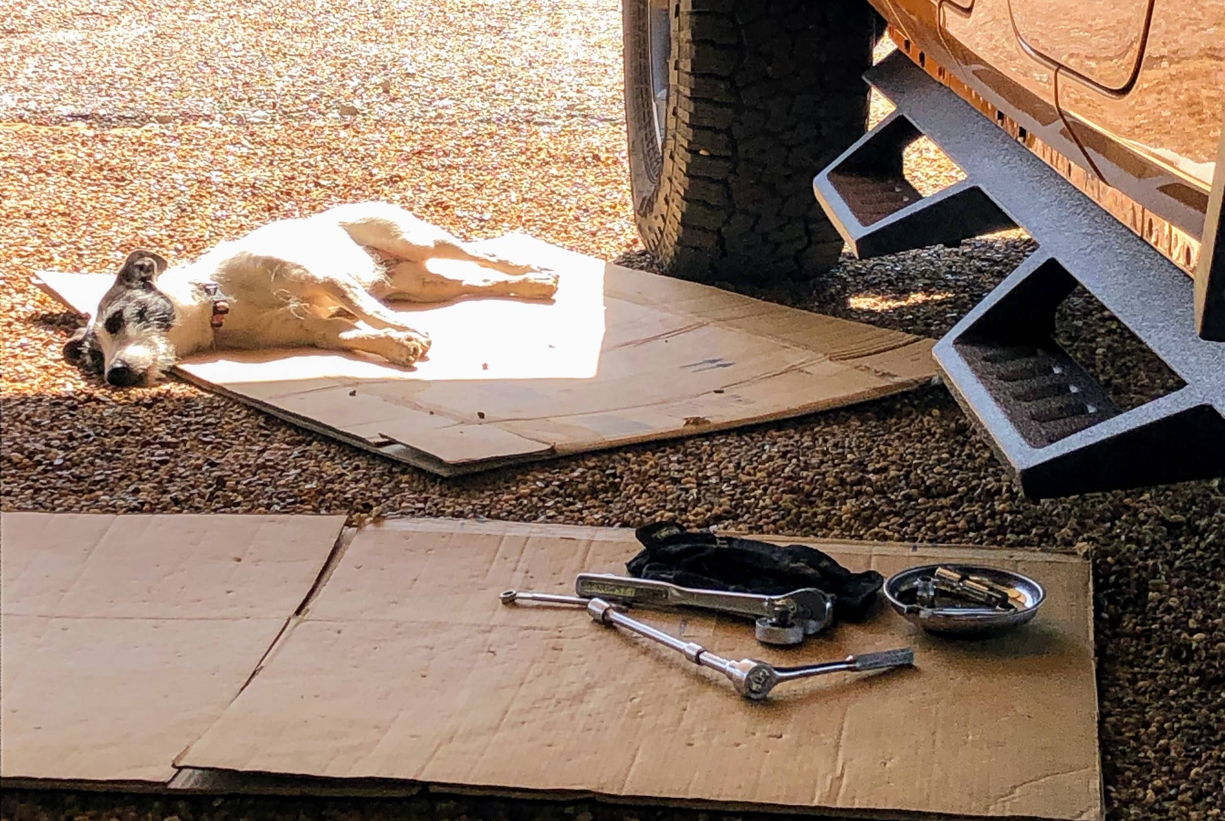

Here my exhausted helper, Izzy,
holds down a sheet of cardboard.
Jeep Gladiator Tyger Auto Lander X Running Boards q_iKnubIIJ11UYxLP_ELxH-stZ1RPoH3mReT61JuZBAY=w2400
A flattened cardboard box
is the most essential tool in the garage.
Comfortably ensconced under the vehicle
one can ponder stubborn fasteners
until stared into compliance.

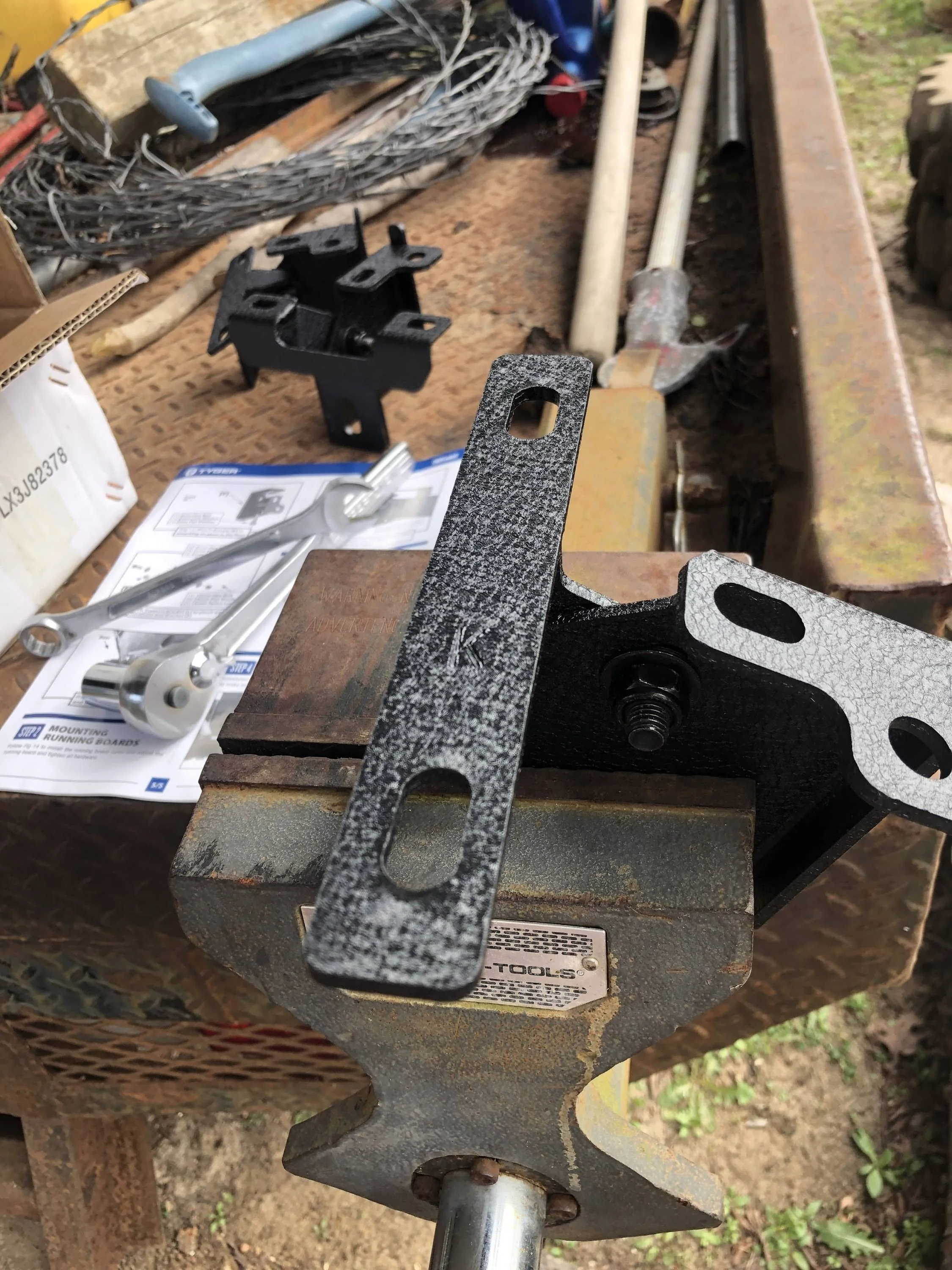

First, assemble the bracket and support bracket.
This I did standing comfortably
using my vise for a third hand
instead of upside down in the dark on my back.
That modest flatbed mounted vise
is one of the best accessories I ever purchased.
Jeep Gladiator Tyger Auto Lander X Running Boards pLE5iV82zdndKOgEqQFDI0axvl0Rf5bRqBB_7jpm1h5H=w2400

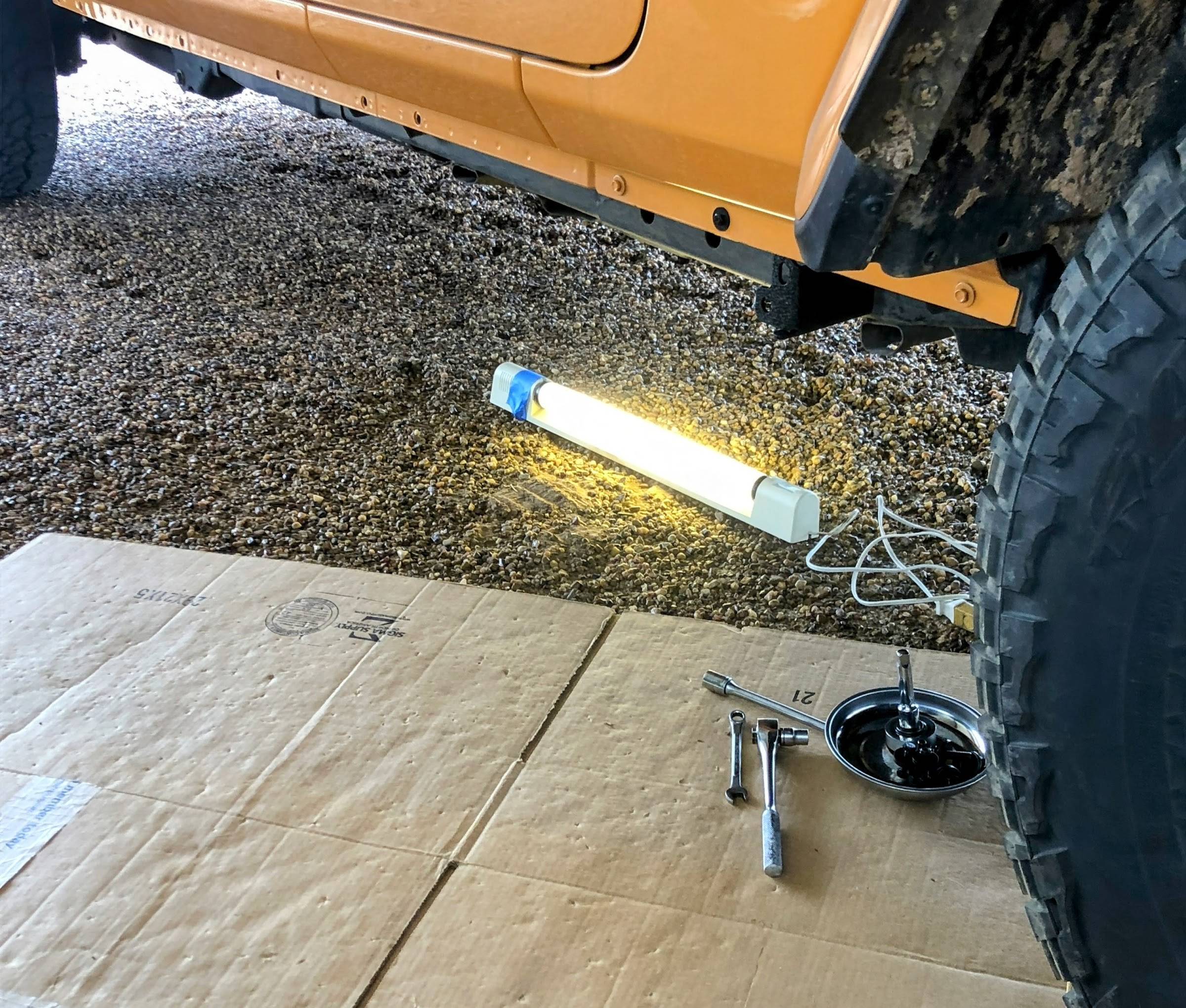

Next, I repurposed an old fluorescent light
left over from a kitchen remodel.
Another useful item is a magnetic parts tray
to keep all those parts, fasteners and tools
from rolling out of reach.
And of course the cardboard upon which to recline
and cogitate about the meaning of life.
