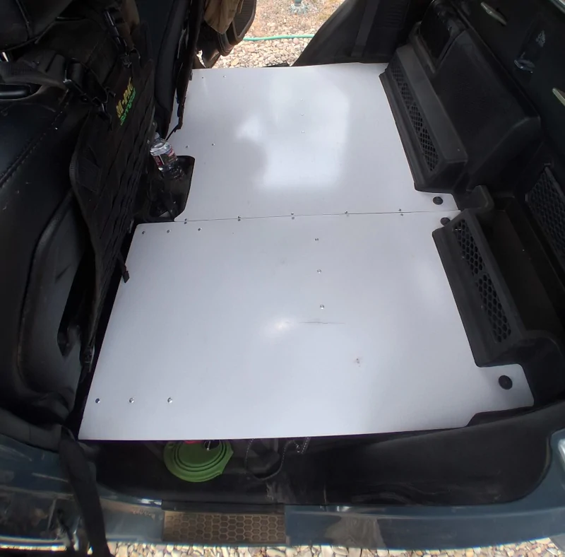

Made a flat floor out of 1/8" Aluminum composite Material.
This stuff is lighter than solid aluminum sheet, but not near as sturdy. Made it so either side could be easily removed, if a seat needs to be reinstalled temporarily.
Used aluminum 1/8" x 1" flat bar to create supports. You can see in the below picture the aluminum rivets and screws where those supports are located.
Jeep Gladiator Ultralight Rear Seat Delete (Home Built) Flat Floor

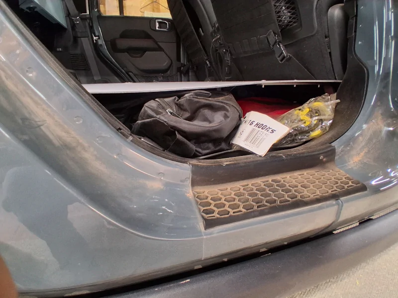

Picture below you can see how thin the aluminum is. Almost like aluminum foil bonded to the plastic material on either side. It is very easy to work with. I used a razor knife for the long straight cuts, and a jig saw with a fine tooth blade for the curves.
Jeep Gladiator Ultralight Rear Seat Delete (Home Built) Floor Stuffed
Down sides to this floor are:
* The lack of a hatch over the jack. the jack and tools can be removed from under the floor, but not so easy. So a hatch will get added.
* If more than about 15 lbs is applied in any small unsupported spot the floor will flex. With the load spread out it is surprisingly strong. Just for fun I put a 65 qt 12V fridge in, and it was very well supported.
It helps that there is plenty of gear stuffed under the floor, adding more support.
When Super Pup walks on it, there is very little flex.
