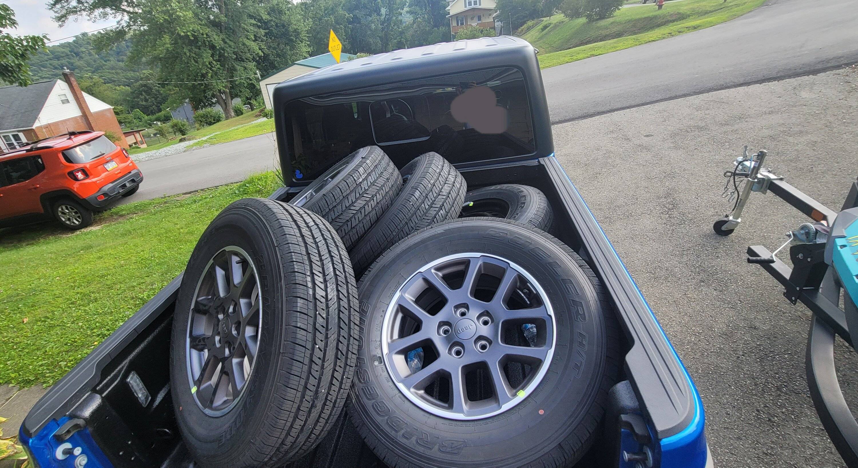

Thanks for the input, guys. I opted to err on the side of caution for now and decided to stick with stock for now. I found a set of dealer take-off Overland wheels (4+spare) with near zero dueler hts for 800. I figured for what it would cost for tires/mounting/balancing, this was a decent deal. And then I'll have my old overland 18s to possibly throw something bigger on a little later down the road.
