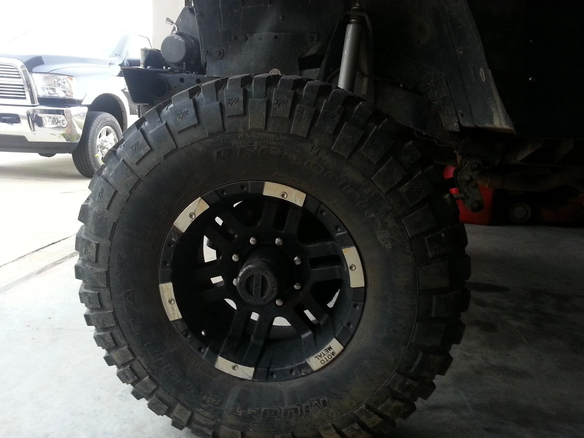

Well........it is the TIRES. I decided to swap back to the stockers this morning to rule out tires officially before going down the suspension geometry/steering upgrade rabbit hole. It drove smooth as glass and got it all the way up to 75+ with no shimmy at all. So next I am going to swap the 37s back on, but move the previous fronts to back and see if there is an improvement or hopefully identify one shaky tire. Glad I tried thisbecuase I am selling the stockers this afternoon.
Usethis83
Usethis83
May 20, 2020
190
273
Alabama
2020 Gladiator
I swapped the 37s back on and rotated them in the process. It definitely improved, but still needs balancing attention. It starts to shimmy after 65+ now. I plan to ask the alignment shop to take a crack at it and see if they can balance them better. I have had 37 bgf km2 in the past and they balanced out fine (although the jeep could only do about 60) so.....

Did you take the media out?
Usethis83
Usethis83
May 20, 2020
190
273
Alabama
2020 Gladiator
No. I flipped them just to see if it changed anything and perhaps could isolate a bad tire. I do not have access to a tie machine. I also do not know how if 4WP mounted them (i.e. did they line up dots and valve stems, etc.) From what they told me during sales, the beads come in a bag that ruptures after driving and lets the beads loose? I do not know much about these. Maybe a bag did not break. I figure the tire shop could verify after breaking the bead.

The balance media conversation is stupid long to understand but it sounds like you paid for a balance that didn't work.

Andy,
Have you heard of the prefilled bag deal that is placed inside and ruptures to release the beads on its own? Is that a thing?
DOOKEY
Andy
Aug 1, 2019
62
49
Thornton, CO
2020 Billet LEJT.
I build wheels.
Andy,
Yes. It is a nice convenience since the bags are already the OZ you want. I always cut the bags and drop it in. I don't leave the bags in there.
The issue I take with balance media is that I've seen wheel and tire combos in years past that require zero OZ's to balance. Which means you create a problem when you toss in the media.
You have to weigh the combo properly to know how much weight to add. The charts aren't true.
Do you know which product is in there?
Usethis83
Usethis83
May 20, 2020
190
273
Alabama
2020 Gladiator
EQUAL 8 OZS. BAG - Part # IMIEQCS40CD
DOOKEY
Andy
Aug 1, 2019
62
49
Thornton, CO
2020 Billet LEJT.
I build wheels.
I can't find that part number on their site. Do you know if it is a solid ball bearing style media or the powder?
If it is the powder... that's your issue. Equal used to make a powder product and it just shouldn't be used. I don't know if they have updated their product.
I also wonder if i have given the bags enough time to ruoture and release the media. I have less than 25 miles and mostly slower speeds......i saw on some other forums guys were driving at least double that before they beads worked correctly. Maybe i should just keep cruising for more miles and see next week.
