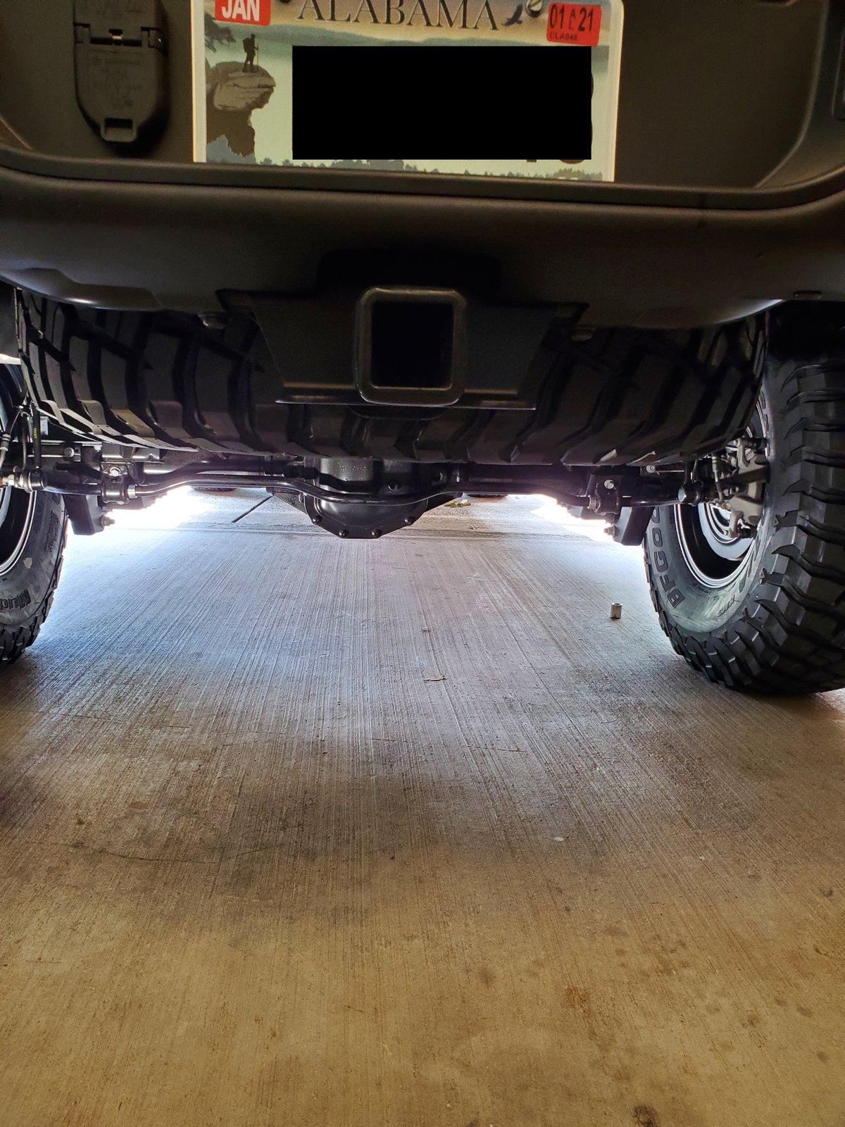

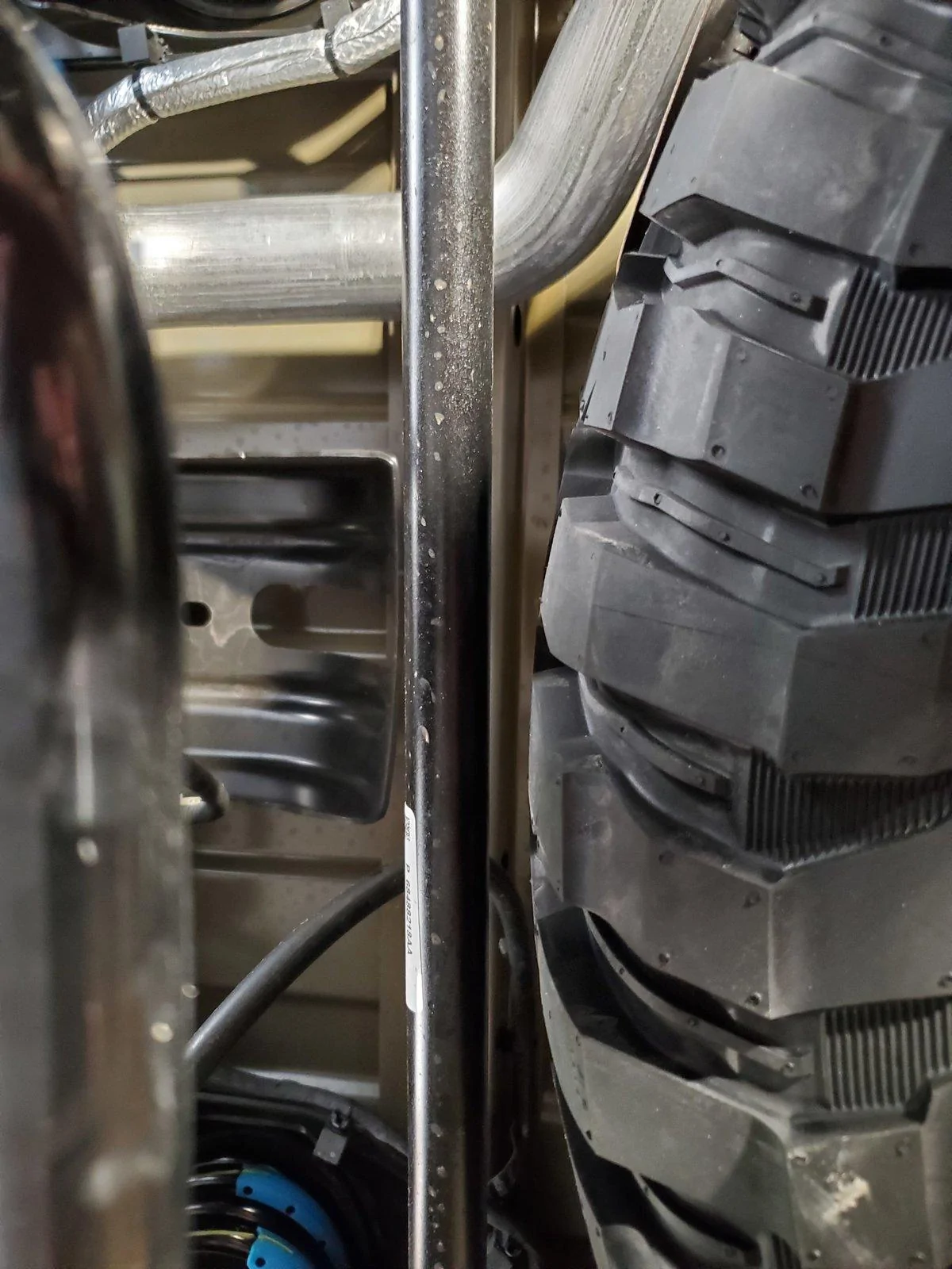

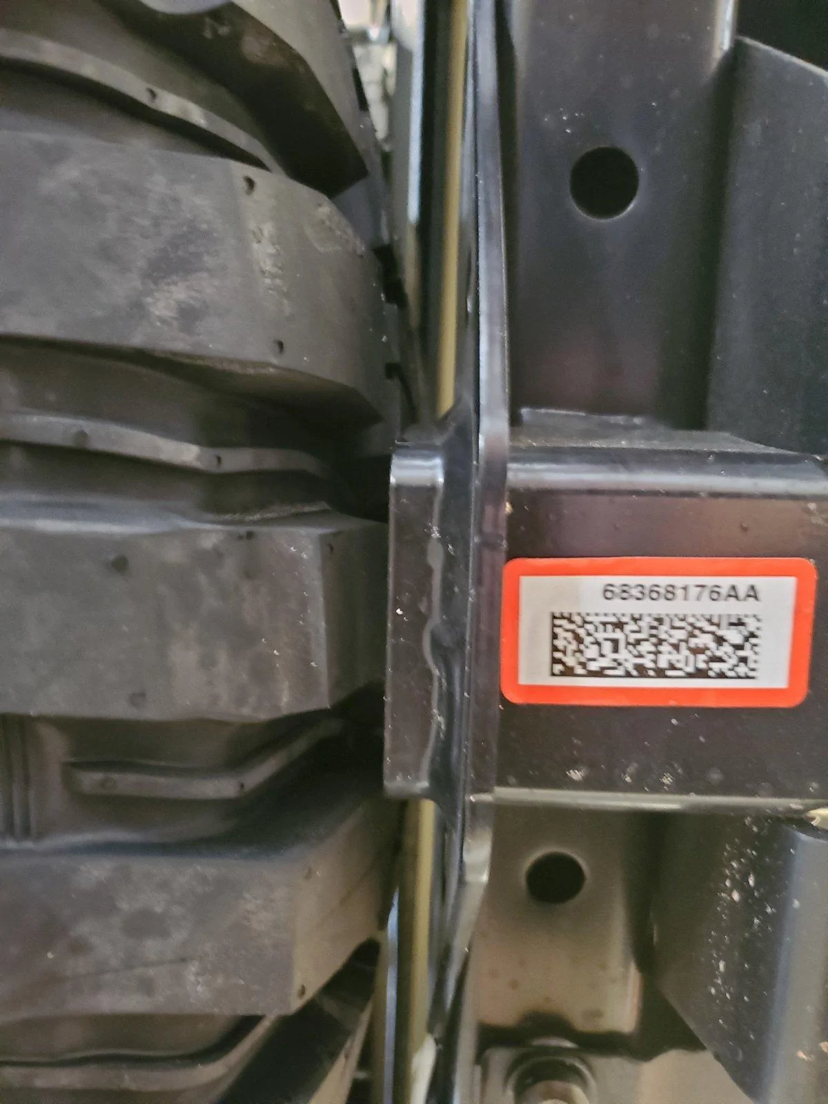

Also, for the spare tire folks, the 37 BFG KM3 on the 17x8.5 wheel does fit. I shoved it as far as it would go to the hitch and heat shield to get as much clearance to the rear track bar. There is about 1/2" clearance to the track bar at full pressure.
