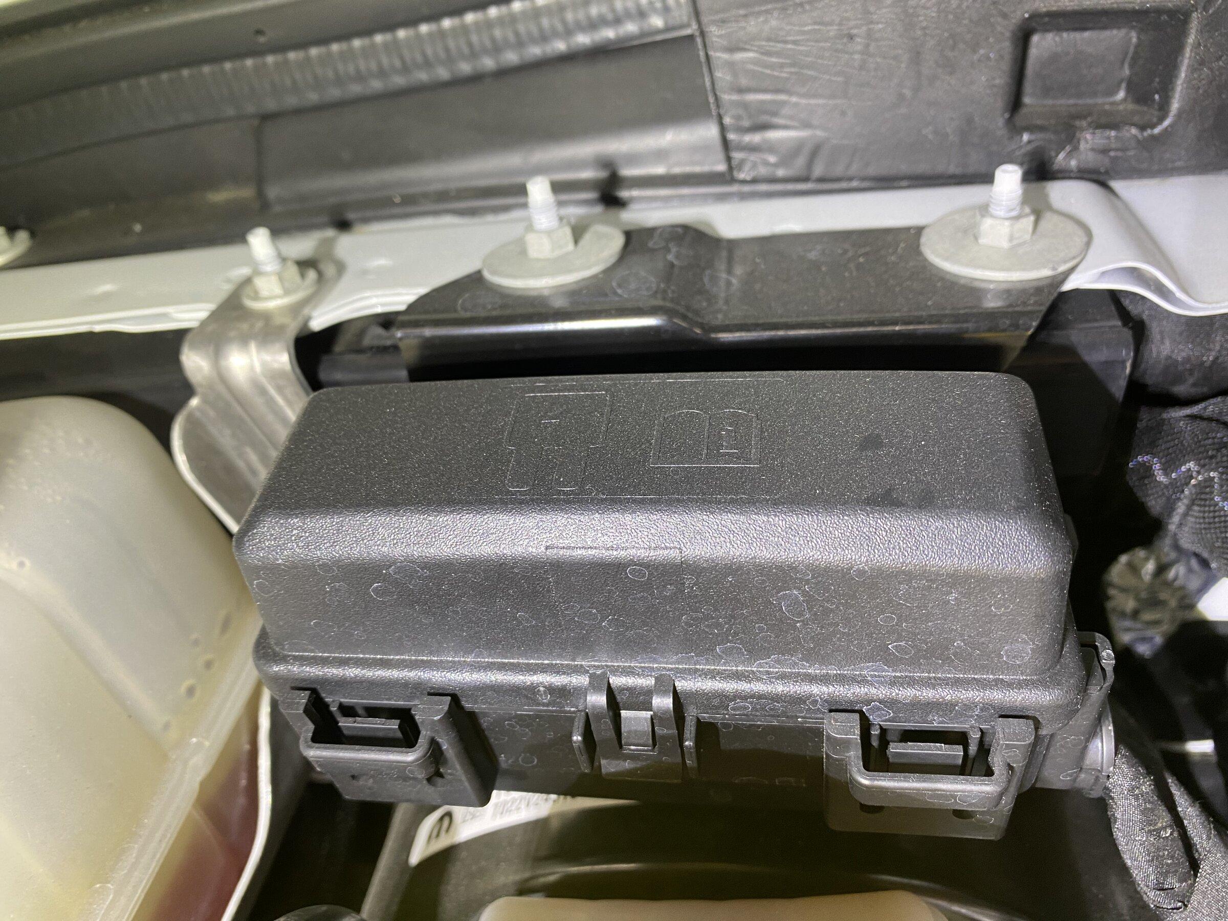

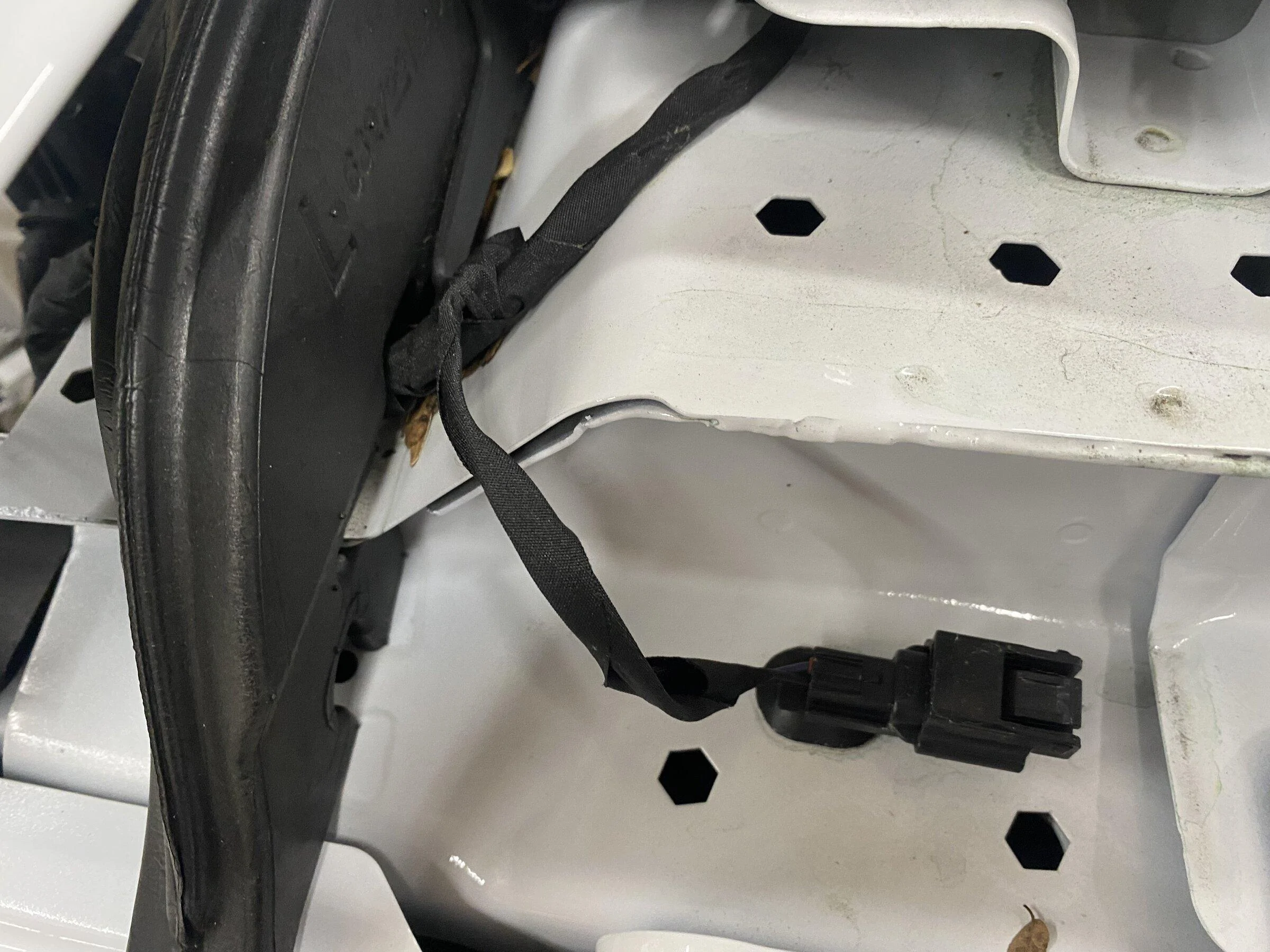

So I finally had a little spare time to try and install my CB and GMRS Radios. I still haven’t found the best way to run electrical or 2 lines of coax.

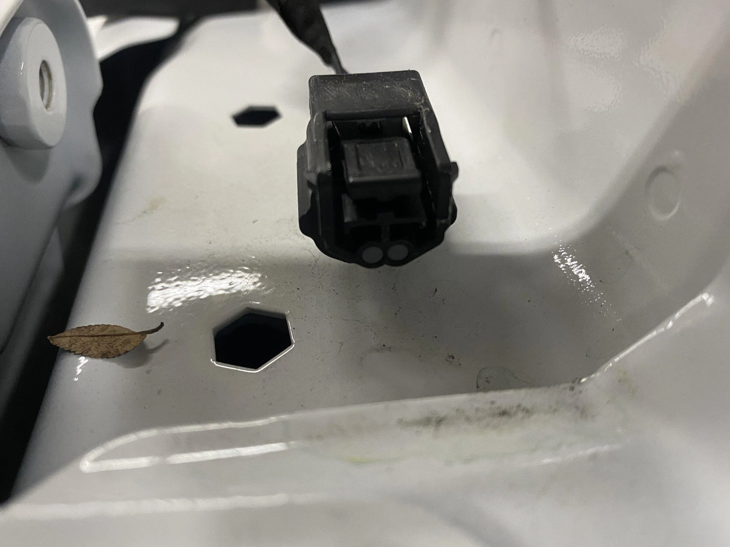

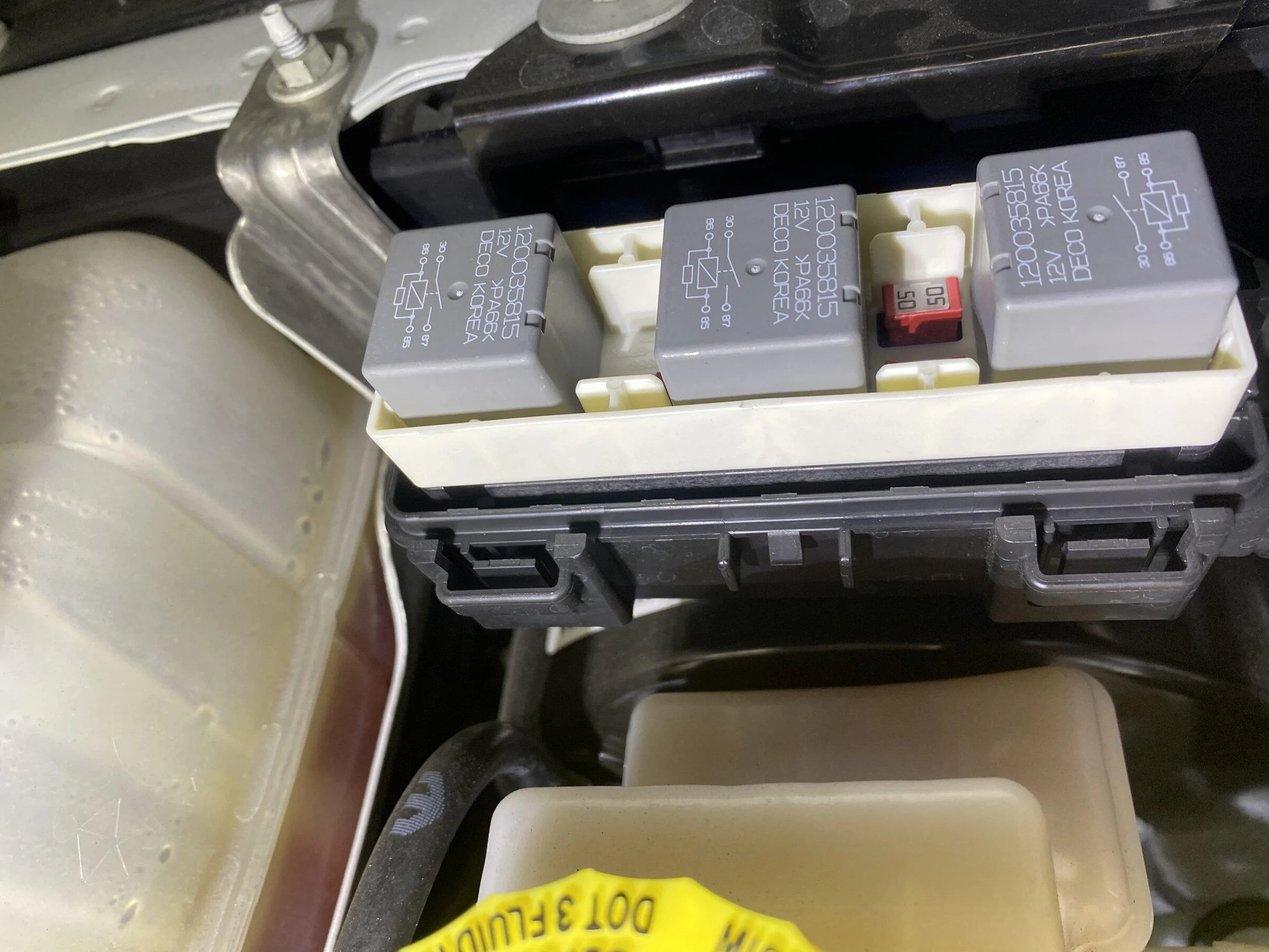

I came across a couple of things I have no idea what they go to. The small relay box is located just above the brake booster and has 3 relays and 1 50A fuse. The plug is located under the drivers side corner cowling.

Idk?? Do you have aux switches ??

That plug is for something relating to the adaptive cruise, if you have it. If not, the wire is just capped like what you have...
That fuse block could be for the Aux switches I guess.. I don't have them or that box in my Mojave, so that seems most likely.
The driver-side cowl connector is for the resistive heater built into the Adaptive cruise windshield.
