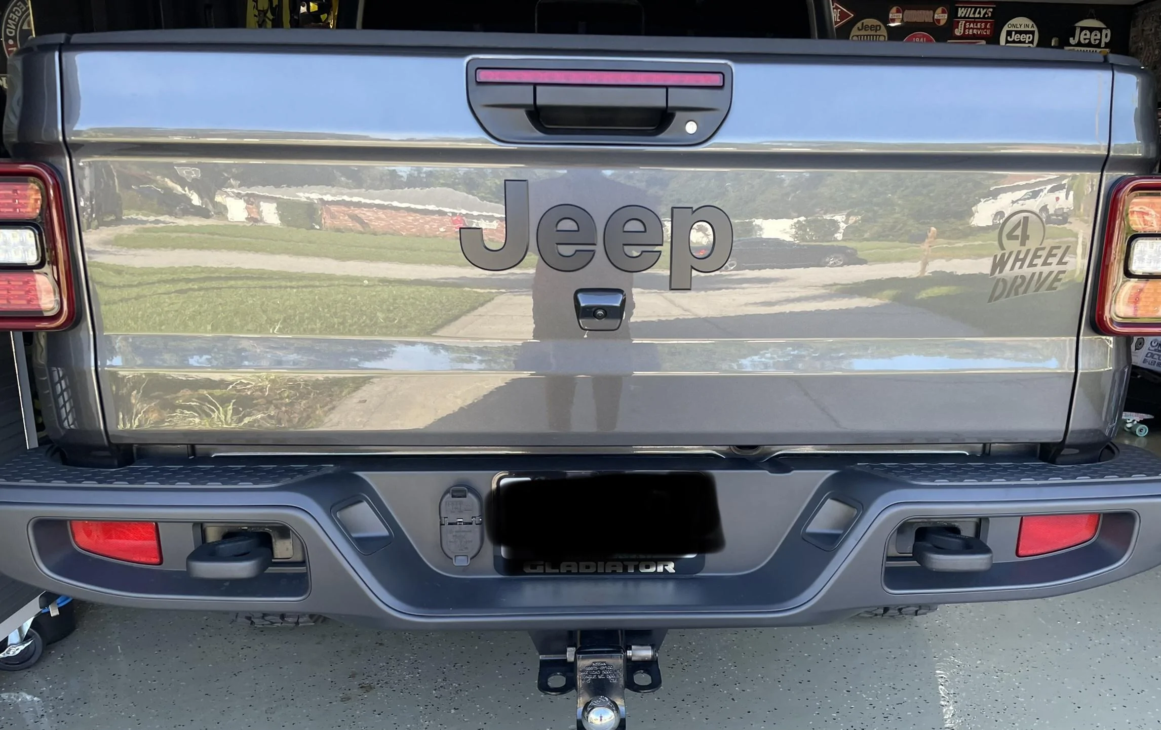

Installed the second tow hook. It’s amazing they don’t come with two.

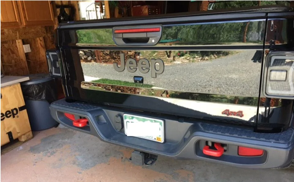

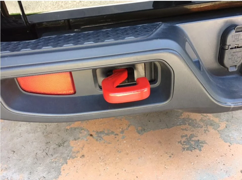

Added the second tow hook to my Max Tow. I went the OEM route and used the Mojave insert vs. cutting. Dissembling the rear bumper is no joke but I managed to not break anything.
I also painted the hooks gator while I was in there.

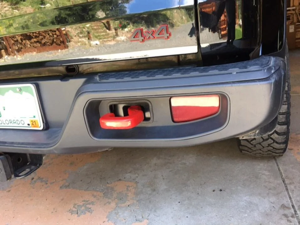

I finally got around to adding the right side rear recovery hook.
For others adding a second hook, a few call outs.
I bought the right-side factory Part No.: 68355490AA
BEZEL-REAR BUMPER.
This Bezel has the cut out for the hook.
Come to find out, the Bezel doesn’t fit the non Rubicon bumper, the design is just a little off.
I ended up cutting out the current Bezel to match the one I bought.
I added edge trim to give it a finished look.
Also painted the left hook to match.
Picked up some paint that was pretty much a perfect match to the Red Hook.
